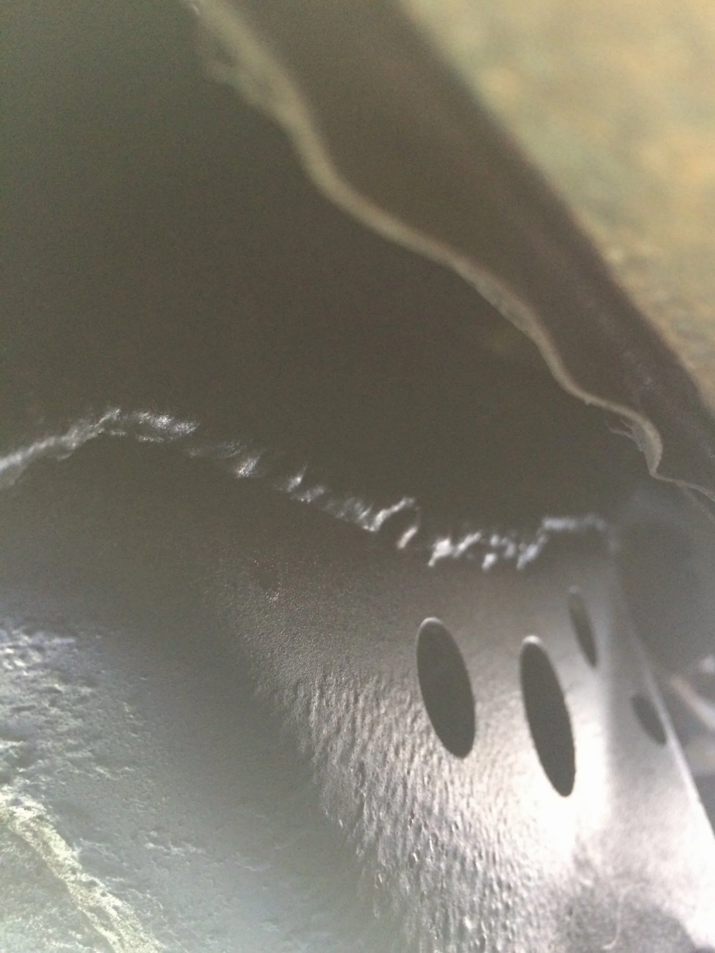

So I sold my 3x locked lx45o and got a 2002 4runner SR5 for my son he will be driving it this school year. This build has already its ups and downs from the start. Almost sold it due to my son not liking it . So I let time pass by ang let everything cool off. So after a month my son agreed to keep it . This build was started at T4R forum originally but almost sold the vehicle at that time then found this forum here so I just decided to start it here since I have my 3x Locked 94 LC build on this forum . So on with the build . 2002 Toyota 4Runner 224k miles 1owner. First thing first is I have to address the frame . The pass side rear lower control arm mount on the inside frame has weakened due to heat coz it's right where the muffler was. So I have a friend welded this thing out and btw he really did a good job and took time to grind that bad spot . Then did the timing belt , water pump , thermostat , all pulleys, drive builts.
