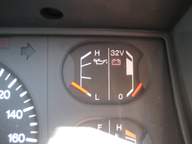

Heres a picture:
The engine is obviously off btw. It is about halfway between the first line and the bottom during idle, little higher during cruise, and hit the bottom line of "the zone" when high rpm.

Well its time for the mechanics pressure gauge.
The sender in the LH side of the block is interchangeable with about 30 Toyotas ,petrol and diesel,and cheap if you know where to look.
If the gauge is no good they usually sit down much lower than the lowest mark when the engine is off according to my wrecker.
An oil change can often push the gauge up a few mm.
My old 3F would tell me the oil needs changing when the gauge dropped.
The indications I see on my 1HZ is two (when cold) or two/three needle (warm) widths below the first mark at idle and about one to one and a half needle above that same mark at RPM above 1500. Only when realy cold the needle will sit approx 3 widths above for a short time (2-3 km's).
Even when I get close to max RPM the indication will hardly change.
