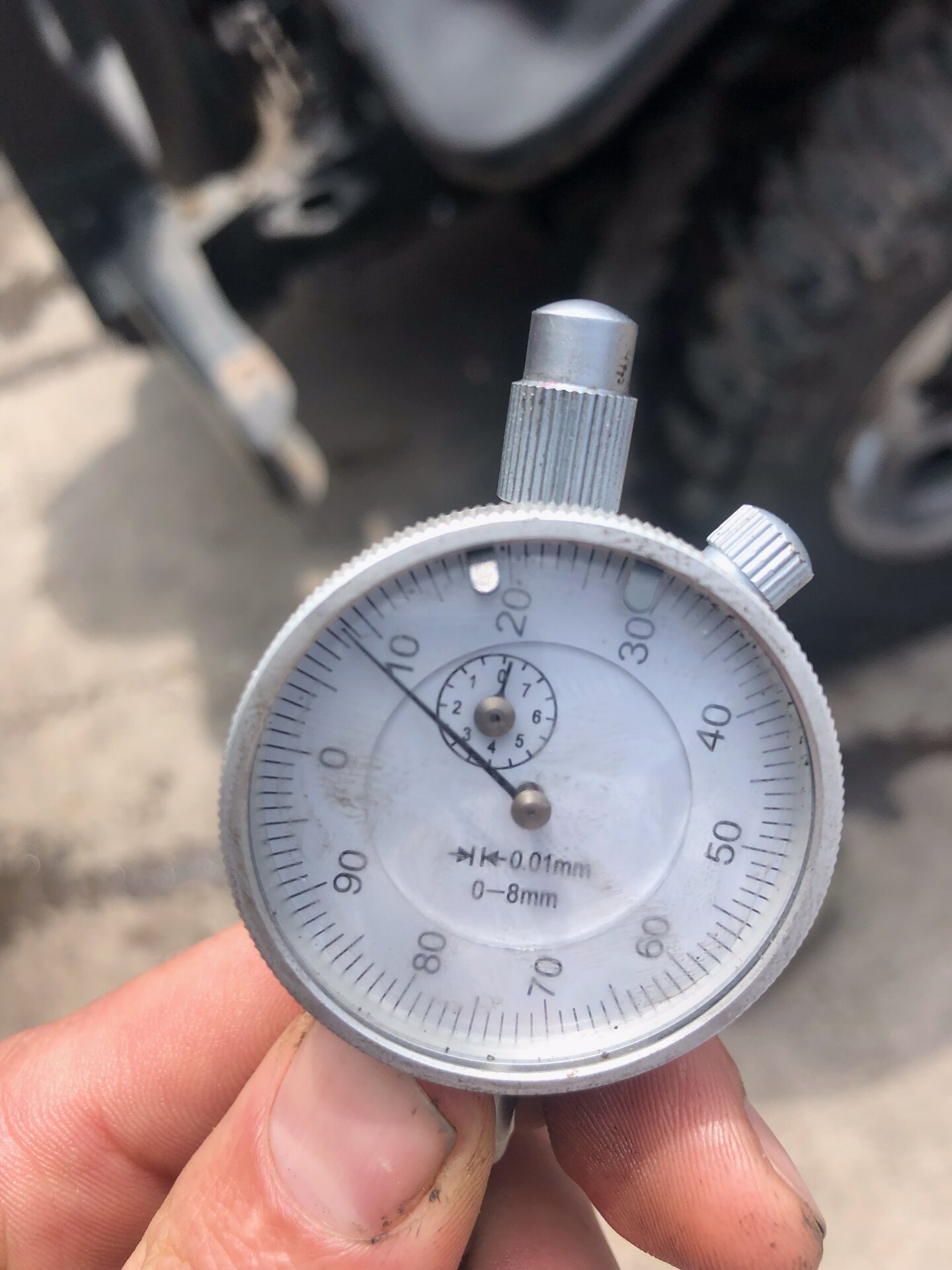

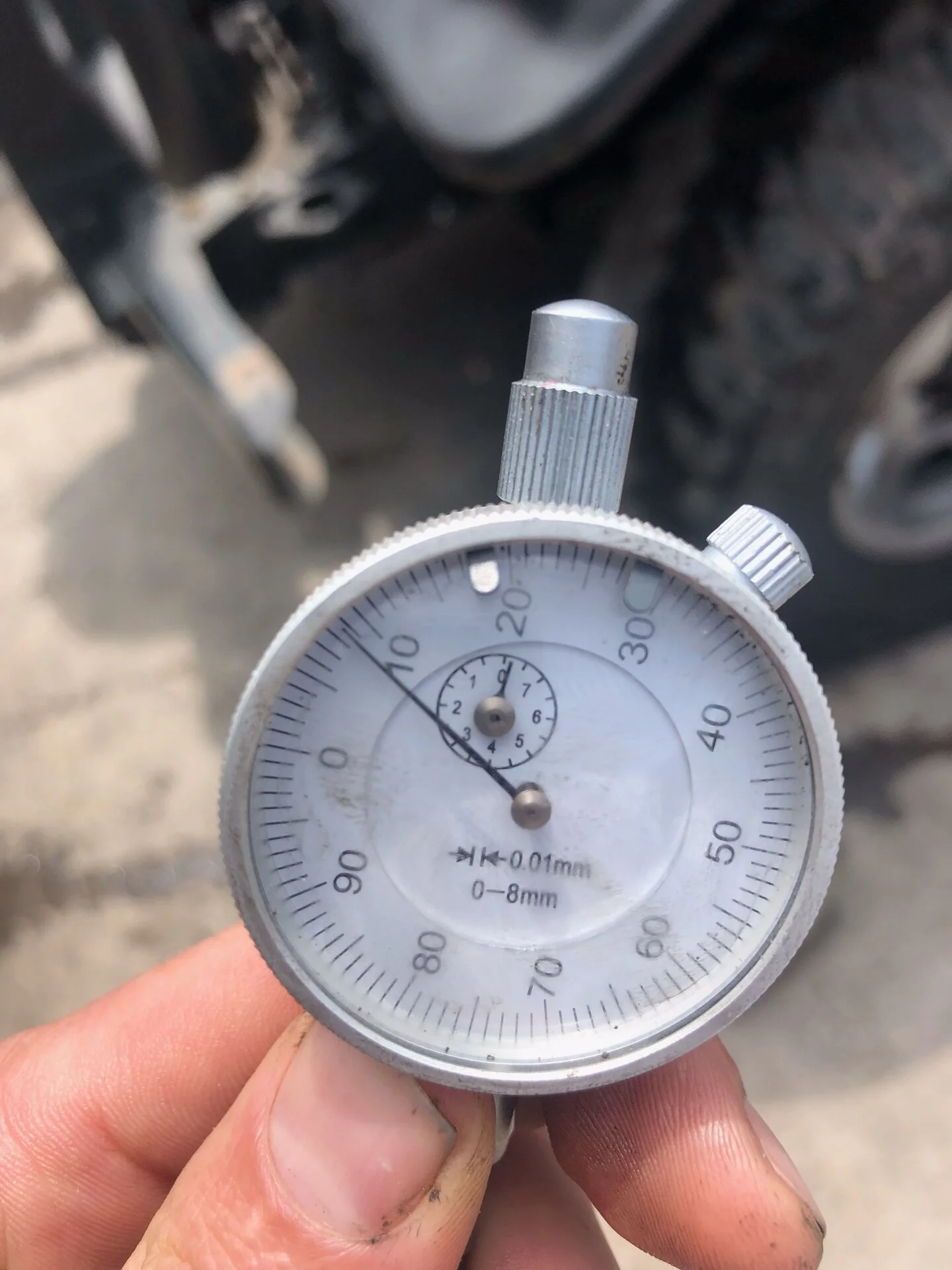

Today we timed the injection pump. 1.09

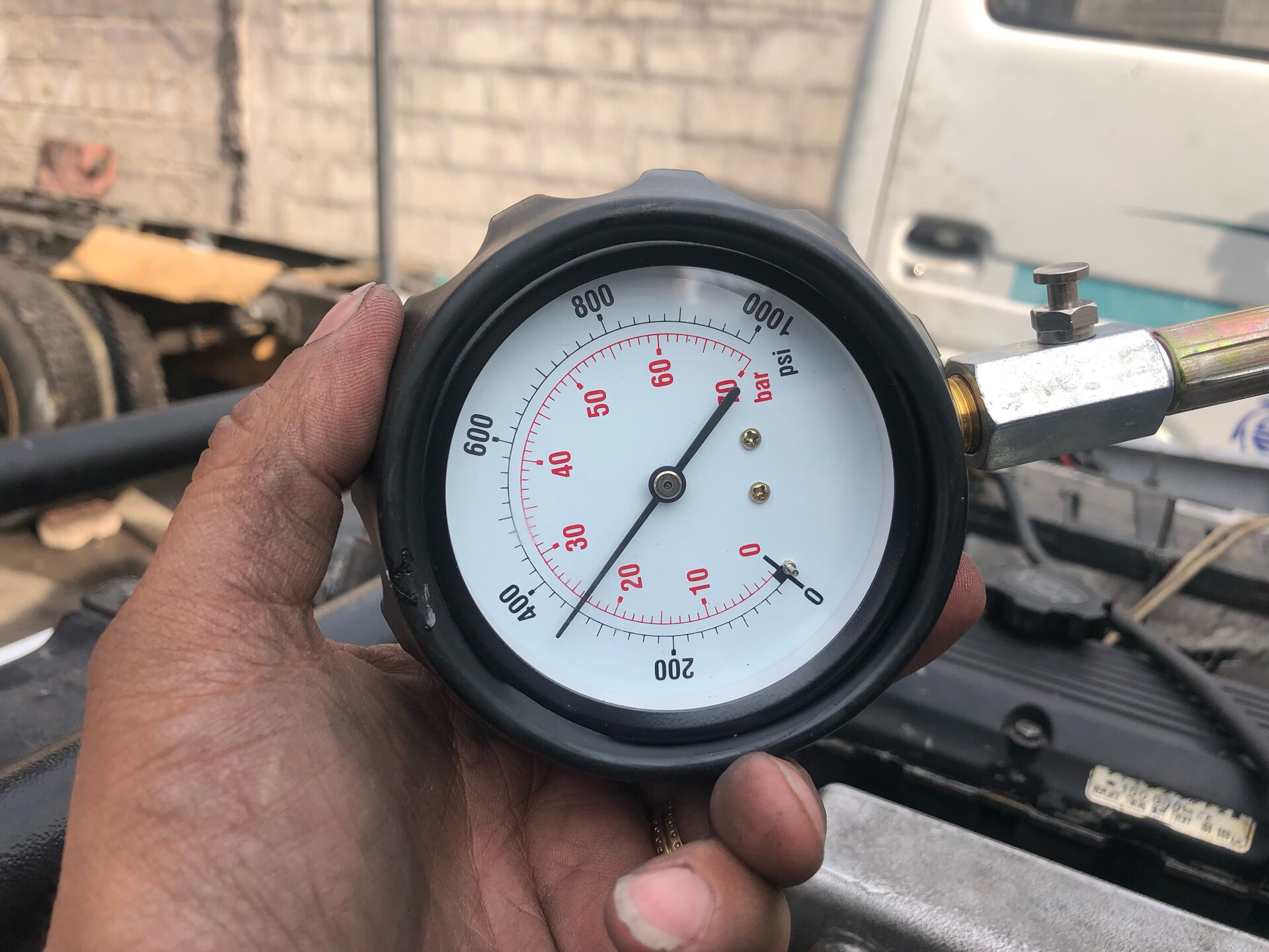

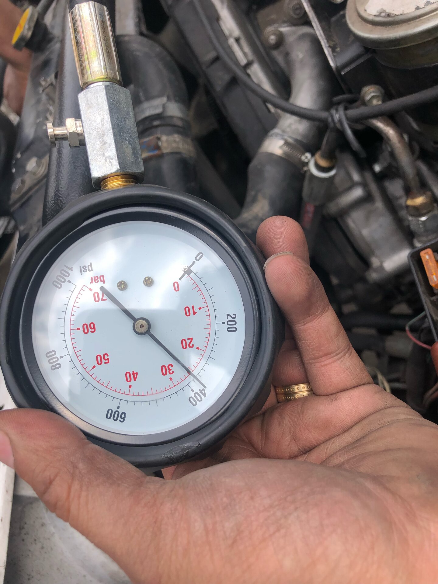

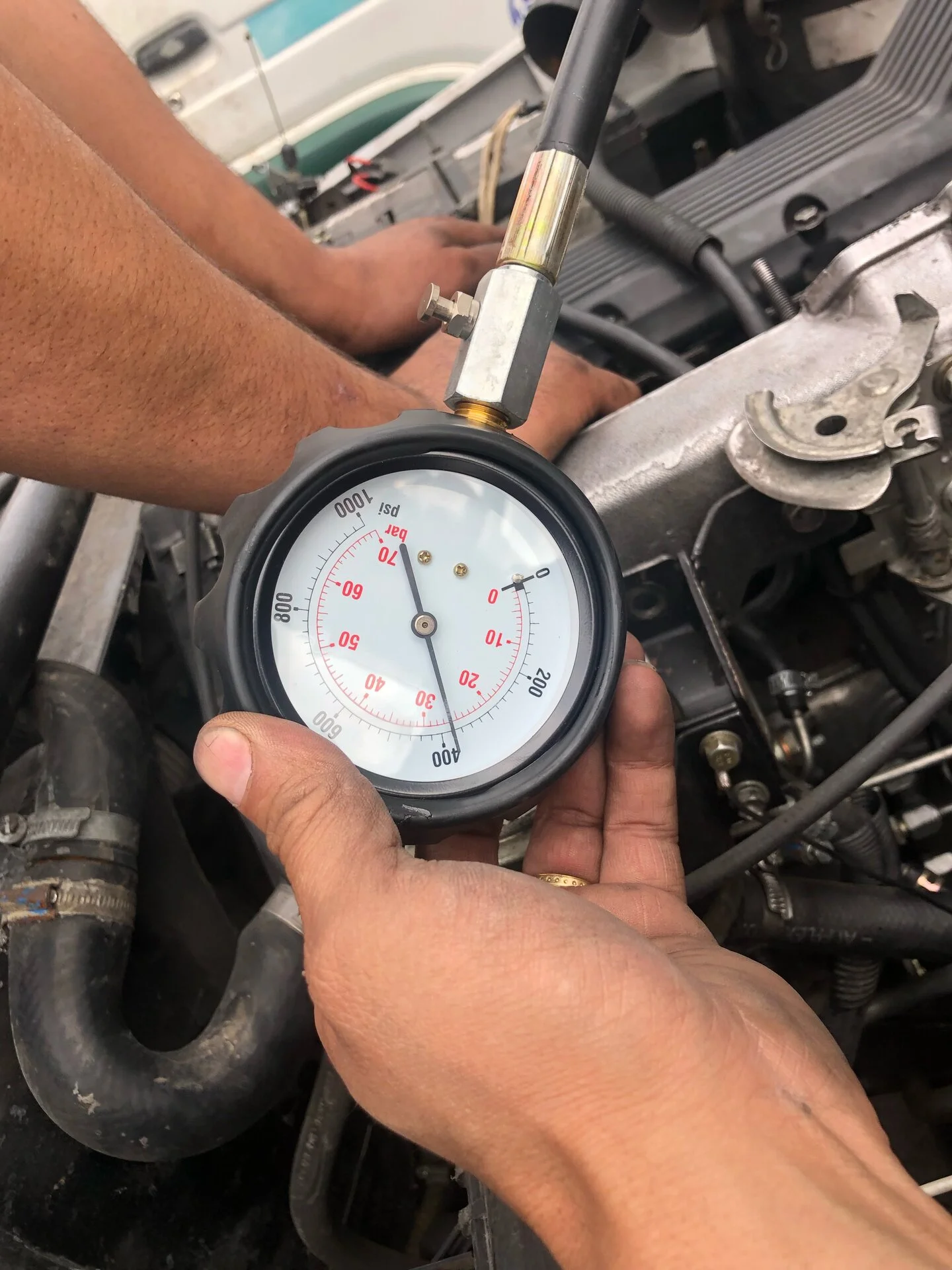

Compression is all about 375 psi

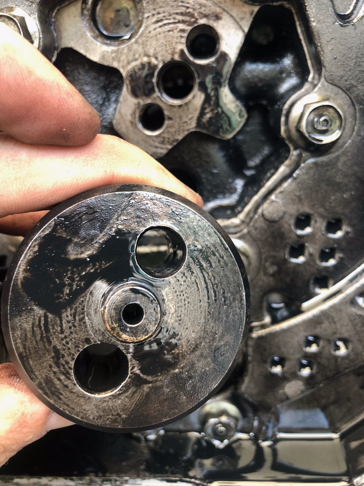

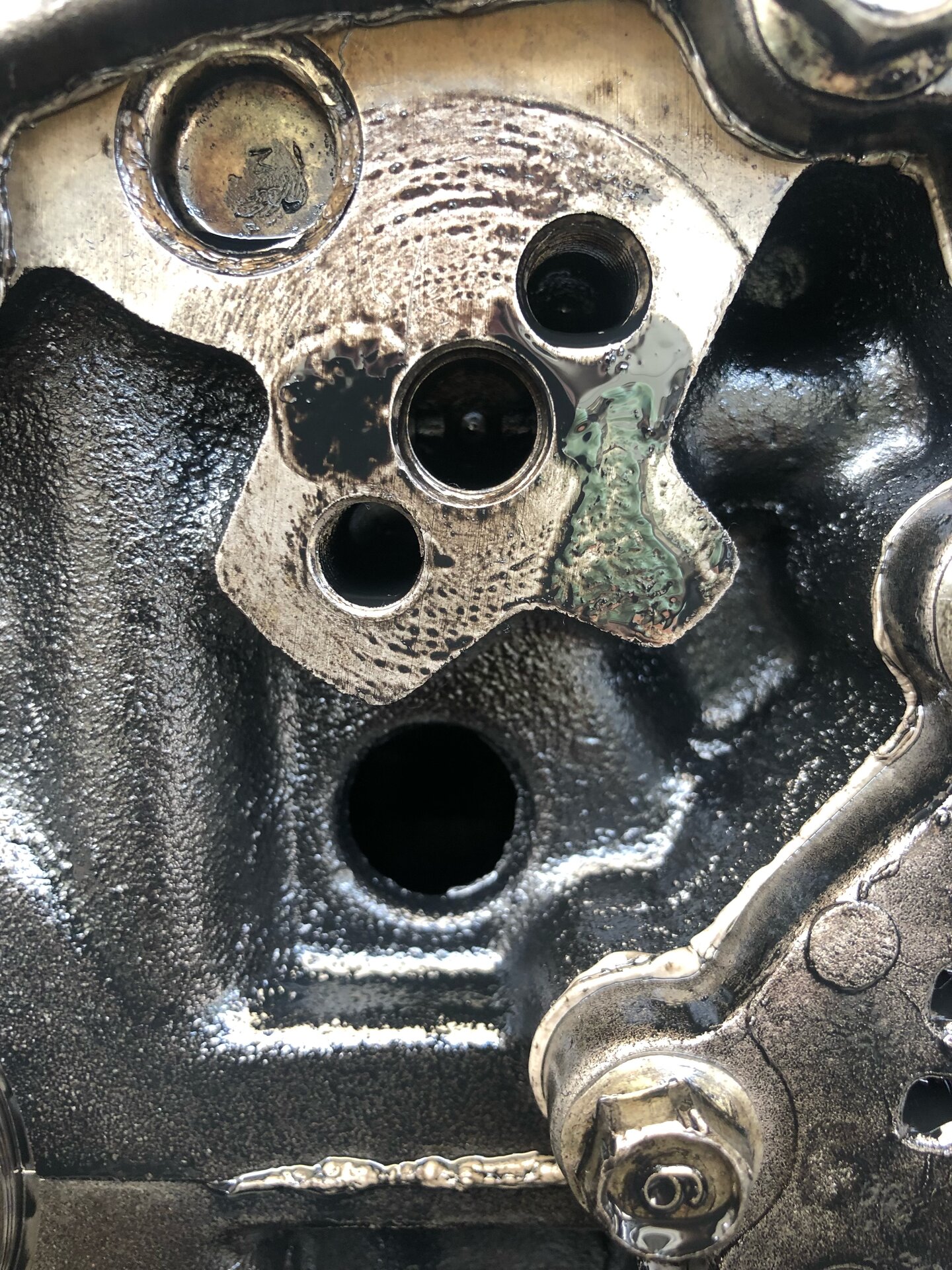

Seems like the rattle noise was this thing a bit loose. The holes are a bit oval now but not to bad. As long as they get this to hold firm it should be ok?
