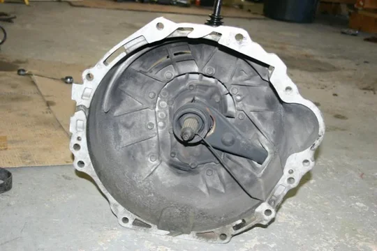

After some research of my own...The bellhousings pictured in this thread both mate to a h55. They do use four bolts. However, The 1hz-r151 belhhousingdoes not. It uses 8-10 from the pictues I've seen.. Just like r151 found in the mini truck.
Still trying to figure out the input shaft length of the r151/1hz tranny?????
I sold my R151f that bolted to the 1HZ, so I can't measure the input shaft for you, but I can give you a picture of the bellhousing bolted to the transmission.
I sold it to a member here, so perhaps he can measure it, if it's still out and available. He may have torn into the transmission already though.
Dan
Thanks Dan,
I sent that pic to the company making the adapter so hopefully they can tell me if its a match.
