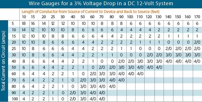

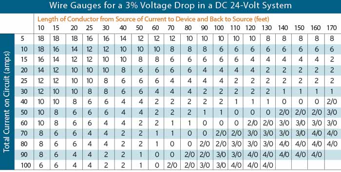

I think you have it the other way around. A 24v at 30 amps is the equivalent of a 12v at 60amps. So if you increase the 24v to 60 amp it would be like a 12v at 120 amps? I dont know just trying to make sense of what you said and what i read on google.
I've worded it poorly, but if the wire is sized to safely handle 30 amps at 12V it can handle 60 amps at 24 volts. The higher the voltage the more amps a given wire size can safely conduct. Of course the length of the circuit matters for voltage drop/wire protection but as an example: If you have 10 AWG wire, and your circuit is 10 feet and you want only a 3% voltage drop then that 10 AWG wire can carry 30 amps at 12v or 60 amps at 24v. Compare the wire gauge charts below and you can see that you need much larger wire to conduct 60 amps at 12v.
