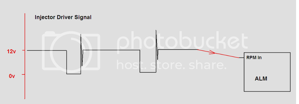

I was able to contact the manufacturer and the sent me this to describe the required input signal for RPM:
I don’t remember much from my basic electronics class but that’s a pulse wave, right?
Now after a bit more searching I found this thread: https://forum.ih8mud.com/threads/fzj80-to-hzj80-conversion-tach-wiring-problem.817896/#post-9359200 what I gather from this is that the sensor on the IP is an inductive (VR) sensor with sinusoidal signal output. I figure that I’m going to need some sort of a tach signal converter to get the ALM to log the rpm. Please excuse my ignorance; does a sine wave to pulse converter exist?
