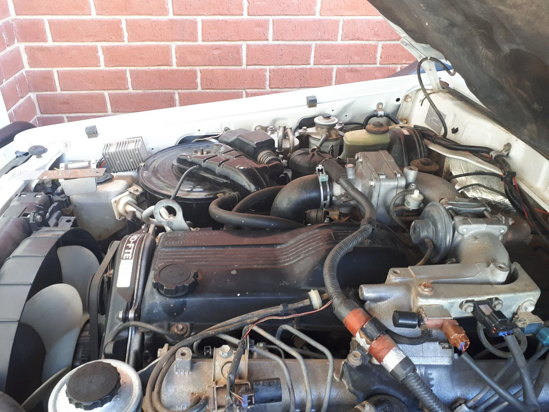

Next mod i will be doing is a egr delete. My question is, can i drill the egr delete plate exhaust side for a egt probe, and will this be a accurate reading spot? I realise that i need the probe pre turbo for a reliable reading.

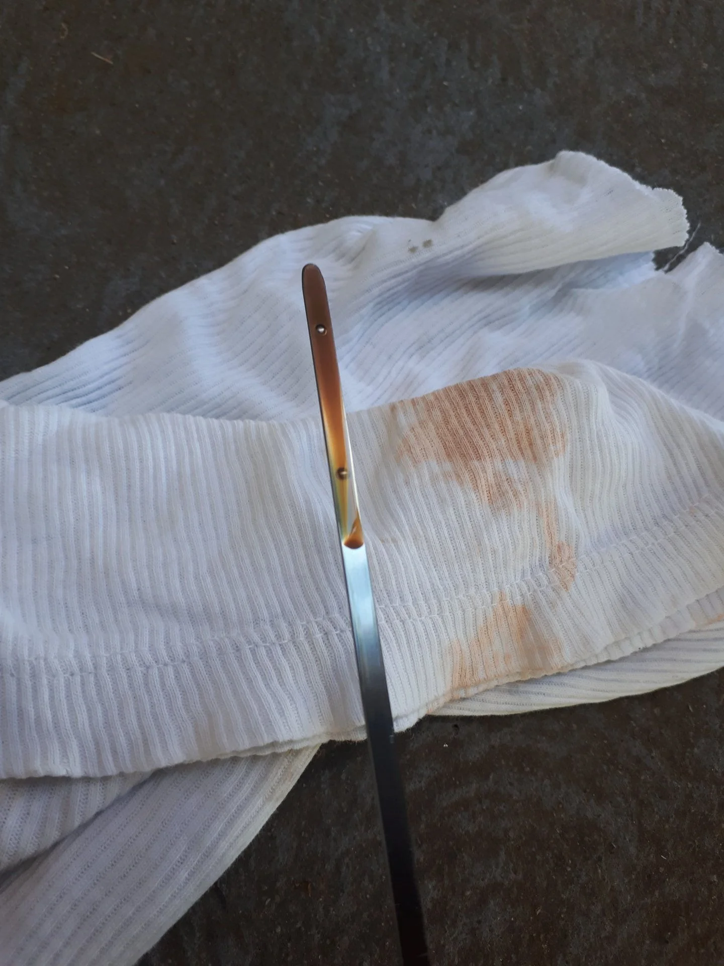

This is the oil colour after 2000ks:
1924225
so, looks to be a healthy motor if this is a good indication

Nice oil, but it should be that clean after 2k. In fact it should be that clean for quite a while. Mine still looks new at 5k, starts to darken about 6-7k. At 10k it's still cleaner than a 1hz after initial start to get oil pressure...

The EGR spot is the perfect place for an EGT probe, post turbo is a really poor place for a probe as it's an estimation at best. The EGR spot is ready made. I cut the pipe off and reused the flange (just welded the bung in). It's reading cylinder 6 more than the others but that's good as it's the hottest cylinder.
Yep the more kms i am putting on it, the smoother it's getting as well. Oil is still that clean done 5000kms now.
