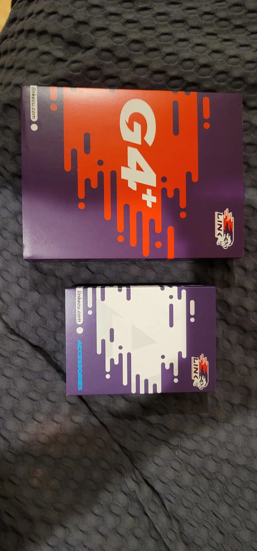

9 days from now I will have a Link G4+ ECU and wide band O2 sensor installed and tuned in the hope of fixing the terrible economy.

I pressume I will see the full extent of what is going on in about 7 days with the new ECU and wideband O2. They said they would like to go over the car quickly before installing the new ECU. If anything is faulty I will know about it soon.

I did not do any of this work myself. Requested the mechanics replace the injectors and trusted they would source an appropriate replacement. Idea behind an ecu and wideband is chasing the economy. I accept it is expensive but better than burning fuel for a car that lacks even a narrowband O2. I accept what you are saying about dodgy workmanship. Fortunately this time my hands were not on the tools. No claims of innocence however.
There's a lot of basics I'd want ticked off before I went to an aftermarket ECU and added a bunch of new variables to a problem situation
Using a Foxwell I70 diagnosis tool. MAP sensor has been replaced. To be fair I did not mention the gradual build up to this point. I think 24L/100km is too much. Especially dealing with an open loop tune, no O2 sensor and this will be a very long term vehicle. I appreciate your knowledge on this. I had been taking the vehicle to mechanics and auto electricians as it may have been something I have missed or simply know nothing about. They came up empty handed and here we are.
I've got no confidence in 80% of Australian mechanics, just because your mechanic did it doesn't mean it's right and doesn't mean they fitted good quality parts. You need to work out what's going on before you throw a $2500 ECU at it.
If it came to us for an aftermarket ECU and tune, nothing would be getting fitted or tuned until it was running well on the stock ECU. The last thing you want to be doing is fighting with parts that aren't working.
Tuning with questionable injectors would be like tuning with a brand new maf that hasn't been calibrated. Very time consuming and tedious.
Fortunately, that is what the mechanic I am sending the car to for an ECU is doing. He wants to sort the car first or at least try and work out the issue before fitting the issue. The mechanic that gave me the car back after the injectors were installed stated "running better than before" but the car was idling roughly. My argument for not taking it back was clearly they do not know what they are doing so I sought more competent help.
