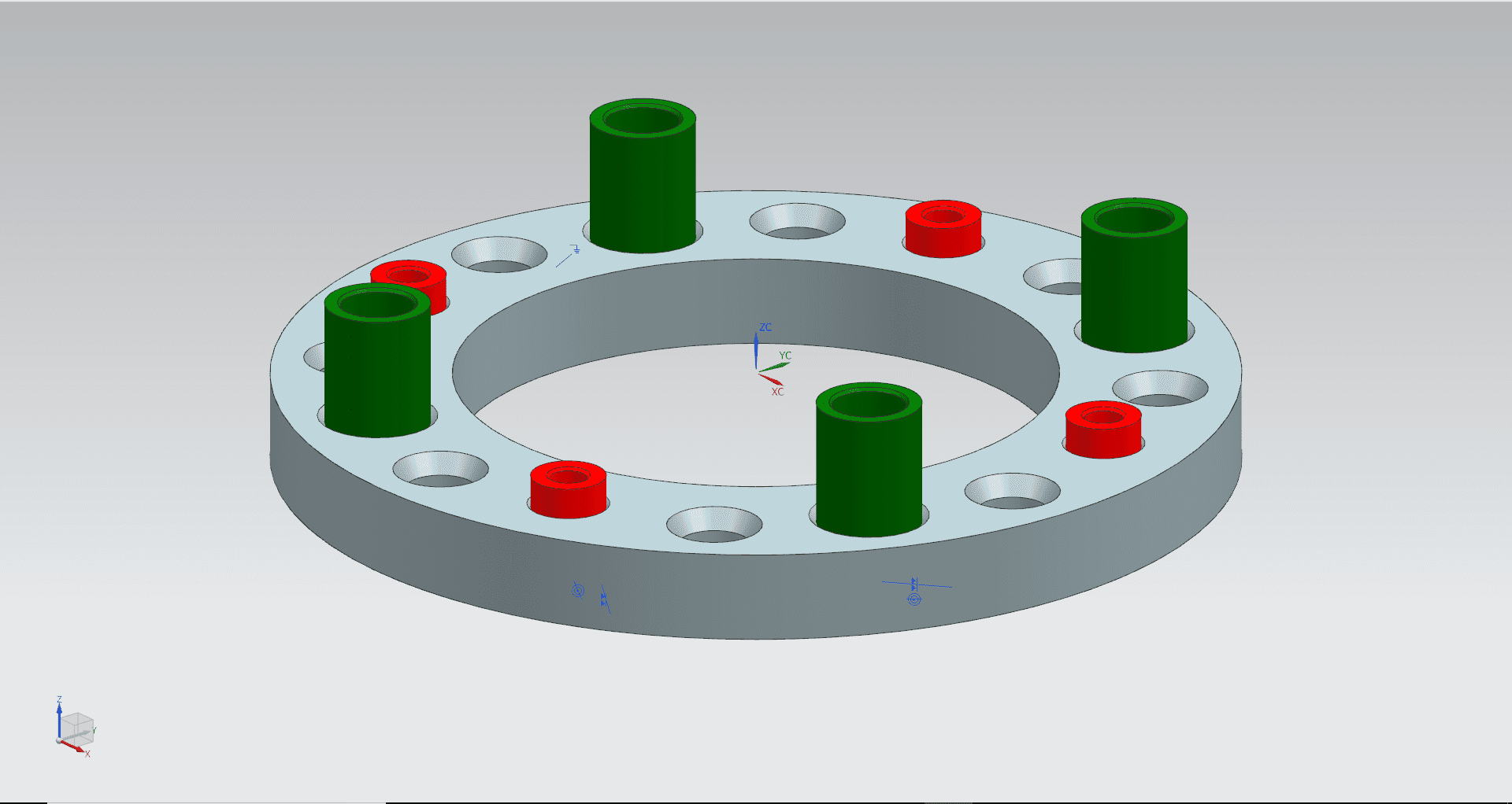

I am seeking an alternative, something that keep the WMS distance stock or close enough that the wheels don't stick past the sheet metal. I am going to attempt to install 2000 F-350 stub shafts along with the corresponding wheel hub assemblies. To combat the problem of the wheel lug pattern I have designed a fixture that should allow me to redrill the hub flange from the Ford to accept the 8x6.5'' pattern that the old dodges use.

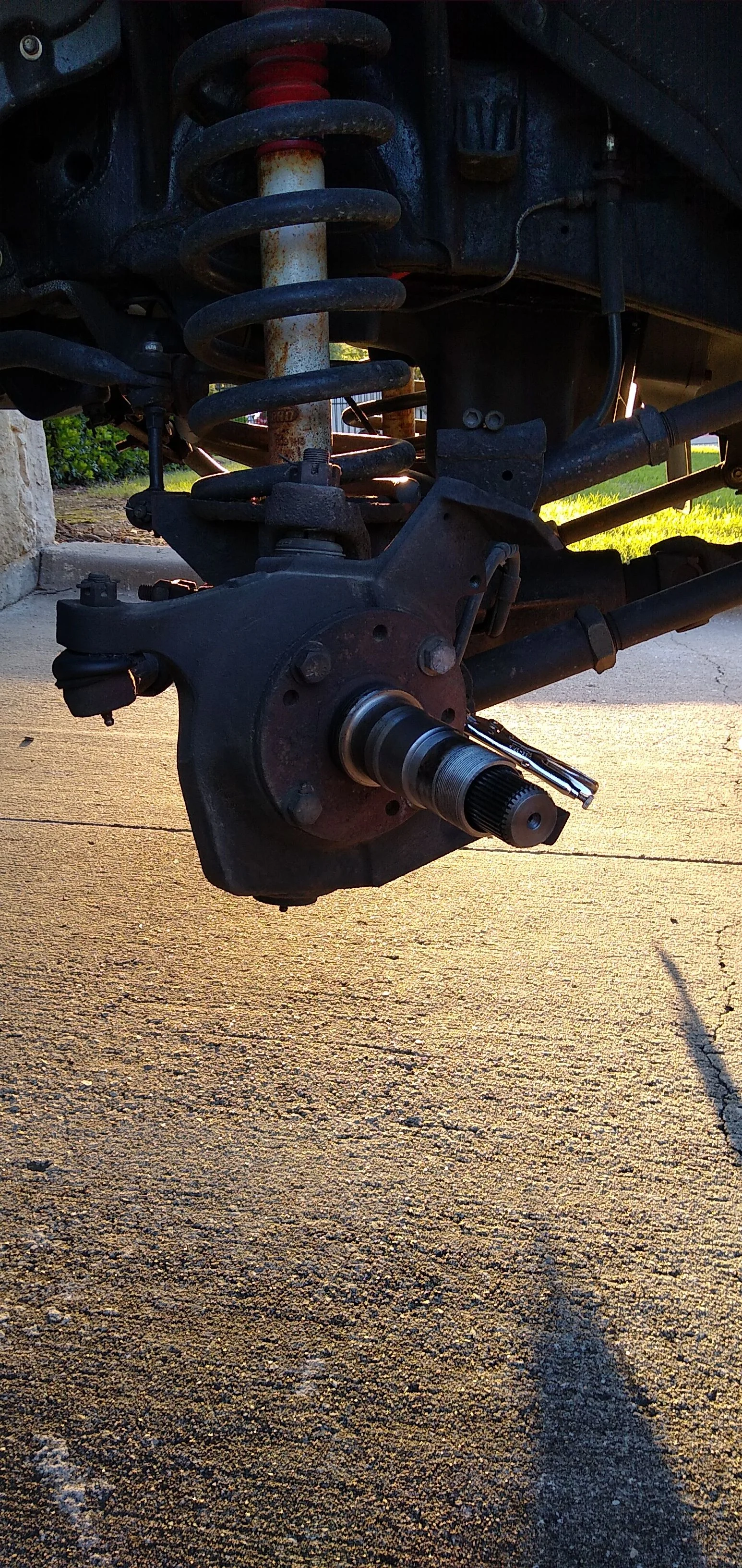

Turns out that the ford unit bearing / stub shaft combo does not work with the dodge knuckles and inner C's. The U-joint alignment is wrong, something will need to be custom in this setup, which makes sense because if there was a bolt together solution for this problem it would for sure be common knowledge at this point.
The following pictures illustrates this problem.
Also the unit bearing flange spacing is incorrect to mount the stock dodge rotor behind as it, just as is done with the dodge unit bearings. I will figure out something to fix this soon.

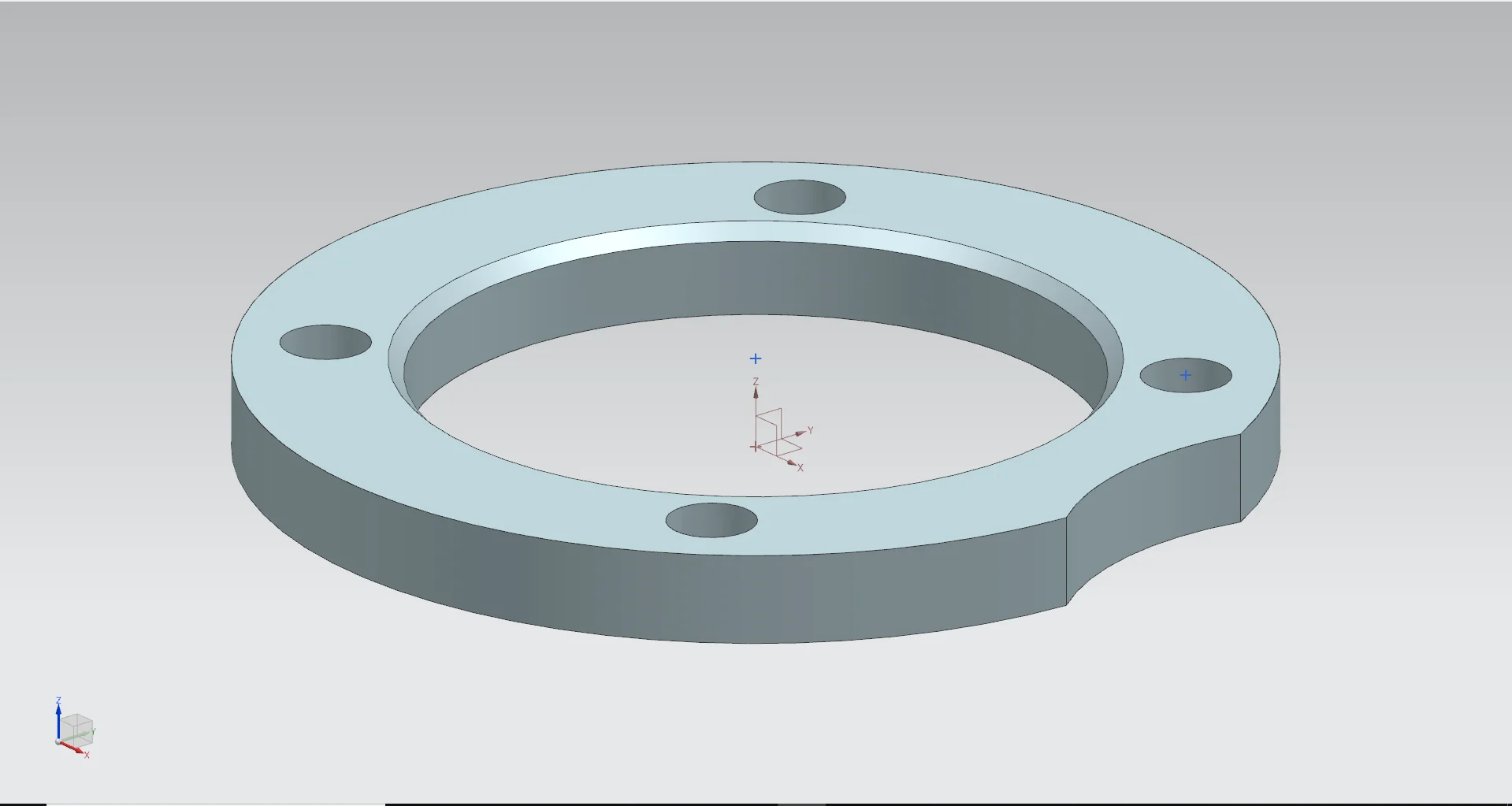

After comparing a stock dodge wheel bearing assembly to that of a 2000 F350 I have determined that the Ford unit needs to be spaced away from the Dodge Knuckle by approx 0.605 inches.
The reverse engineering process is a little tedious, but with a good pair of measuring calipers it is not super hard. I like to draw sketches on large graph paper and verify measurements to avoid mistakes.
I did a little measuring this afternoon with my center finder calipers and came up with these part, side specific. Pictured below is the spacer for the LHS.
The other side is just a mirrored image of this part.
Once I get the ford hub mounted up, I should be able to determine how much material needs to be taken off the ford stub shaft to put the u-joint in the correct spot.
