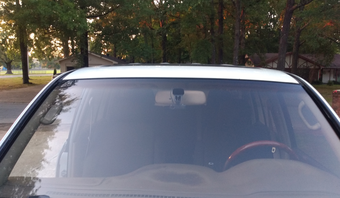

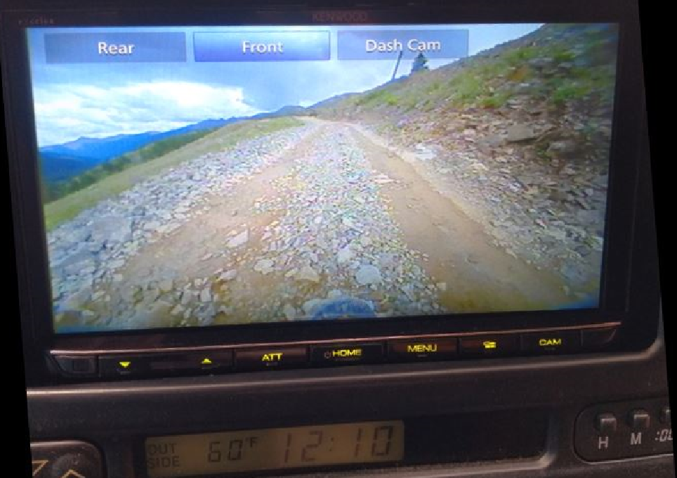

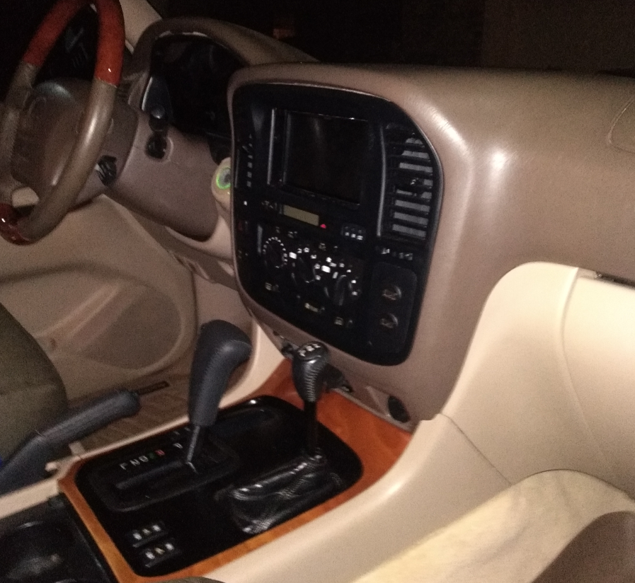

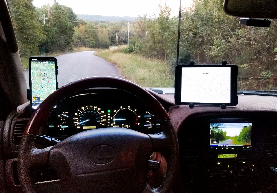

Very nice setup!Same here. I simplified the climate controls while advancing sound system technology to be more state of the art with 3 cameras.
Front cam is a trail cam looking down through from the front bumper on Black Bear Pass.
Plenty of navigation tools that stay up to date.
The dash cam wakes up and records people if they come around the front of the vehicle.
