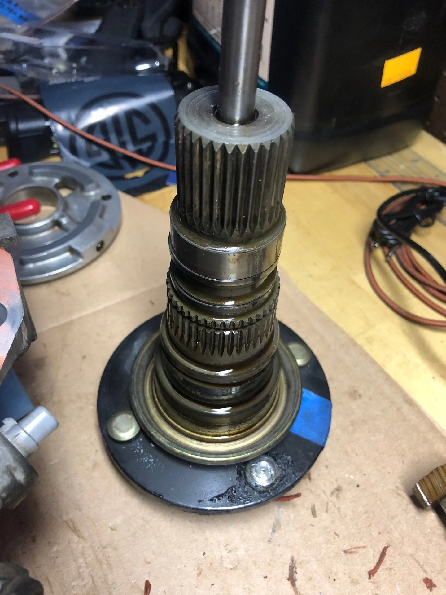

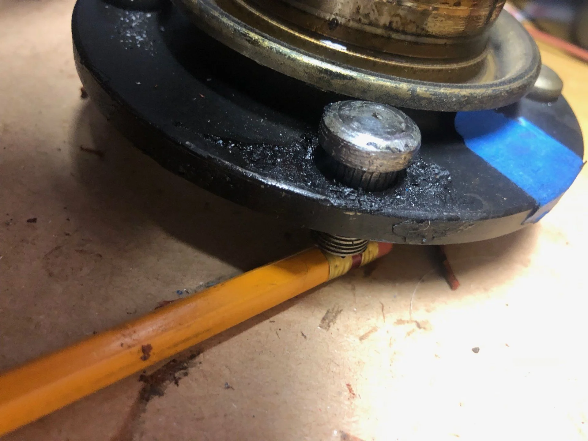

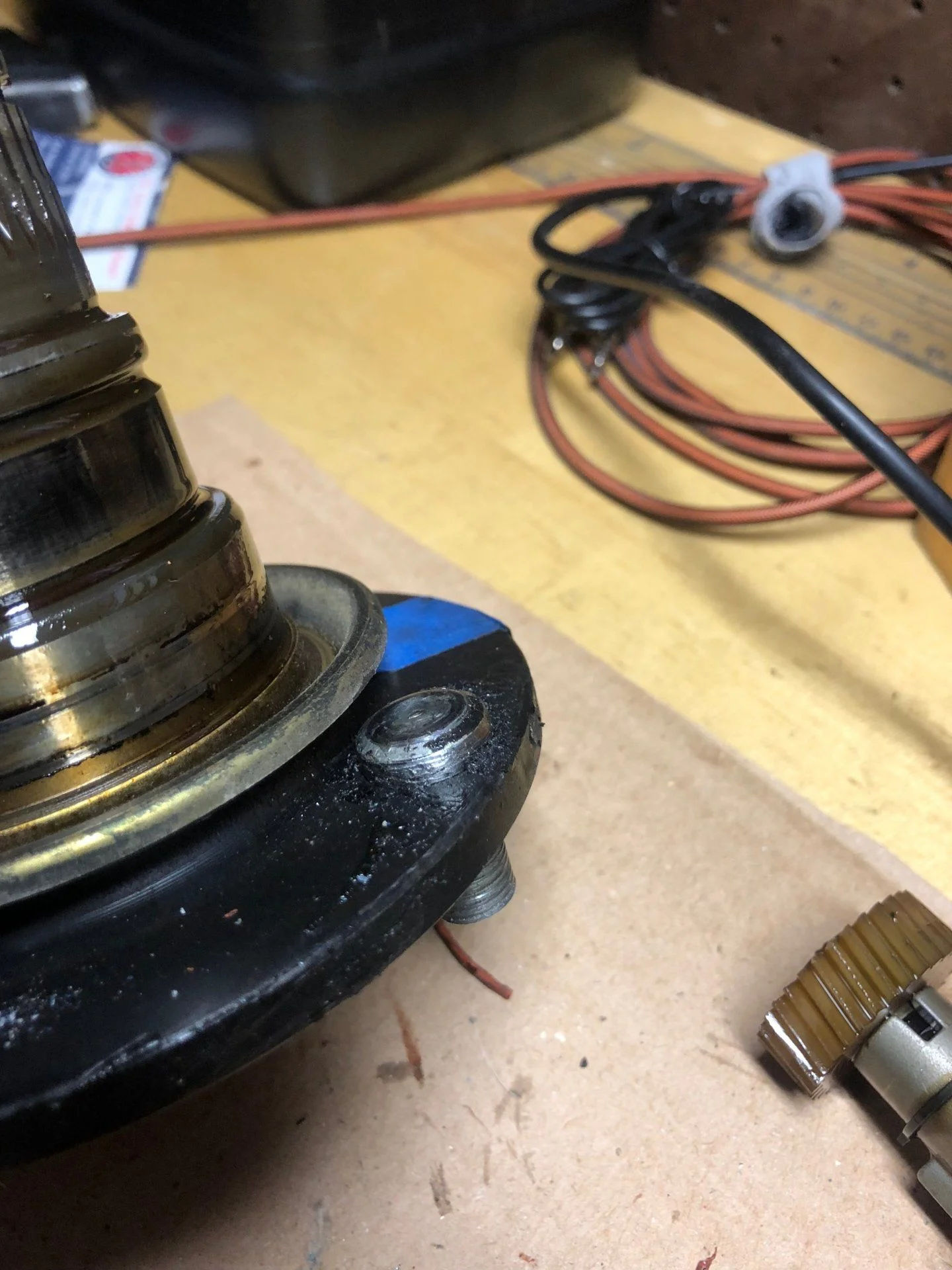

I've been using nissanrh's thread as my guide (thank you again for that writeup!) Transfer case rear output shaft oil seal and bearing removal and installation , all because some work the PO had done was shoddy and I'm determined to fix it RIGHT. BLUF: like the title says, a stud is stripped in the output flange and now that I've removed the output shaft I see that those studs are CAPTIVE by way of another flange behind the stud heads (see photos). Does anyone know 1. a non-destructive workaround or 2. what the part number is for this ENTIRE OUTPUT SHAFT ASSY? In retrospect, no wonder the shop that had originally stripped the stud said "screw it!" (or the PO did) and tried to JB Weld the (stripped) splined head in place on the flange.

I have not gone down this road. But doesn't the dust deflector/flange (33325-60090) just pry off at this point?
The shaft sub-assembly (36202-60040) is pretty pricey (>$500 online).
Yes, looks like you have to get a new dust shield and seal, and pry the old one off.

Couldn't you (or someone) just weld it down onto the flange? at this point, that seems easier than sourcing a new output or stud. Just line up the flange w/ the driveshaft so it is welded correctly.

I considered taking a grinding wheel and removing the dust cover/flange in just that spot to press a new stud in (I had to cut the previous one IOT remove the driveshaft--the nut was halfway on, seized, and the stud would spin even though it had been gooped-up with JB Weld by the previous guy who'd worked on it), but figured the dust shield was actually functional since the seal was in good shape after 276K on the clock. I also considered purchasing an entire TC off a parted-out vehicle, putting in the soon-to-be-discontinued Marlin Crawler gear set, and then just swapping the TC when I was done. But again, how much time & effort was this going to end up being, simply because the previous clown was too cheap to pay for a proper repair, or the shop he used was shady AF? I'm sure he was quoted a similar $500 + labor amount to replace that flange, so he probably deferred and I can't totally say I blame him. But...in order to get it at least *RIGHT*, I felt I needed to get back to some semblance of a baseline repair before doing more upgrades.
So I have time, and I have *some* money, but neither in infinite amounts. I could drive to hell and back to search parts yards etc. I like the idea from DTCsk8er about welding it in place, but like I said that stud was stubby now since i had to cut it. So that was out.
