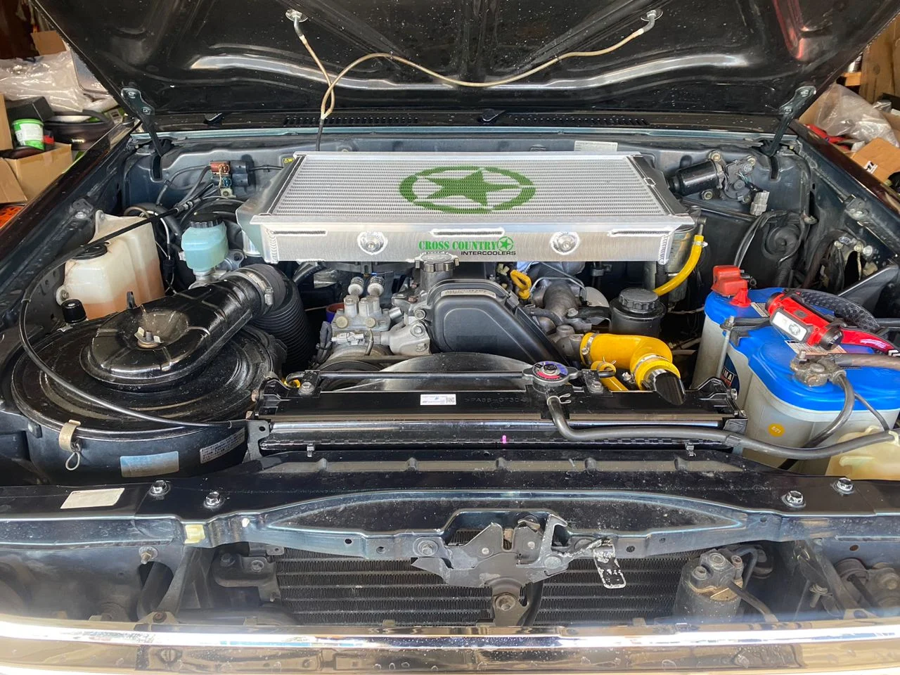

@Tsvigo is that an air, to air or water? Did you need to scoop the hood or did it fit flush on top of engine? I am currently planning my IC install. Thanks
Air to air, no it does not sit flush. Will be sitting higher than standard Prado body. Then I would be recommending doing a front mount intercooler is better.

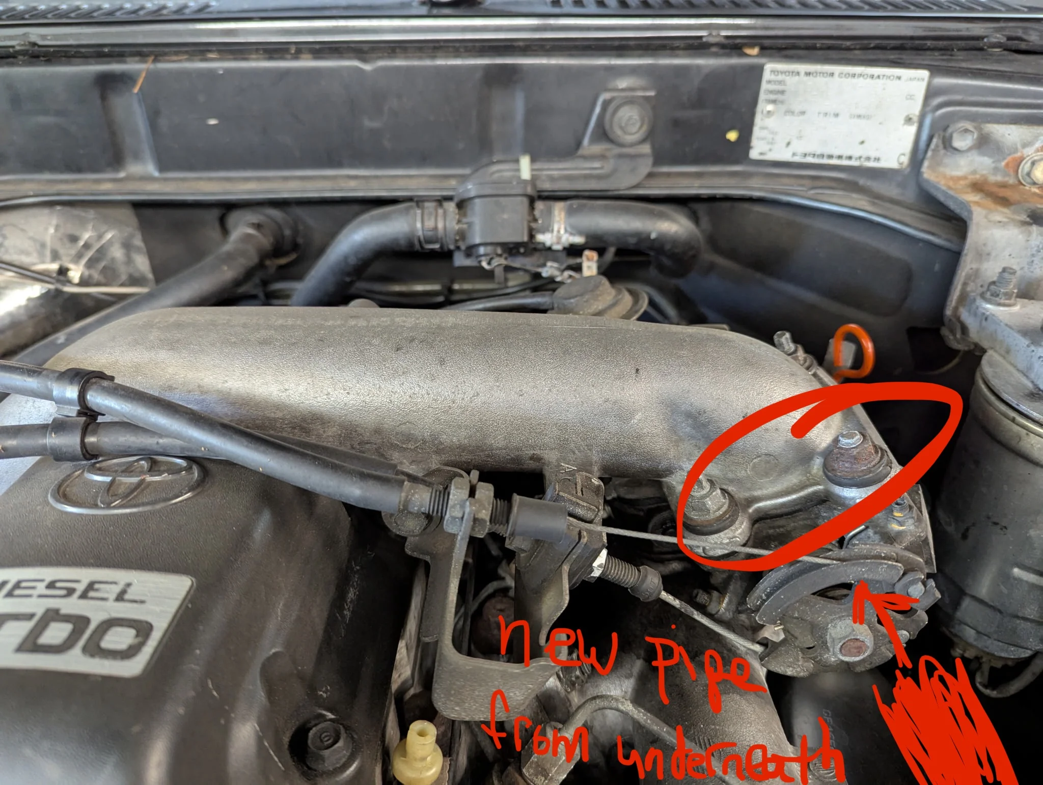

Hey gang, installing an intercooler on the KZJ78 this week! Question for all of you who have done this before: the right side of the “air horn” (metal pipe pictured horizontally across) faces down. This means that the intercooler pipe coming up from the underneath-right side doesnt line up to the intake because its opening face up (as circled in the pic).
How have you solved this? Is there a part you have bought so the opening faces down?
Thanks!
Thanks!
Rubber grommet pressing the crossover flange
