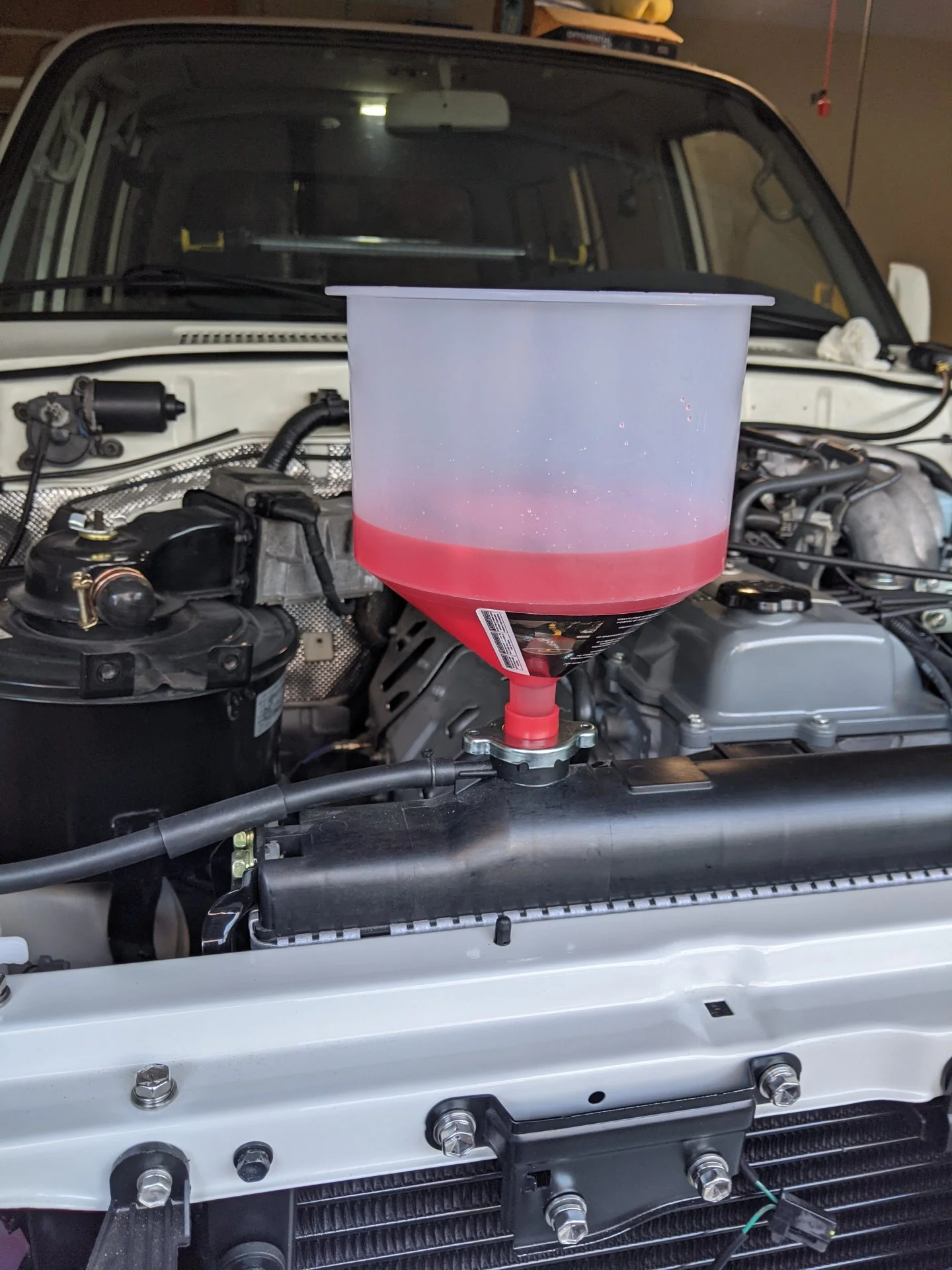

I picked this up a few months back to restore for daily driver. I have owned fj40s for 30+ years.
Finally got wife projects to a point to start doing long term maintenance. I have pink milkshake in the cooling system. Found while pulling original radiator for future replacement. Going to do water pump and gaskets and seal on from of engine while the radiator is out of the way.
Questions
Flushing transmission instructions and should I replace transmission cooler while I'm at it, I tend to think I should.
ThanksEric

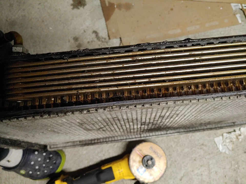

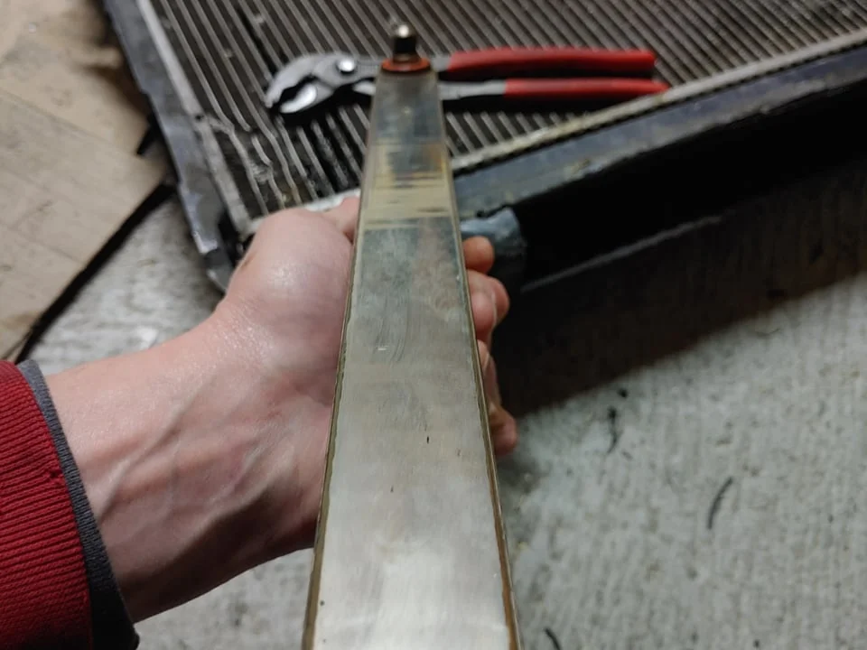

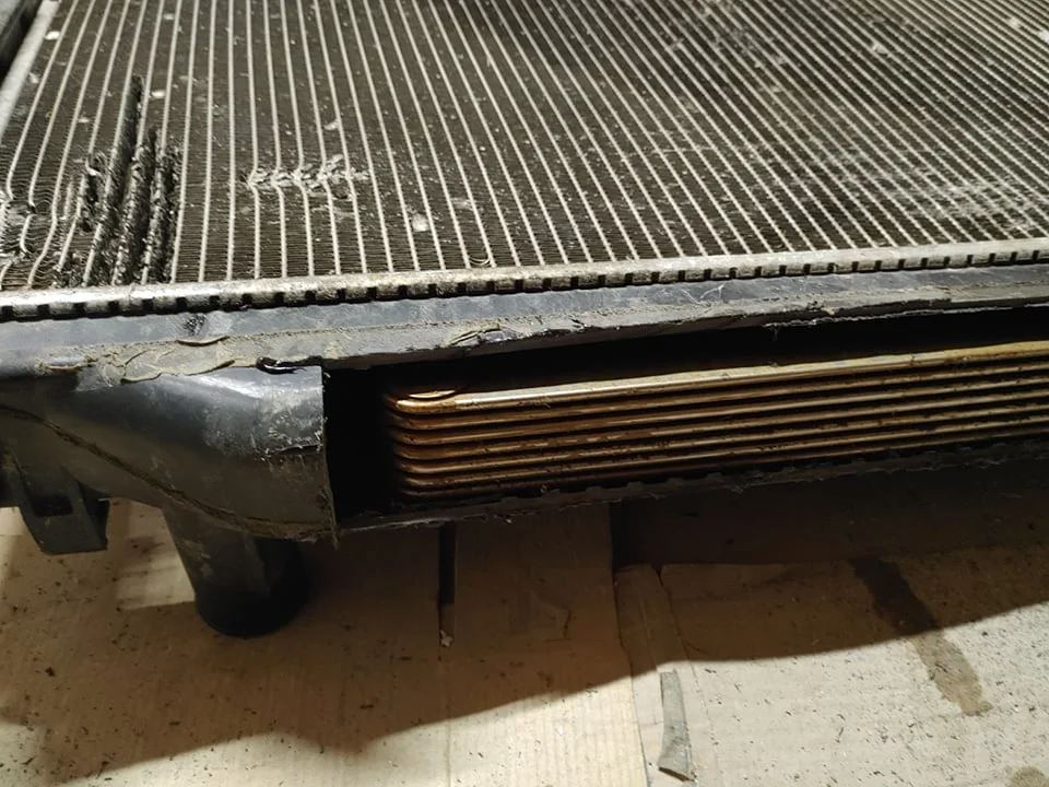

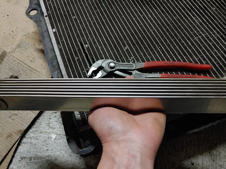

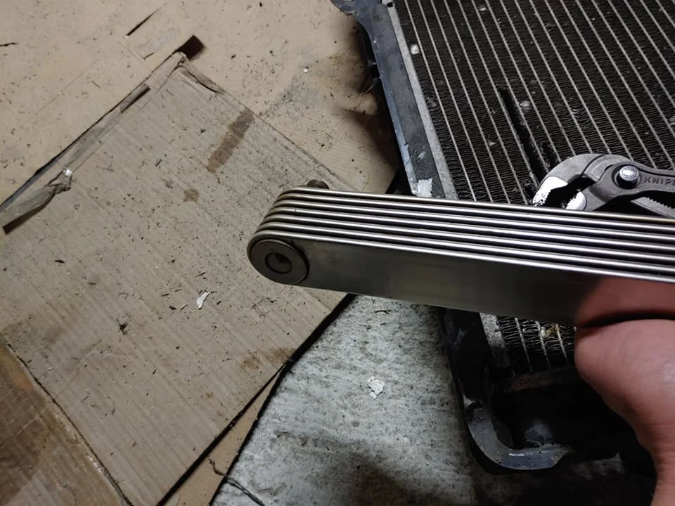

I thought that was from trans fluid mixing with coolant from the radiator.
in which point(place) could the confusion occur?
It’s common on basically all Toyota 4x4s if the plastic radiator with AT cooler in the bottom isn’t changed every 100k miles or so…
imo theres no way, cause plastic part on bottom of radiator is only cover and directly here is flowing coolant. Got similary problem, with latte milky under radiator cap, did new thread few days ago...one member told me, that coolant could mix with atf due to impact to my radiator ...it was good lead so decided to check it out. I thought that both parts( 1 with coolant, and 2nd with at oil) work similiary but no. Upper part where coolant moving is s*** made with aluminum prone, to damage from little impact, corrosion, oxidation and weak accids, but AT cooler is really heavy duty made. Check pics bellow, it is dissasembled old radiator (~250k miles). Its look like high quality steel with nickel coat? Theres no corrosion(just sediment). Horizontal pipes are 5mm thick. Will try soon to put this oil cooler in metal bucket with water to -15*C, i think it will not be damaged by freez. Only directly,heavy impact can damage this cooler.

That's pretty cool, and not what I was expecting. I've just assumed the lower rows in the radiator were isolated to the ATF, but that clearly isn't the case. At least in this radiator. I had a 2005 Honda Pilot and that generation of Pilot/Odyssey were notorious for this failure. It was a fault in manufacturing where the OEM use some steel washers when they pressed in an aluminum ATF hose port into the aluminum radiator body. The dissimilar metals corroded and eventually you would have leaking between the two systems, and lots of owners suffered from it. If you were in a salty climate/cold climate the corrosion was accellerated causing the earliest failures.
