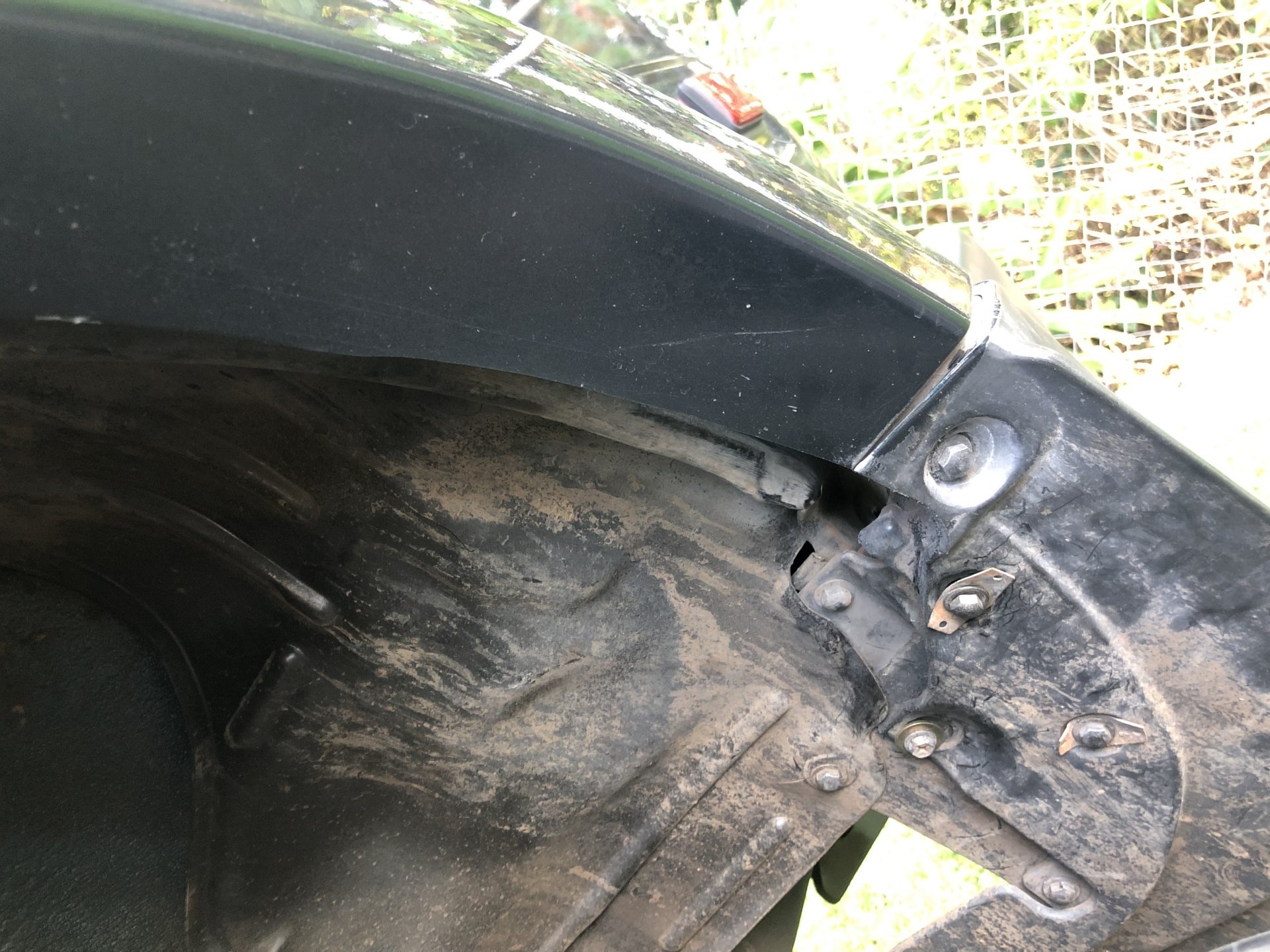

went out to the normal spot today. Did some flexing to kind of mark off what needs to be trimmed. Any one with suggestions on what to cut the fiberglass flares with? There’s a small triangular section I need to cut. I have an angle grinder with cut wheel but it seems kind of overkill. I really like the factory mud flaps and as much as possible want to keep them.

I have a nice dremel kit if you need it.
Took it to a shop to do the cut. Only $40 for both sides. For me totally worth it. We’ll see if it’s enough though!
either trim them, or learn to remove them before wheeling. They are not very sturdily attached.
I tore one off the very first time my current cruiser saw dirt. Trimmed them significantly, and lost another this past week while reversing. It got pinned between tire and a tree.
