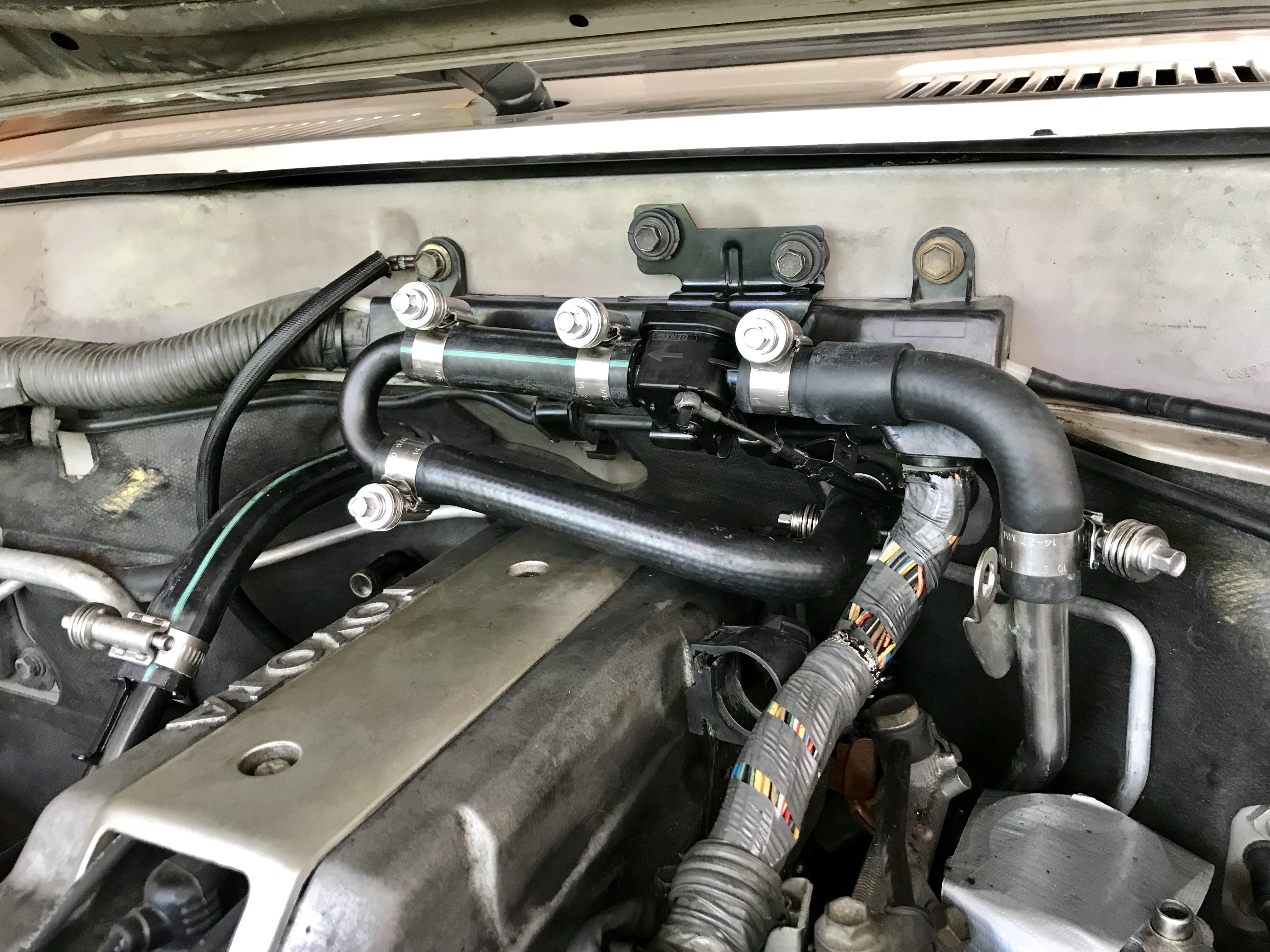

Then I replaced the heater valve, finished the firewall heater hoses, and bypassed the rear heater.
