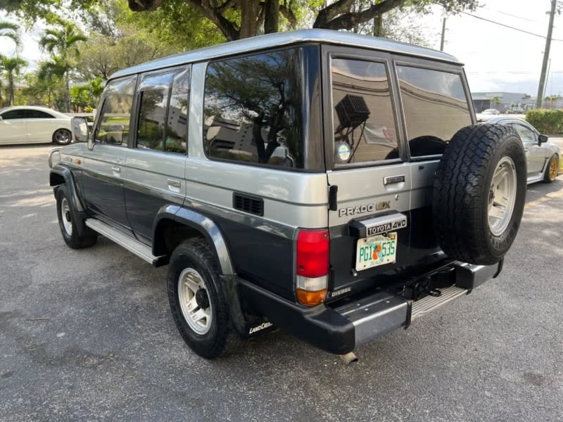

Hello guys,
Obviously, I'm new here and with LC too, but I came across this "JDM" 92 LC Prado at a local dealer here in South Florida.
I'm thinking of buying it, but I would like to have an idea of what am I getting into before doing it.
Any advice is very well appreciated.
