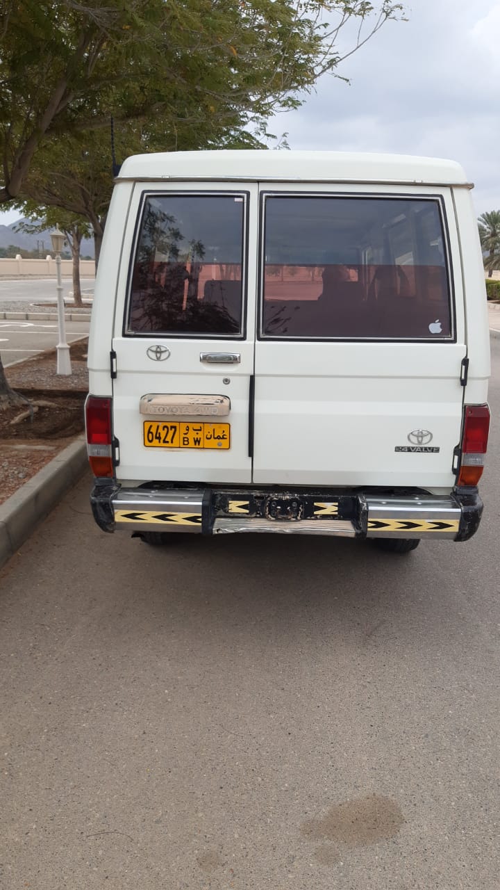

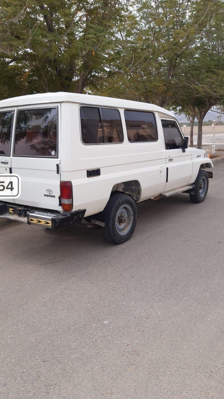

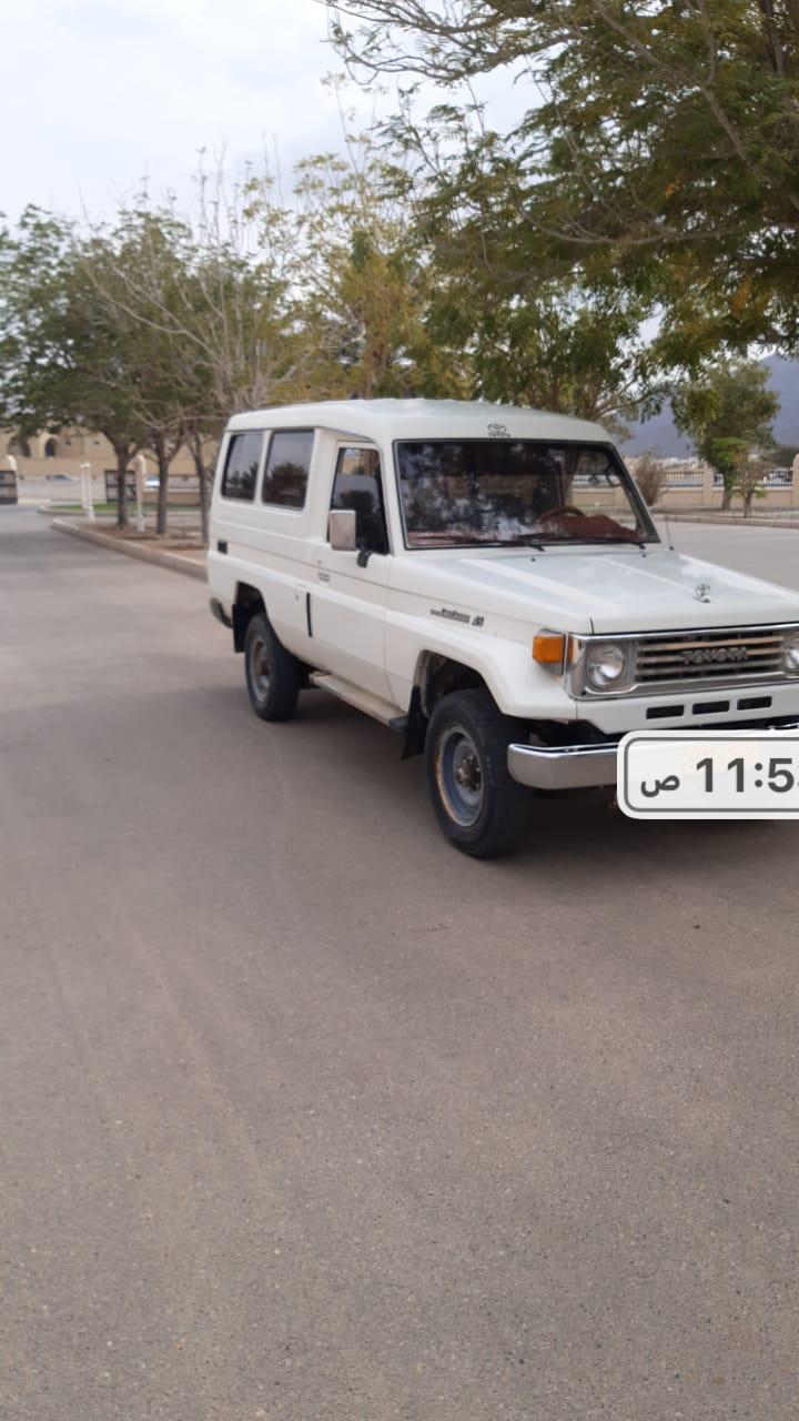

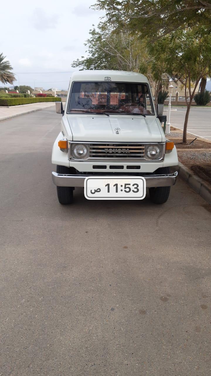

It presented as a typical sample of an Omani truck. It's been repainted. It's been kept running. It's a former school bus. The government has recently put a maximum age on vehicles used as school buses as well as some safety requirements... so a lot of these long-time school bus Troopy's are finding their way to market. I expressed some interest, enough to get a few more photos.
It's a 1FZ, 5-speed, AC-only truck. Odometer reading could have been rolled back... but also might not have. The typical buyers of these really isn't looking at the odometer much, so not a big motivation to roll back. Nonetheless, it does happen. We'll see what compression numbers tell me...

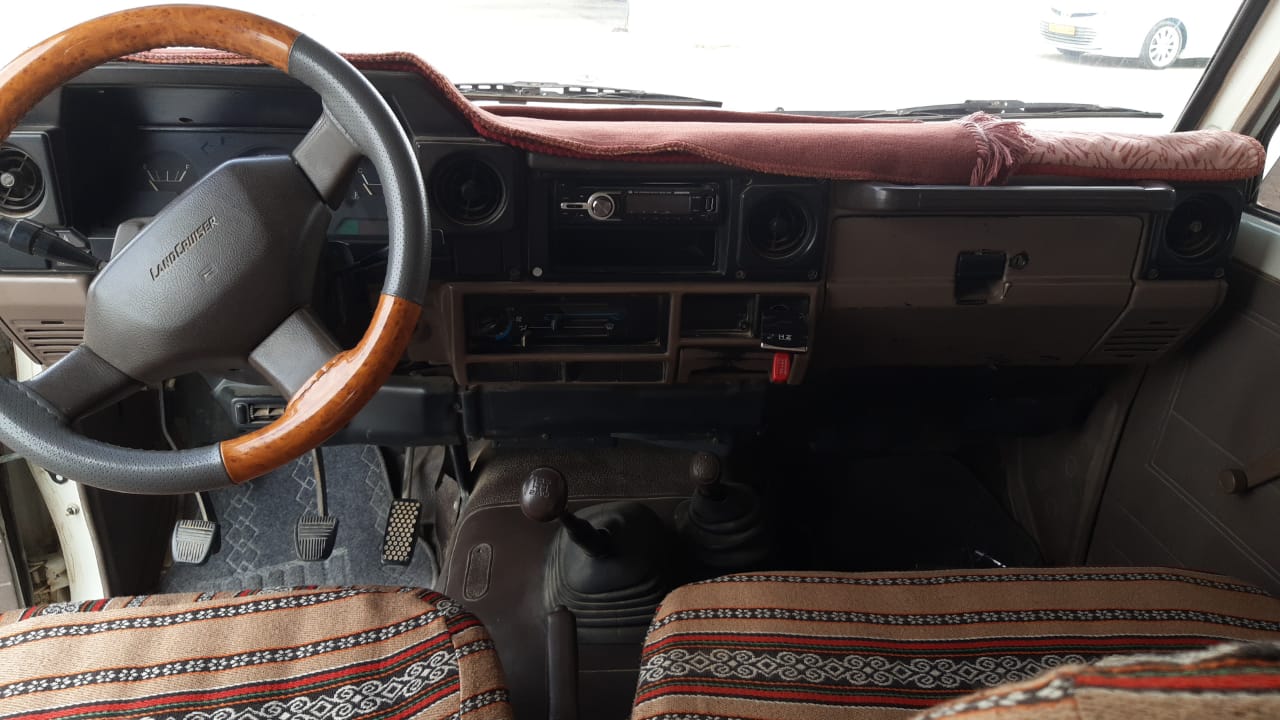

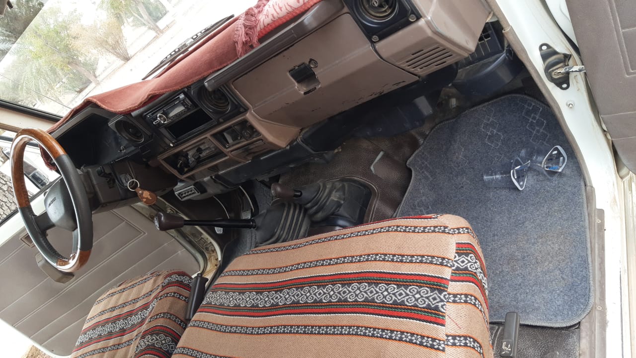

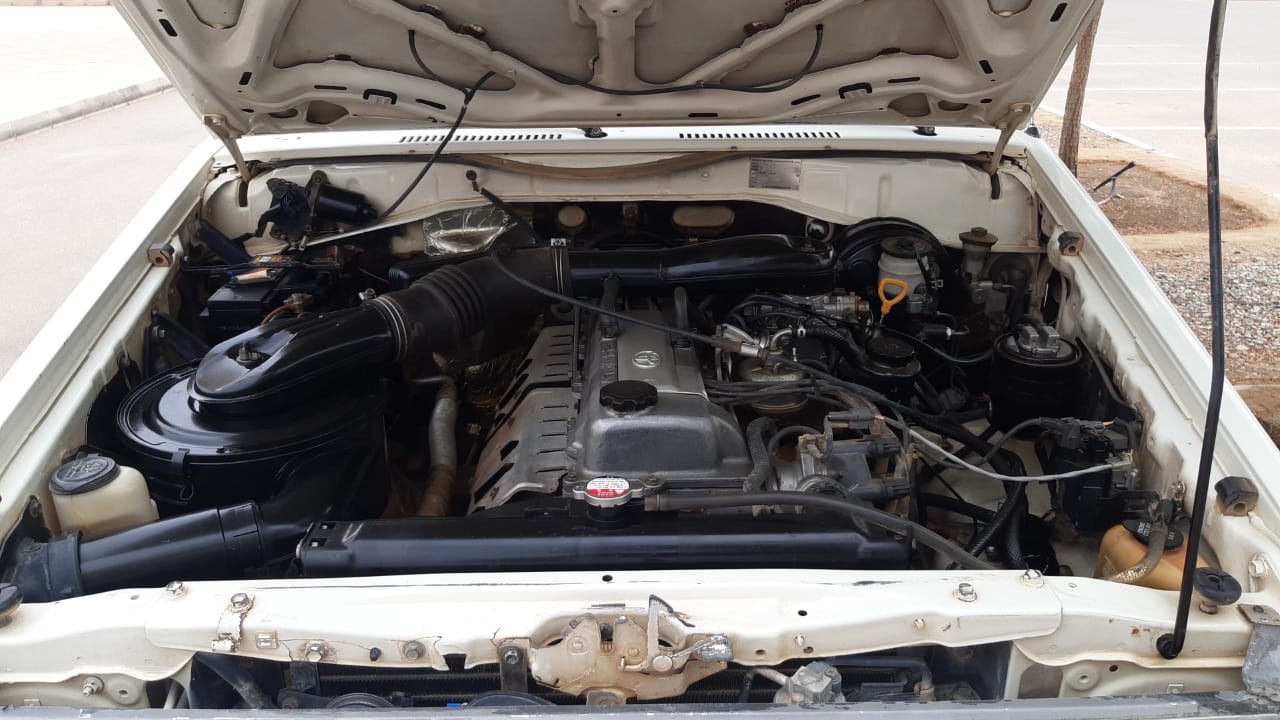

Engine bay shows a new radiator and new carb, likely both Chinesium.

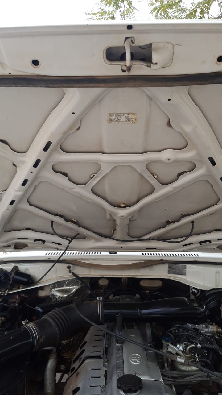

Hood has come apart from the brace, typical for the age.

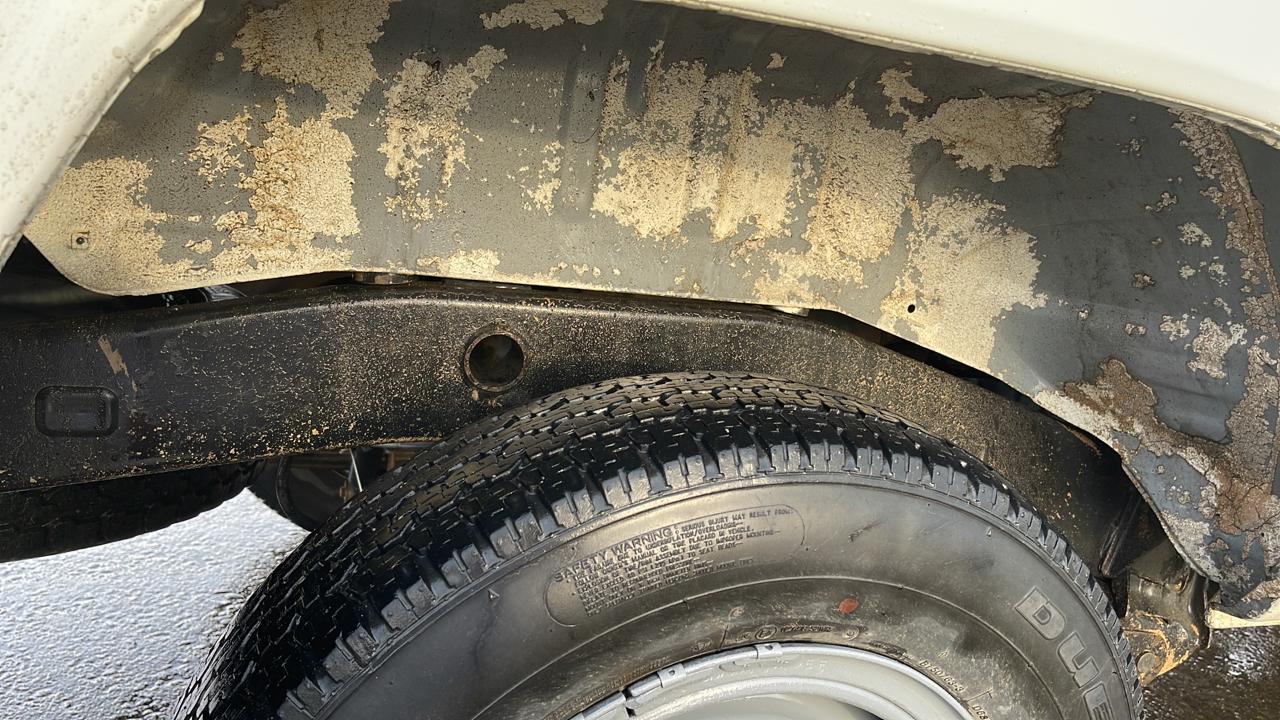

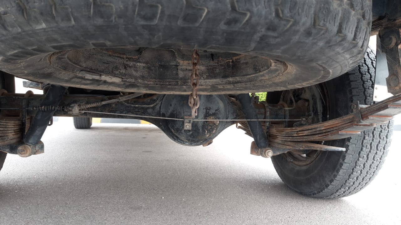

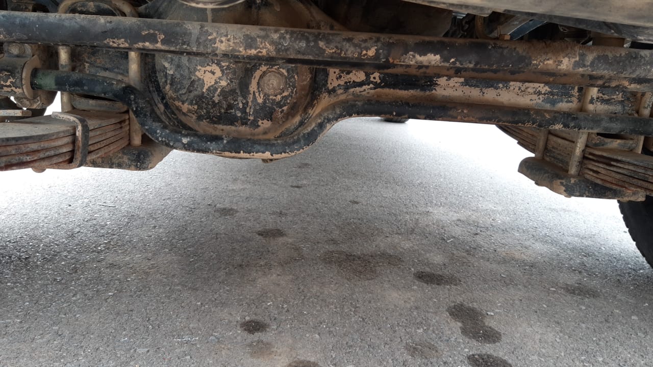

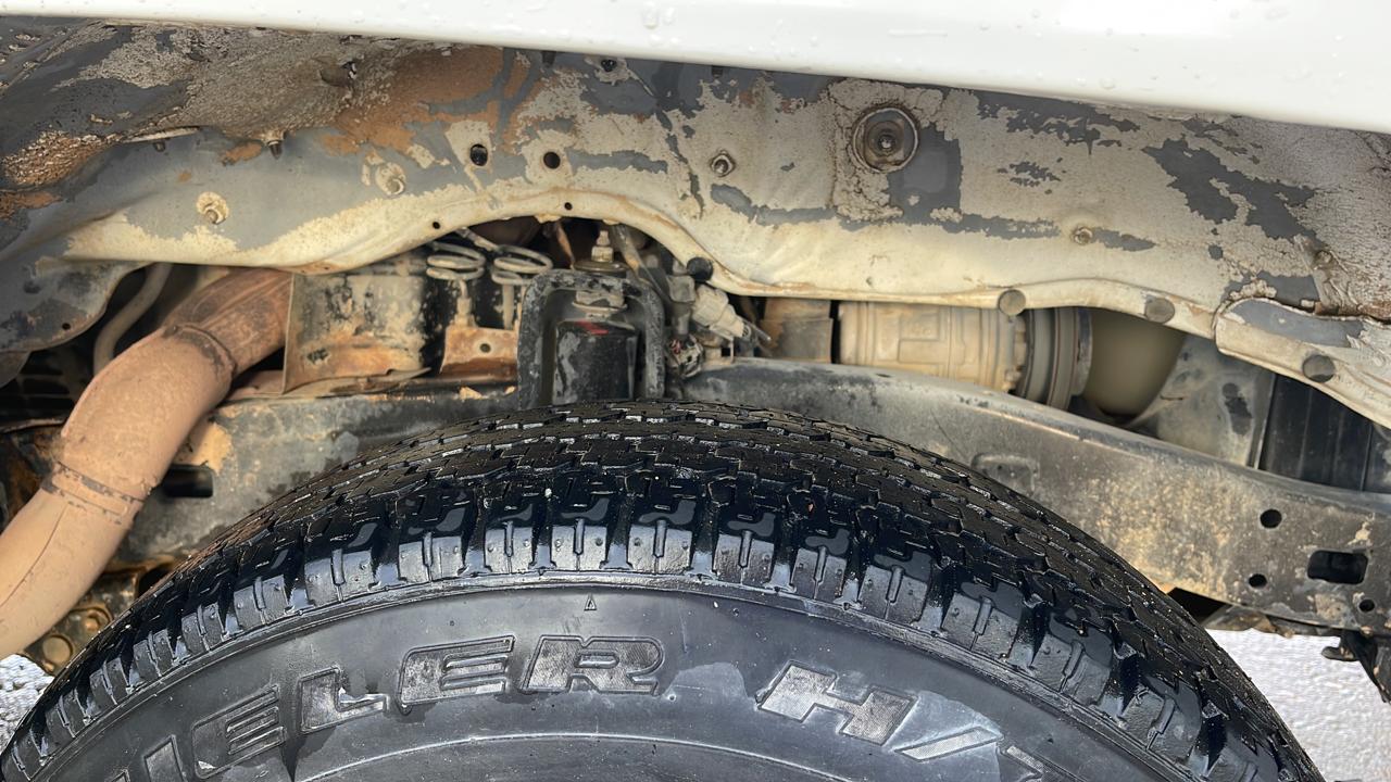

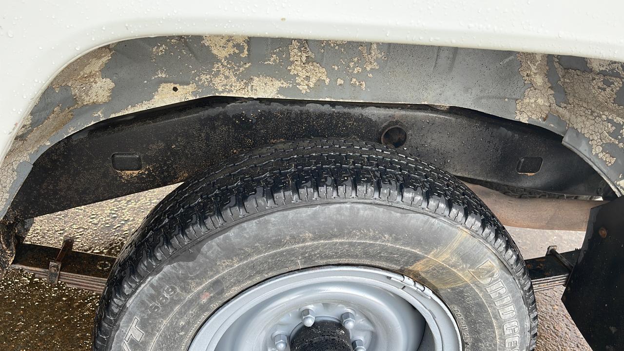

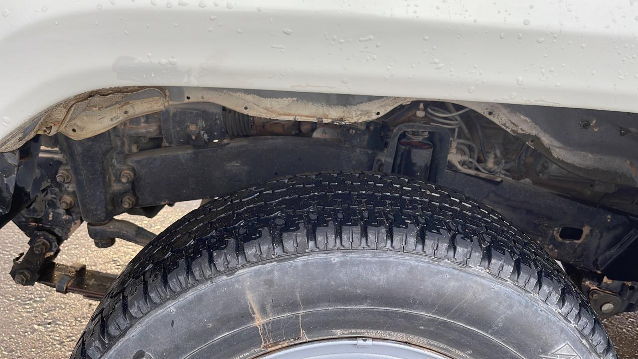

Underside and wheel wells. Everything checked out for a non-coastal truck. Typical caking of fesh-fesh. Typical lack of rust for the arid mountainous areas these often saw service.

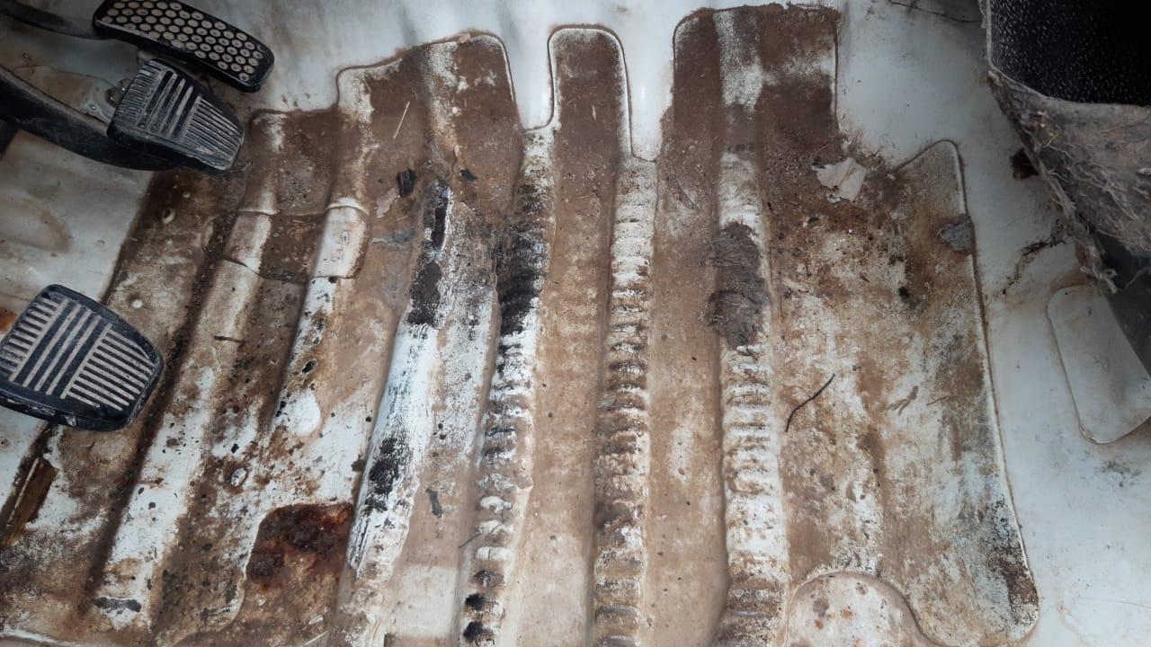

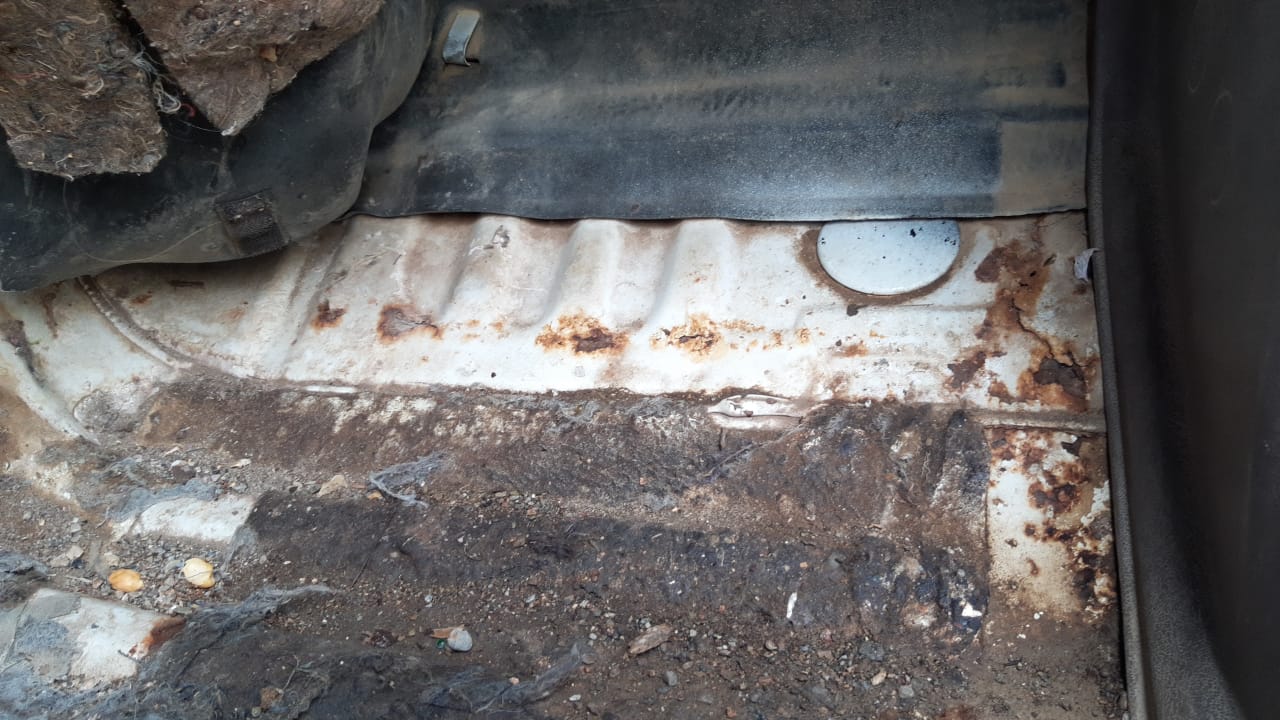

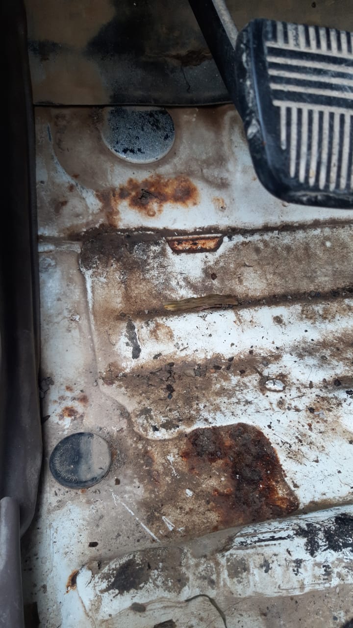

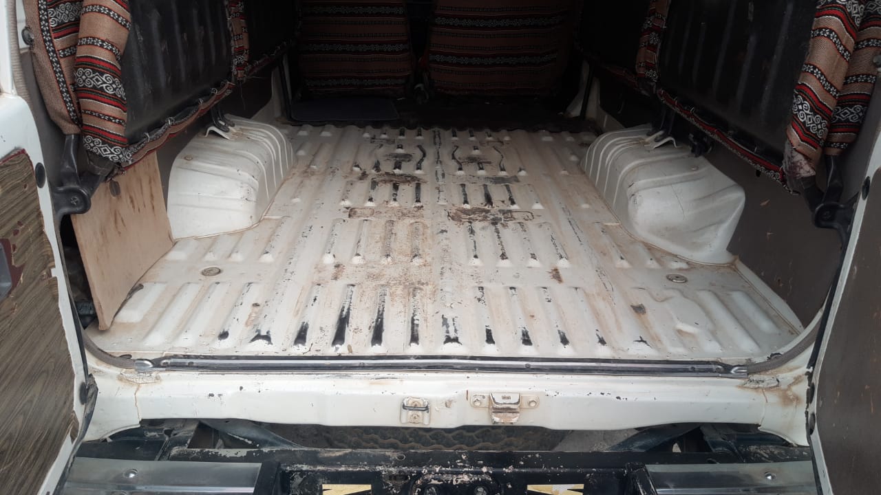

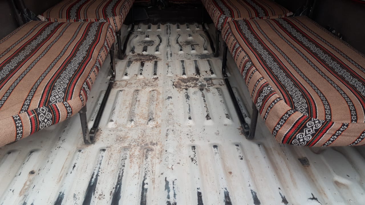

The biggest concern I have with Troopy's out of Oman... the rear floor. They often get Swiss-cheesed with rivets and screws from putting in diamond plate material... or they get pruned by repeated loading/unloading of personnel and equipment over and over. I'm also concerned about rust in the front foot wells. Pretty typical for 70-series of this age no matter the location/climate. For me it's a matter of how severe. @SNLC has really gone in depth on his builds which have helped me hone my pickiness on this issue.
Once I got the pics I wanted it seemed this was a good Troopy to move on.

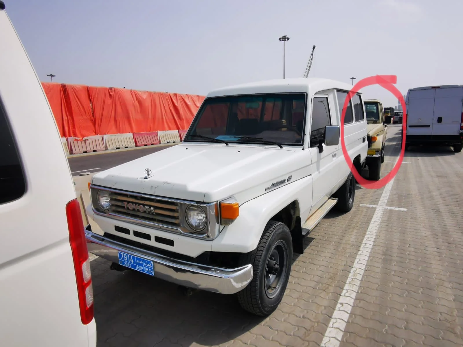

So I bought it in February... and it was scheduled to ship in March and that vessel canceled it's port call to Oman. So I've been waiting and we finally got another vessel lined up. Export work has been done and the truck will be loaded up on July 2.

Here she is in line at the port waiting to load on to the RORO vessel.
If my latest shipment of restored trucks is any indication... I won't see this truck until sometime in October.
