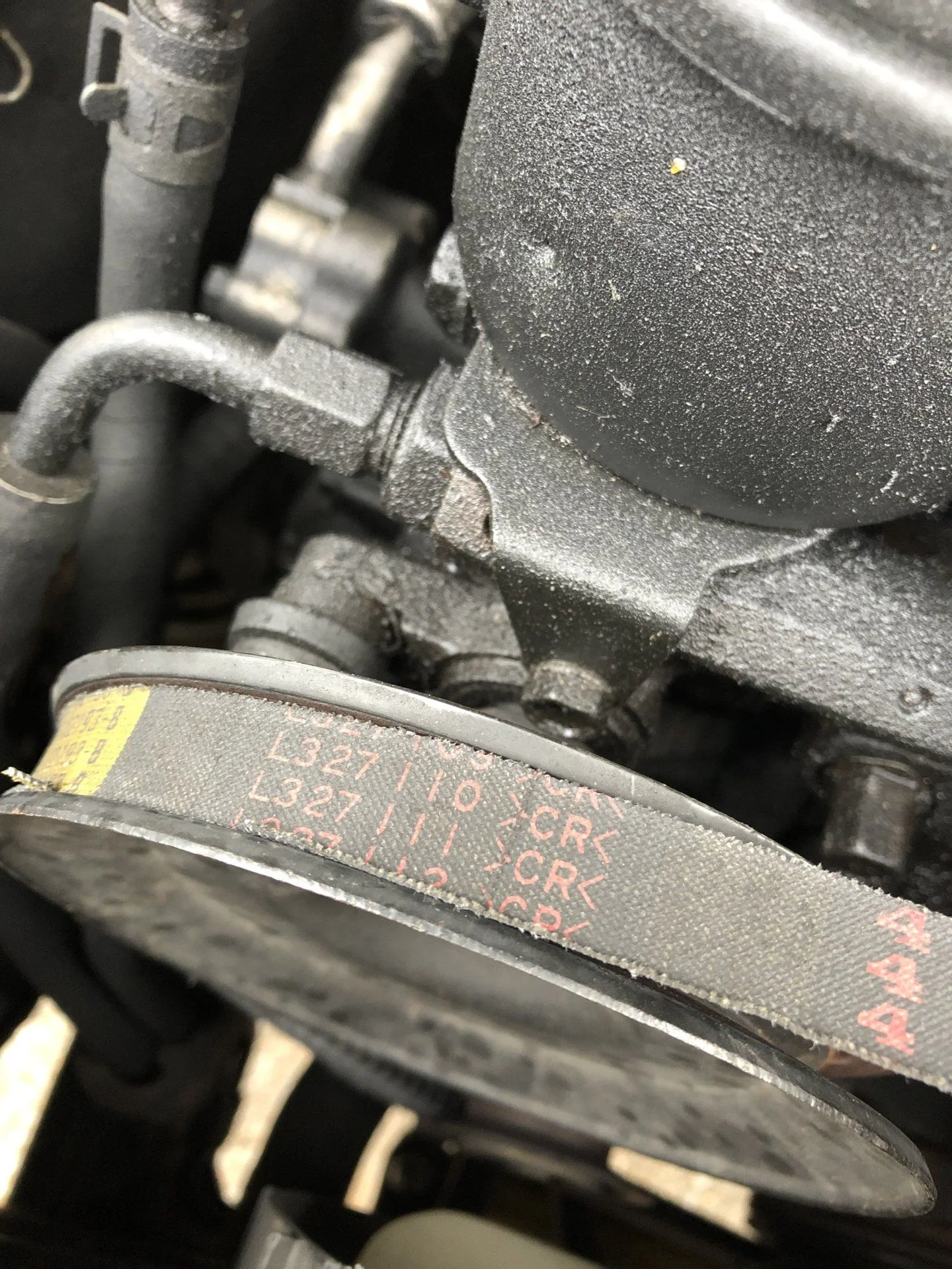

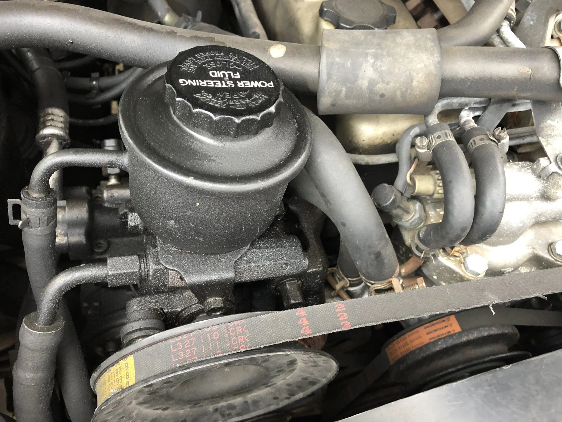

Hey fellas - I've got a significantly loose PS belt (at least for starters) causing hard and notchy steering especially at lower RPMs.
1991, FJ80, 3FE
I replaced the belt (along with the other two and the water pump and that pulley that rattles) probably 10K miles ago with new OEM. Steering fluid has leaked for a while, probably because pump and lines are original, just been adding fluid till I got around to replacing all the lines and rebuilding the pump, then the tranny happened.
Quite a bit of time has passed due to that transmission odyssey, but when I finally got her back, she was way low on steering fluid and it took well over a quart to get her back to full. And the belt seems loose in a way that I'm not sure I can tighten.
The main idler pulley for the PS belt looks to be adjusted all the way tight (toward the passenger side).
I gently coaxed the PS pump to the top of the adjustment range with a pry bar.
The alternator belt seems tight enough that I don't want to crank on the alternator too much to try to take up the slack.

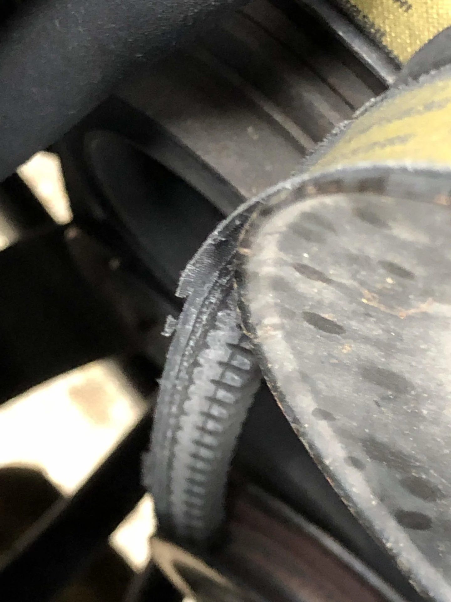

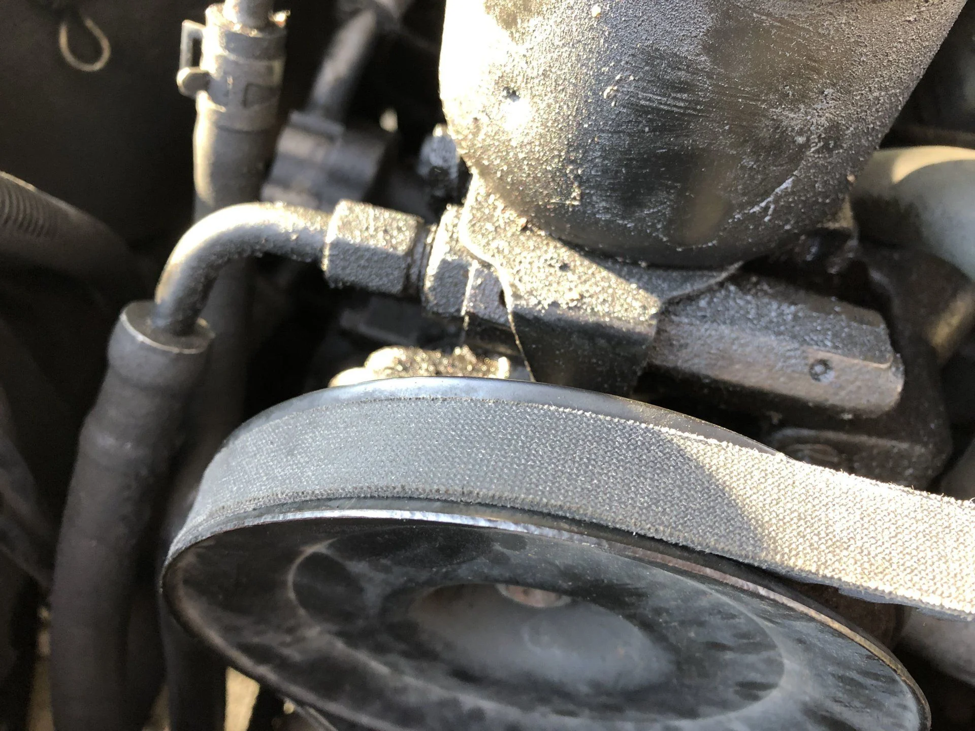

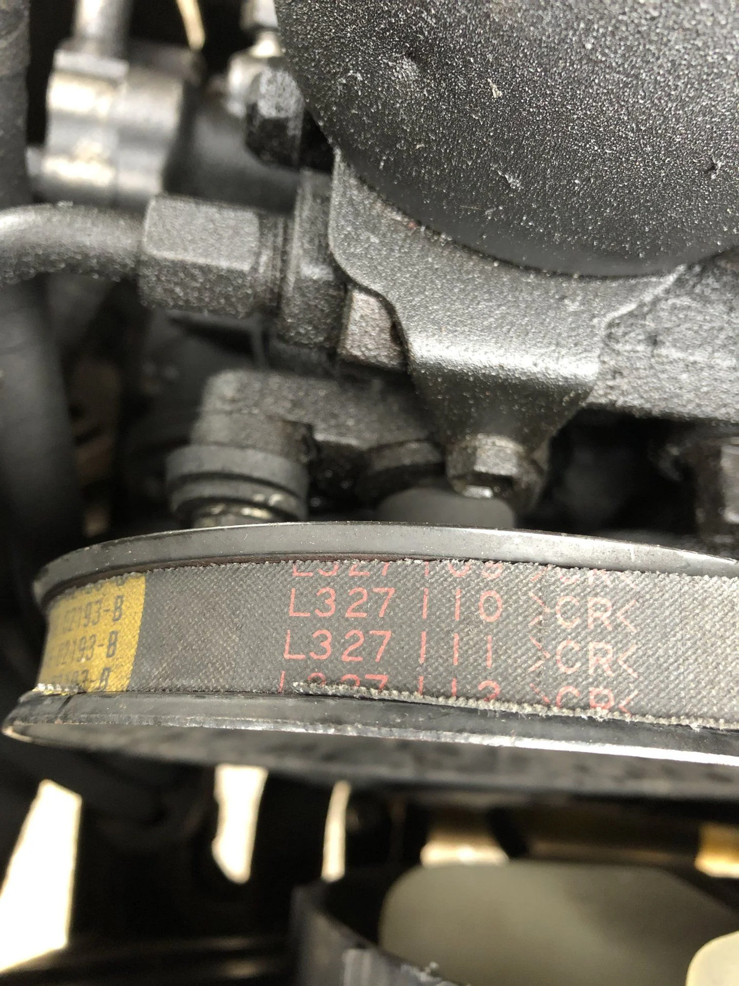

But what I noticed is that the edges of the belt seem a bit frayed and the belt seems to be riding low in the pulleys. To my eye anyway.
There's also about 1/4" of fore/aft play in the PS Pump shaft when I pull on the pulley. Not sure if that's OK. If anyone wants a more precise measurement of the movement, let me know, I'll get it.
Can you guys take a look at the pics and let me know if you think maybe the pulleys are worn, the belt is worn, or I might have another issue? Thanks!
