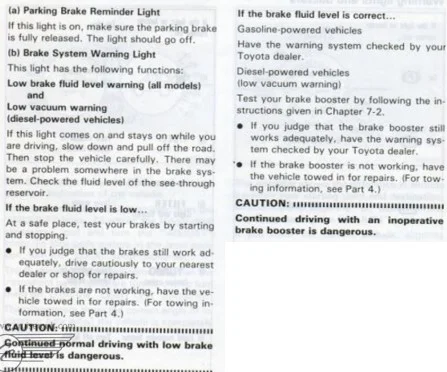

Man if I could read I would be very upset right now
I am not sure if I understand what you meant exactly, but if the photo provided was too blurry, my apologies. It was just a snapshot from the big file on cruiser cult site.
It is a joke that implies I cannot read, hence I was driving with my parking brake light on with a gasoline engine and my brake booster was bad (despite it saying it is very dangerous to do so).
No wonder my brakes have sucked for a while.
Appreciate you very much putting this on this page, should answer OP's question!
Maybe it is me that needs reading lessons. Haha.
I find that the owners manual does answers a lot of basic questions but some of the answers are pretty ambiguous too.
Hello,
At first sight, your image looks blurry.
On a closer look, the text is readable.
You may want to magnify it (using your browser's Magnify Image function or an equivalent tool) to make it even more readable.
There is no problem with reading it.
Juan
