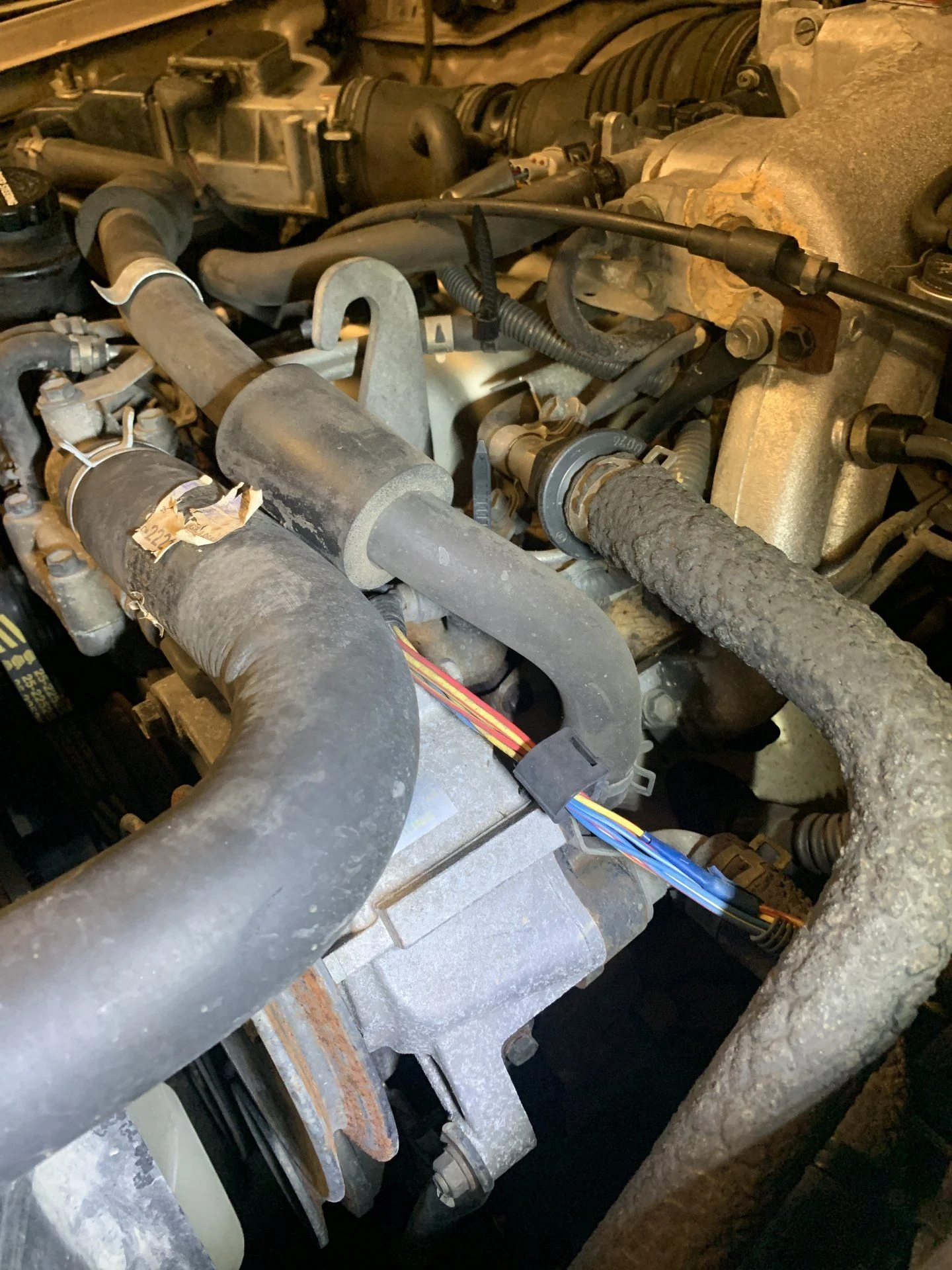

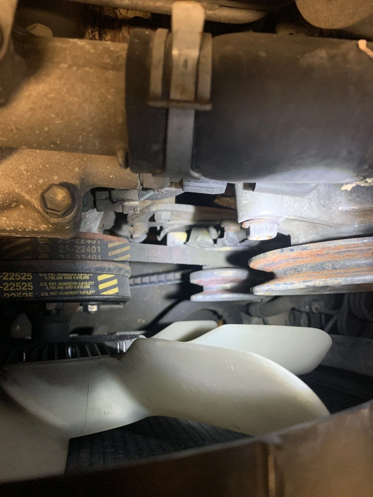

Interesting info here, waiting on my overspending order from Wits End to show up before I start wrenching but taking inventory I noticed another winner on my new to me 3FE.
There appears to be zero mods to the engine, all of the air pump lines are intact as far as I can tell and I bought it in a no smog/emissions state.
However, I’m only running two belts. Even more odd to me as a newbie - am I about to jack something up when I throw all three OEM belts on?!

Happy to! It *appears* as if everything is intact, but I’m also green to the 80. Which is why I’m concerned about running the air pump now that it’s been without it for...um...no one knows. 😂

As Jon Held alluded to earlier that smog pump bearing could be toast (or they desmogged). I imagine if it is seized that putting a new belt onto it won't be good. Check to see how freely it spinds before putting a belt on it.

Ah, yes, for sure! If he says it, I look at it. Should have mentioned that. My first assumption was that it had an obvious disconnect, but t doesn’t.
Turns freely, no off axis play/wobble by hand turning, just a little surface rust since it’s just been sitting.
I guess my fear is that there’s just junk within it somewhere and introducing it back into the system would be bad.
We’re about to find out.
