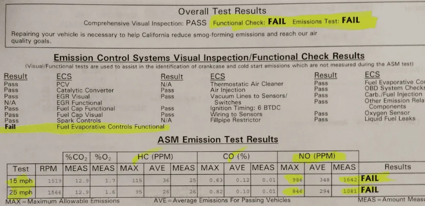

My 1990 Truck has always passed CA smog no problem, but this year my NO numbers are high:
The tech at the Test Only Smog Center also told me the gas fill neck wasn't sealing properly.
My mechanic suspects the fill neck issue is also the root of the high NO measurement.

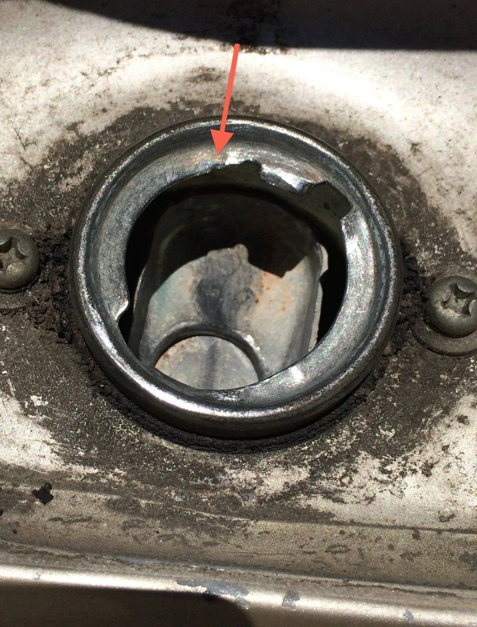

I think my problem is here (red arrow) where wear from the gas cap has worn away metal:

So your problem isn't with the gas cap, but with the threads that hold the gas cap on? (isn't that the same thing?) Or is it that you're saying they took the gas cap off of the vehicle and tested that piece by itself somehow?
No, the threads in the fill neck for the gas cap are one piece with the rest of the neck. The whole shebang is replaced as a unit.

Update: I got tired of waiting for my regular mechanic to schedule me as my tags were already expired, so in desperation I went to a local smog shop where the owner assured me he could get it to pass. For the NO he replaced the EGR Transducer Valve and for the filler neck issue he pressure tested it and could see a small leak at the bottom. His solution: squeezing it with a big channel lock plier. I couldn't believe it. He told me it looked oval to him!
It passed. Not with flying colors, but I'm good for another two years.
