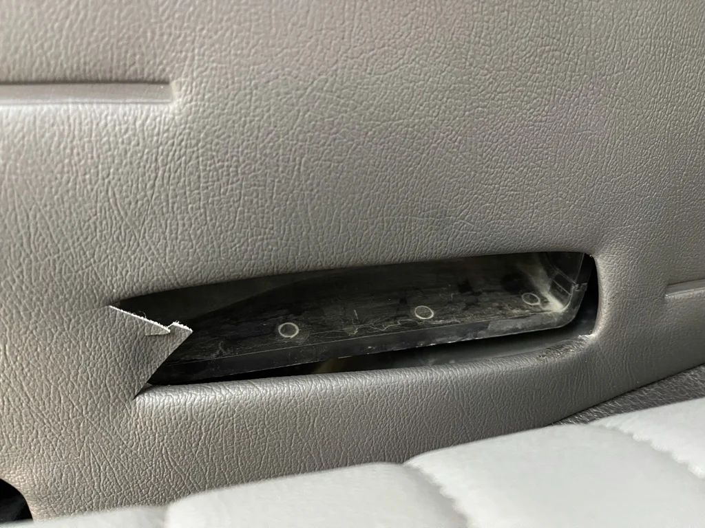

My 89 FJ-70 has an black exterior fresh air vent connected with a duct to the interior. However, I can not find a piece of trim that installs on the inside rear drivers side trim board. The trim board has a cutout for the trim board vinyl and I would think a piece of trim would connect the duct to the interior. Anyone have a picture of this piece and possibly a part number? I've searched Megazip and can not find a trim piece but those figures are pretty damn small - at least they are for my eyes!

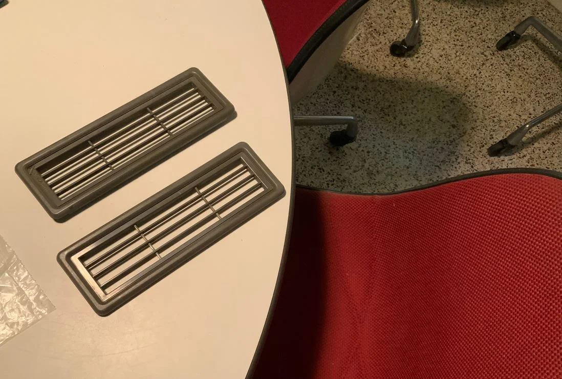

62951-90K00 For the rear lh side. Parts are always stated as left or right. This part number is from an 05 Troop carrier as they no longer keep parts for the year of your 70 series.
It looks the same part as the rh side.
You will need the metal clips that hold it on as well. Can't remember if they come with the new piece or not. Those things are much easier to install than to remove.

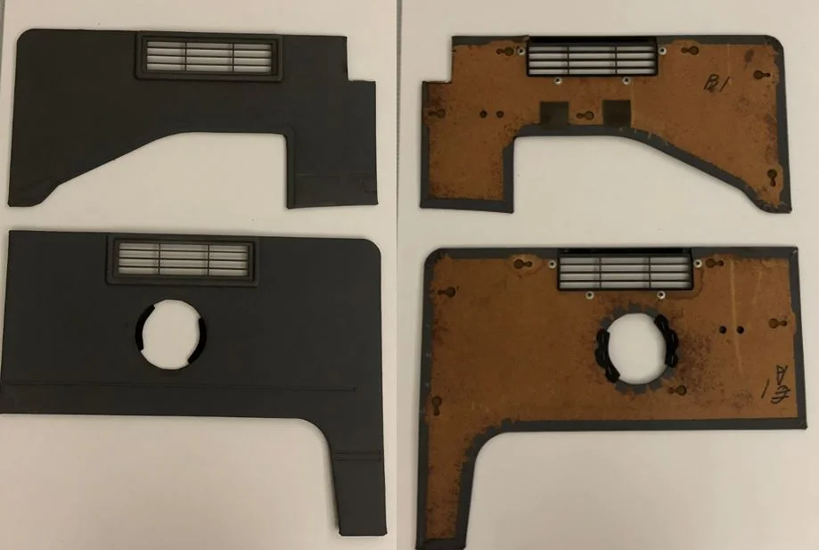

My guess is that your trim board is homebrew South American style and doesn't even have the holes. Pic example below of OEM.

Home brew style for sure. Vent hole is there but no holes for vent trim tabs

I pulled out the couple I had in a box. The P/N is 62821-90K01-B0 for both sides and readily available on ebay if you use the part number to look it up. I would go with B0 for grey color.

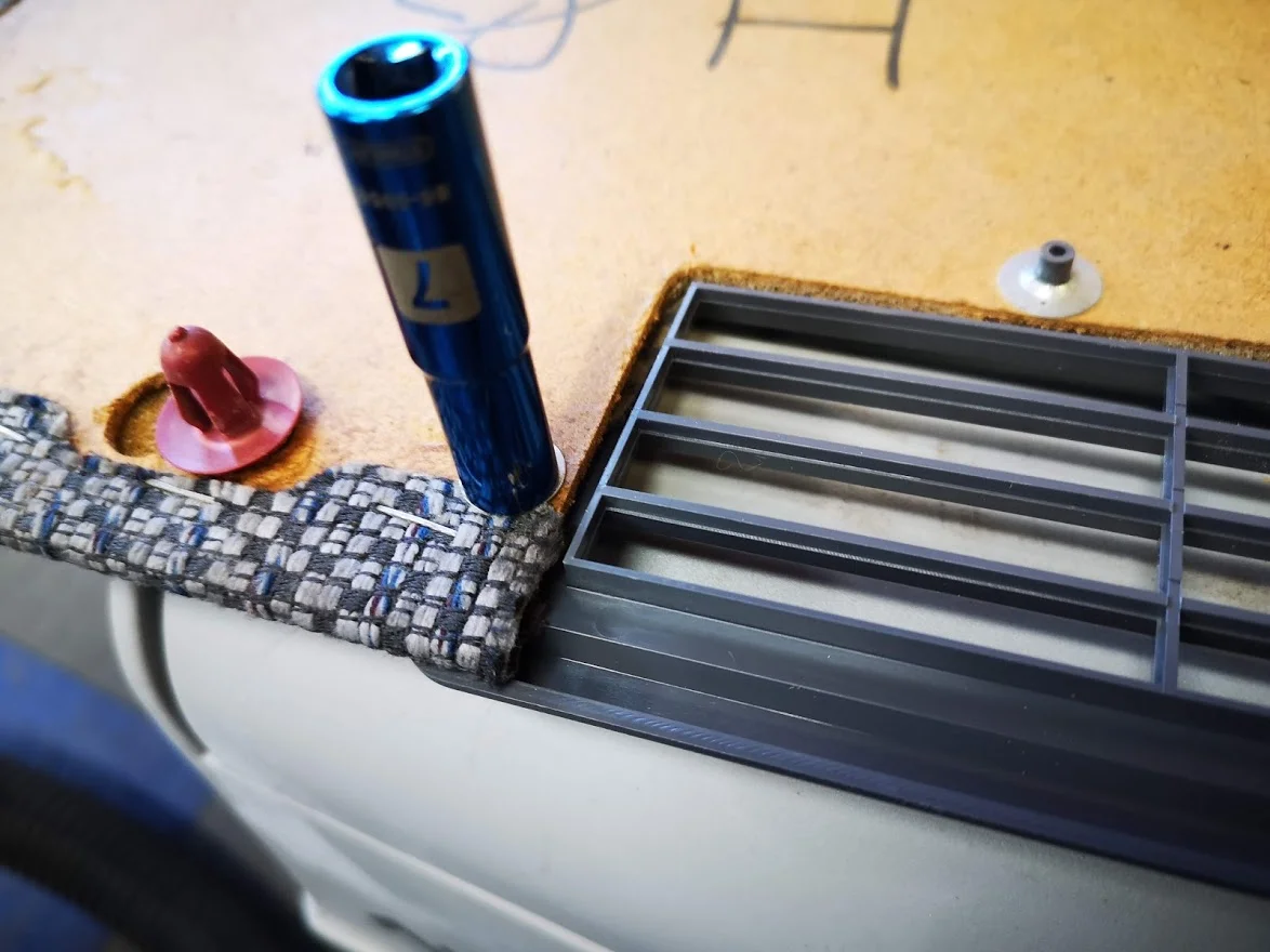

I put some in my 77 Series (same part) last spring, and they didn't come with the clips. Had to reuse the old ones. They are basically a press-on clip, and I pressed them on with a 7mm socket. Home depot probably has something that will work in that misc fastener bin. Barring that, some mechanics wire would probably do the job?

They are held by plastic clips. Some call them Christmas trees. If you look at my picture a few posts up, there is one visible (kind of a reddish color). A trim tool and patience with the 30 off year old plastic does wonders. The clips are still available if (when) you break one or two. The trim tool sometimes even comes with them if you a get a generic kit from some mail order place named after a river.

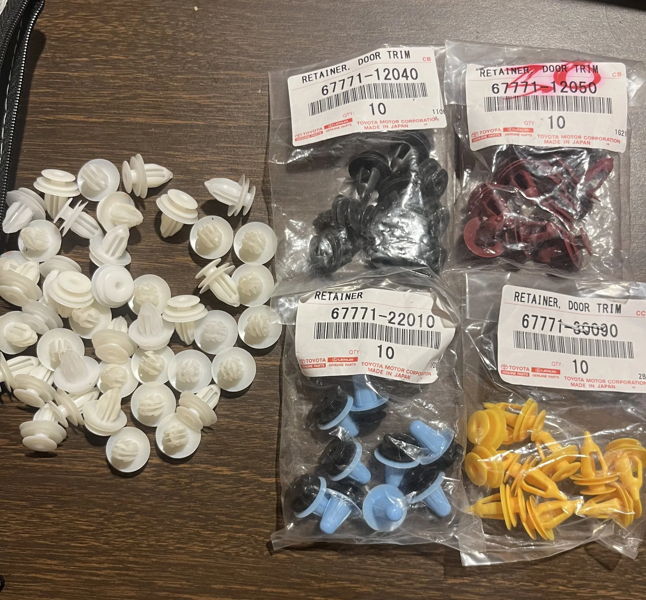

I can’t recall the part number of the white retainers but they seem to be the most common. However it is my experience that Toyota seemed to mix these retainers up on each panel of different types. I try to keep it that way.
Pics of the retainers I have. Have a lot more than this. Never know when you need them and the aftermarket ones seem to be too loose or break too easily.
