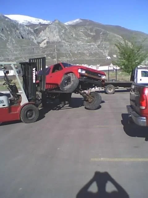

So I have a 87 pathfind I am building so far I got a xj front axel
With TJ 4.5 lift coils and a custom three link long arm setup have
Don't all the fab work to make it work just needed some info on the front
Axel the rear end has 4.375 gears but you can't get that for a Dana 30 the closest
Is 4.27 is this going to be ok ? And what locker should I run up there for best rockablity turning and so forth ! And any other info on this rig that any one might have would be great help !
Picture of the pathfinder !
