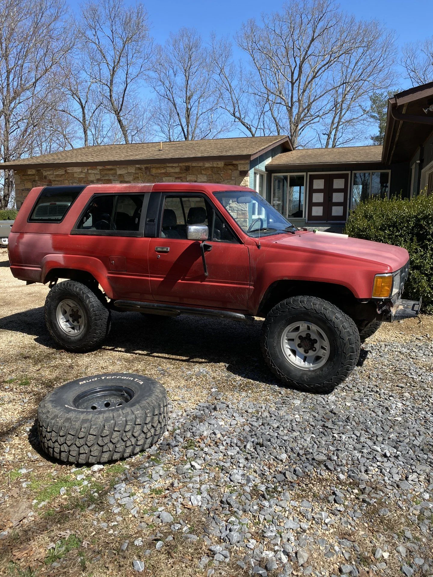

For 31x10.50s just bolt them on and go. Keep stock CV and steering angles. Use your lift money for a rear locker. I’ve had (and wheeled) everything from 30x9.50 to 35x12.50 on my stock height 4runner. A lift isn’t needed, other than for looks.
33x10.50s are my preferred size. Seen here on a stock height front end and a 1.5” “lift” in back to level things out.
