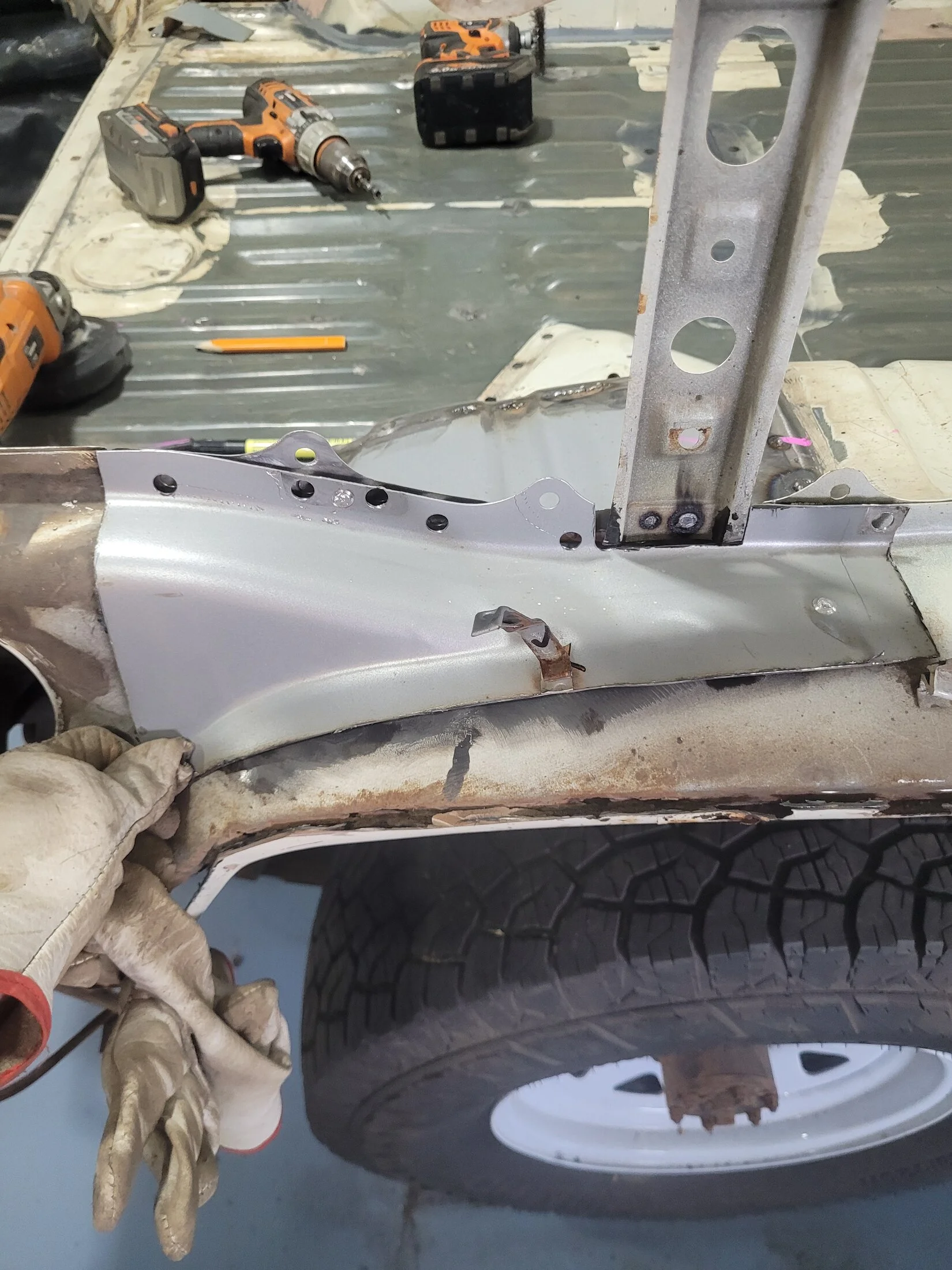

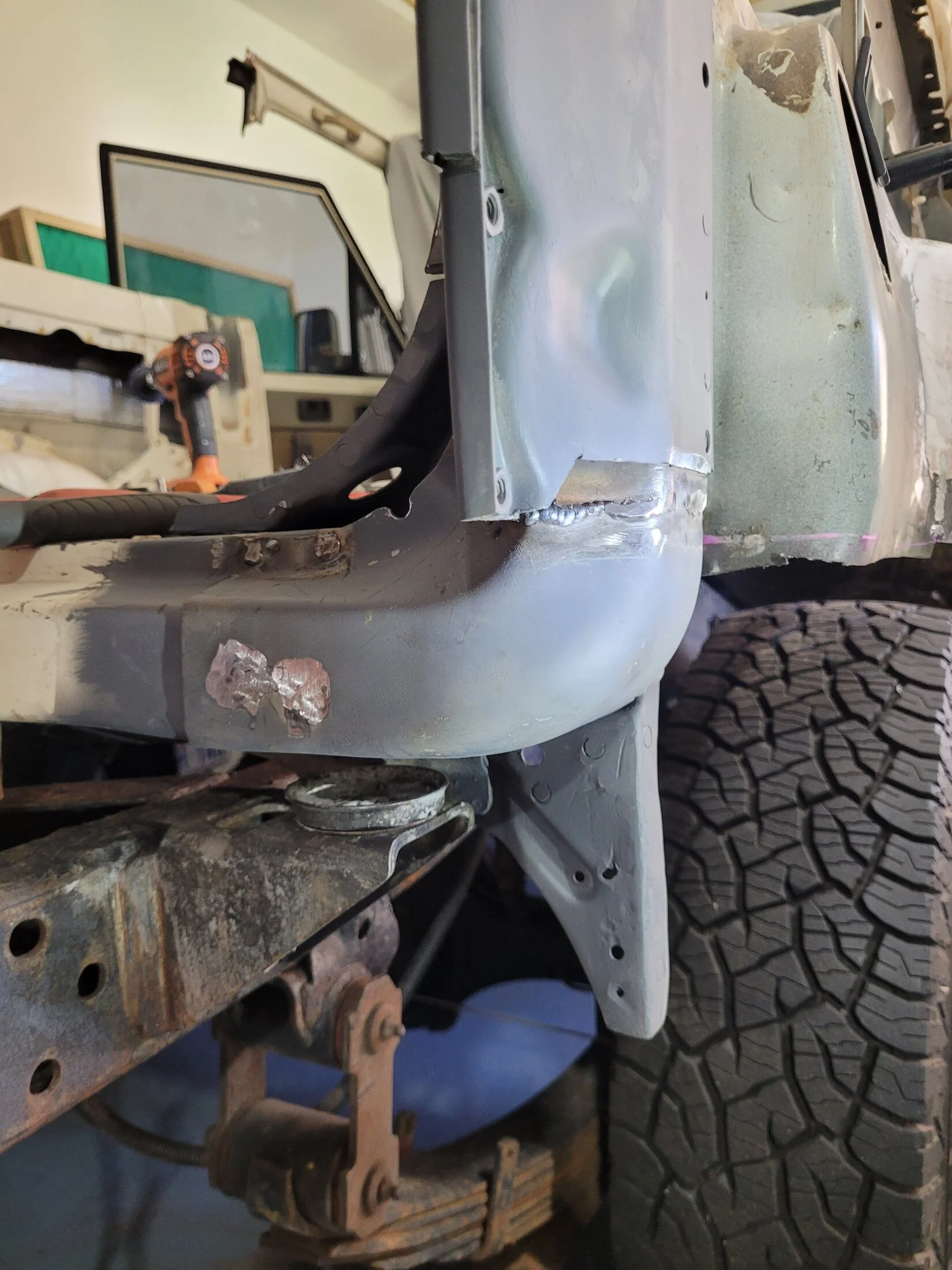

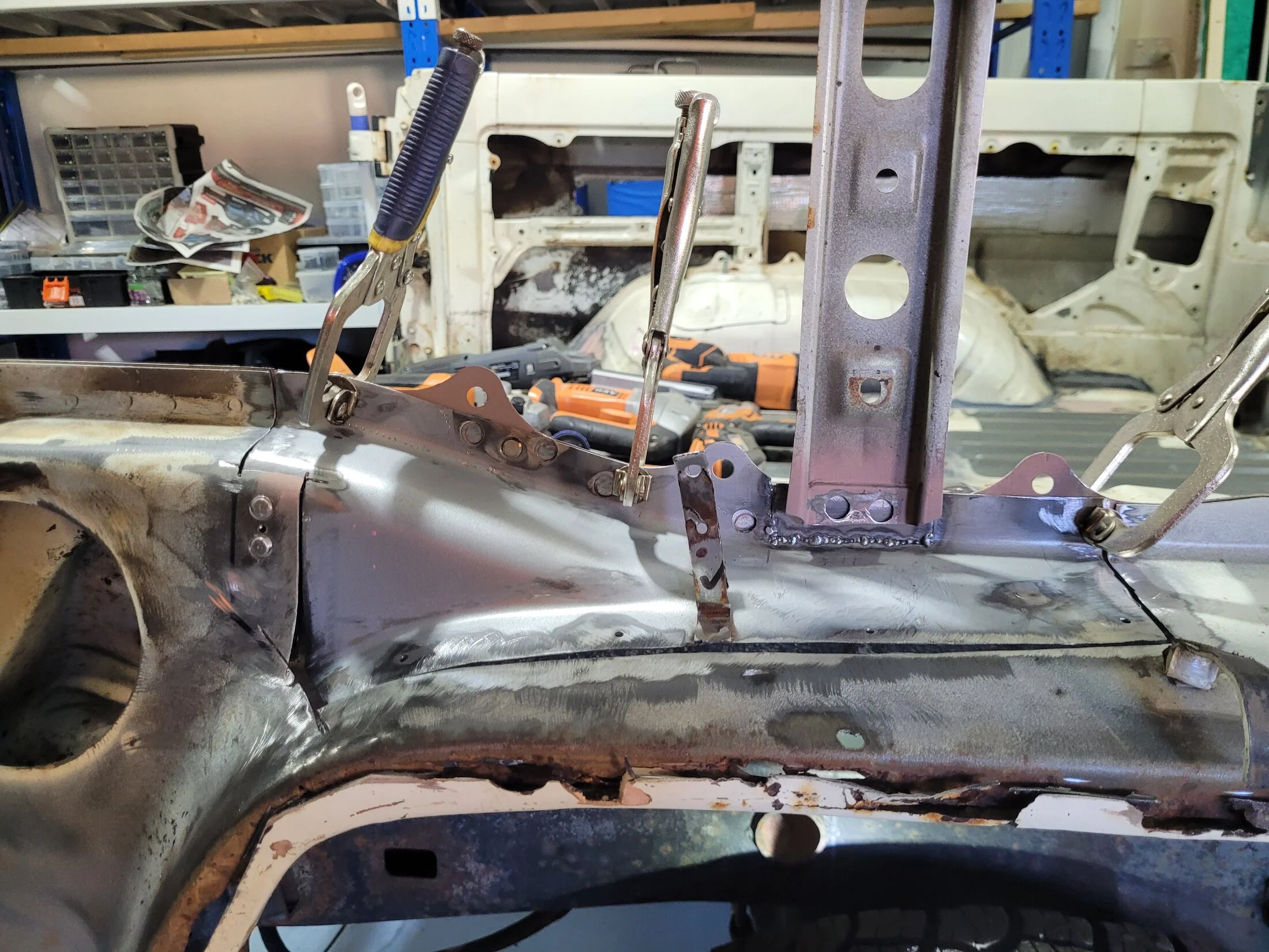

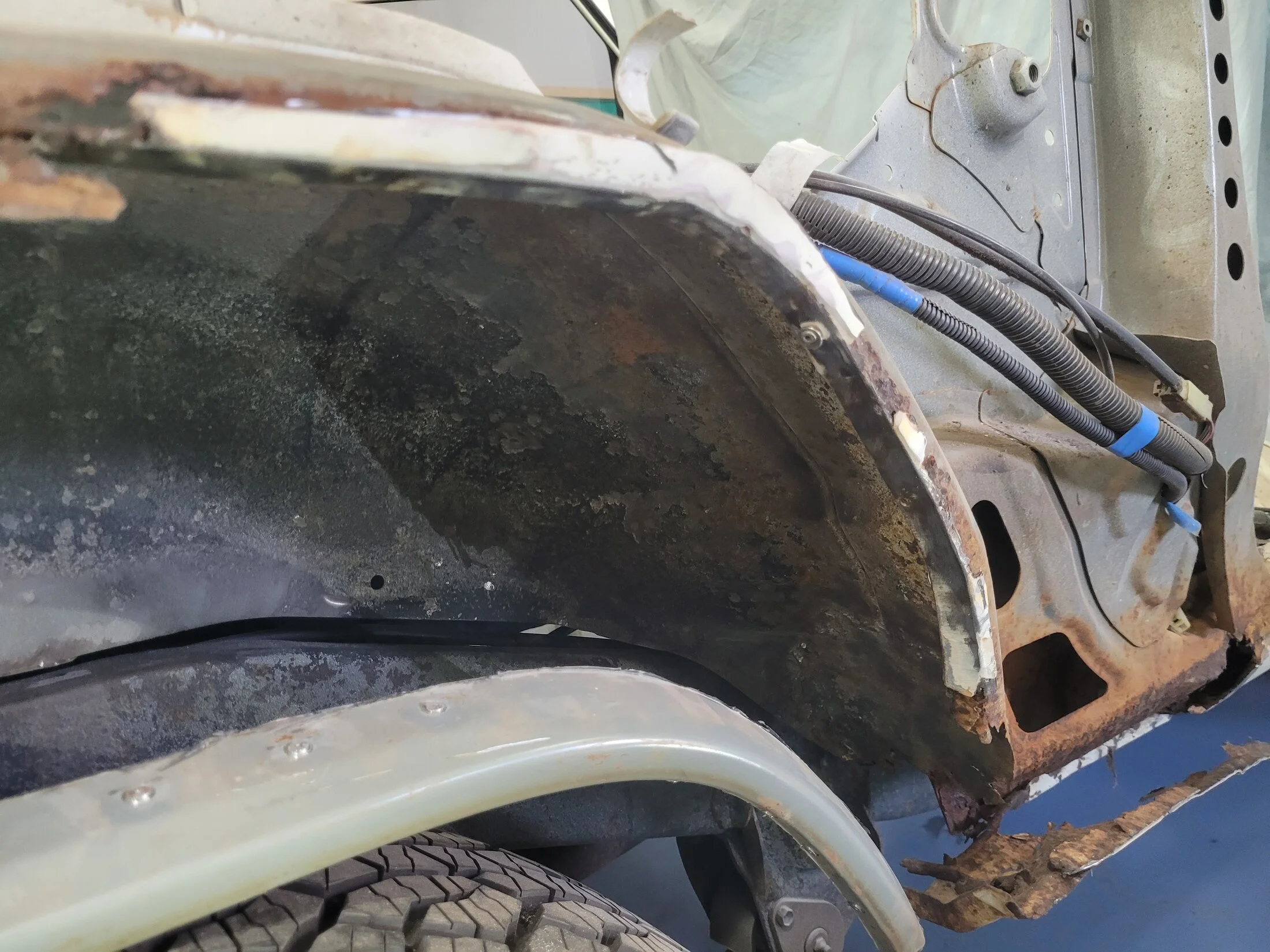

Now the other side. Lots of heat distortion on this side so getting the profile rights more of a guess. Having the other half meet up at the spot welds has helped heaps.
Very happy I've got such a clean result.

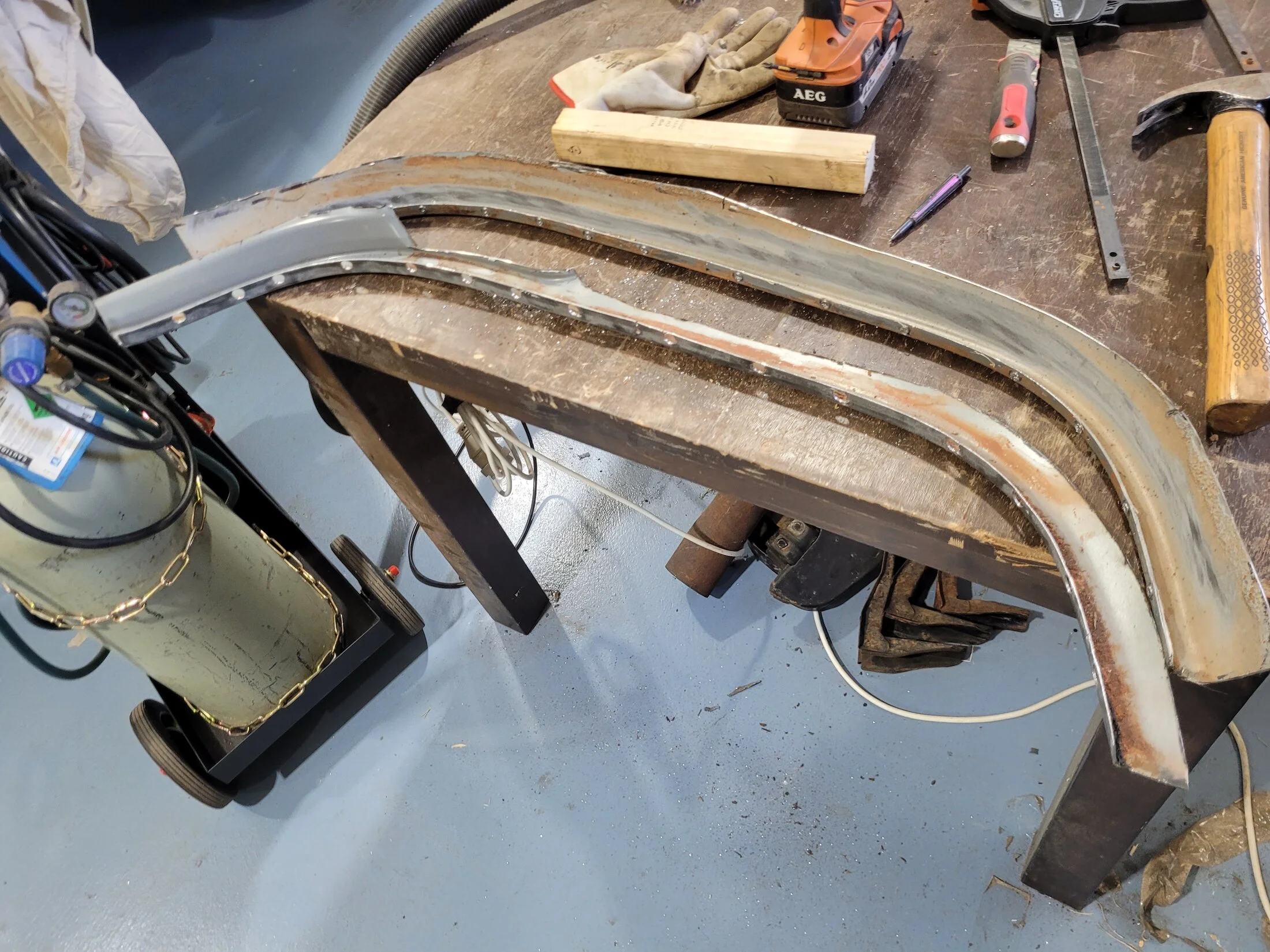

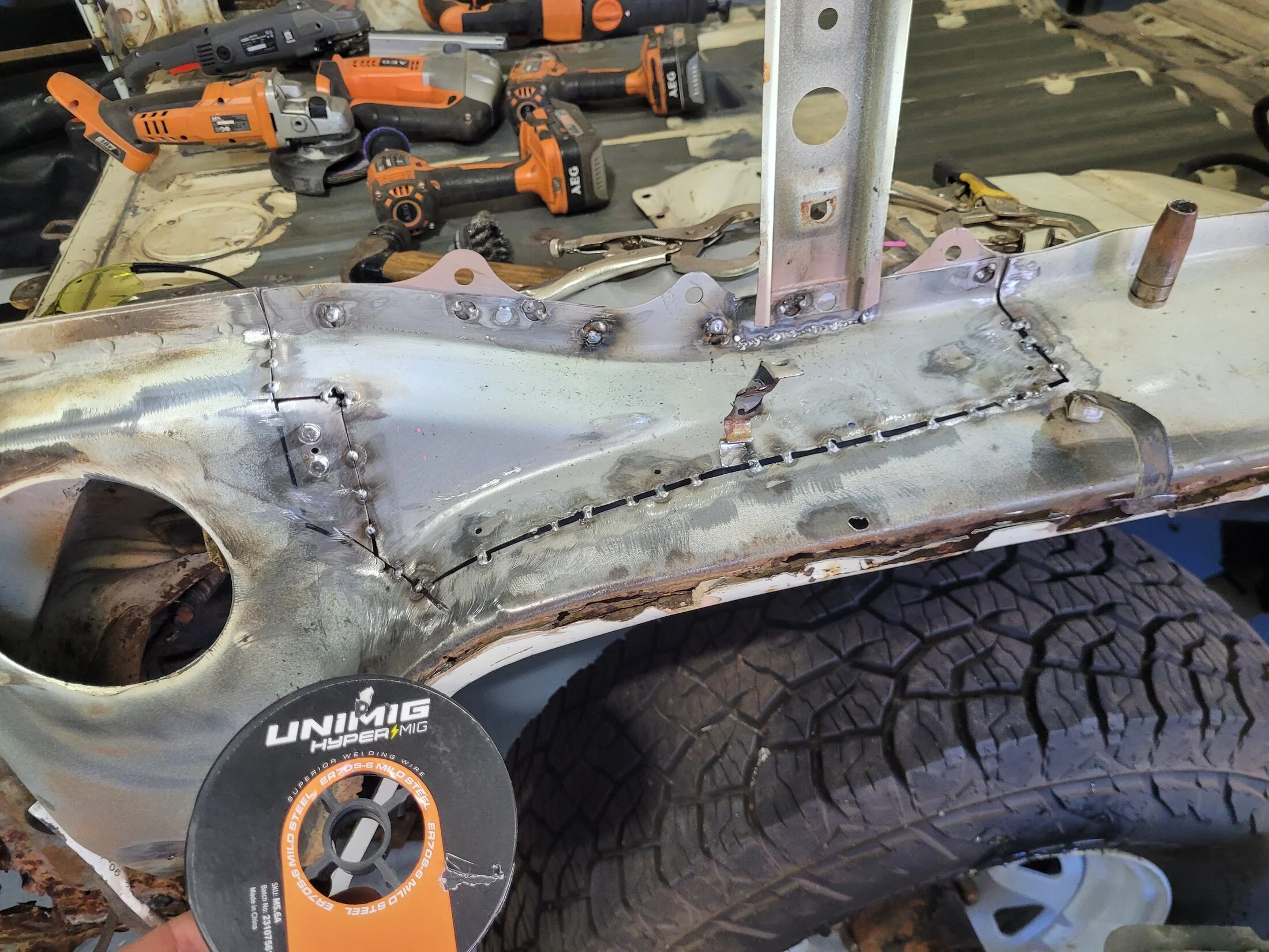

Onward to the flares. Not much metal left.

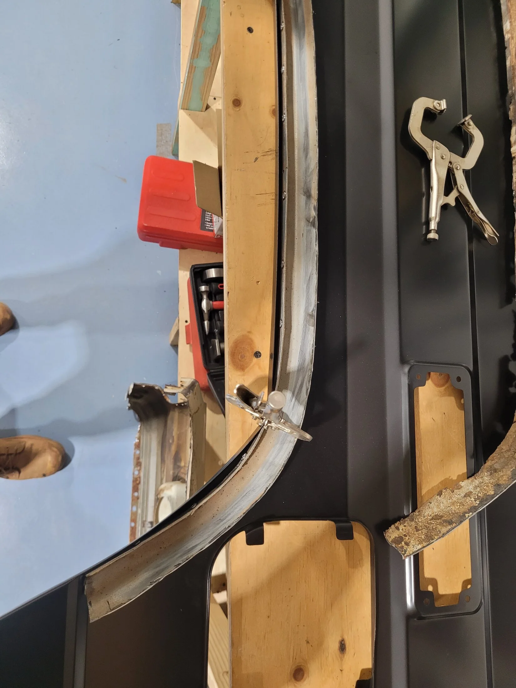

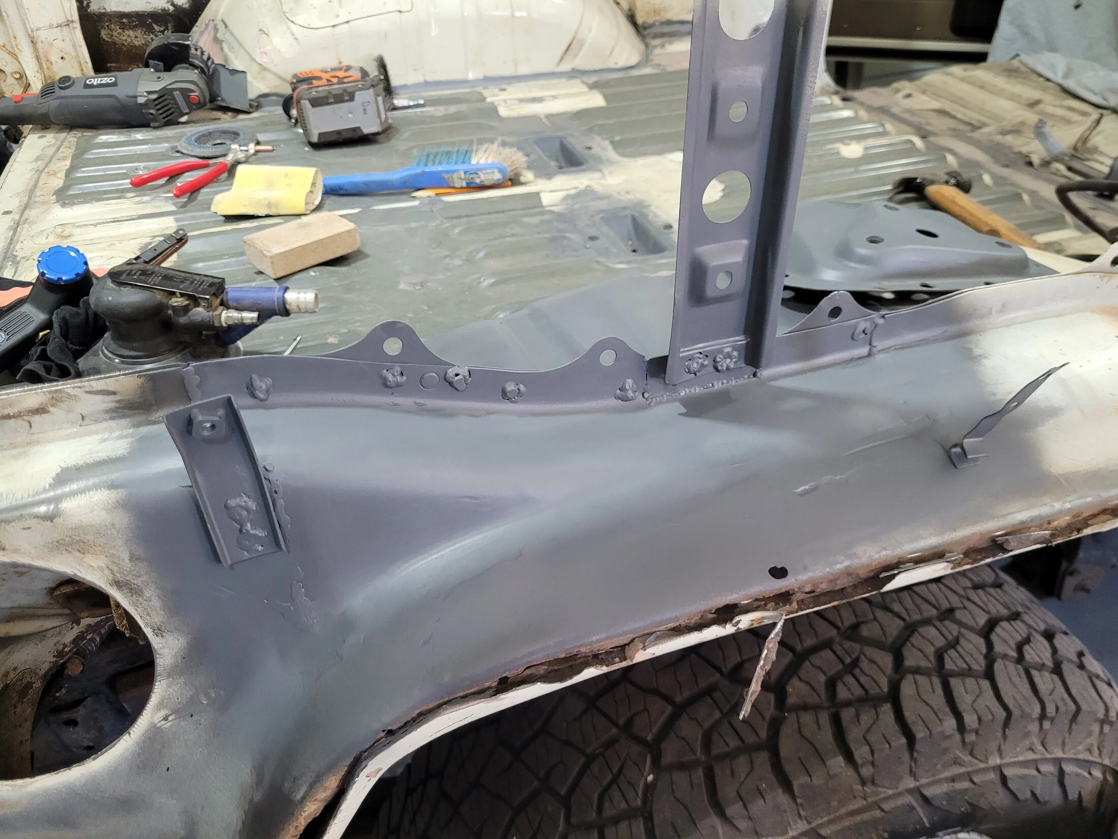

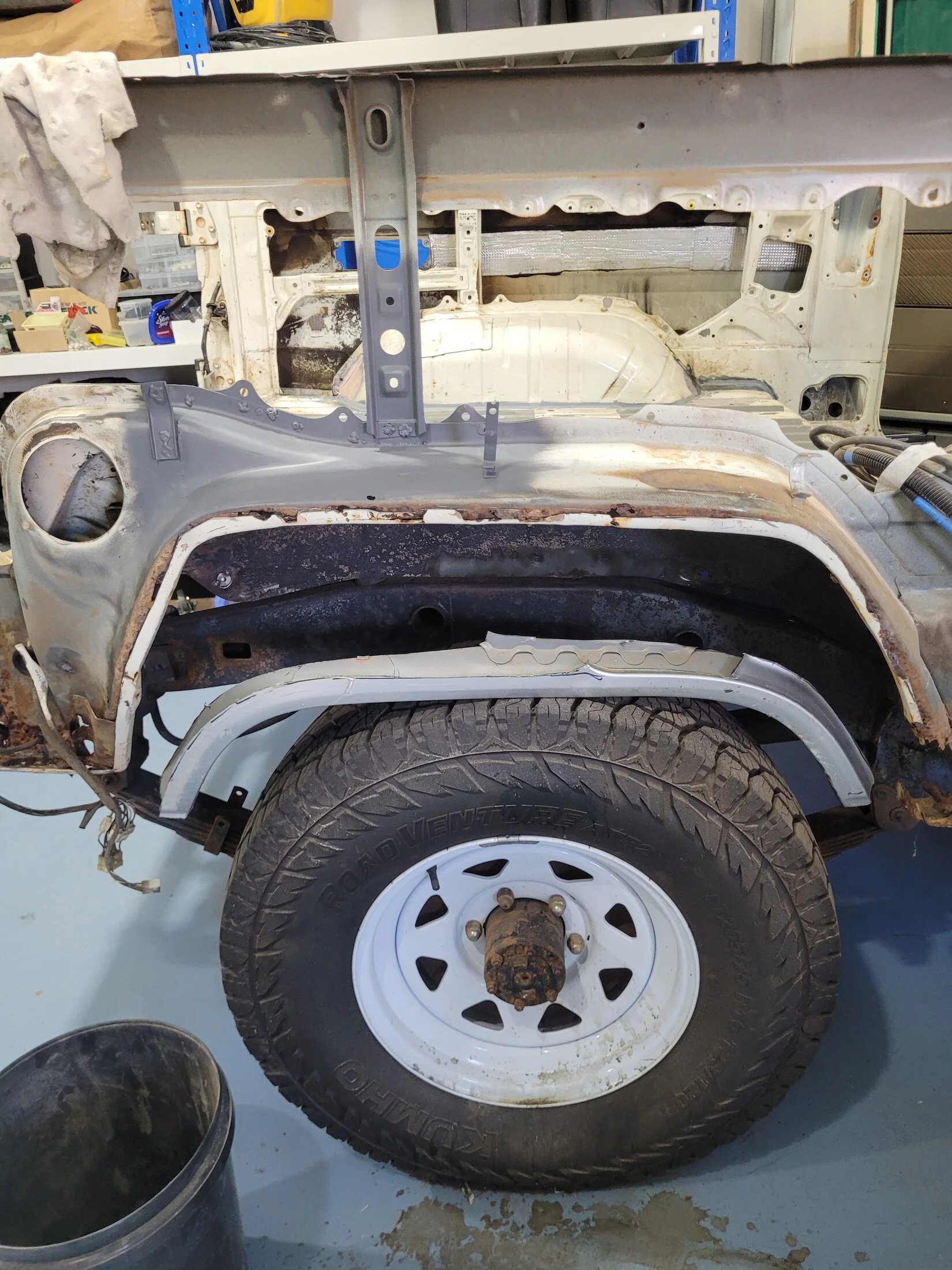

Scavenged more profile from the 76. Turns out it's a very close fit
Slight difference. Front curve fits like a dream. Top arches out by about a cm and then the rear sweeps more gentle then the reproduction panel. Checked with the old one I cut off and fits the same.
So I made it work. I've got 76 series arches now. Bending and tacking to make it meet as I went and all fitted up okay. Trial fit with the outer skin and fits well. 30mm of fresh metal in. Onto the next sections

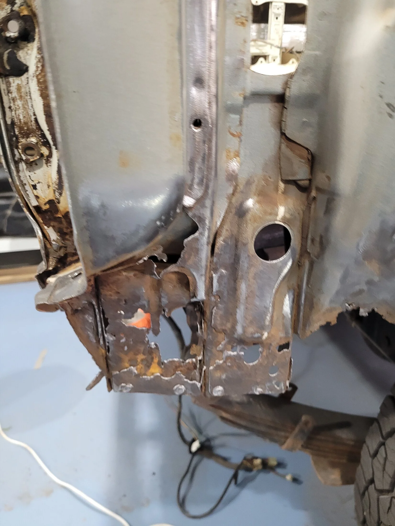

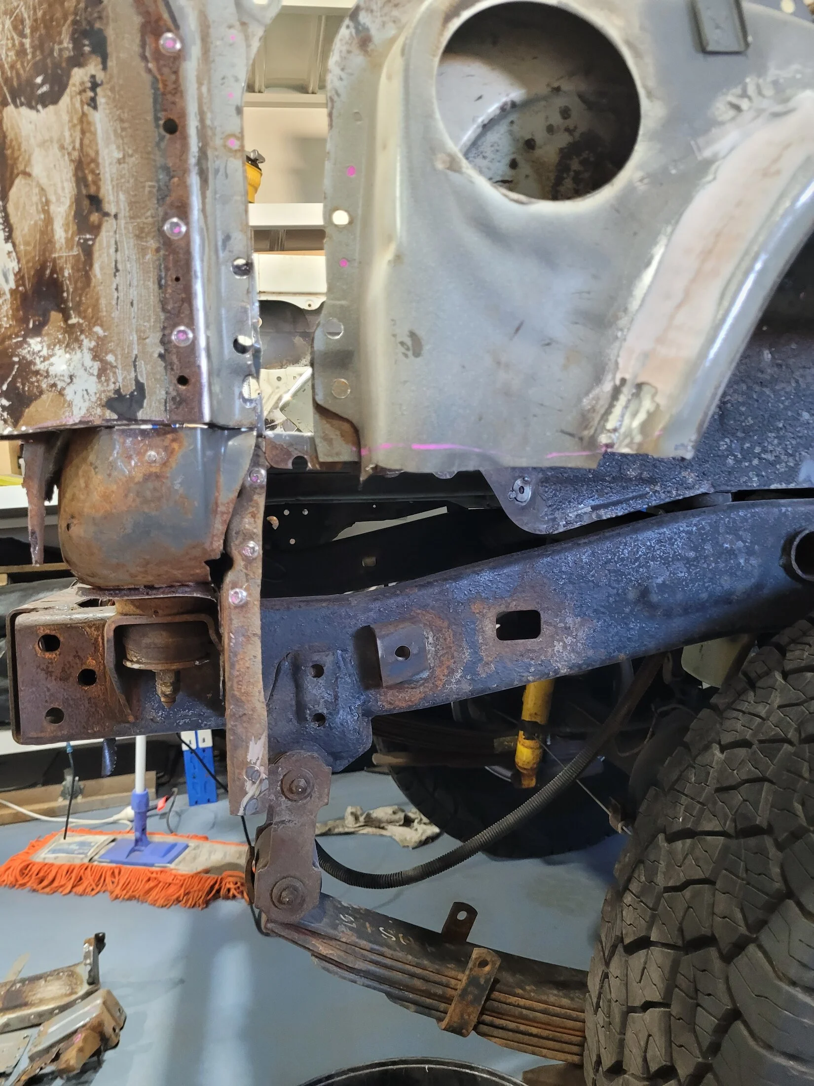

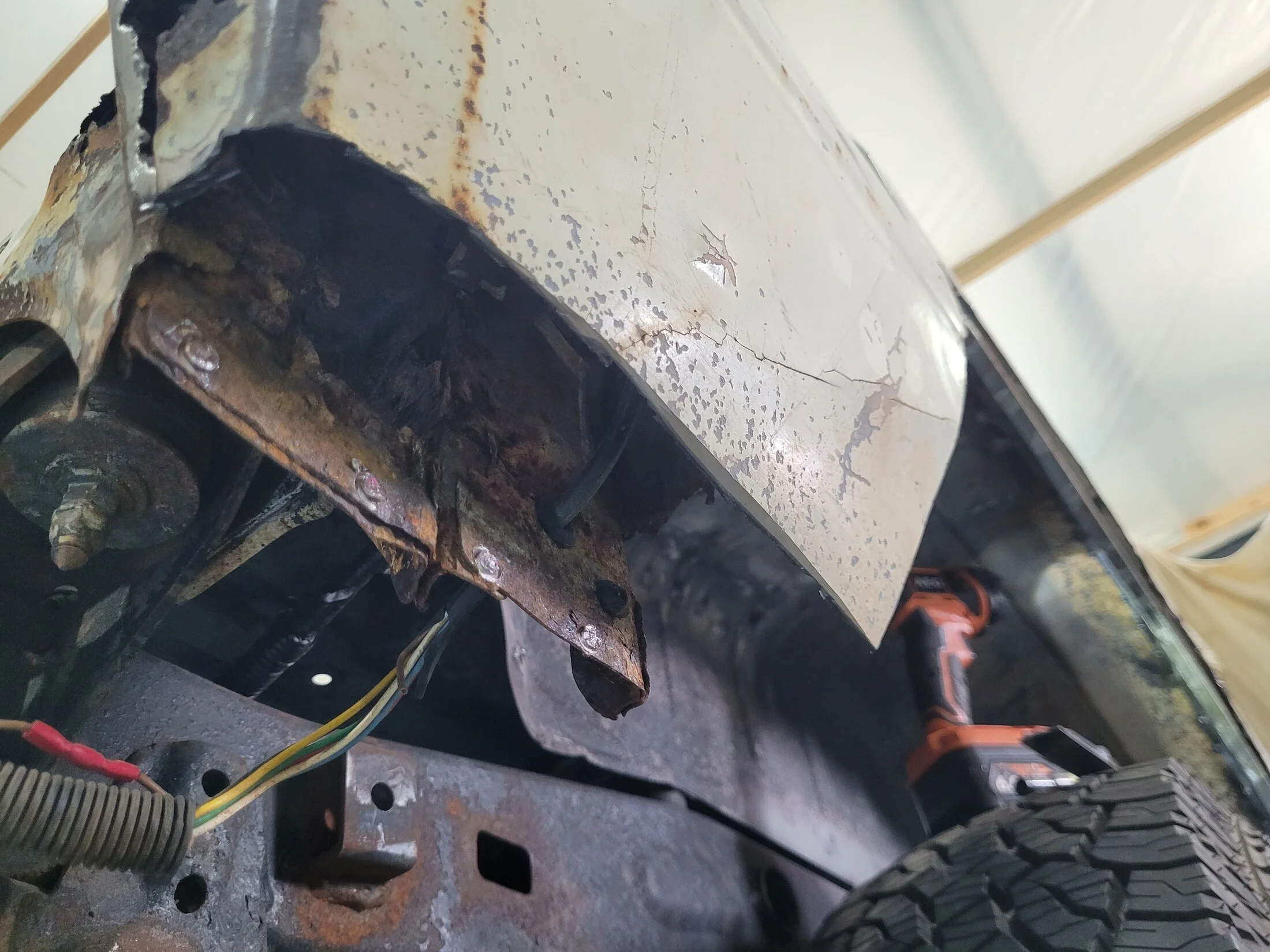

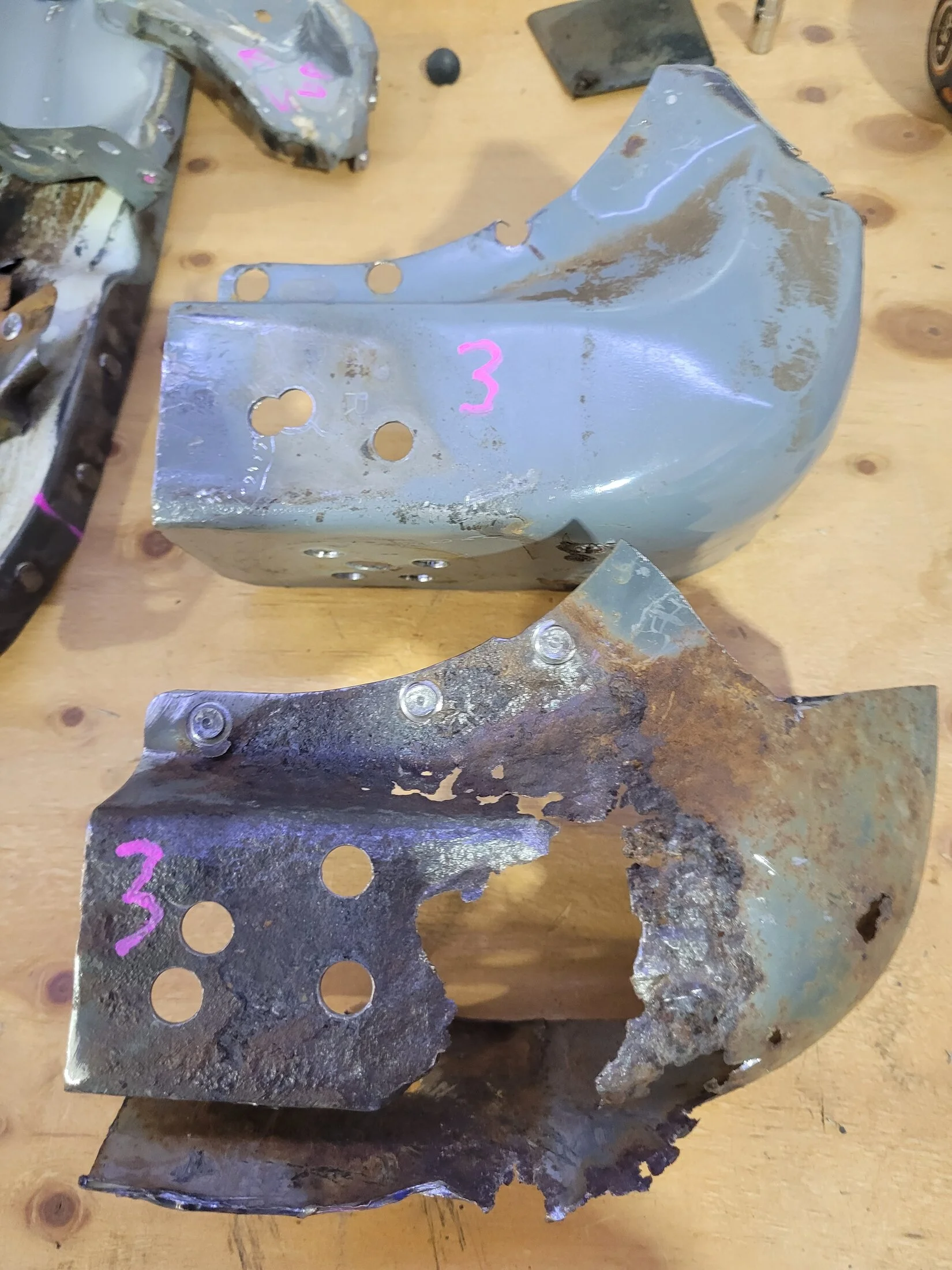

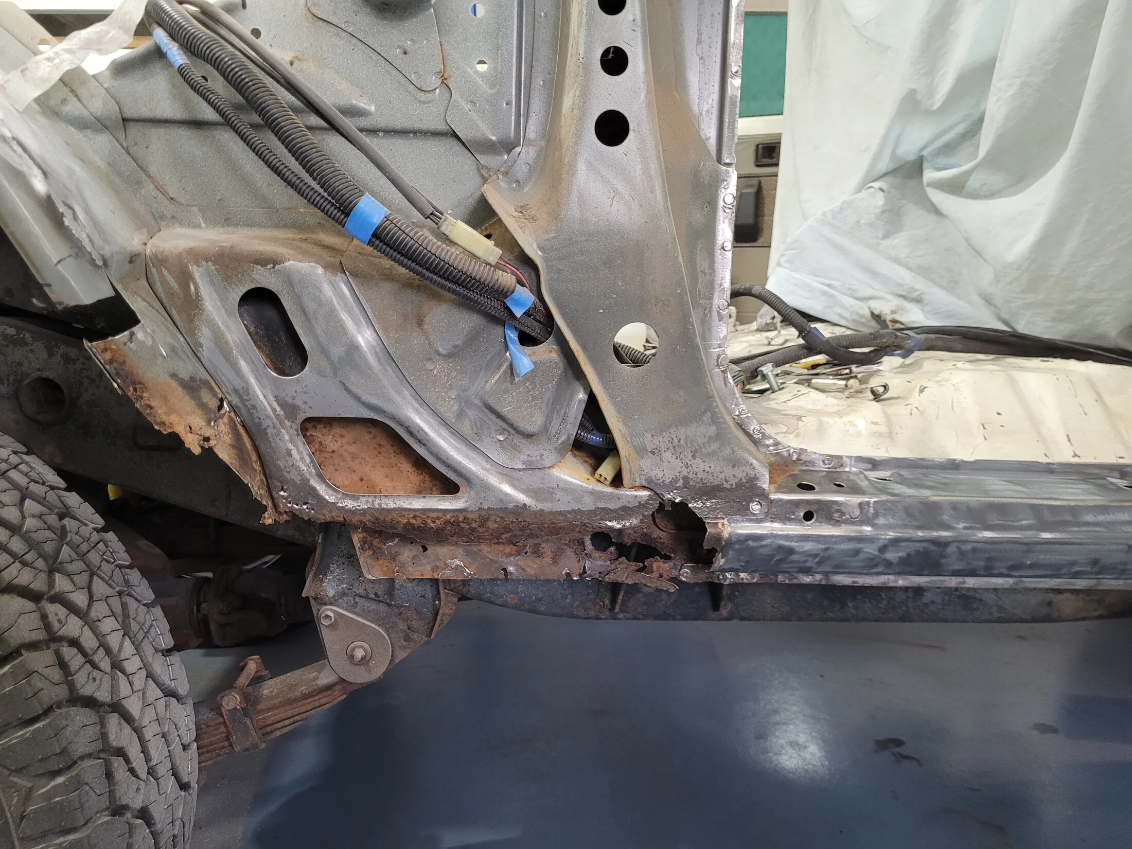

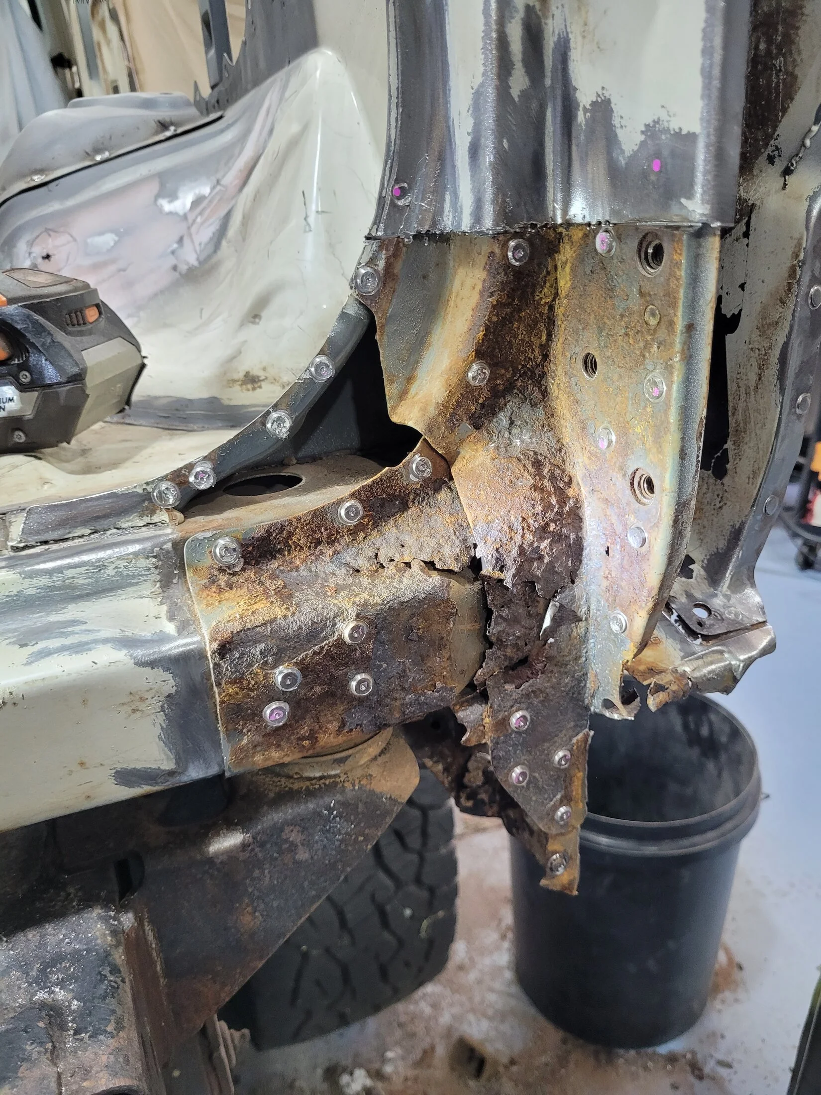

Got the wire wheel out to where ever it would fit. I can see what needs to go and what's savable now.

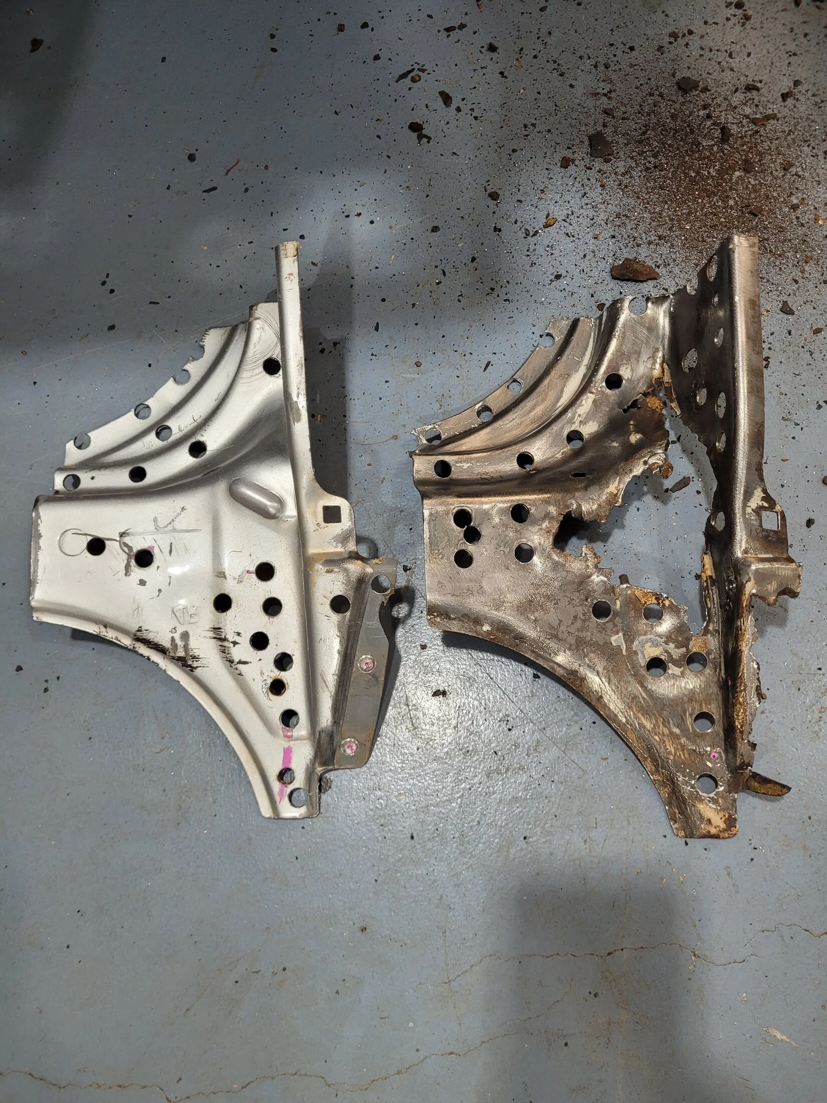

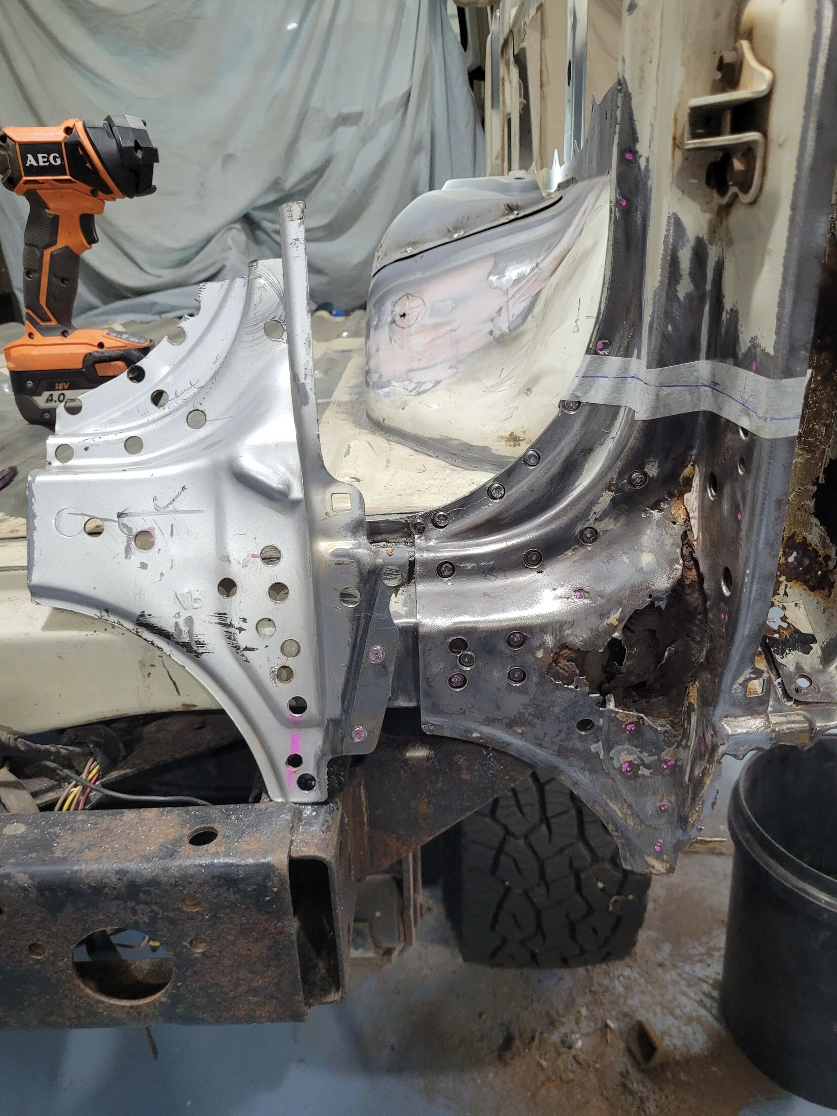

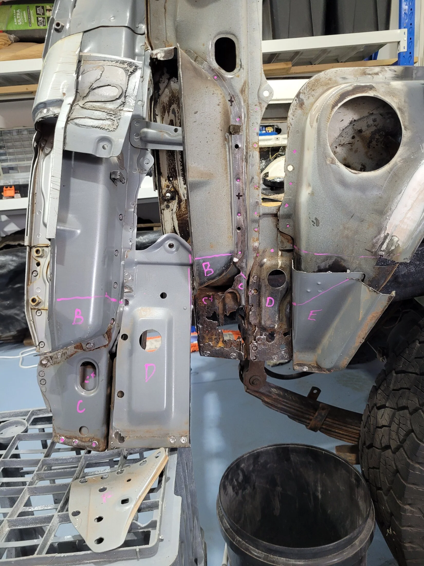

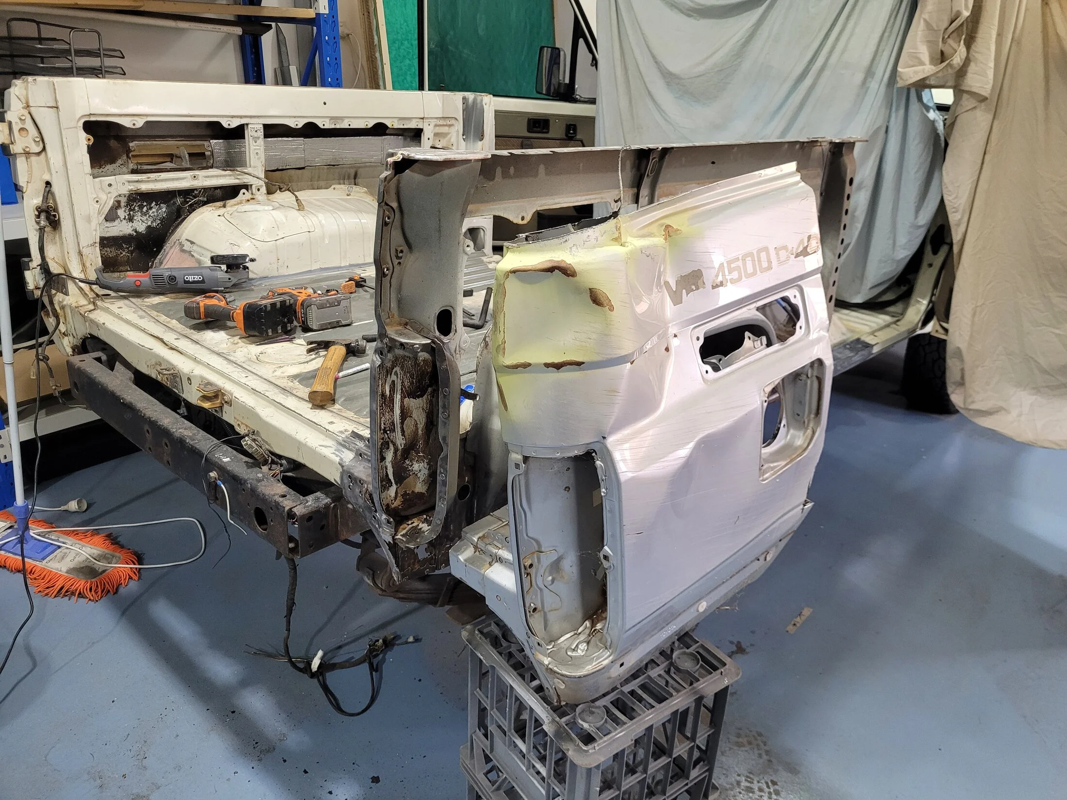

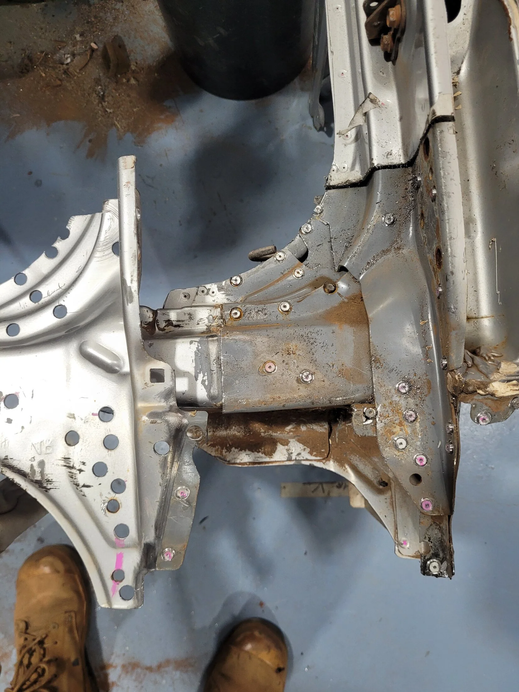

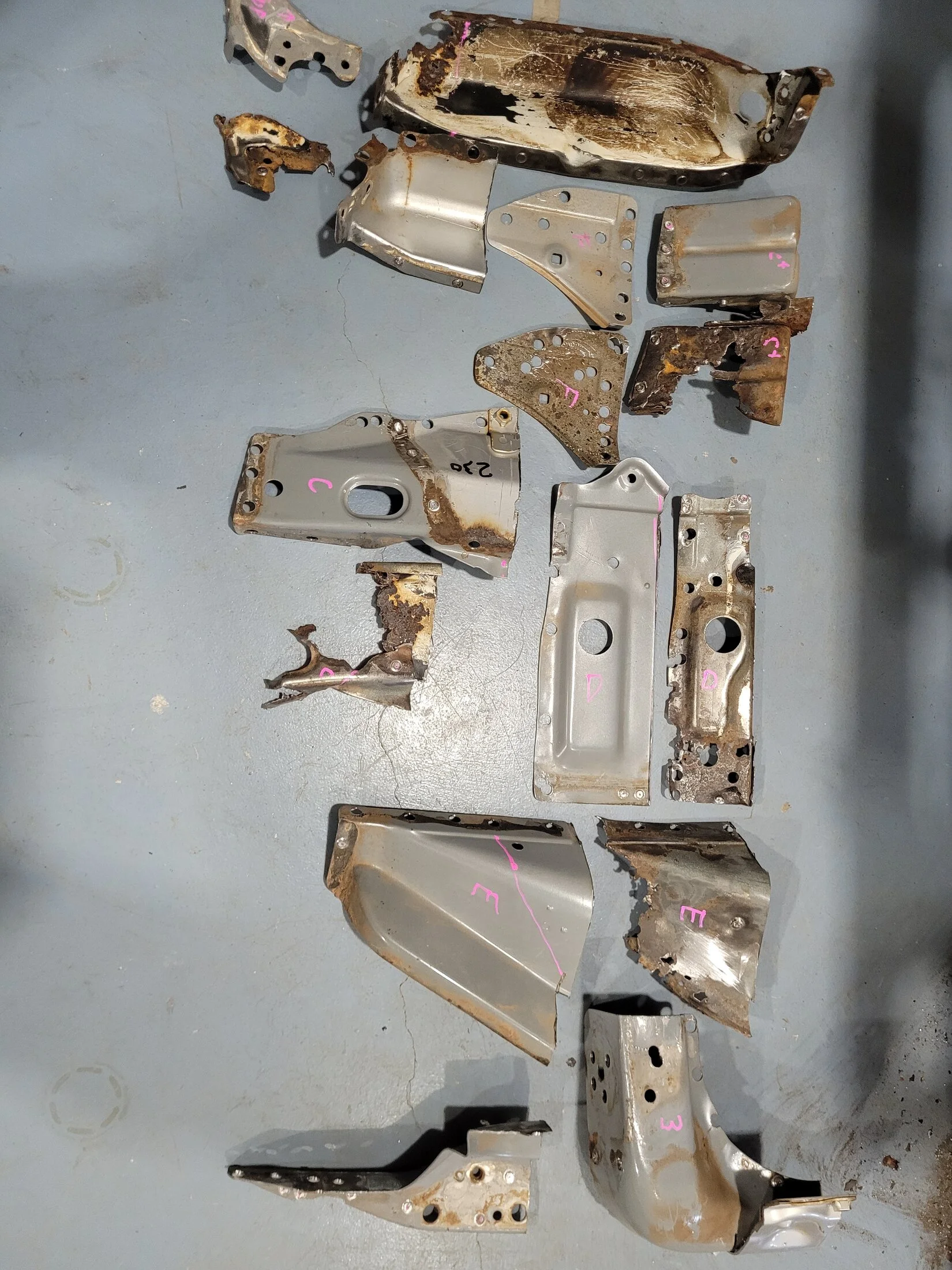

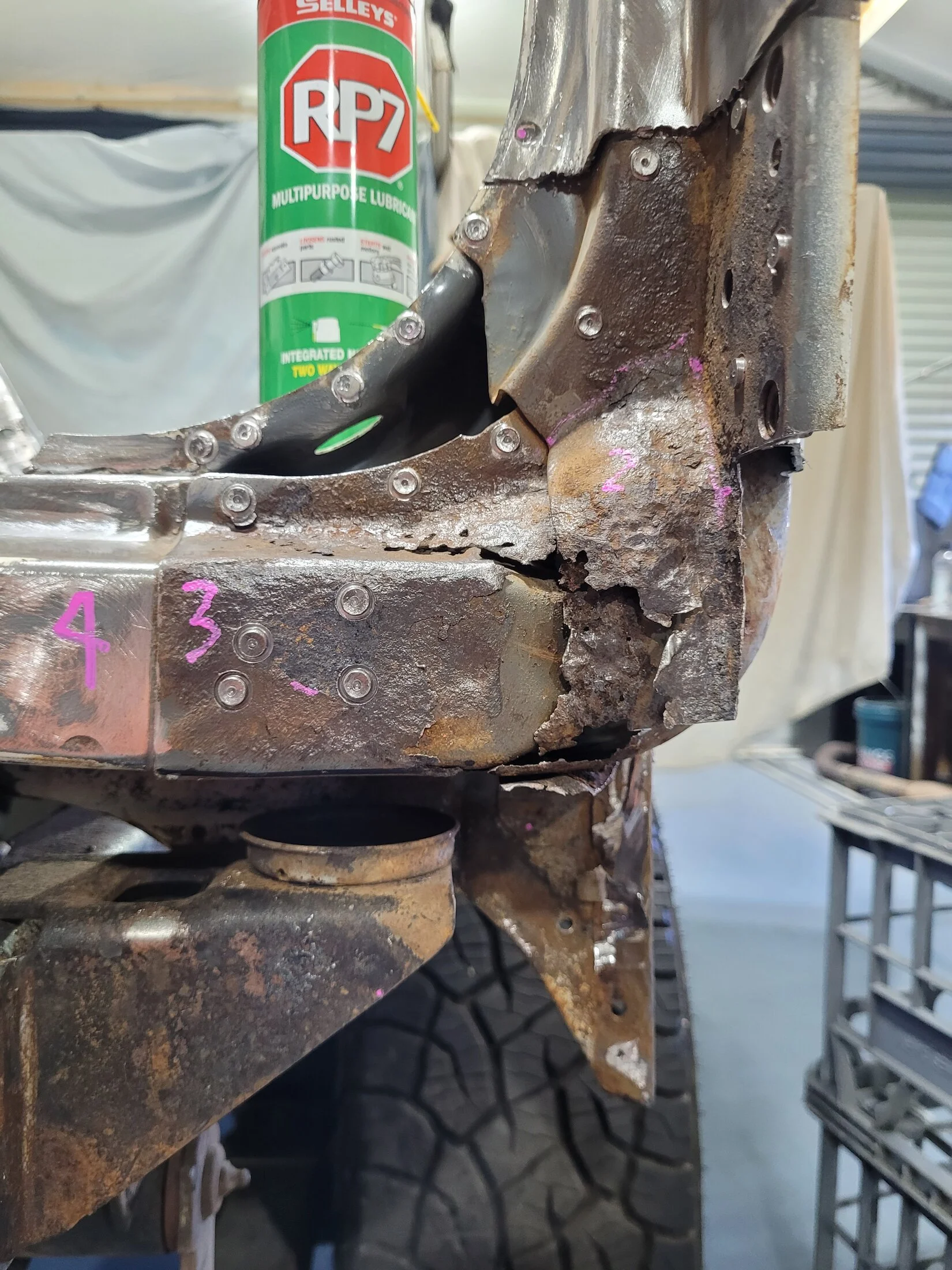

Took the outer skin off to see what my options are underneath. Jackpot, lots of the same panels.
Excuse me, I'll be drilling out a million spot welds

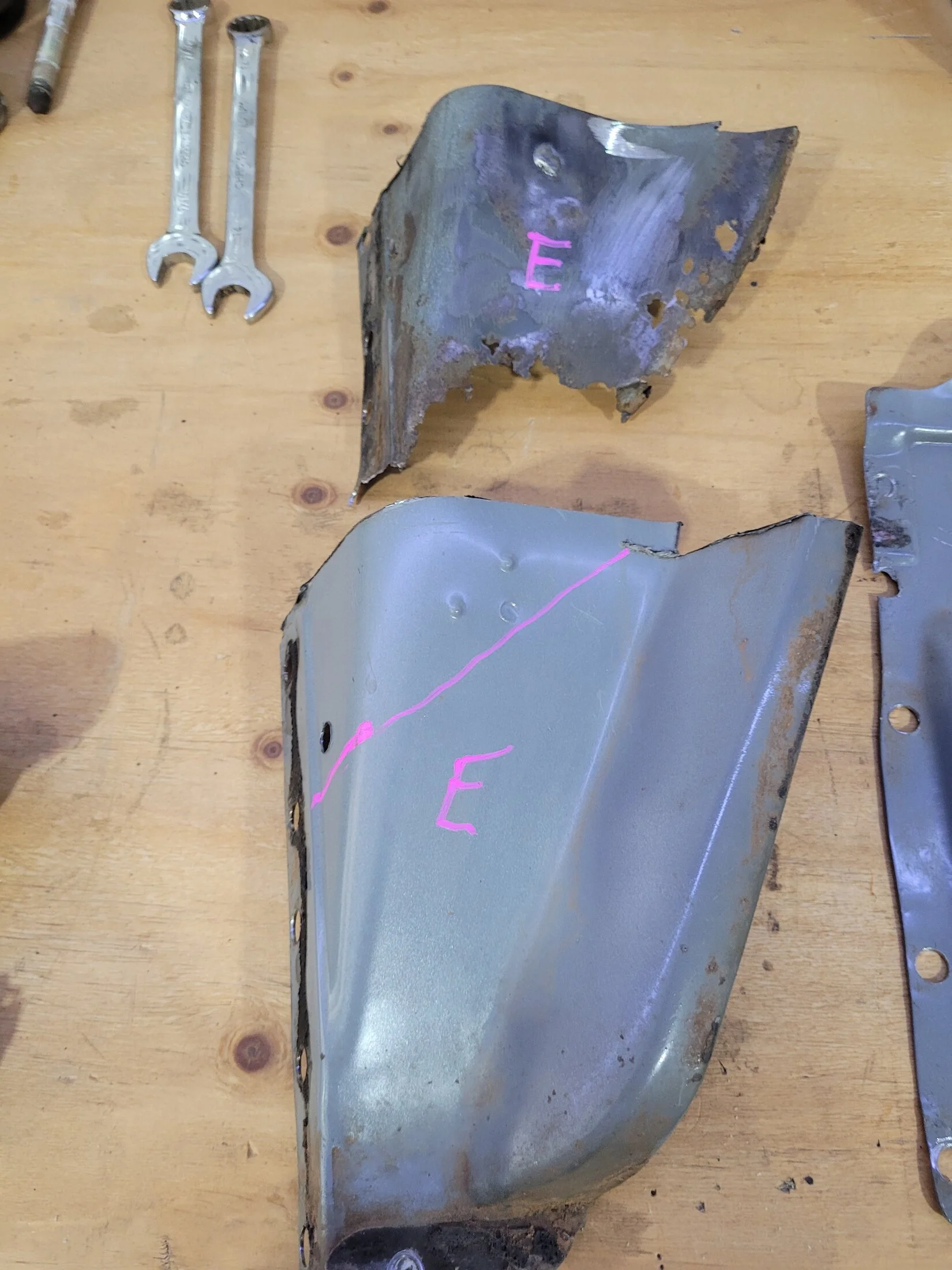

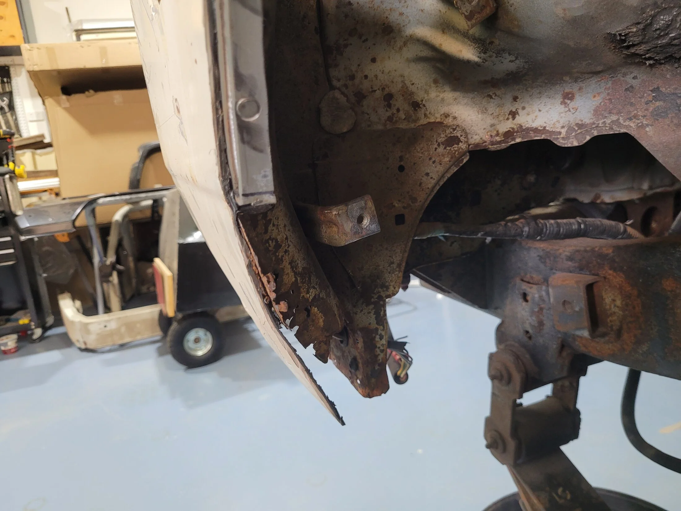

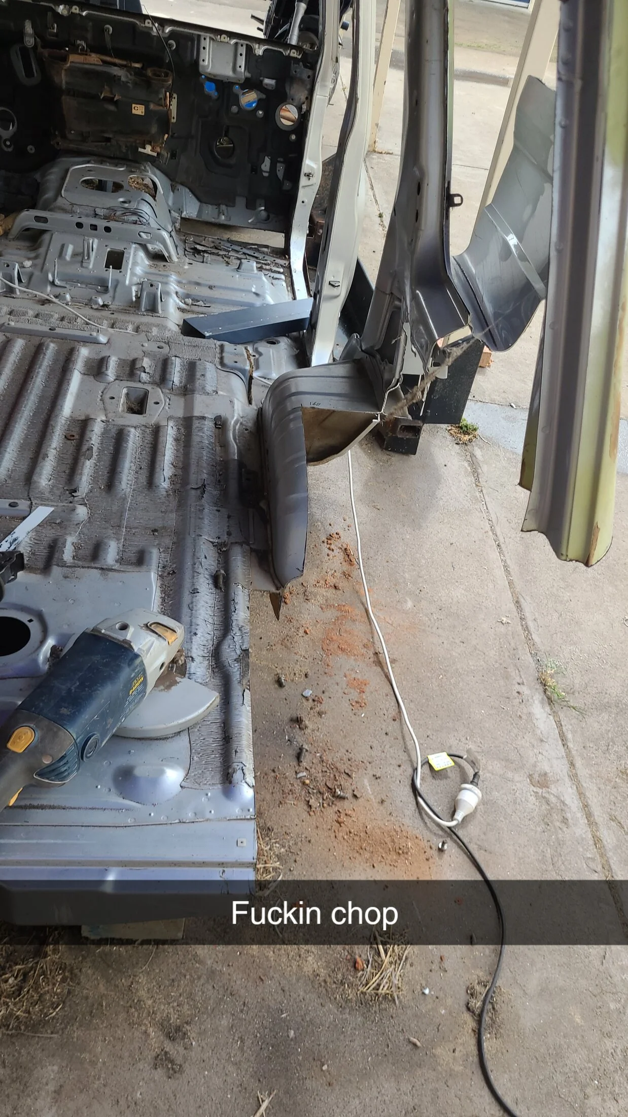

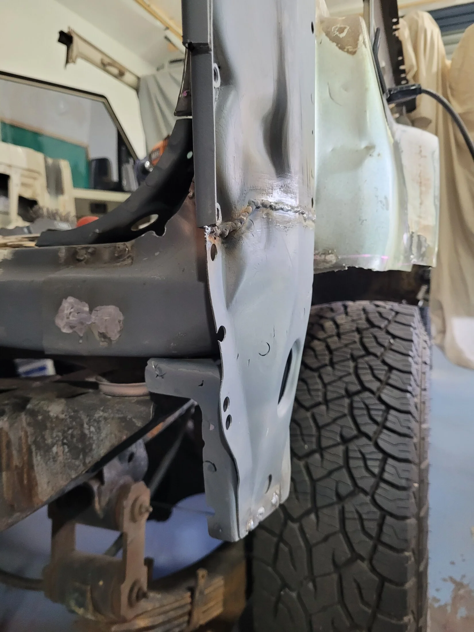

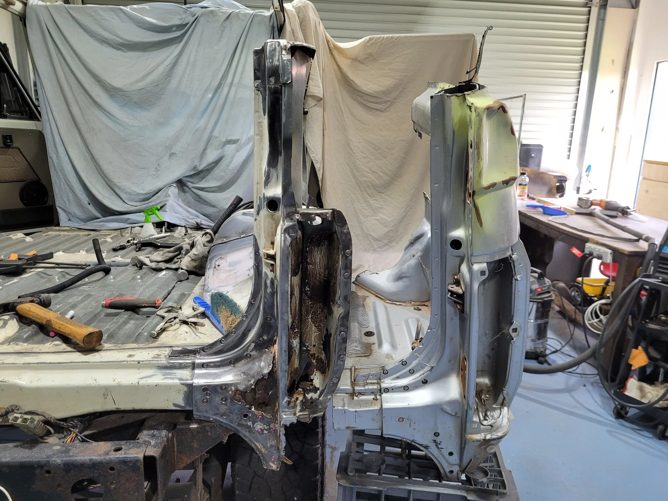

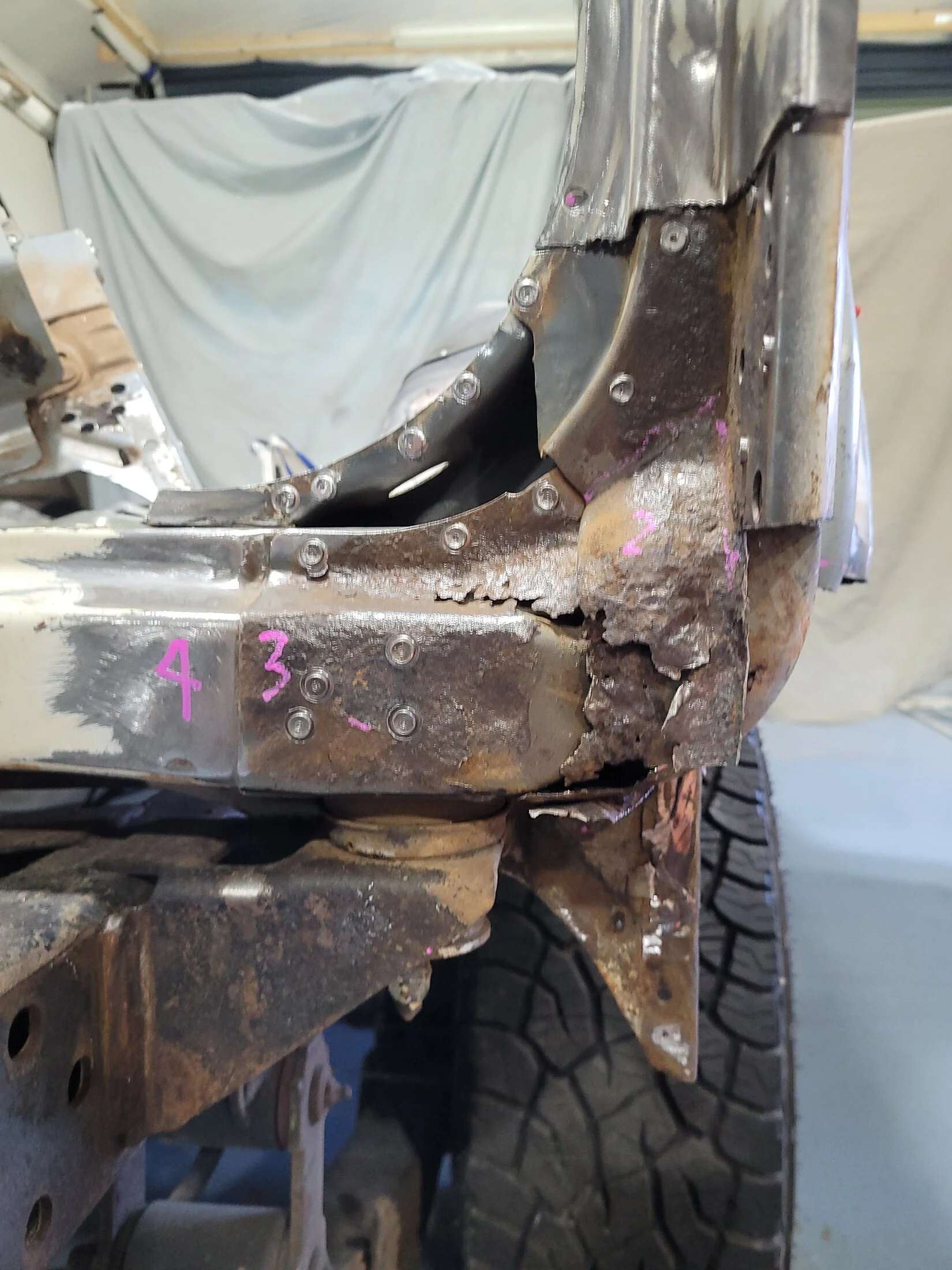

Few spot welds later and I've got the outer upright cut. Didn't want to have to re align the door mounts if I don't have to. It's quite a heavy peice of steel that's eaten away.

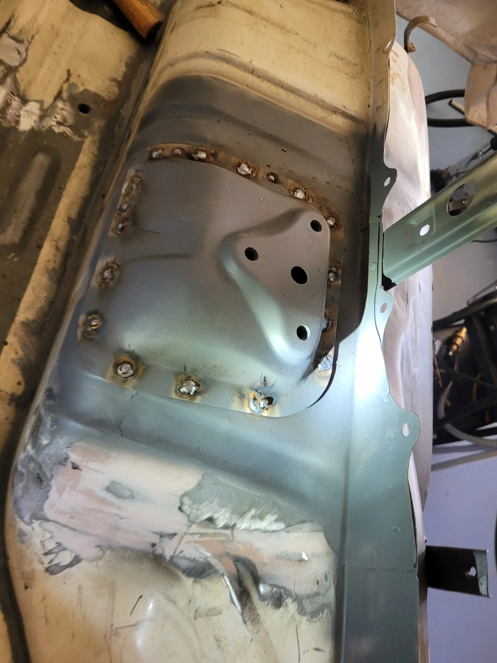

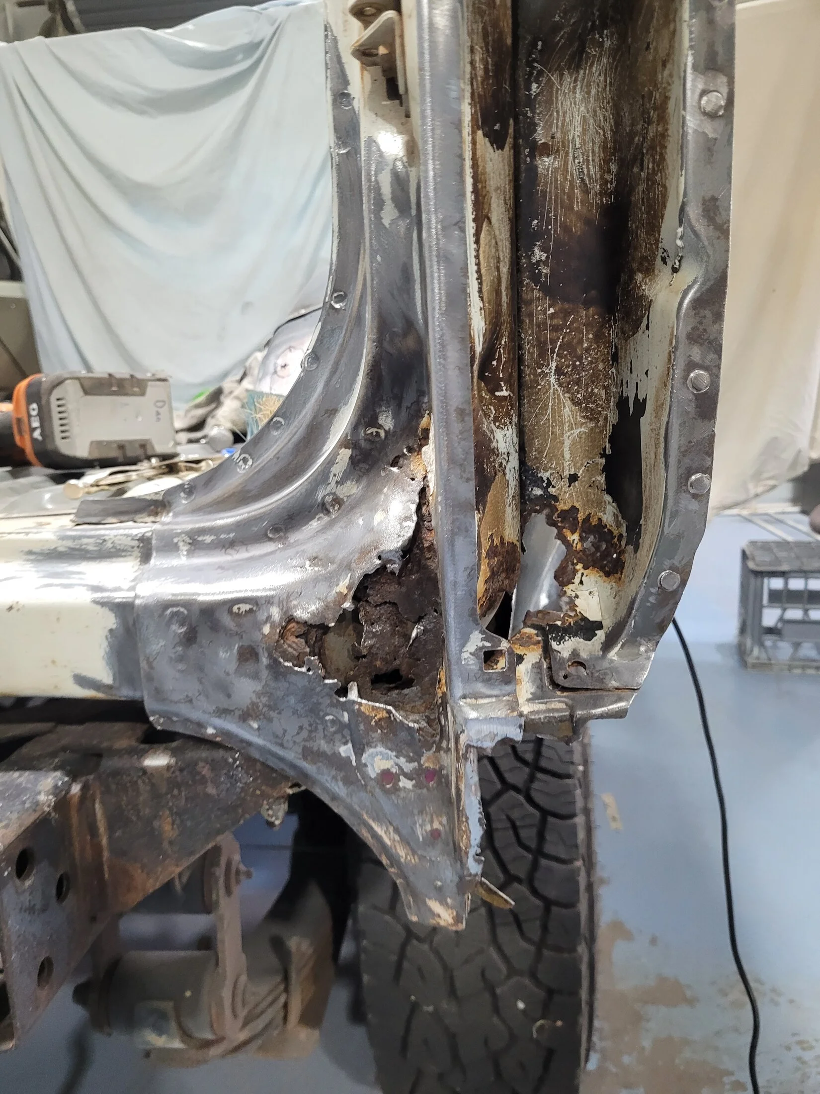

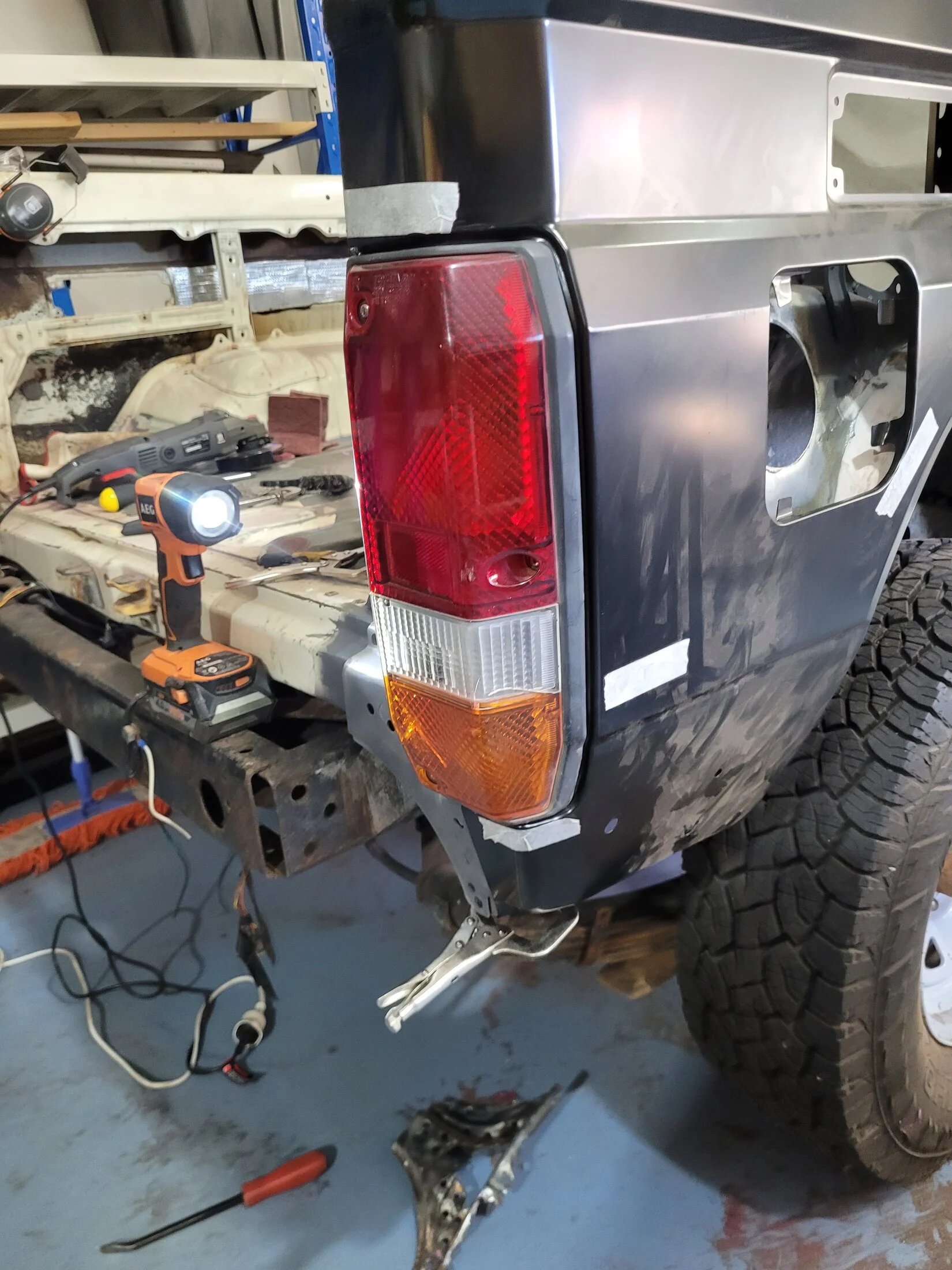

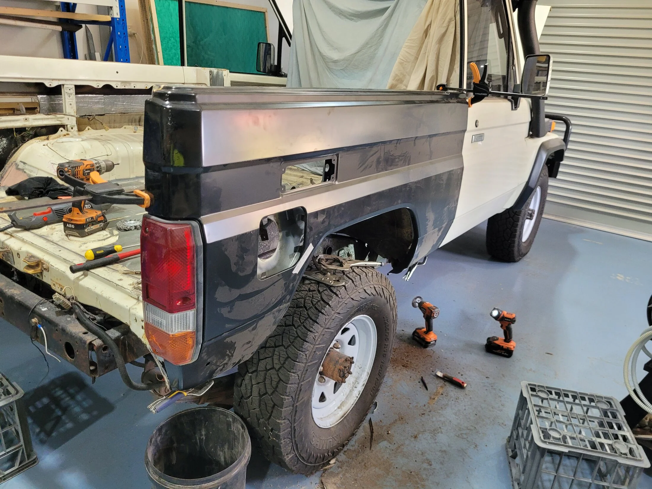

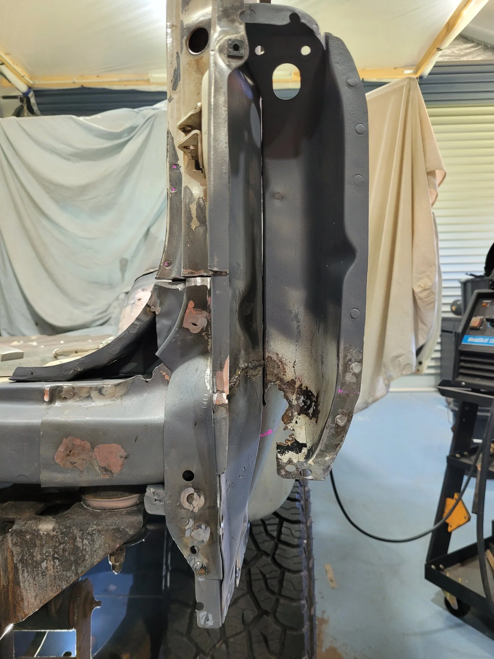

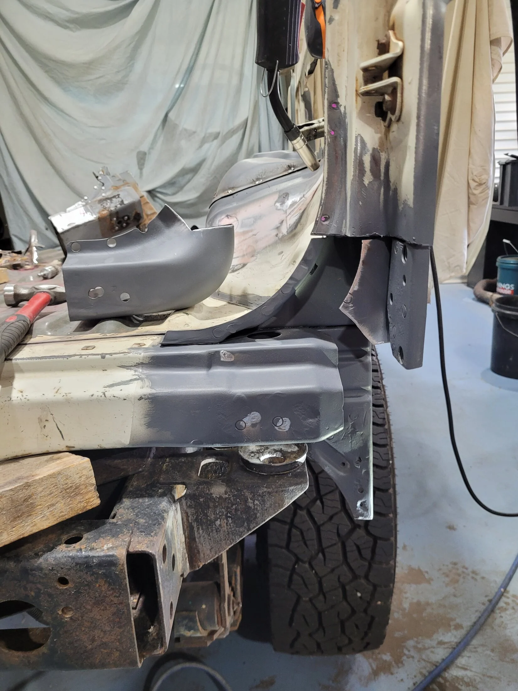

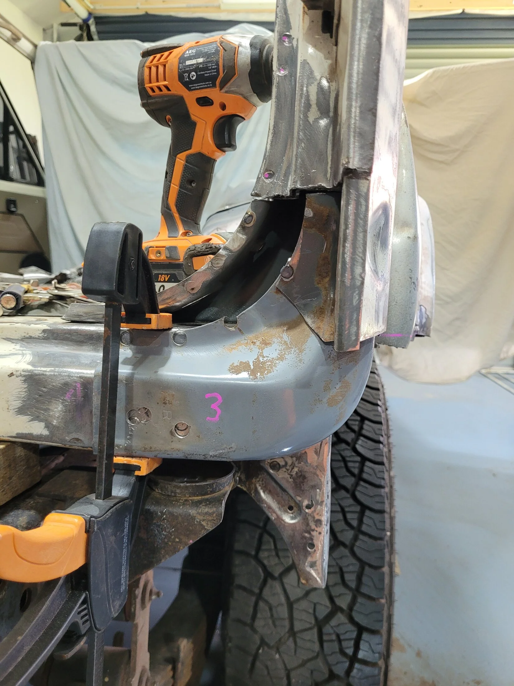

Only small wins today. Got a plan on how to tackle the jigsaw. I'll have to take off the tail light housing to cut behind the main upright. Needs to be stitched in around the 'B' mark whole peice is just gone below body level
Almost finished the back corner. Forever test fitting to check the tail light alignment. I can see how these rust out so easy with the gaps under the tail light. If it's not sealed well it will collect crap.
