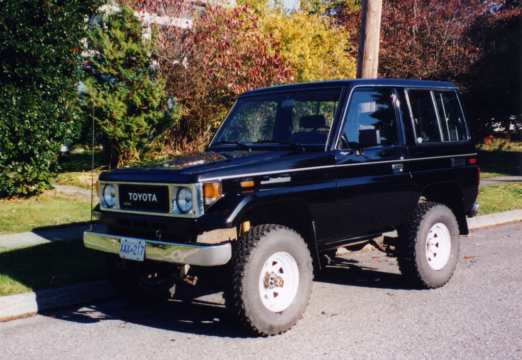

My old 70 with fresh, original Emus in all its glory :lol:
255/85R16s:

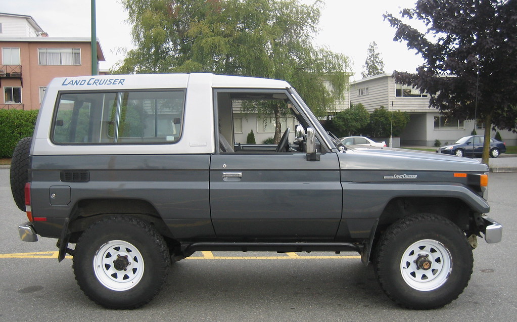

and my 74 with fresh "new" Emus, same tires and wheels:
