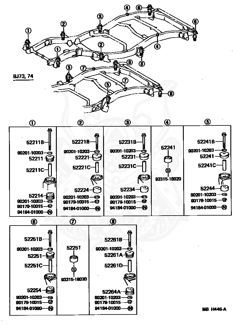

Hello. Yup, the body mounts are crispy bits. 1985 BJ70. Would like to replace them and am have some troubles sourcing parts. If you have some advice, please let me know. Looking for rubber for bushings #1, #2, #3, #4, and #6 in the diagram. (parts, 52211, 52221, 52231, 52241, 52251, 52214, 52224, 52234, 52244, and 52254). Much appreciated.

Can't tell from your post if you have the full part number for the bushings so just in case here they are:
52211CUSHION, BODY MOUNTING, NO.1 UPPER
52201-250202
52211BBOLT(FOR BODY MOUNTING NO.1 CUSHION)
90105-101032
52211CSPACER(FOR BODY MOUNTING NO.1 CUSHION)
90440-170212
52214CUSHION, BODY MOUNT, NO.1 LOWER
52202-250202
52221CUSHION, BODY MOUNT, NO.2 UPPER
52203-600202
52221BBOLT(FOR BODY MOUNT NO.2 CUSHION)
90105-100392
52221CSPACER(FOR BODY MOUNT NO.2 CUSHION)
90560-122332
52224CUSHION, BODY MOUNT, NO.2 LOWER
52204-600202
52231CUSHION, BODY MOUNT, NO.3 UPPER
52203-600302
52231BBOLT(FOR BODY MOUNT NO.3 CUSHION)
90105-100392
52231CSPACER(FOR BODY MOUNT NO.3 CUSHION)
90560-122332
52234CUSHION, BODY MOUNT, NO.3 LOWER
52204-600302
52241CUSHION, BODY MOUNT, NO.4 UPPER
52209-600202
52251CUSHION, BODY MOUNT, NO.5 UPPER
52201-250202
52251BBOLT(FOR BODY MOUNT NO.5 CUSHION)
90105-100392
52251CSPACER(FOR BODY MOUNT NO.5 CUSHION)
90440-170212
52254CUSHION, BODY MOUNT, NO.5 LOWER
52202-25020

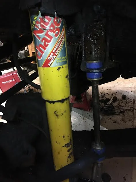

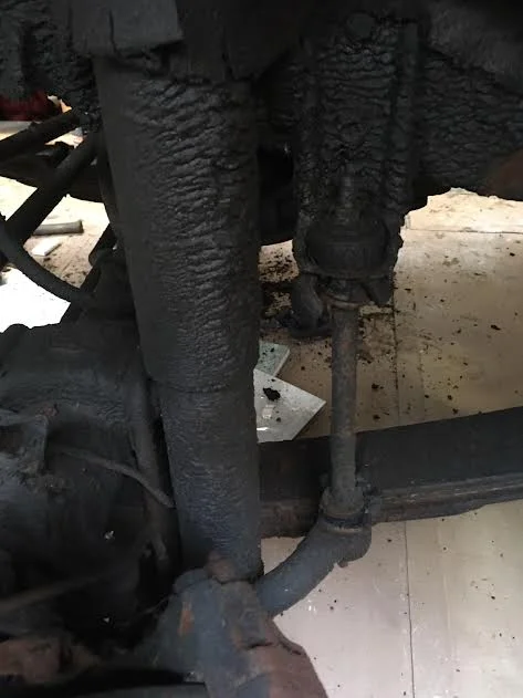

Liked the video and the amount of 'hand crafting' used. In the meantime, changed out the link bushings and scrape away 20 years of rustproof undercoating. Before and after pic attached. Gave me a chance to have a good look at the body bushings, too. Will order a kit from 4Crawler Offroad.
