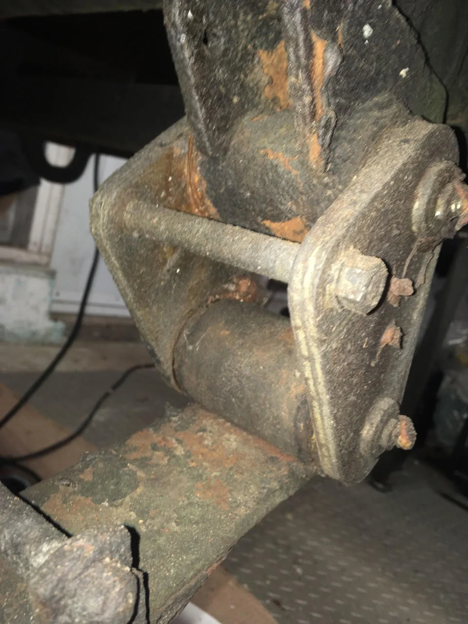

Hello 70's. We are not too familiar with lift kits and/or original heights of the body and leaf springs. 1985 BJ70. Would anyone be able to tell us , in the pictures attached, is that an original lift or is that an aftermarket addition? Thanks for the help.
Hi i4c. Is this something to leave on (we don't off road), shorten to lower the height of the vehicle (if we wanted to lower it a bit), or just don't ever touch on account of painful death and destruction...:).
I had to you-tube "anti inversion shackle" and now understand:
Did you just get the cruiser? I would drive it for a while to make sure you really want it lower before going through the work. In some respects, the aftermarket shackles are actually better than the OEM ones as these can be greased to reduce "bushing binding". Once this happens, there is less movement in the springs, and you end up with a much rougher ride.

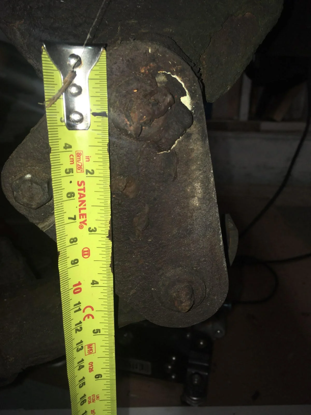

It looks like from the size of the shackles on there, you would only lower the entire truck by around 1" by replacing them with stock ones.
Now if the leaf springs are also aftermarket, the average lift in the springs would be 2". But we would need to see and do measurements of the entire truck to determine.
Hope you find your way in dartmouth! :D

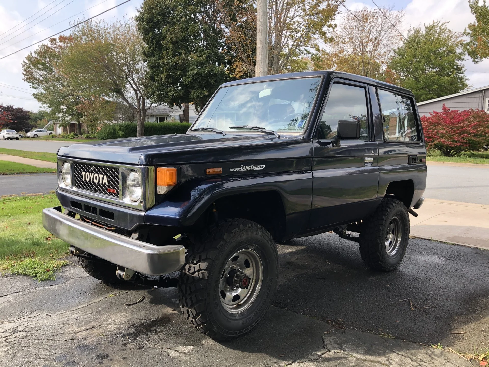

Hi Rigster. Looks like you are in Vernon. Lovely country. We are heading to that area this July for downhill mountain biking... In the meantime, to your question: Yes we just bought it last month. Seems overly high for the 235/75/15s on it. Could go for a larger tyre size....but we will see. Photo attached to give you some idea without true measurements yet...

Just based on the picture (nice 70!), I would have to say there is an aftermarket set of leaf springs in your cruiser - most likely 2" lift.
If you are set on lowering, I would recommend grabbing up someones originals from the forum that are in decent shape and use the same aftermarket anti-inversion shackles. This way you retain the greaseability of the bushings. Take the opportunity to put new bushings in if you go through all that work!
But I would still drive it for a while! :)
