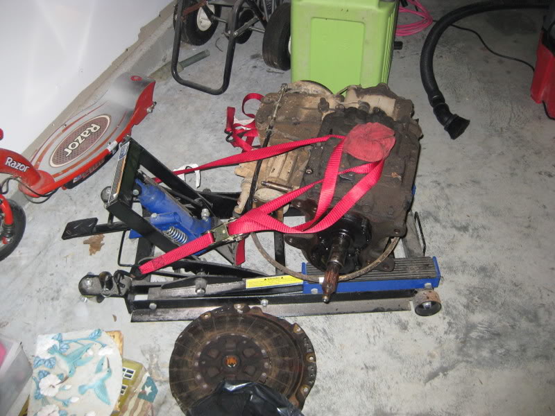

Tranny/transfer on my custom tranny jack :D (dirty).

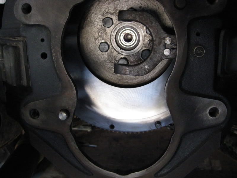

A little scotch bright and the pilot bearing fits great.

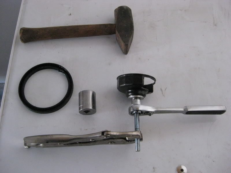

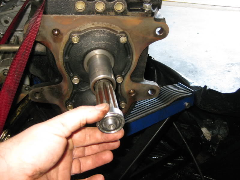

My persuaders and pilot bearing removal setup.
Another of the pilot bearing remover :)
Next up is the input shaft seal install...still thinking about how to do this one.

Glad you were able to get the pilot bearing issue resolved, you had me thinking on that one, though it's been some time.

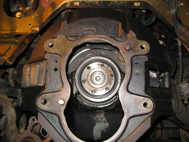

Got the inside and out of the bell housing cleaned up.
A shot of the new rear main and pilot bearing installed.

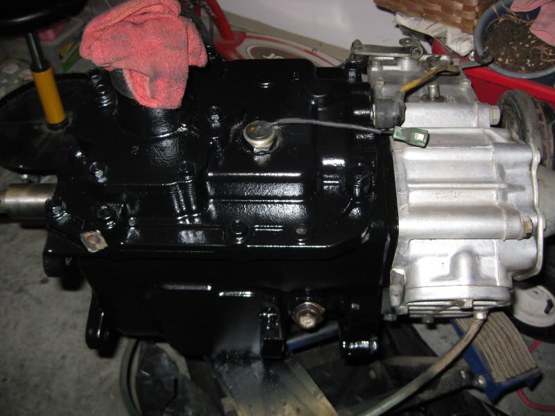

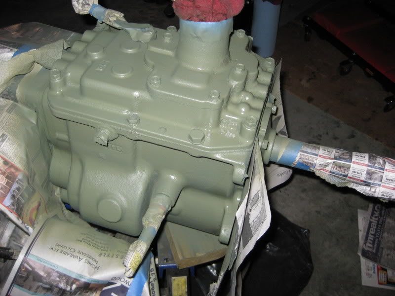

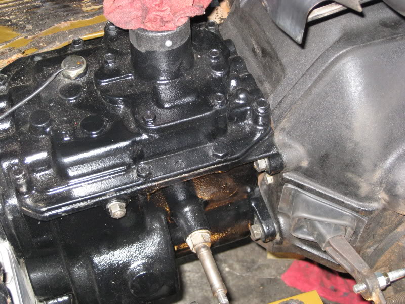

Decided to go ahead and prime and paint the tranny so here is a shot of that...no it is NOT professionally done although it appears that way from the spray booth :D
Next up is scotch bright and another coat or 2 of primer then plastikote semi gloss black...then on to draining the oil, dropping the pan, cleaning and painting the pan...then fighting with the new OEM gasket :D

Tranny painted...
Hi All,
OK, the tranny is painted now. I just got the oil pan off (that was a pain):bang:. Now I am trying to get the gasket cleaned off which is now petrified. Using gasket cleaner and letting it soak.

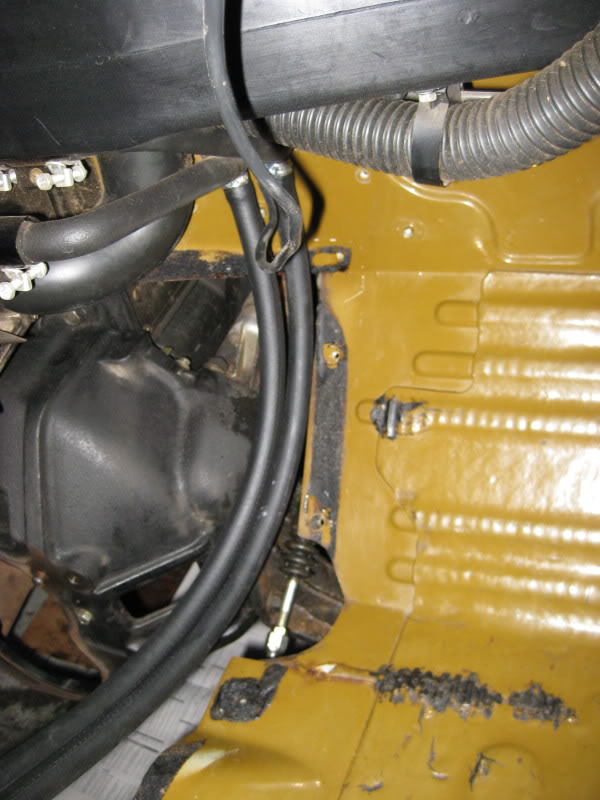

- pulled rear heater (what a mess) had cracked the hard lines a little.
- New 1/2" line for rear heater installed (according to the performance place, this is made for fuel, heater hose and coolant lines for tranny coolers and should be better than fine for heat and pressure).

New lines installed for rear heater
Old lines and rear heater out

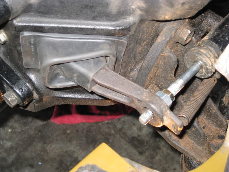

New clutch fork boot installed.

New rear heater lines routed.

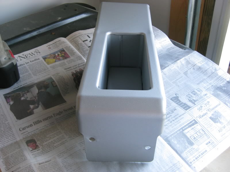

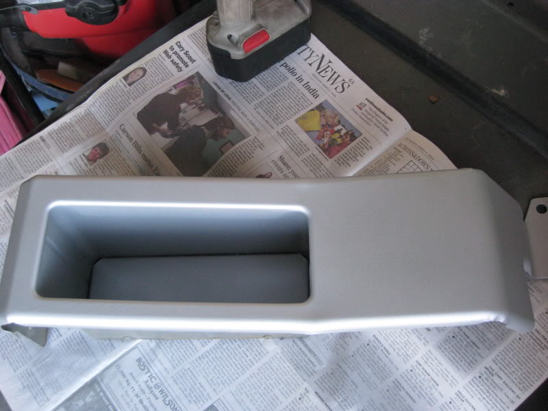

And went ahead and sanded and primed the console while I had it out, yeah, I am a little anal.
Now painted up (plastikote cast finish, pretty close to original color).
