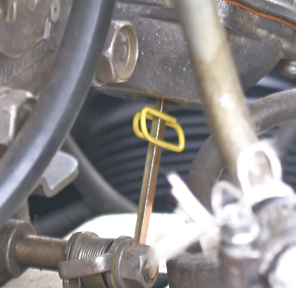

Once bucking, you can shut off the engine and coast to the side of the road and see that there is zero fuel in the sight glass window on the carb. Start the truck up, and carb will refill properly at idle. I can now recreate this issue in 2nd, 3rd, and 4th gears. It's RPM based. If I drive long enough in 2nd gear at the same RPM that it takes to achieve 40mph in 4th, it will also starve the carb.

- replaced the fuel tank for brand new OEM unit (original was leaking from the seams, so it needed replacement anyway)
- ran a temporary 5/16" soft fuel line from tank to fuel pump in case of suction line obstruction
- installed brand new OEM fuel pump
- pulled carburetor apart and set the floats to OEM spec
- blocked off fuel return port in case it was allowing too much to bypass the bowl
- pulled the "fuel cut-off solenoid" and cleaned it, ensuring that it works (it does)
