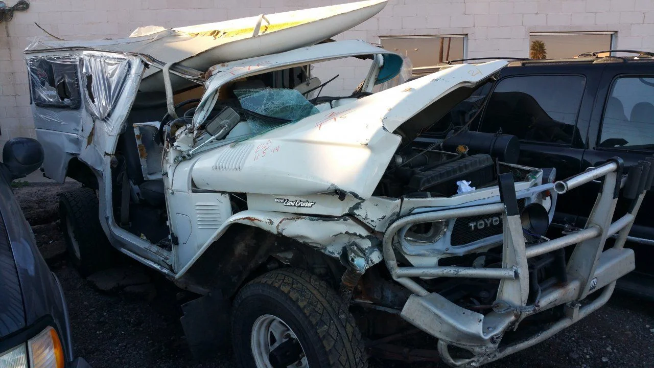

This beauty showed up in a local junk yard. While I will had to do modify it to LHD I got the extension vent off the heater. Already had LHD version of the inline evaporator. Advantage of the 3FE I have the A/C compressor is already in place. Condenser coil is still in the wreck but in pretty bad shape. Not sure what valley your talking about but doubt it's as hot as the "Valley of the SUN" (Phoenix). A/C is a must of want to use it nine months of the year.

To this day have never seen an FJ40 in our local junkyards. Would be nice. Congrats.
Not sure my wife feels the same. Been a number if years since the 40s in junk yards dried up. Prior to that they were pretty easy to locate. At one time know where at least fifty were. Mainly 70s FJ40s a few 55 series and few 60 series. Once found FJ25 transmission and transfer. But that was probably better then ten years ago. This late model HJ47 would have been a rarity even back them. It does surprise be as big as Phoenix the few number of 40 owners who are interested in keeping their 40 series stock or modify it using LC parts. While most the body is trash there are some pretty rare parts there for the US. Being local I didn't ask if they were willing to ship small items but Large items I know they would. The 2H was still available I believe. Believe the rest of the running gear is gone.
