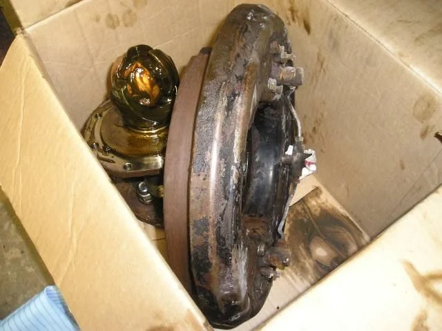

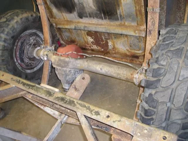

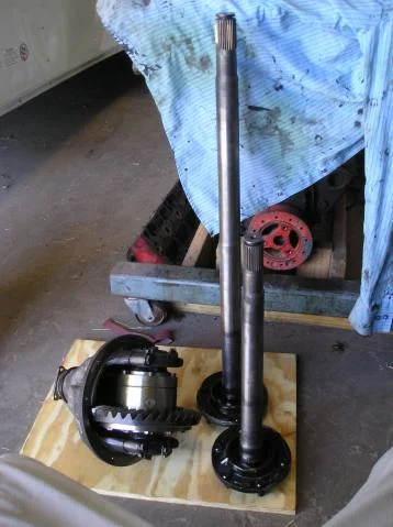

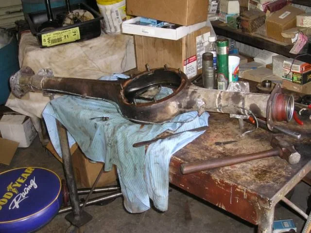

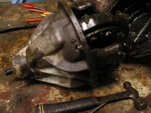

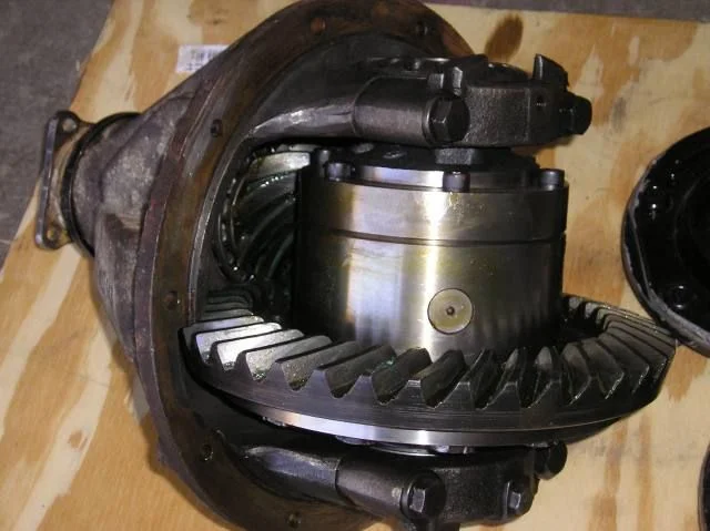

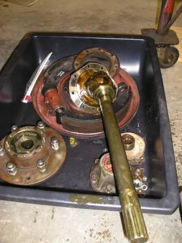

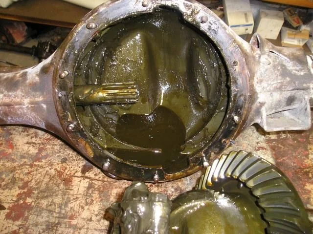

Started working on the Front Axle next....

Man, that is coming along really good. Keep us updated and keep those pics comin.

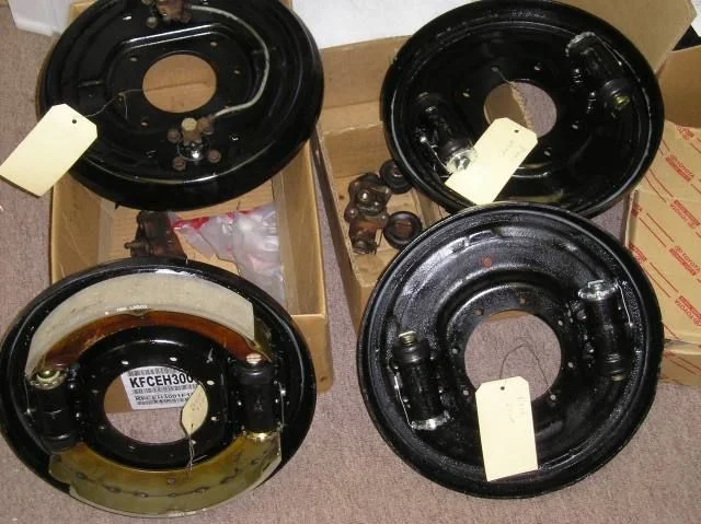

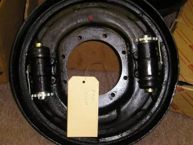

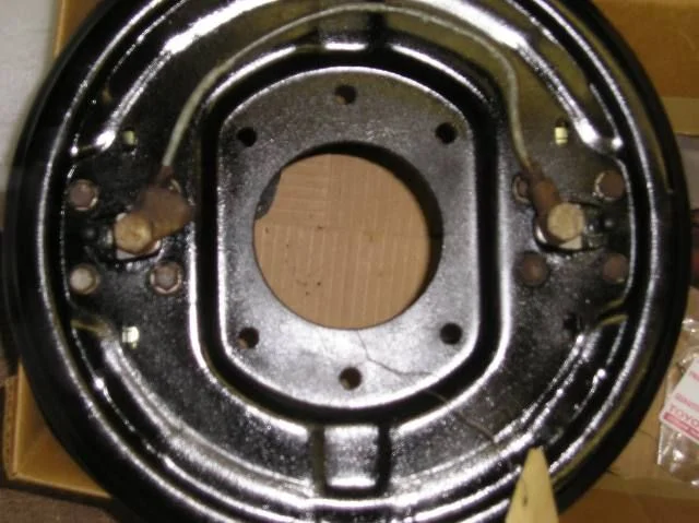

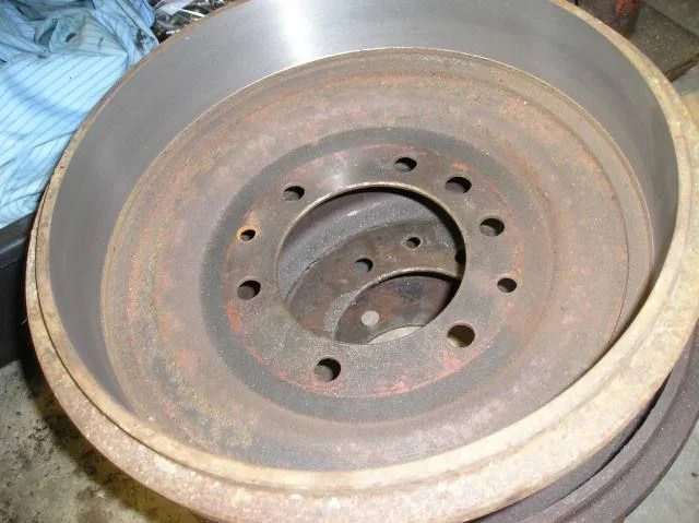

I started going through the brakes next..
Put all new:
-wheel cylinders
-shoes
-return springs
And on the drums and drum plates I did a little prep with a wire wheel, then painted them with a galvanizing compound, and then a high temp paint.

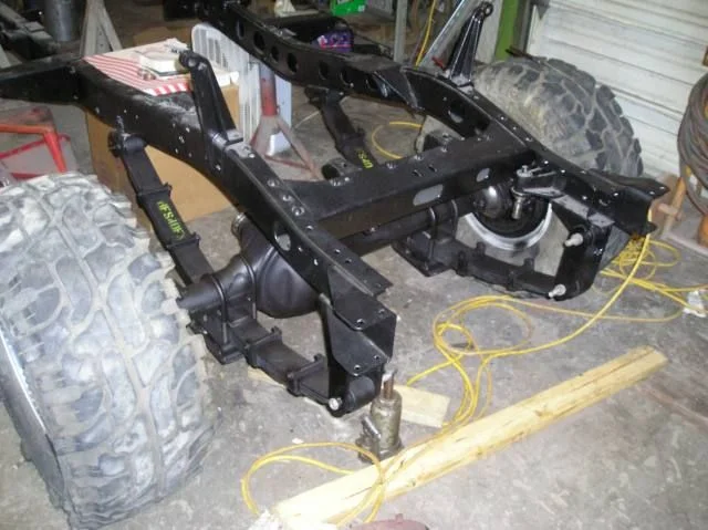

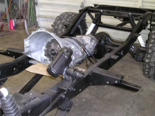

After the two axles I took the tranny (TH350) to be rebuilt. As I came to find out I didn't have some of the special tools needed.
I used a Raptor rebuilt kit, so I guess it can be considered a Raptor Transmission.
This is a pic of the T-case and tranny installed along with the axles, suspension, and driveshafts, steering, and Mini - truck powersteering.

are you leaving the ball and claw front end in the truck with a 350 .... i mean i know that the ball and claw stuff it pretty strong but 350 strong?
I guess i should of read a bit more
406 SBC "Muy Torque" - Completely Rebuilt
Aug 6, 2005
1,641
Corpus Christi/Austin, Texas
I'm really not to worried about the brakes. I know that I will have to push hard to stop, but it's a Landcruiser not a Camry.
I also know that the front axle is weak, especially with the 406. I left it open diff in hopes to keep it together. When I was done rebuilding the front that is when I discovered that it is not that strong. So for now I'am going to go by the saying "Don't fix it if it ain't broken."

62 Dust Collector said:
Do you have your own parts washer to wash all your T-Case parts and what not for your axle? And yes why didn't you go with a newer style front end?
I used alot of solvent, a wire brush, a file, and a bunch of time.
It was so dirty when I dropped it from the chassis I couldn't tell it was aluminum, except for it being susprising light.

It might be something to consider to go with at least front wheel disc brakes, seeing as you are running 35" tires. At least do it for safety reasons. Looks like you are doing a nice job on your build up, cant wait to see it done.
35" tires with drum brakes = :crybaby: :doh:
