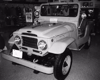

So was just reading that this was one of 58 Toyota's imported to the US that year (it was traded in by it's California owner for a new Toyota).
The Toyota Company bought it for their museum, and restored it. What I see is a round chrome mirror. Doesn't seem original, but I can't find out what is. Tells me they didn't restore full on...
