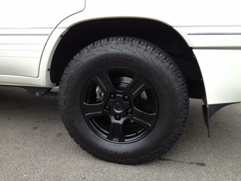

Which center caps are these?
Can someone help me determine which centercaps that arbetrader is using on his wheels? I was able to pic up a set locally for cheap but cannot determine which caps to use.
Thanks in advance,
Spencer
Yes, this is correct, they are the standard 16" LX caps.

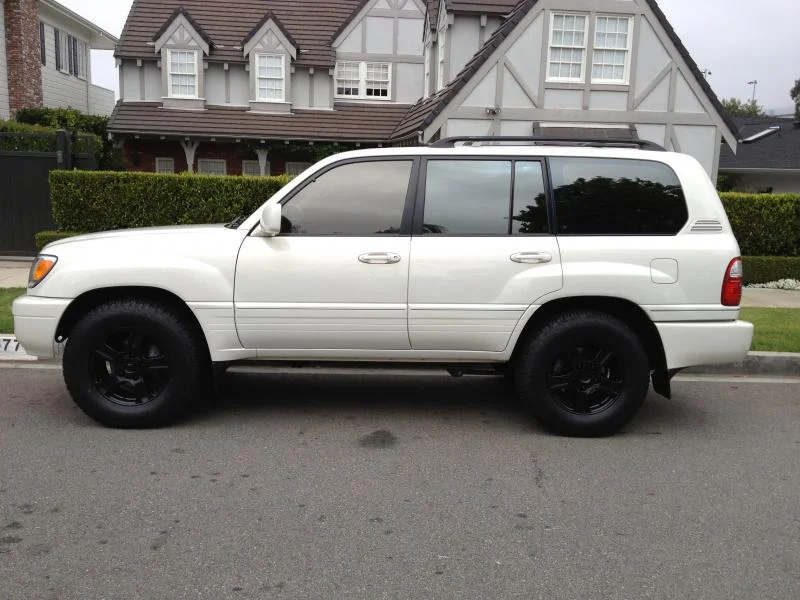

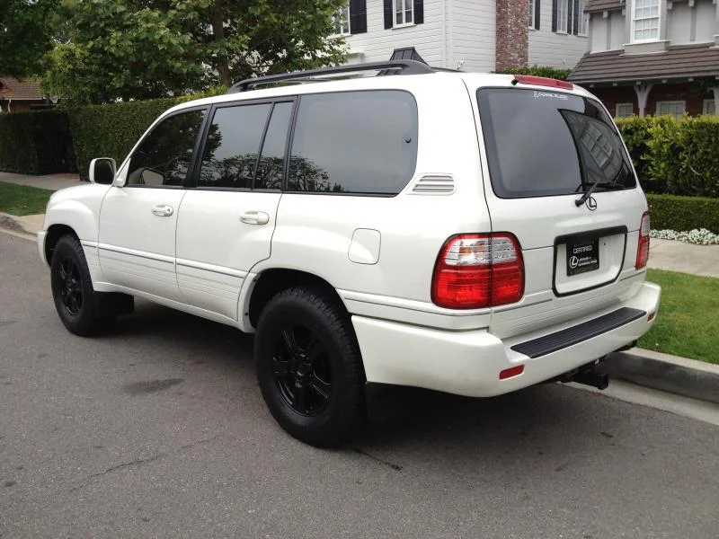

so after a while of running the TRD wheels a set of the other ones showed up on craigslist and I couldnt resist. Have to say I do preffer them over the other ones and have to agree with those of you picked them originally.
Roogle, close ups of the fronts? Please?
Do you use spacers? My hubs stick out too far for those caps.
More pics would be great, did you rattle can your lugs or find some blank ones somewhere?
Looking for a set of wheels for my 2004 LX470, will all 5 lug Tundra, 4 Runner and Tacoma wheels fit? Same off set? Will stick with stock wheel size 18" and very close to OEM tire requirements. Found a nice set with MICHELIN TIRES 275/65/18 A/T 2s for $1099 on Craigs List locally. My OEM wheels are good, but some light paint issues and tires need replacing, so I will store the originals to go with the truck when I sell it. Here's the wheels:
I'm putting a set of those wheels on my '99 in a couple weeks but a slightly larger tire.
275/65/18 will fit no problem - a little over 32 inches.
