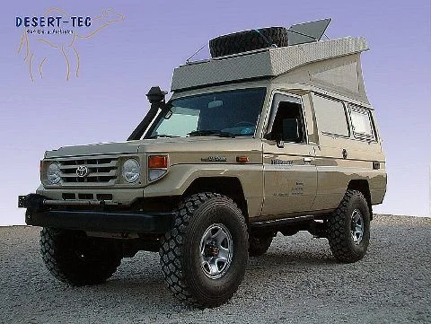

It is close to impossible to get the XZL's here also. I have been lucky to get in touch with the right people. A friend and I ordered 5 each, and we were told that they would only produce 100!!! Don't know if they meant 100 for the Norwegian market, the EU-market or whatever.
HZJ 78 on 9.00-R16:
