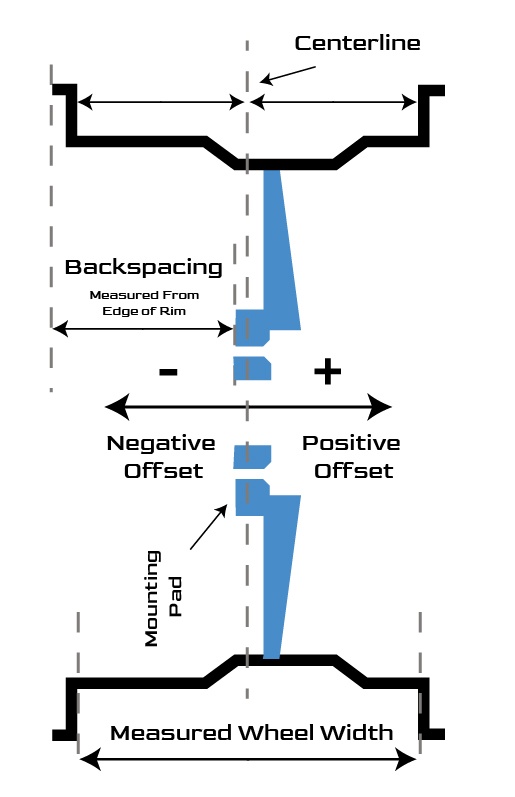

Reading that these trucks on need a 22 offset and these rims are 33, so should be fine without any spacers, no?
Below I’ve attached an offset to backspace chart, as well as a calculator. For these trucks, you want 3.5” or less backspace to be safe. I’ve heard some running up to 4” backspace but haven’t seen their specific setup. For reference, I just ordered a set of Braid 7” wheels with a -20mm offset for my 1992 FZJ75. I’ll have them mounted in the coming week or so. Negative offset pushes the wheel further out away from chassis centerline, positive offset brings the wheel closer to chassis centerline. Hope this helps.

Thx, so based on this calculator a 7" rim with a 20MM offset would have a backspace of 4.79, so are you running spacers for your new wheels?
My offset is -20mm so my backspace is approximately 3.170” with a 7” rim. With that no spacers are required. Back to your original question, I bet those rims will be fine but might stick out past the fenders depending on the tires your run etc.

Stock is generally 3.25" BS but you can get up to just under 4" BS.
Anything between 3.5" BS and 4" BS will possibly cause some minor rubbing issues depending on your overall suspension set up. If you go to far inward on the rear, it will rub on the body which will happen if you are cutting it close to 4" BS. If you have factory flares, you will want spacers or it will look weird in the 3.5"-4" range.
None of the wheels mentioned here will work without spacers and there is no OEM wheel in that steel wheel style (w/ holes) that will work perfectly without spacers.
