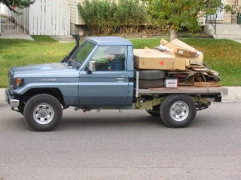

here I stole a pic of them from Crushers post, thanks Wayne!
They are on my 60. but I didn't have a pic of them.
they look great.
42601-60262-03
this is a 16" rim.
nice factory look, and heavy steel to boot. install 235/85/r16 size tires and your golden.

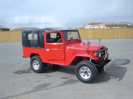

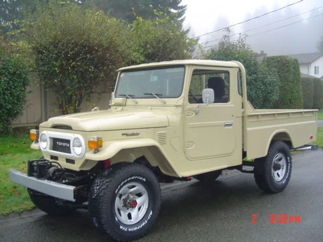

You can order the factory steel 16x6 wheels as shown in the BJ40 and PZJ75 pictures. They are 3.75" BS, which work fine. You lose .5" width over the stock BS'd 3.5" wheels. -03 denotes the grey color.
