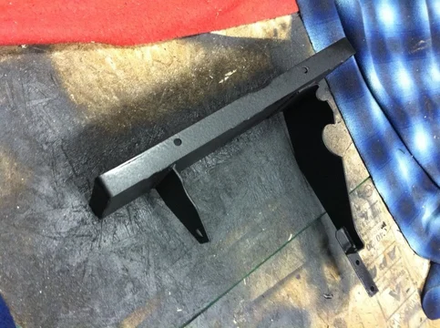

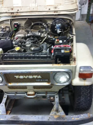

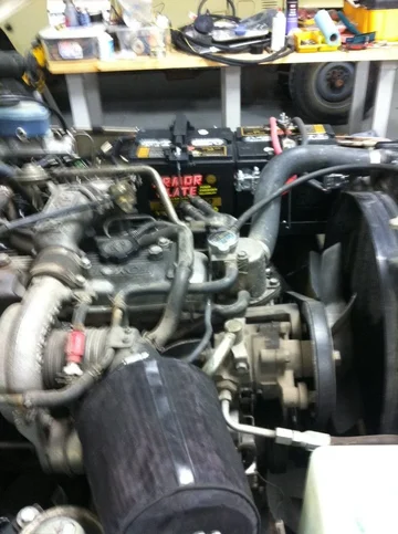

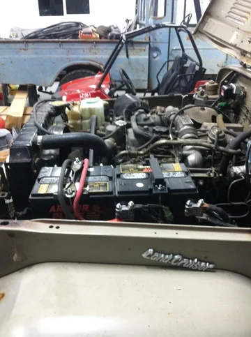

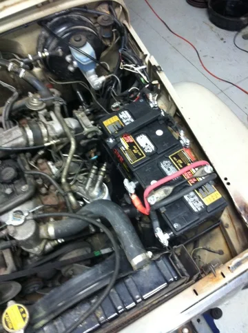

So, just a quick update. I haven't had time to do much with a controller yet, but I did have a chance to install dual batteries which has made a huge difference for starting in the cold. Attached are a few pictures of the progress. As soon as I do something with the glow controller I will post that as well.
Scott
