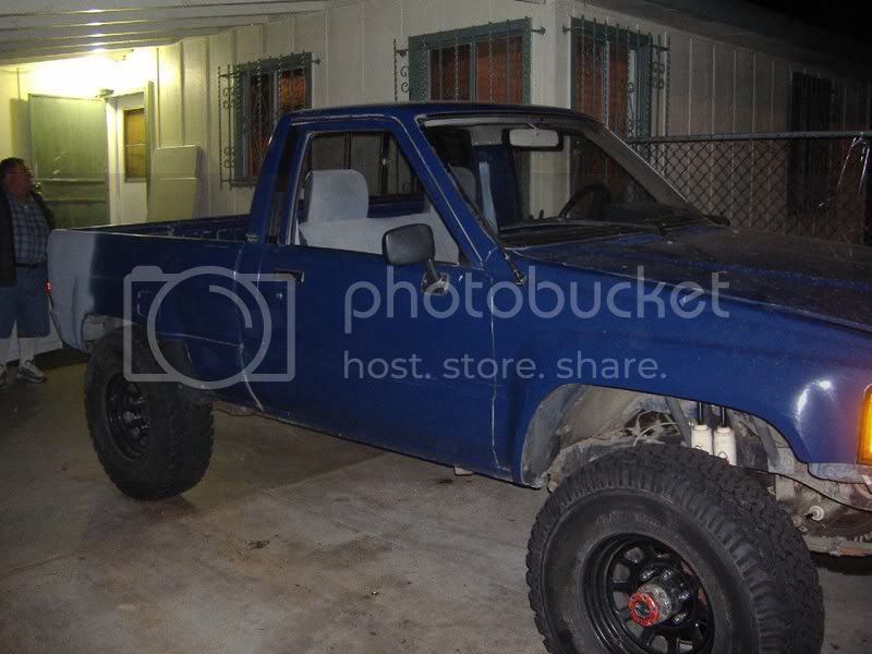

So yesterday I bobbed the bed, a whole 13 inches.....
8 hours of hard strenous work- Thanks to my two brothers, I couldn't have done it w/out your help-

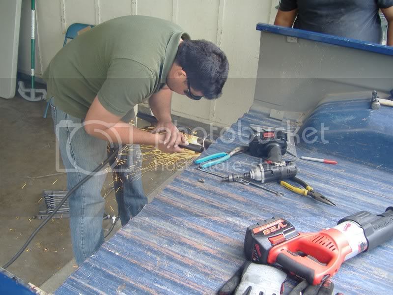

A small write up- tools needed
Sawsall- a corded or 28 volt unit
Welder- A mig welder
Plasma Cutter- For cutting frame
Grinder- For grindng welds and finishing body work
8mm, 10mm, 12m, 14mm, 17mm wrenches, ratchet and sockets
Block Sander
Bondo Filler
Four to five metal cutting blades for sawsall
Assorted sanding grits and grinding disk- from coarse to fine
That is a list of all the big things- but you get the point-
On with the pics:

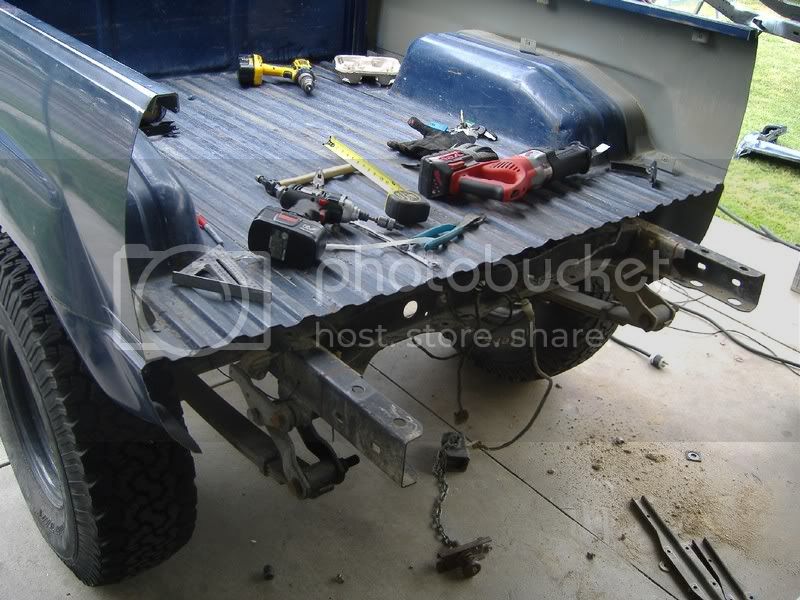

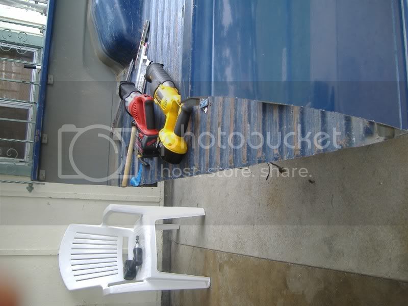

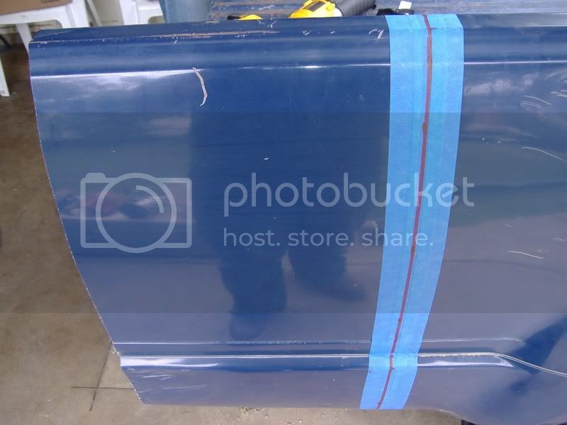

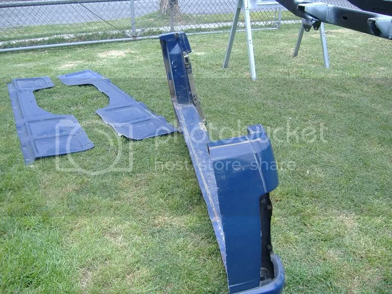

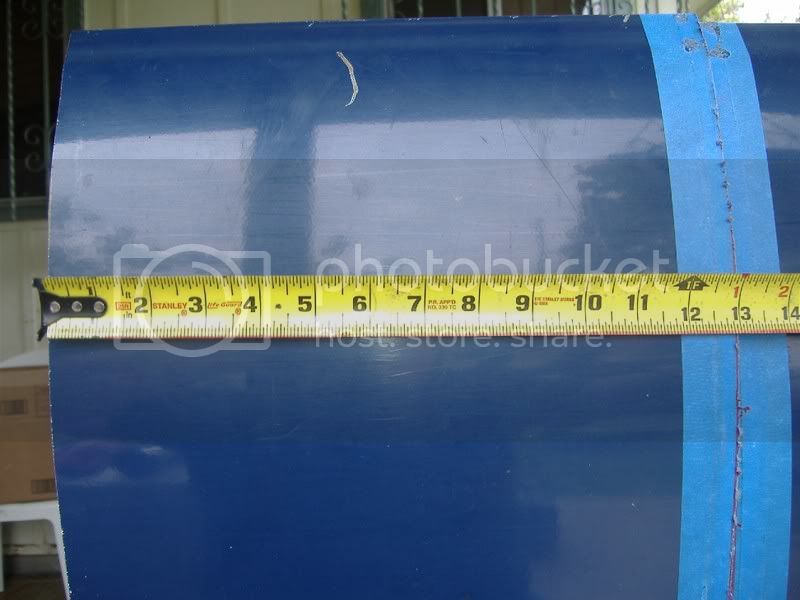

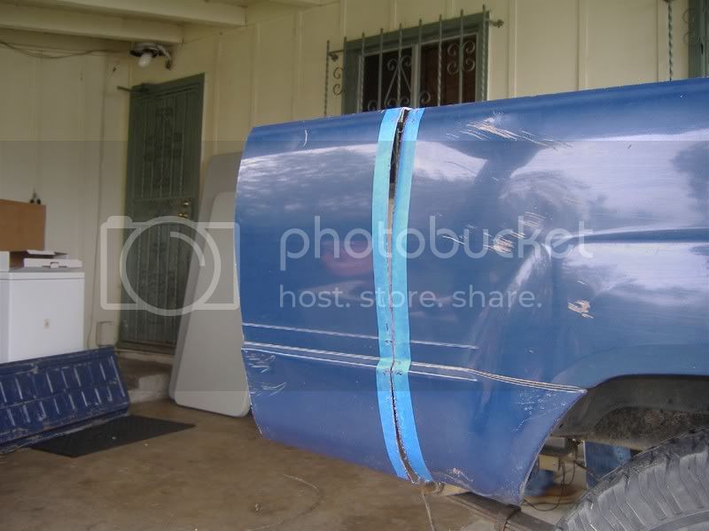

Cutting Off Tailgate/Light Setion

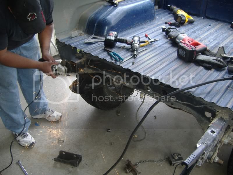

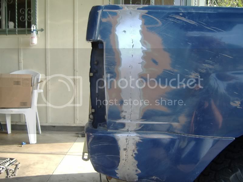

The Second Cut

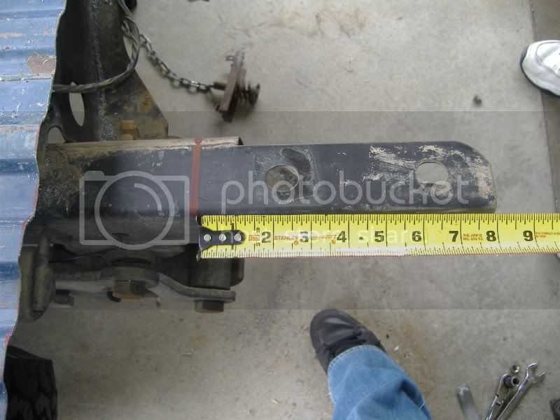

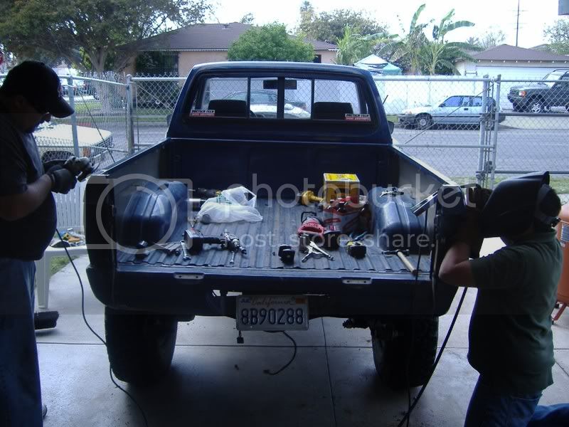

Bed Cut Off Prep For Frame Cut

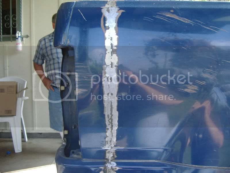

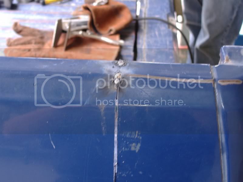

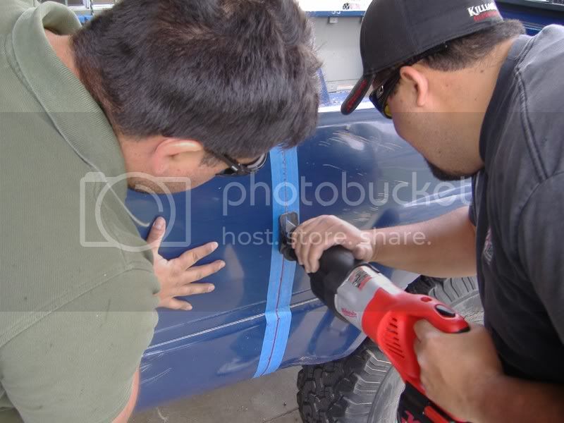

Taching On The Tailgate Section

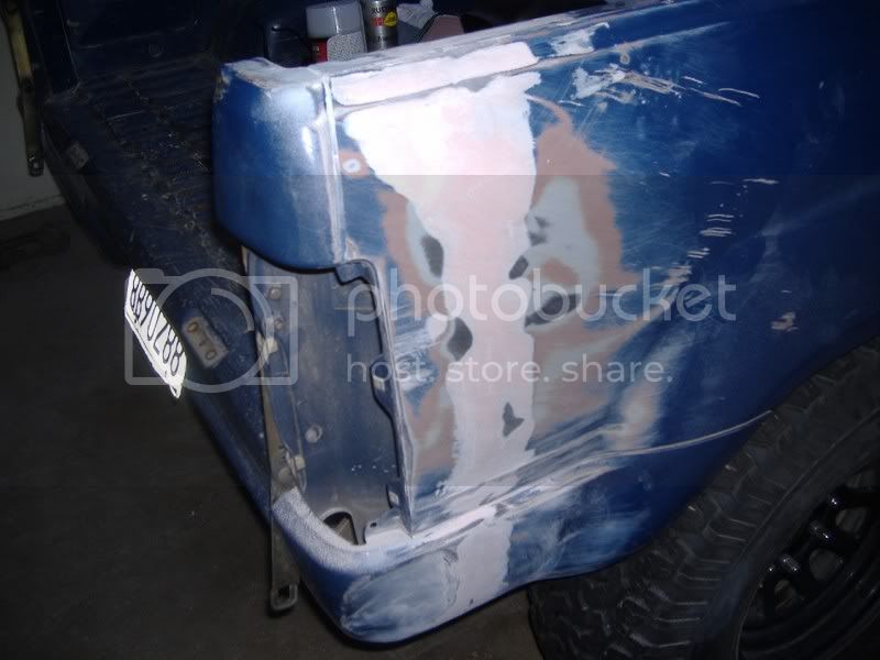

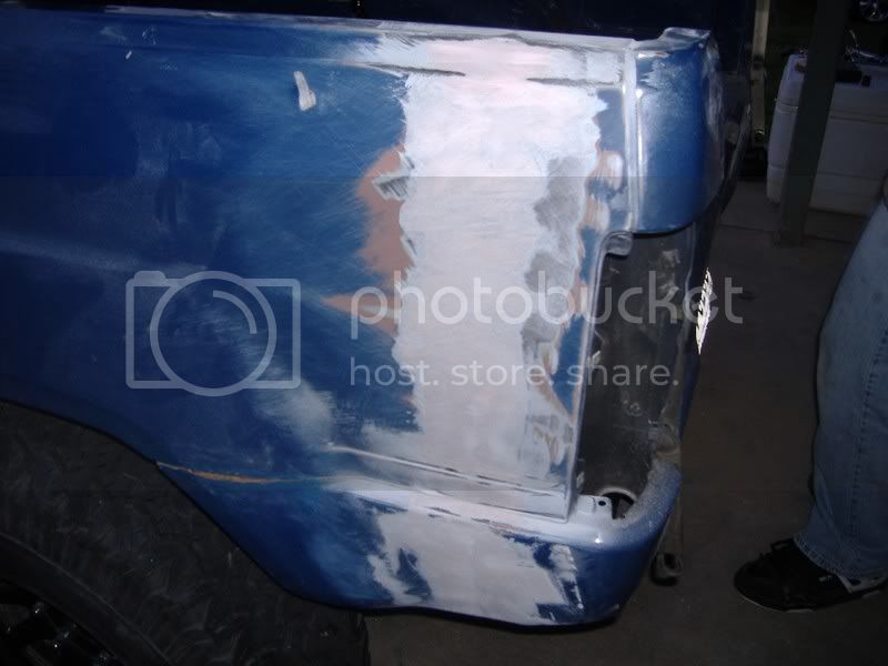

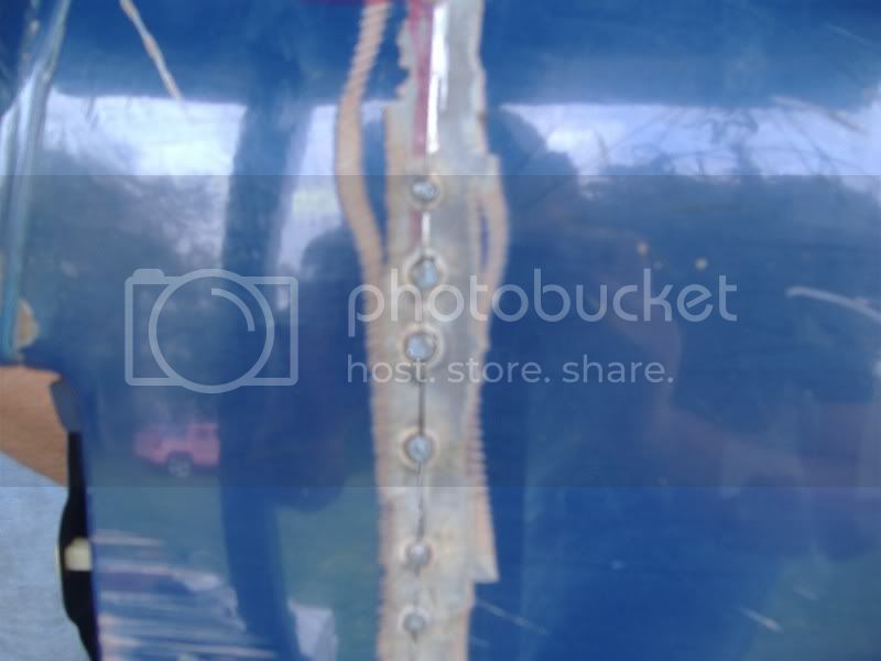

Cleaning Up the Welds W/grinder

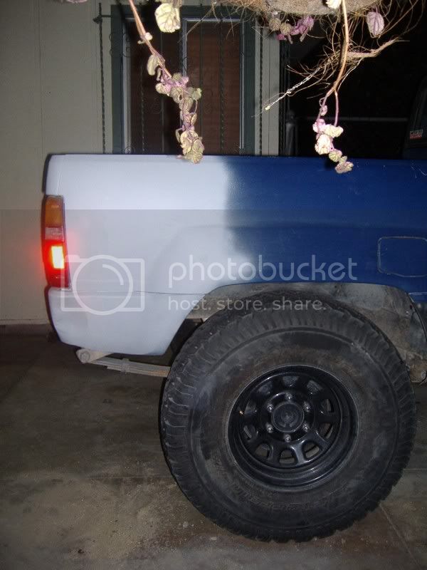

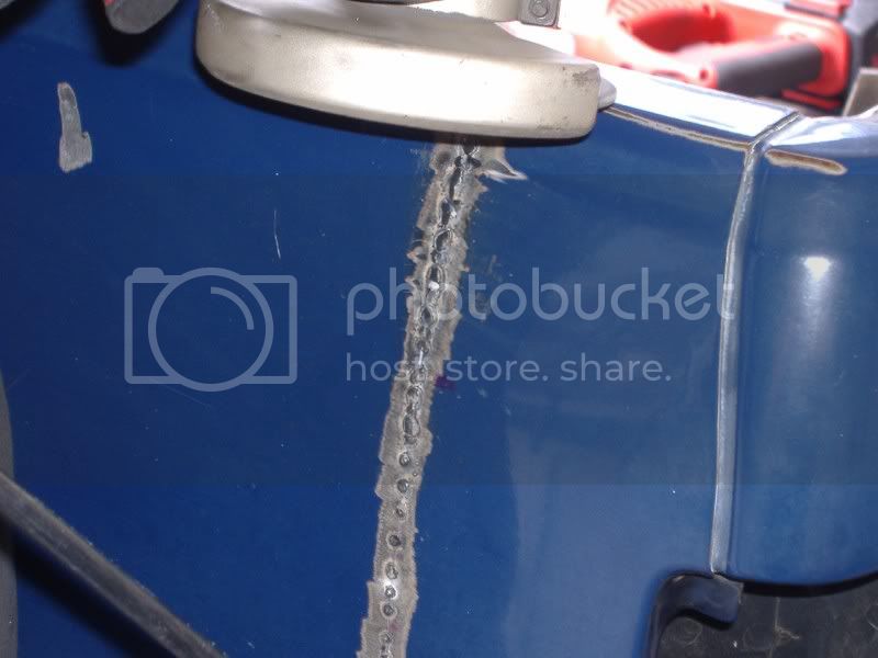

W/Bondo Filler

I was getting hung up on the back of the bed coming off of rocks/obstacles- I didn't have a rear bumper, soooo I said why not hack the back of the truck off....... For it being the first time doing this type of work I'm happy w/the turnout. Still have to massage the body a little but I'm going to lay down some rubberized undercoating on the sides of the bed.

nice. inside of the bed looks good too.
It was a long day but very worth it in the end!!!

I did the same to mine but i went 14 inches 83 long bed the only thing is i had to add some square stock for the chevy springs but looks good man

I knocked mine out in a few hours. This is the third vehicle I've done to date, first my white 85' reg cab for 11 inches in '97, then my red 85 'runner for 12" (don't do this everyone with a runner if you plan on keeping the tailgate and what-not.. max 9.5" or you're notching the fold-down tailgate HEAVILY)in 2000.. now my black 85 reg cab a month ago. I used the sawzall for the frame too. It cut straight and I didn't feel like tugging the plasma from the shop next door :) I went only 8" on this one but it was a short bed and have yet to come close to dragging in on 33's.

Thanks... I haven't wheeled, but i'm on 33'2 and highly doubt I will ever drag my rear nd off of anything. My roll pan i irhgt at the end of the shackle!
