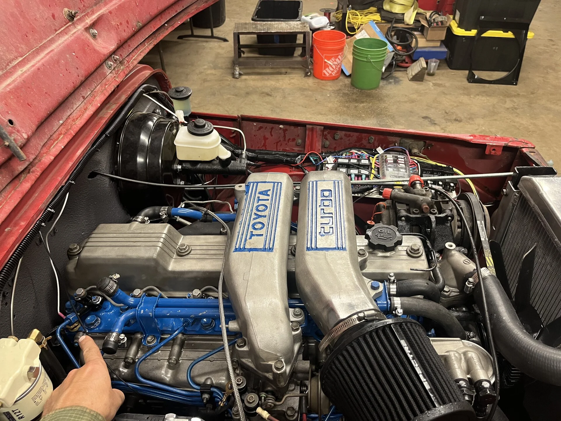

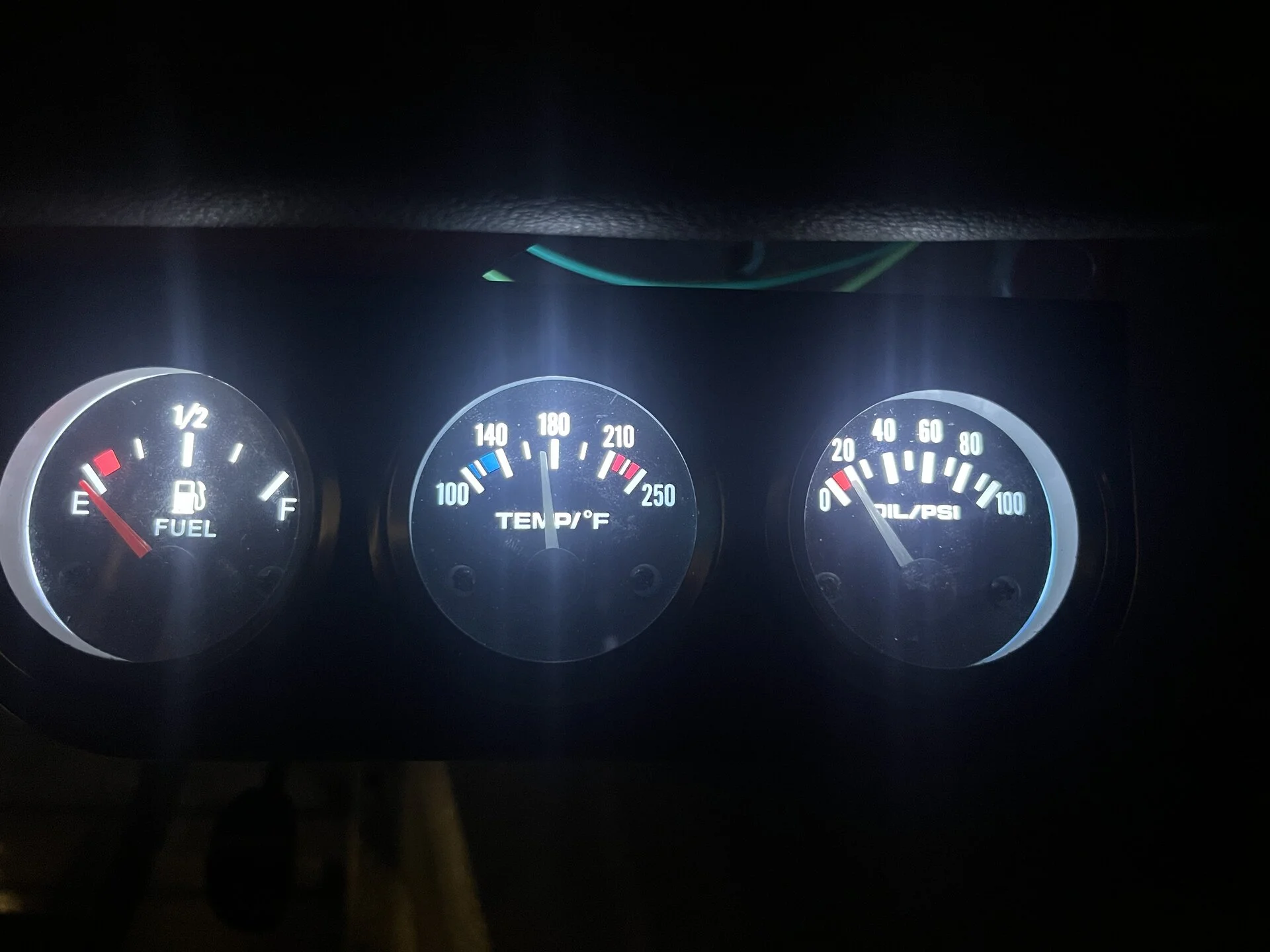

Hi everyone. I’d appreciate your thoughts.
I just 12HT swapped my 40. I’m using an aftermarket temp sender and gauge, and I have it coming from the back of the block.
At idle the engine easily hits 185f (85C).
Just driving around on flat roads, no load, second gear etc the engine maxed out at 210F (98C).
This seems pretty hot for an FJ40 and no load and flat ground.
Is it because of my sensor placement (see photo and finger) ? Is my engine running too hot?

What is the ambient temperature where you are? Not having a fan shroud in place wont help. Have you got access to any other way of verifying temperature?
My factory gauge - at just above half way is 102 degrees celcius ( confirmed by a Redarc gauge and probe in the top of the thermostat housing). I am happy to travel all day sitting on 100km/hr at this temp - and have done so in high 45+ degree celcius ambient temperatures both towing and not towing. I have the Redarc alarm set to 105…
In cooler temps with the same load it will be anywhere from 82degrees up - depending on ambient temperature.
(Freshly built 12ht / manual / genuine water pump and viscous fan (with extra oil in the hub) / HD brass and copper radiator)

No offense but I would not trust those cheap Chinese gauges to be accurate at all, I had the exact same one for a few weeks then installed a nice bosch gauge and the temperature difference was crazy.
Also I would definitely put in a radiator fan shroud, that will definitely help with the temps
