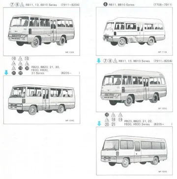

What's a coaster bus? pic?

If you bang Coaster bus into Toyo.diy any time between 1985 and 1990 Japan, you will get a 12HT and 5 speed option. Aparently a lot went to Zimbabwe but I can't find any further information.

After my father in law retired from teaching he drove a coaster for another school in Adelaide for years. That one actually had a 12h, without a turbo.
The coasters are all over the Caribbean and I've seen them in central America but I've never seen one in the US.
that coster bus is just cool! that would make a great RV!
