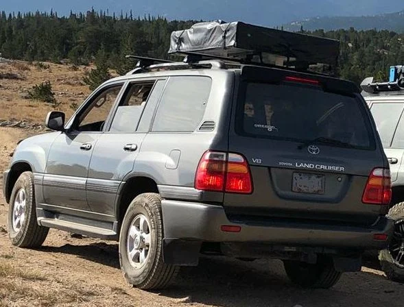

100 series roof rack

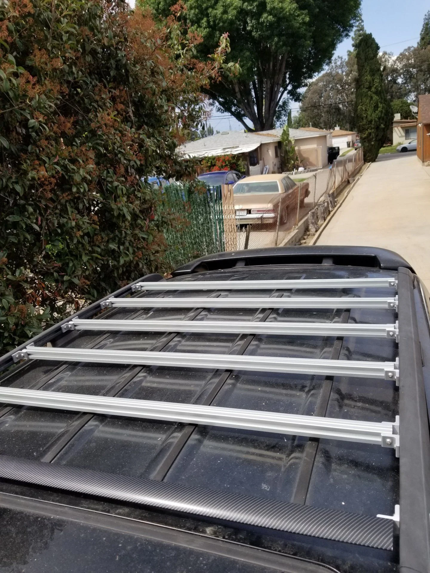

To further hotdiggitydamn's comments, I read that anything adding height to our roofs will further decrease our already sucky mpgs. Also, if you don't use the rack a lot then you will have to take it on and off. So if you leave it on and don't use it you are killing mpgs. I created a lowrise roof rack using our existing rack rails and using some 80/20 extrusion and angle brackets. They have them in black anodized products also, but it's 3x the cost. I should have made them 1/2" longer but I got the materials free from work. The front extrusion is a special piece that I used to create some aerodynamics and covered it with a strip of carbon fiber tape.

Like it! My main goal was also getting it low as possible. I literally made it to fit my index finger under so as to allow me to take my RTT off and on. Of course the tent never moves from the truck now that it’s mounted.

Man, that looks nice! I'm in the process of designing my own right now, and can't decide between running thee Gamivitti feet or rhino racks backbone feet, attached to 80/20.

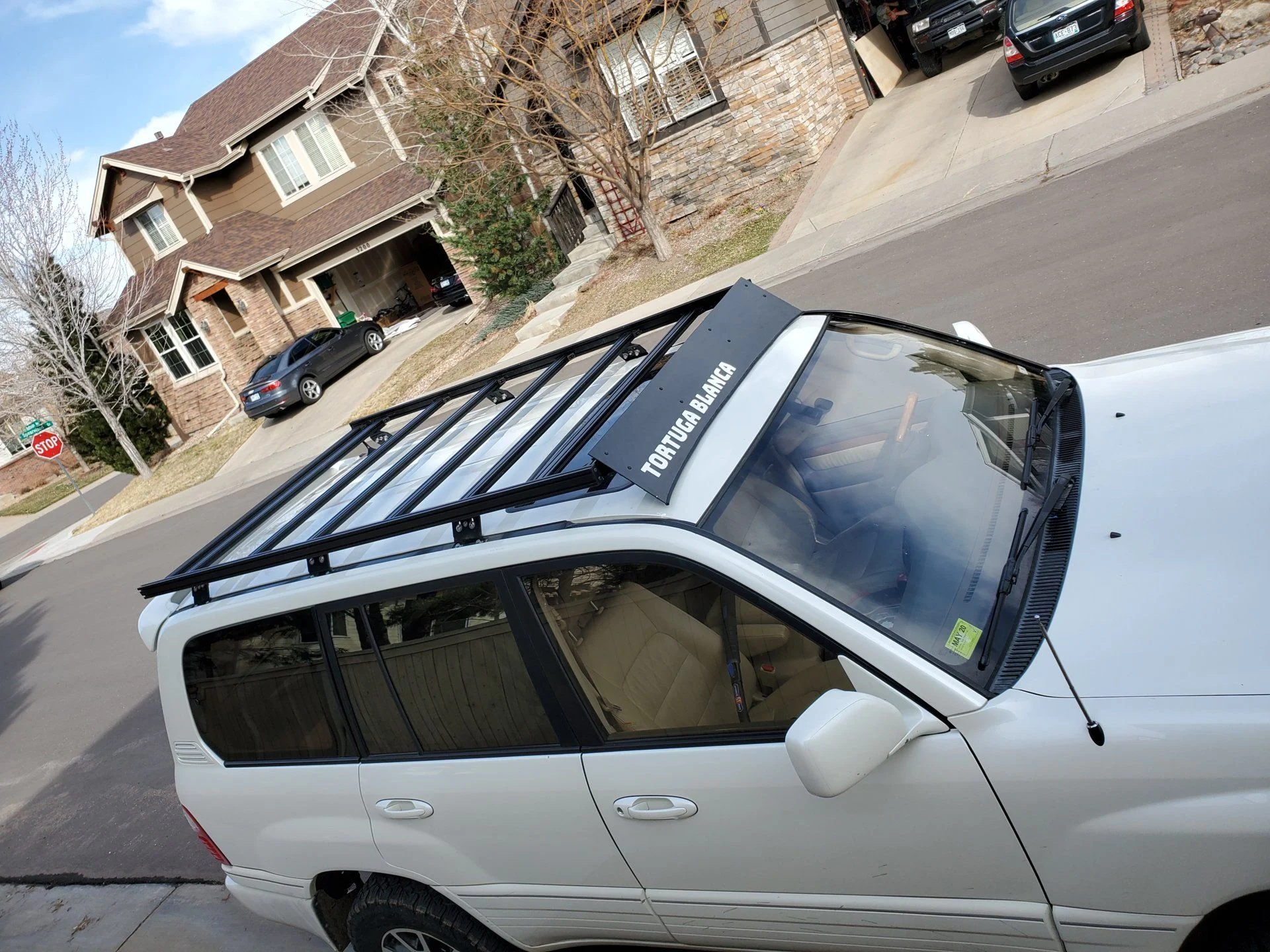

I took my factory roof rack off and replaced it with an 8020 rack in black, sourced through T-nuts. My whole factory rack is looking for a new home, if you’d like to add factory bars to increase your capacity w/out limiting fuel economy.

This is awesome! Have you tried attaching anything to it? I'm curious if this would be good enough to hold a tent, boxes, maybe jerry cans, etc... Thoughts?
If you are worried about the strength of these extrusions they can handle alot of weight. You can see on their website all the different uses customers have come up with. I use them at work to design machines that laser mark cable and pills.
I wouldn't hesitate to put whatever you need to transport on this 8020. You could always add more bars too if needed.
