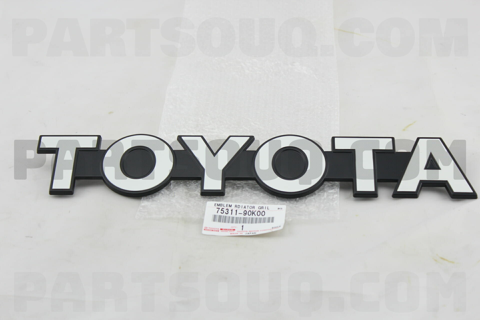

Is the "Toyota" emblem on the front the one for the BJ7x? need to order one with the white letters.
EMBLEM, RADIATOR GRILLE 7531190K00​
is this the one?
is this the one?
Yes I think that’s the one. I will check the part number and let you know
