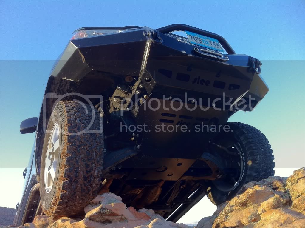

I love my Slee and would not do it any other way. The approach angles both on the wings and in the center are excellent. The winch mounting system is great, winched on a stuck full size a few weeks ago and the bumper didn't flex or bend and we were at the limits of the 12000lb winch. I think it looks better. You lose the headlight/front quarter protection but I have good insurance for that. If you are always in thick brush (and I mean really thick) than the ARB may provide some assurances against damage. The welds and finish on the Slee are second to none. Also for towing/winching I would recommend a frame recovery bracket like Spresso's FRB2 (hopefully available again someday). I have winched off of the Slee and it is fine for straight pulls but if you are pulling at a severe down angle the wings can flex into the fender. I imagine any bumper would do the same because there is no attachment point to the frame back there. Integrating the skid plate does help significantly and may eliminate this. I just choose not to winch off of it anymore because I have the FRB2.

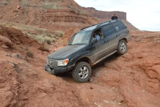

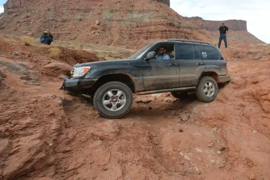

This is Kane Creek in Moab, A couple of trucks on the trip got really hung up here because it catches the front and back at the same time, The Slee front hit but slid easily through the obsticle. I also really like the the Skid is designed for the bumper and designed to be used on a lifted truck giving a continuous/rigid/smooth surface to slide over.

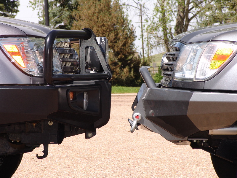

About the only picture I have nose to nose. 305 33s vs 285 35s
Maybe this weekend we can compare a tube bumper, 98-02 arb deluxe, 03-07 deluxe, tjm t3 and a slee bumper.
