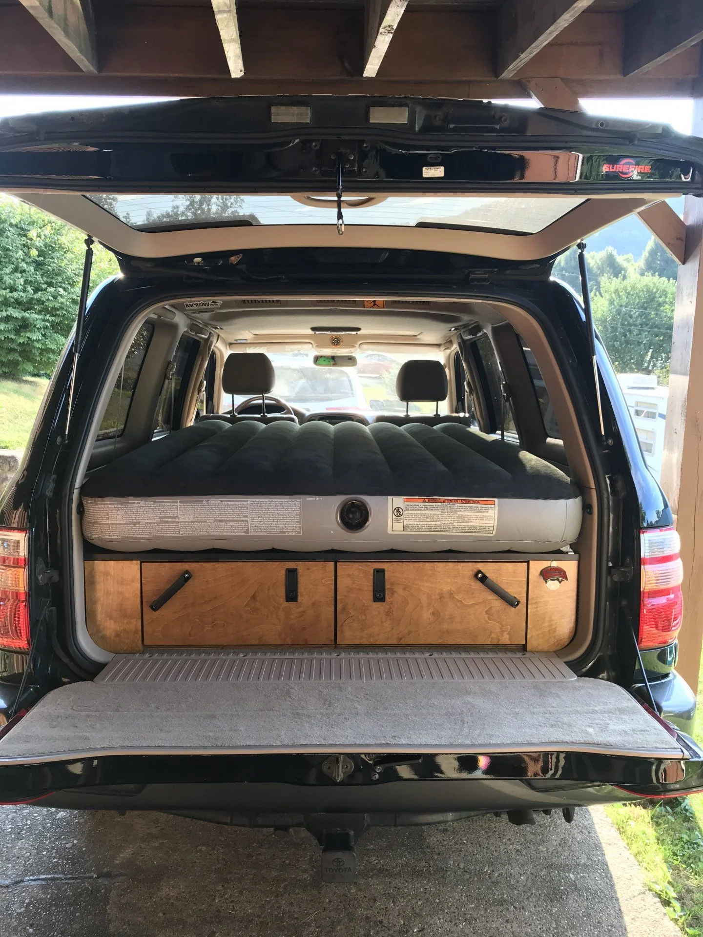

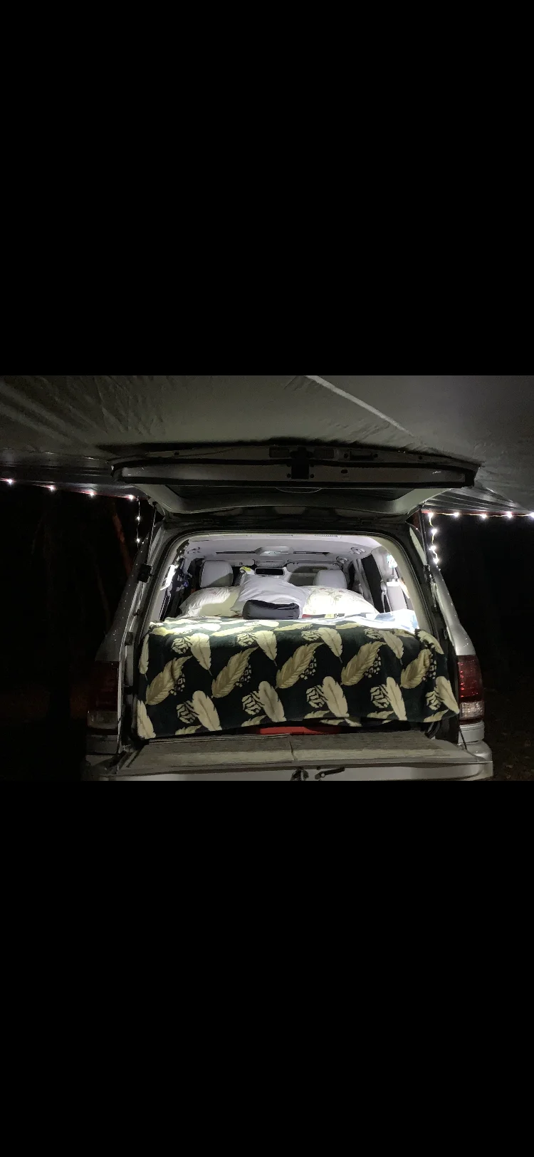

I just built my drawers to be at the same height as the seats when they are folded flat.
Plywood costs a small fortune right now, but you only need two sheets and can build a nice setup.
All that is needed is a set of drawers that match the height of the 2nd row when folded. Below is my home built drawers with a full size air mattress on top. A half height mattress would be better, but my current set up will do just fine.
really digging this. Thanks a bunch.

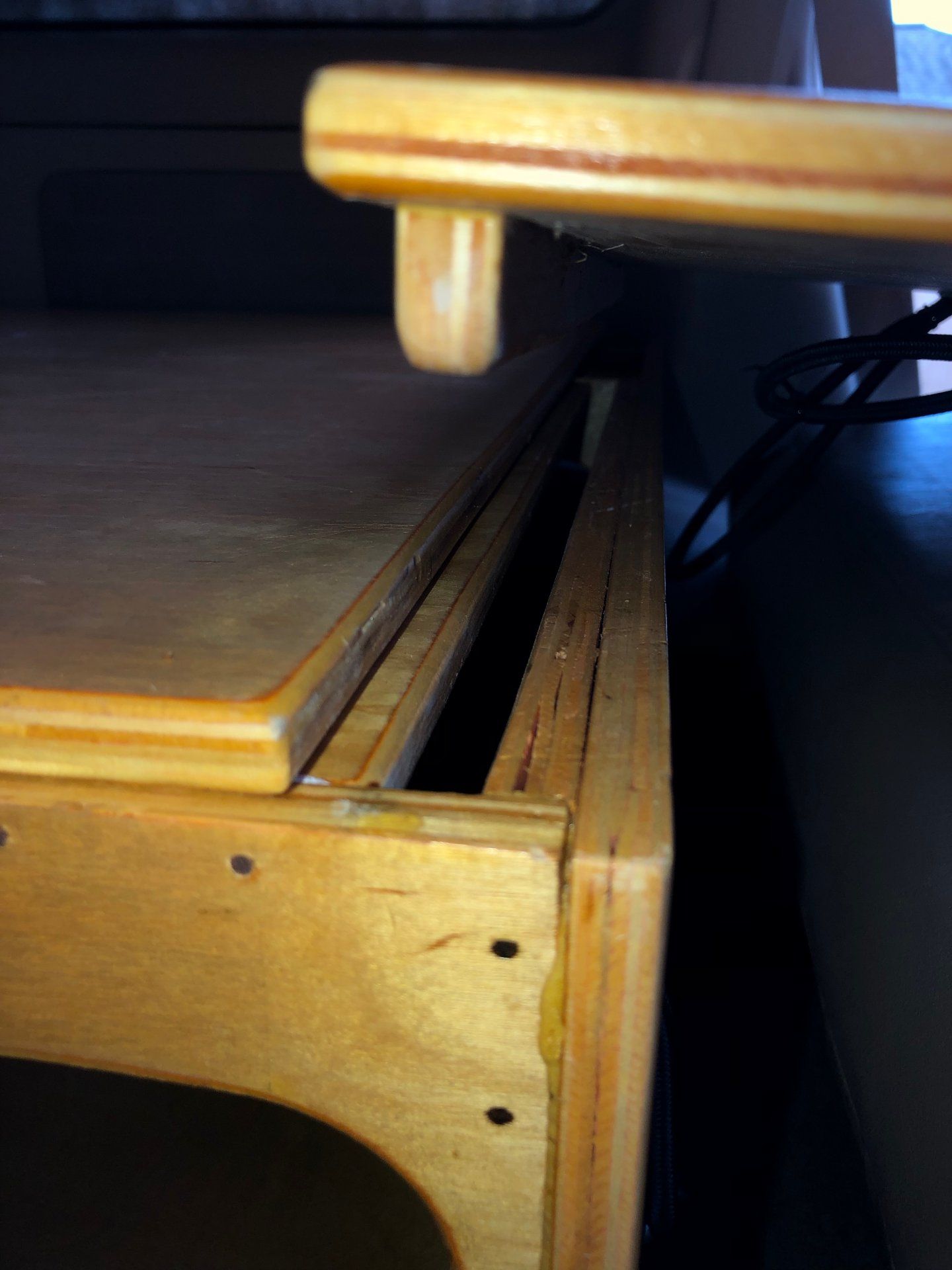

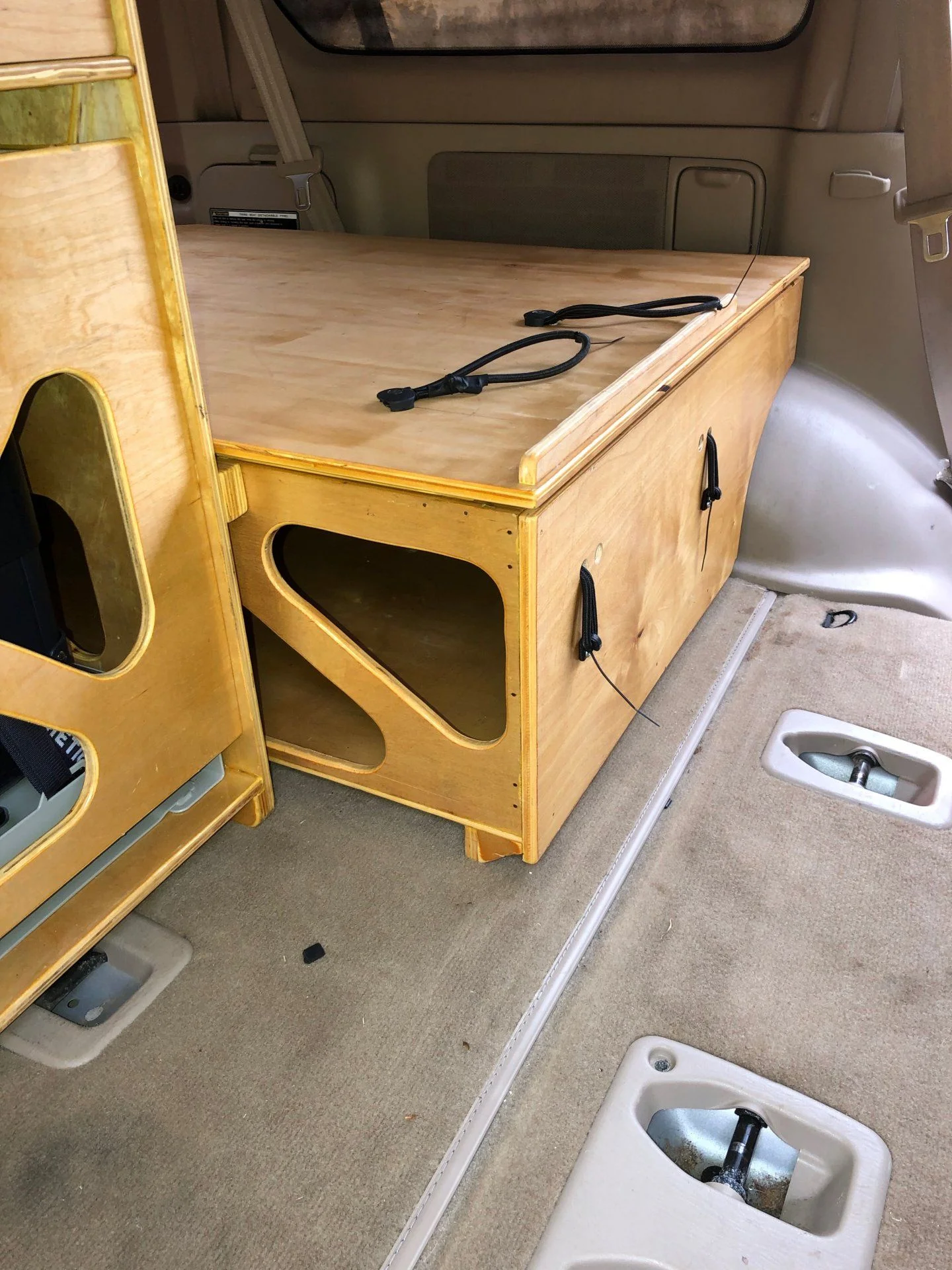

I made a lightweight setup that is for 1 person, you could double it up for two but give up the fridge. In the last picture you can see the plywood that forms the rest of the sleeping platform. It stores behind the seat on top of the box that hold my storage.
this thing looks great! thank you for sharing.

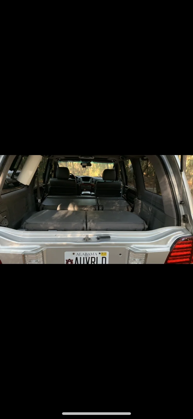

Leave both rows of seats in, use storage boxes, and tool box, between folded down seats the same height as seats. Inflated mattress on top.
