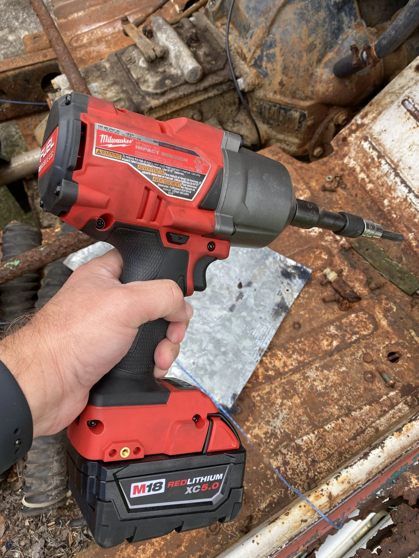

Ok, so I purchased the Milwaukee Fuel M18 1/2 impact driver - and it didn't occur to me that I would need different sockets.
Any recommendations on a socket set suite for this tool that will make this useful for working on the cruiser?

Steven, in a pinch, you can get adapter sets from 1/4" impact driver (if you meant that literally) to 1/4, 3/8, 1/2" for a couple of bucks. But I guess you meant impact wrench?
Yes, it is impact wrench..sorry, these beefy power tools are new to me!
M18 FUEL 18-Volt Lithium-Ion Brushless Cordless 1/2 in. Impact Wrench Friction Ring
I thought one of my current hand tool 1/2 inch sockets would fit - perhaps not be strong enough for use, but that it would attach so I would know what to look for - but that does not seem to be quick big enough...do I just need to brute force it, or are they incompatible?

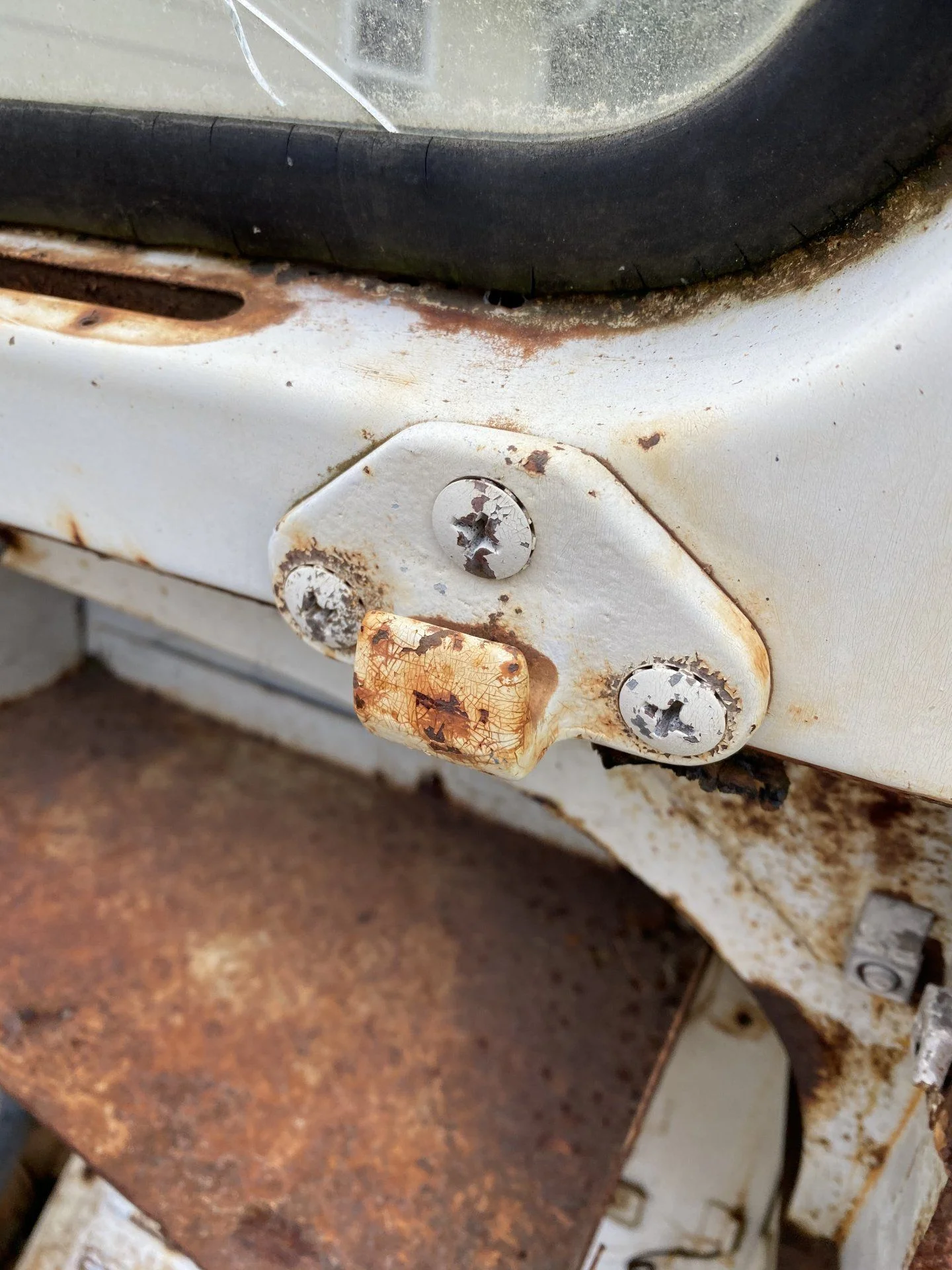

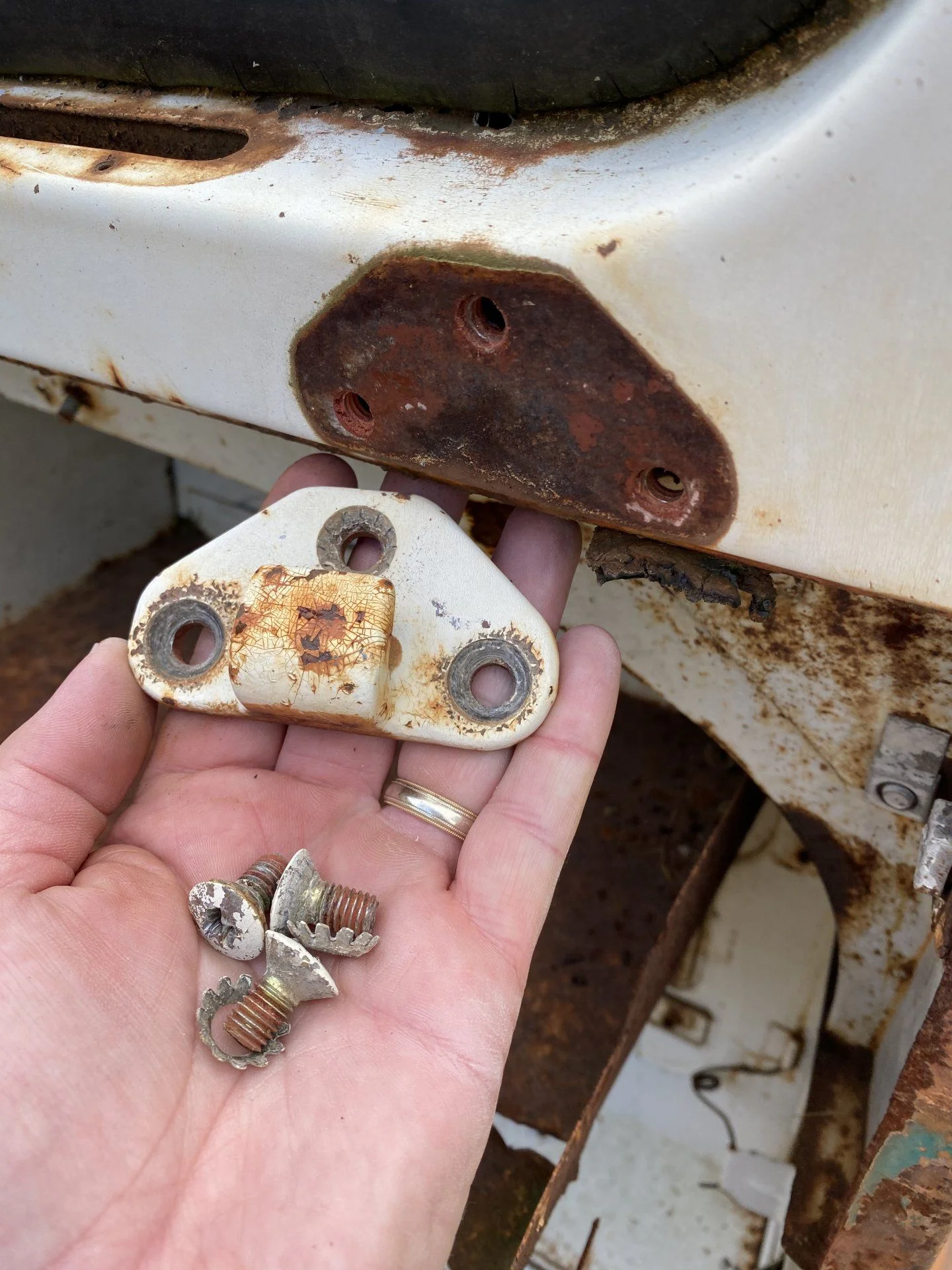

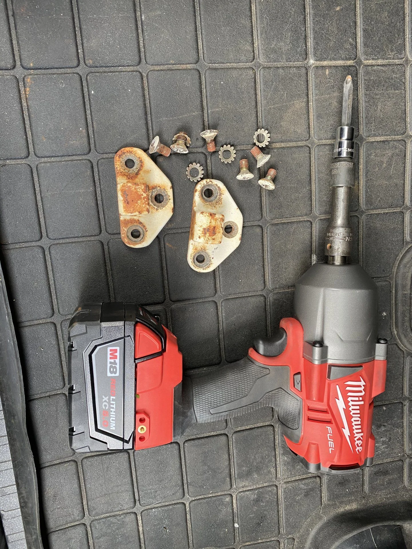

I’m so happy right now. I’ve been trying to get these b!+<@$ off for quite sometime without stripping!
Took less than 3 minutes!
