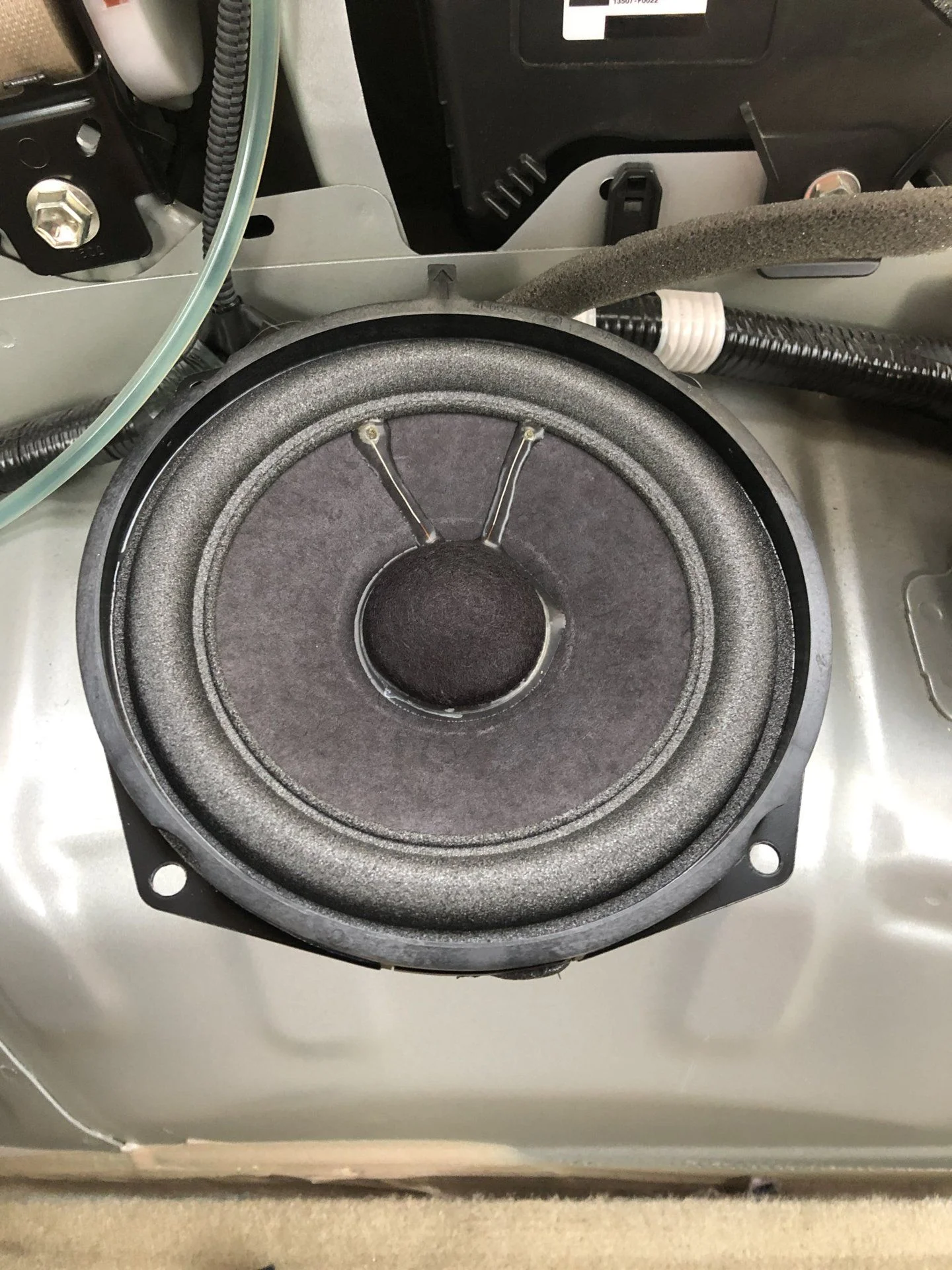

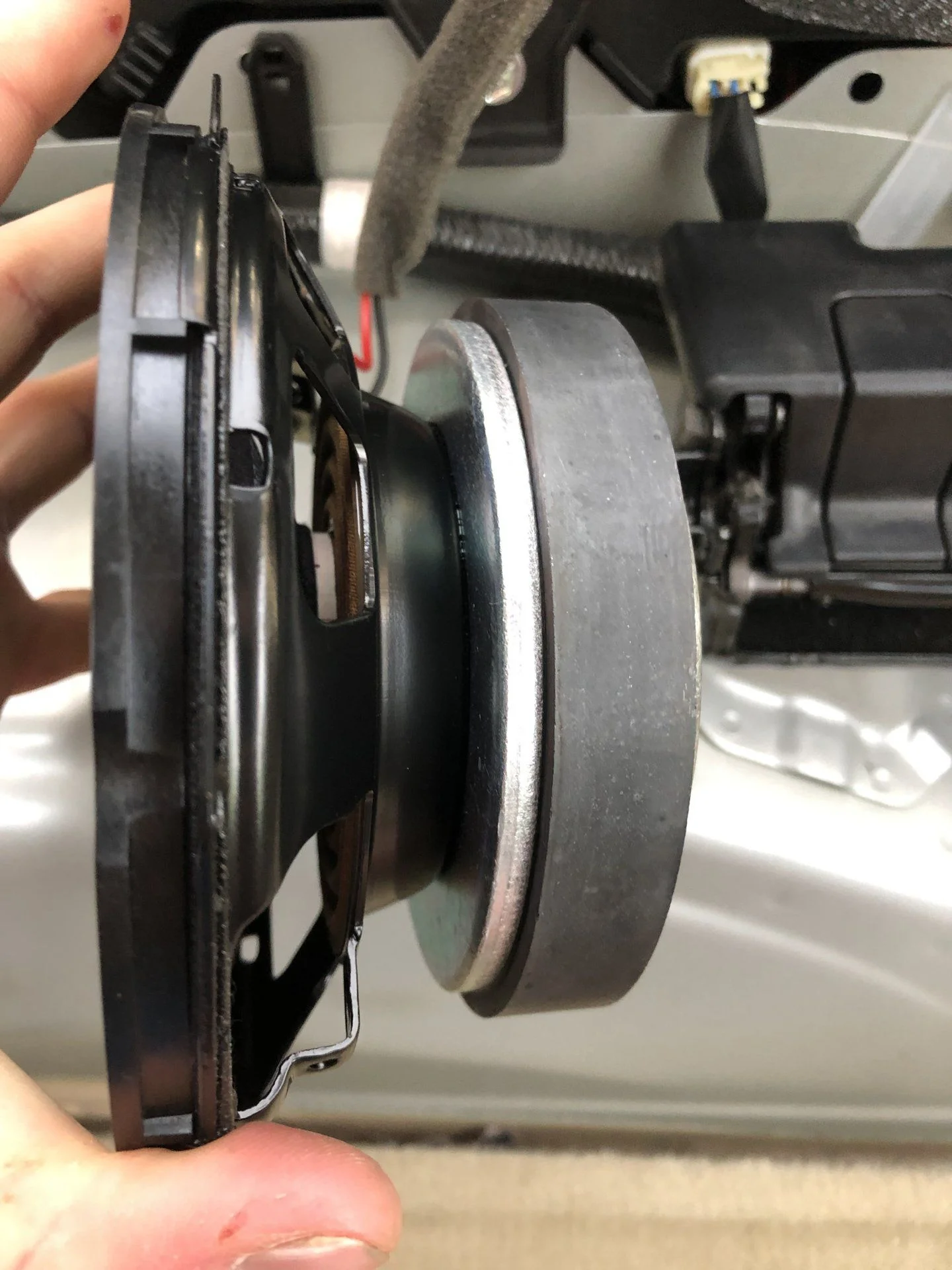

I'm not a speaker guru by any means, but I have a terrible snap/crackle/pop (Rice Krispies) coming from the sub when songs with heavier bass hit. The speaker looks fine visually to me, and nothing is loose in the enclosure. Am I just bumping too hard or do I need to look at replacement foam or speaker itself?
The factory sub isn't big enough..so it gets overwhelmed easily. Drake wasn't a big thing with soccer moms in the 2000s :P
Could be the voice coil has given up the ghost. Might as well replace the whole speaker since you're already deep in there. I replaced mine with a 10$ 6" woofer from Amazon and it works fine. It was a Pyle dual voice coil so you can opt to wire it for 8 ohms if you like. Honestly you can barely hear it unless sitting in the rear seats so I'm not sure it's even worth the effort lol!

Can't see the link/image but yes you can just solder it in, and I had to shave down the speaker to fit the enclosure which was kind of a pita btw. A rotary tool worked ok but kinda made a mess. Some weatherstripping between the enclosure and speaker is a good idea for a nice tight seal as well.
