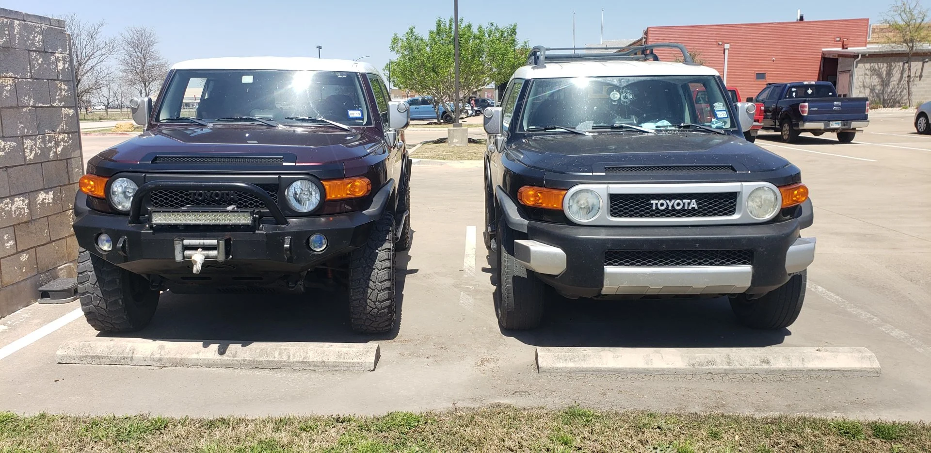

Finally found one worth pursuing that would save a ton of time on the build side from a Mud member down in Texas (being from Ohio the no rust aspect was a huge draw) so my mom and I did a Fly-n-Drive back in March over a long weekend.

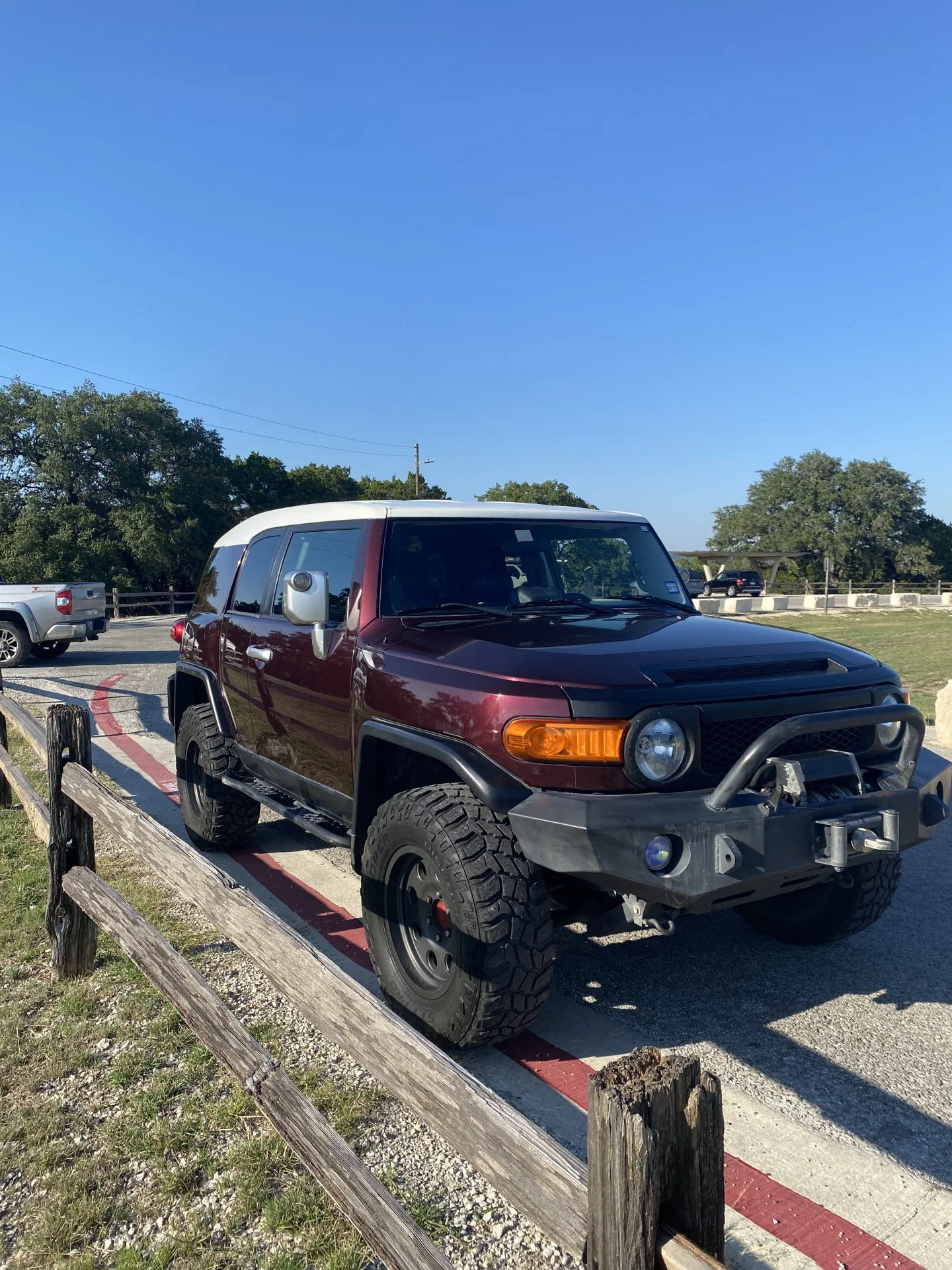

Seller's picture from ad:
Highlights:
Exp 1 front bumper with 9k winch
Metal Tech rear bumper
Sway-a-Way front coilovers and rear springs ~2.5-3in lift
285/70 tires
Full Budbuilt skid plates
43qt fridge on slide out in back

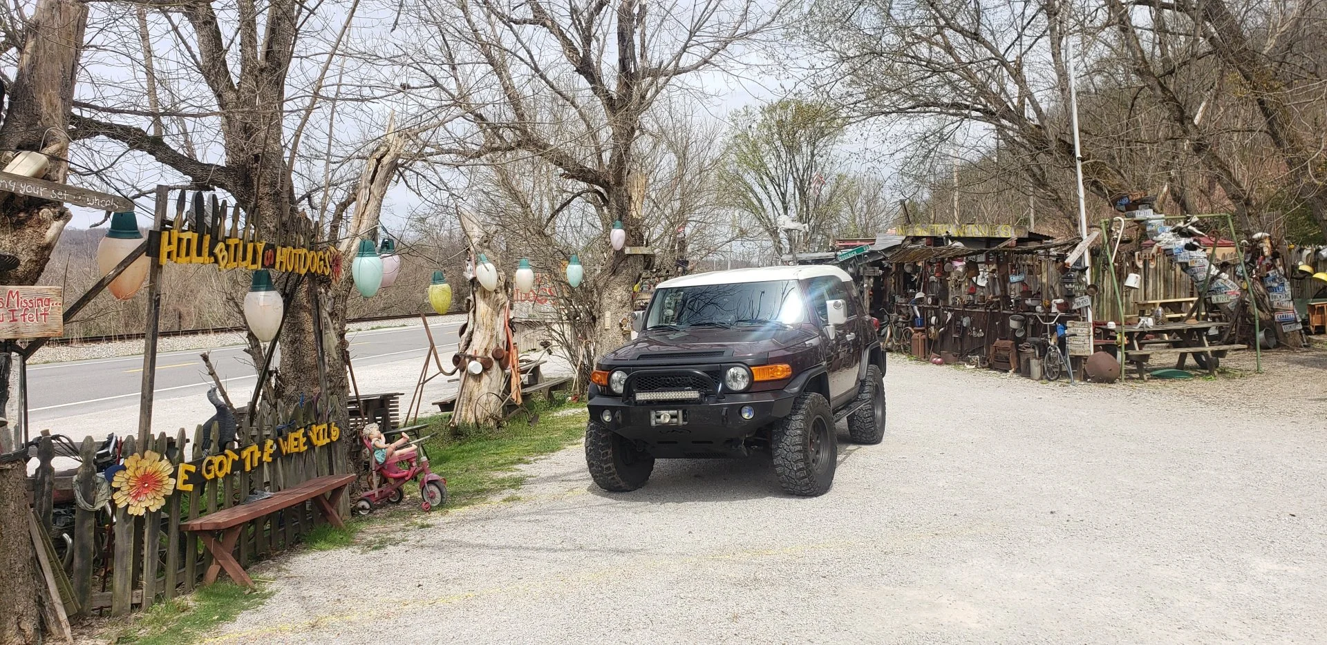

Had to stop at Hillbilly Hotdogs in BFE West Virginia. Unfortunately not open on Mondays but pictorial evidence was needed.

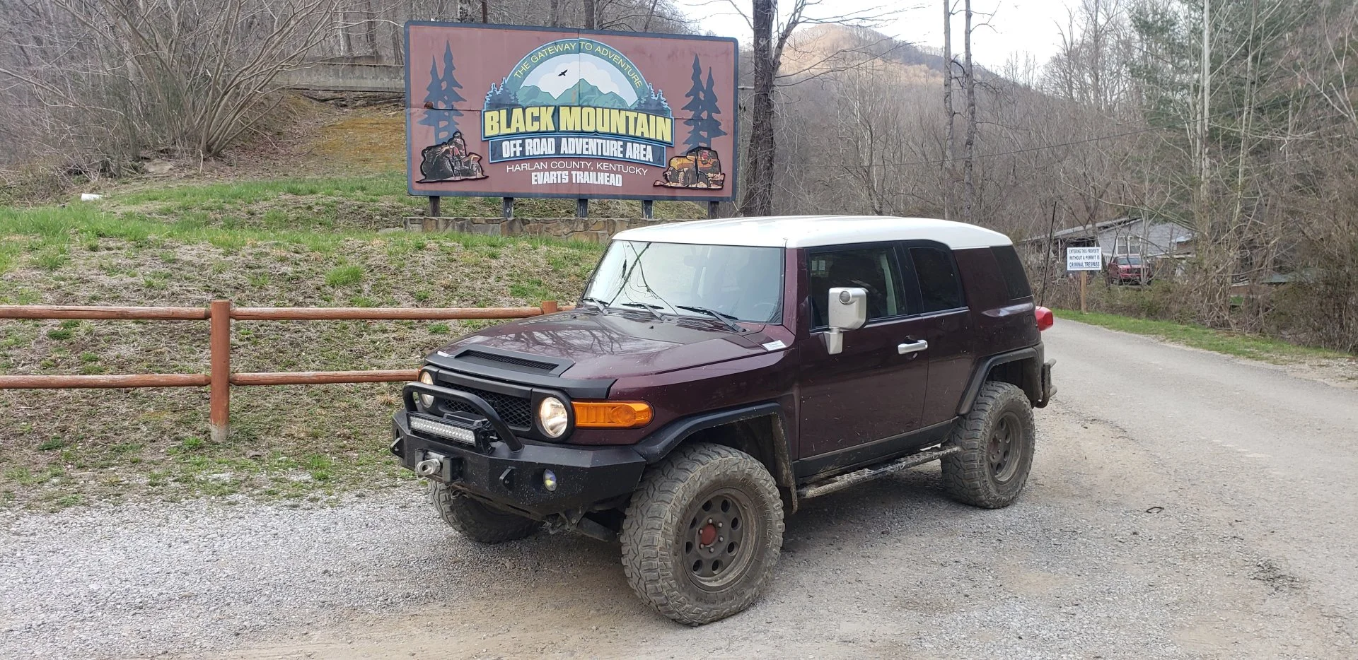

Ultimately landing at my destination for the day at Black Mountain Offroad park in Harlan KY.
Ran some "easy" trails from what our groups always did in Harlan. It was actually great to get to see some of the park I hadn't because when you go with guys in buggies they dont want to run the dirt roads to explore. All in put 2300mi on the FJ in the weekend bringing it home and found it to be awesome. FJ fits in with my 4runner for apartment life about like I do...

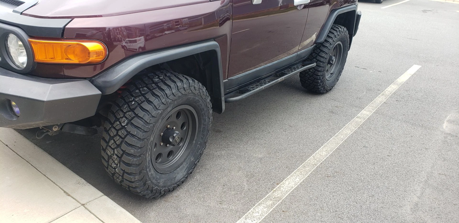

On to the "build", since I got it pretty well squared away it won't change much very quickly. I did find the STT pro tires that were on it to be worn a bit funny with cupping that made them sound like super swampers at highway speeds. With a trail run coming up with my club back in Ohio on a very rainy weekend I opted to have some new KM3's put on to quiet it down and also piece of mind with long trips. Stayed with 33s since I wasn't ready to regear yet.

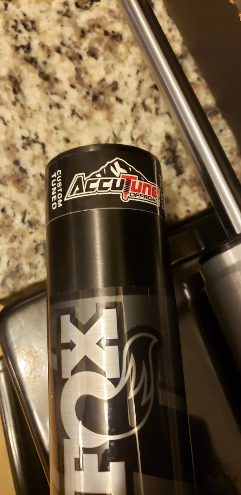

After getting back to NC I found one of the rear procomp shocks to be leaking a bit so I put on some Fox 2.0 remote reservoir shocks valved by Accutune. I ordered the mid range valve stack but the person called and recommended the softer one... hindsight being what it is I wish I had stayed with the more aggressive valving to match the front sway-a-ways but maybe they need to be revalved with a flutter stack...

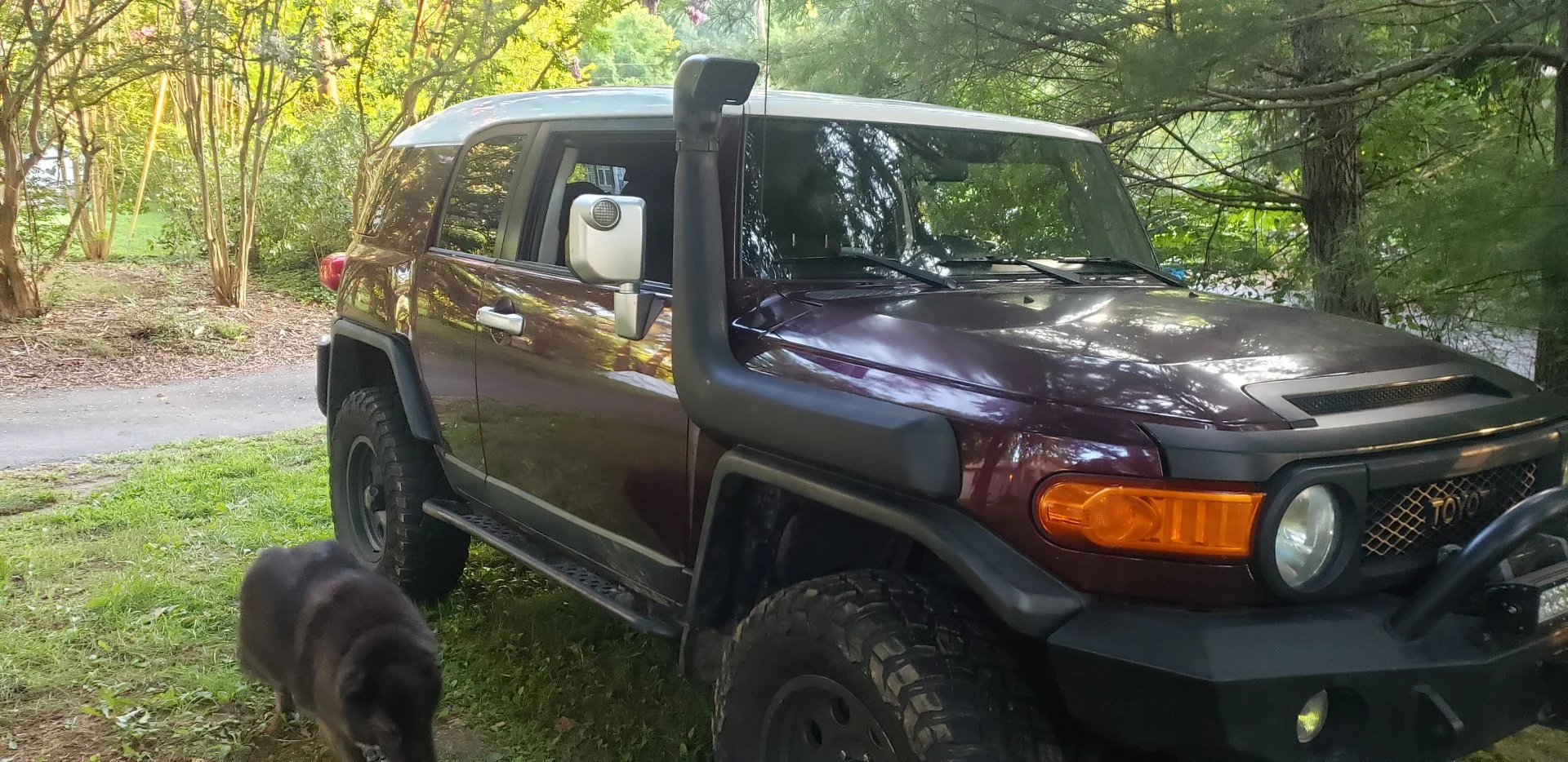

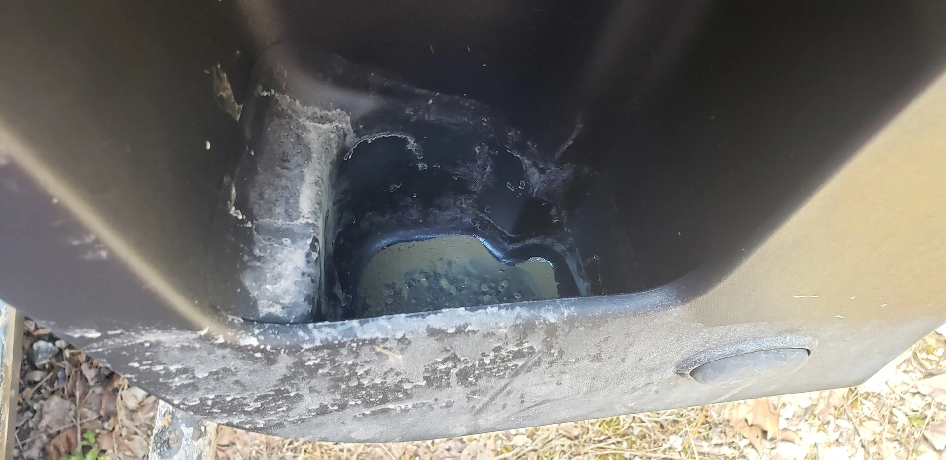

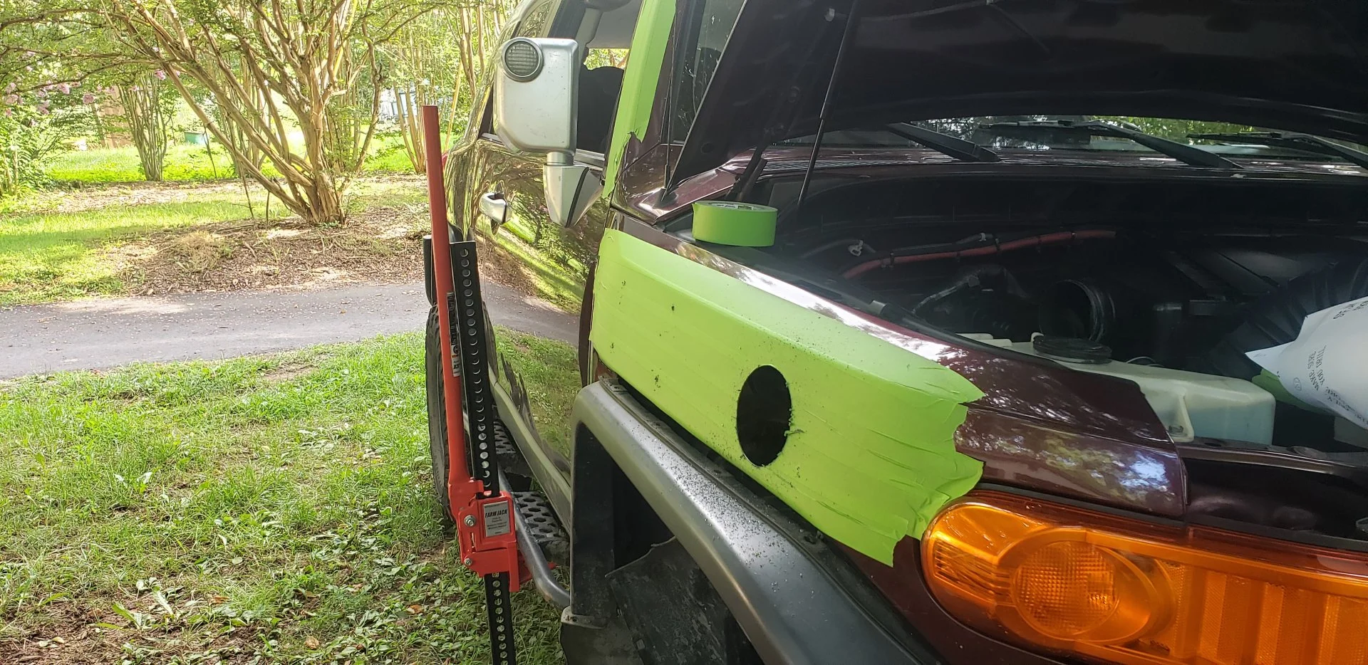

Then for my birthday I gave myself the gift of getting snork'd. $120 Amazon special, I like the look of the TJM style better but the air flow is restricted with their piping so the ARB knockoff seemed like a better function over form option. The build quality is really good and install went pretty well. I drilled my fender holes one at a time so I could keep the hole size as small as possible. Still unnerving hogging a 4.125" hole in your fender... you pay monthly for...
Outcome is nice though. And air inlet temps are basically ambient now when moving. Thats about a 10-15 degree drop from the factory location! Also my pup Maggie photo bombing.

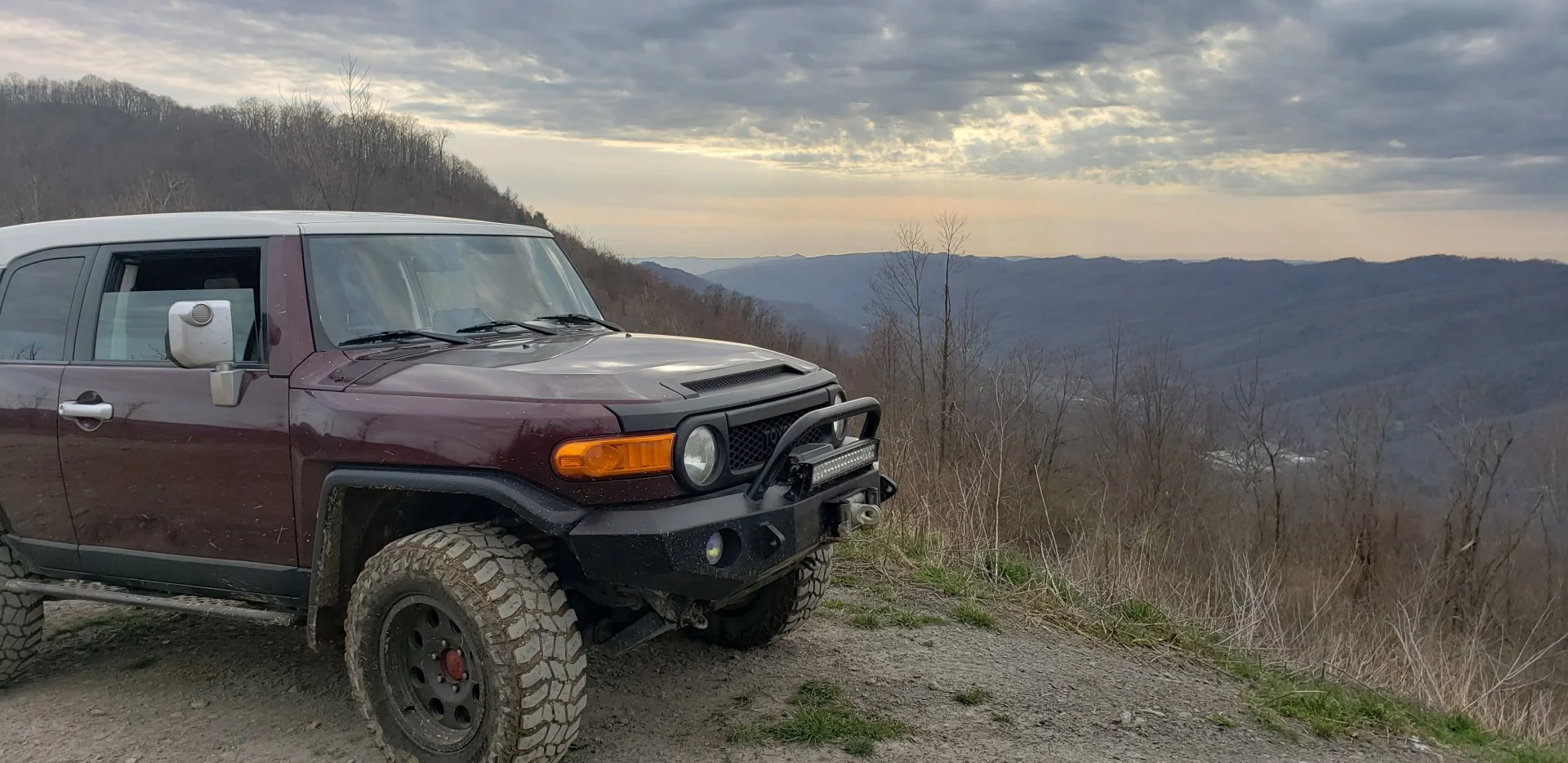

In October I met up with some friends in Slade KY, had planned to take the 4runner since it was going to be a hard trail oriented ride but last minute scheduling changes had my kiddos coming with. Instead of driving a sketchy crawler 4hrs each way we took the FJ... to wheel with buggies... :lol:
We let the big rigs hit the crawly stuff but followed along everywhere else. Did have to go up Carburetor Hill and made it unassisted right after watching a TJ blow a rear axle shaft on the same line :hmm: there were some surprised sXs drivers in the peanut gallery. Skid plates got a big workout but no damage other than some scratched paint.

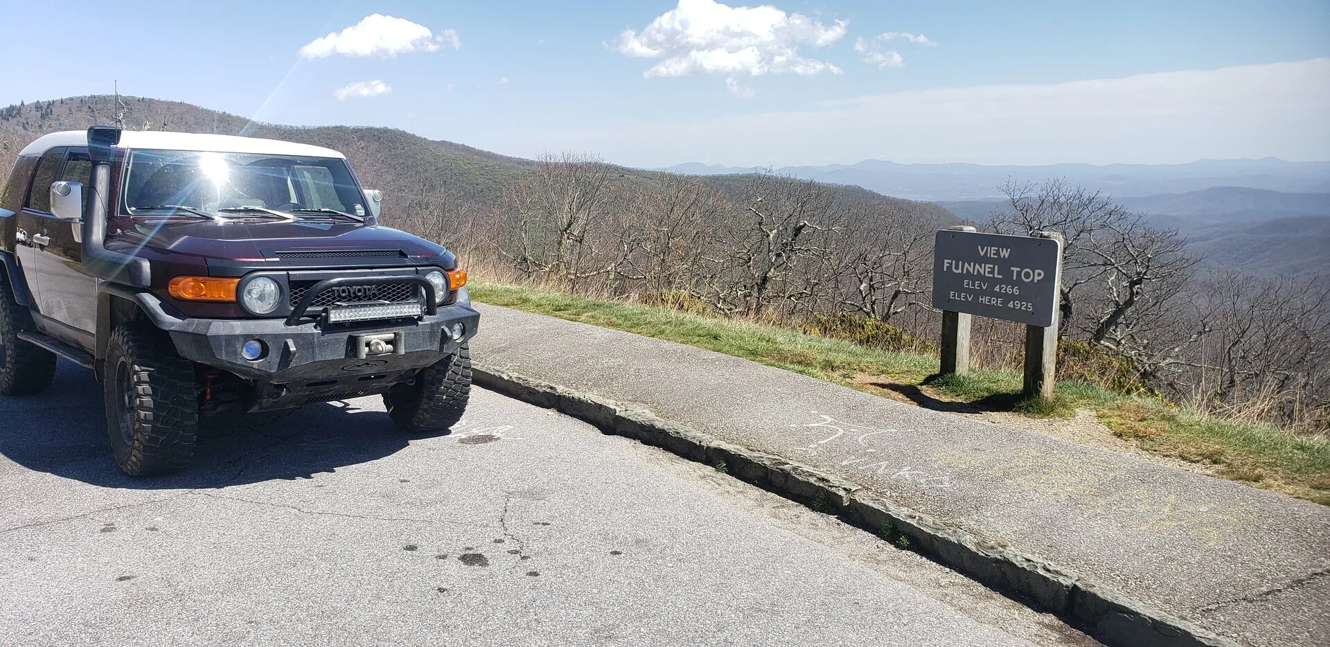

Started at Hurricane Creek and worked my way on gravel roads south through the Blue Ridge Mountains.
Blue ridge continued- Readers familiar with the area probably know exactly which way I went.
Views reminded me of Ouray/Telluride, without the 1000ft cliffs of death :lol:
