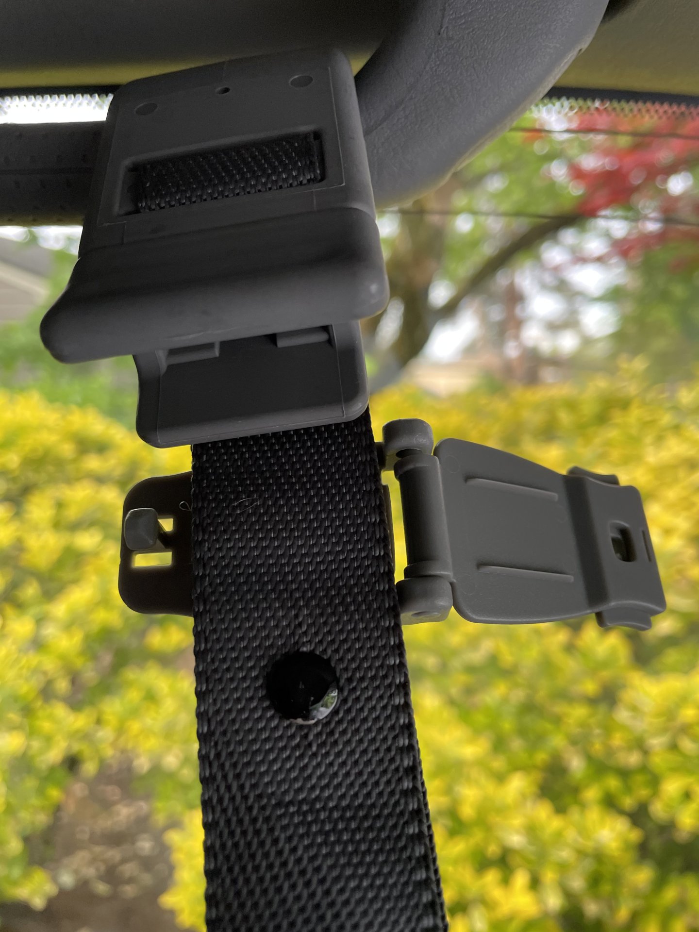

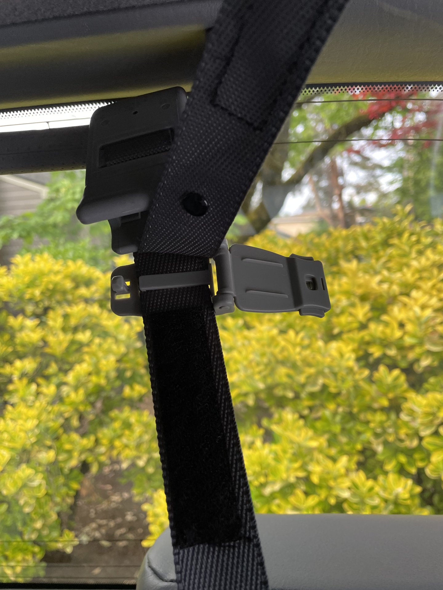

Okay guys here's my report I got the CAM buckle's and they are working great. the stay tight. There's still a little wiggle but i dont want to kill the hand hold thingi by making it too tight. But no more rattle of the seats. My only issue is that the only way i got it secure is getting the cam buckle all around the seat as you will see in the pic. Any other suggestions on how to secure it down?

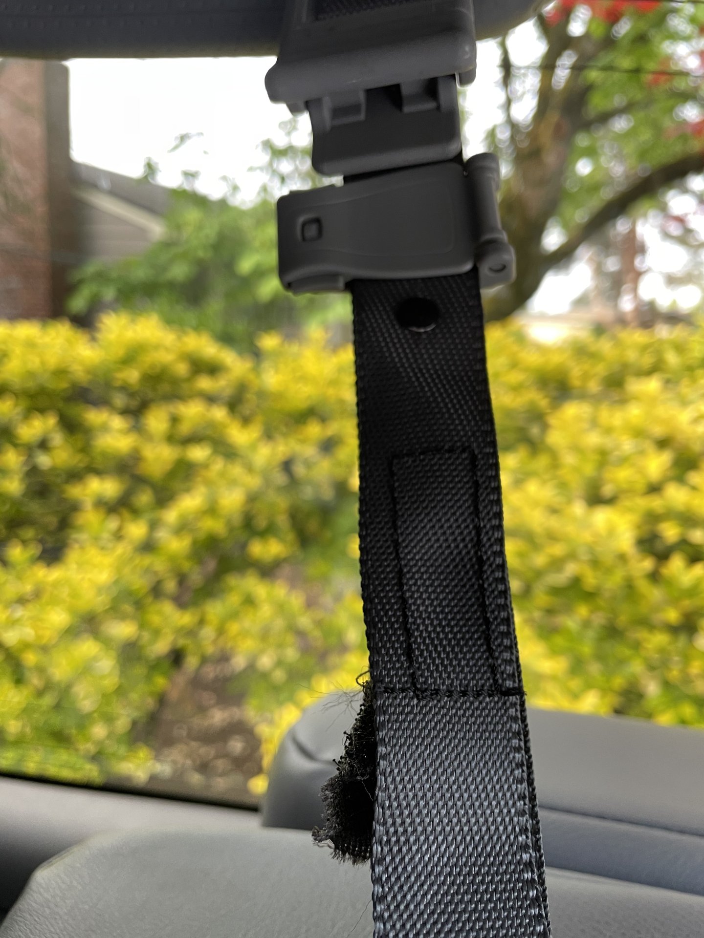

Found these mole clips on Amazon. The Velcro on my straps are no longer functioning. These mole clips work and they have multiple colors available. 10clips/$9
