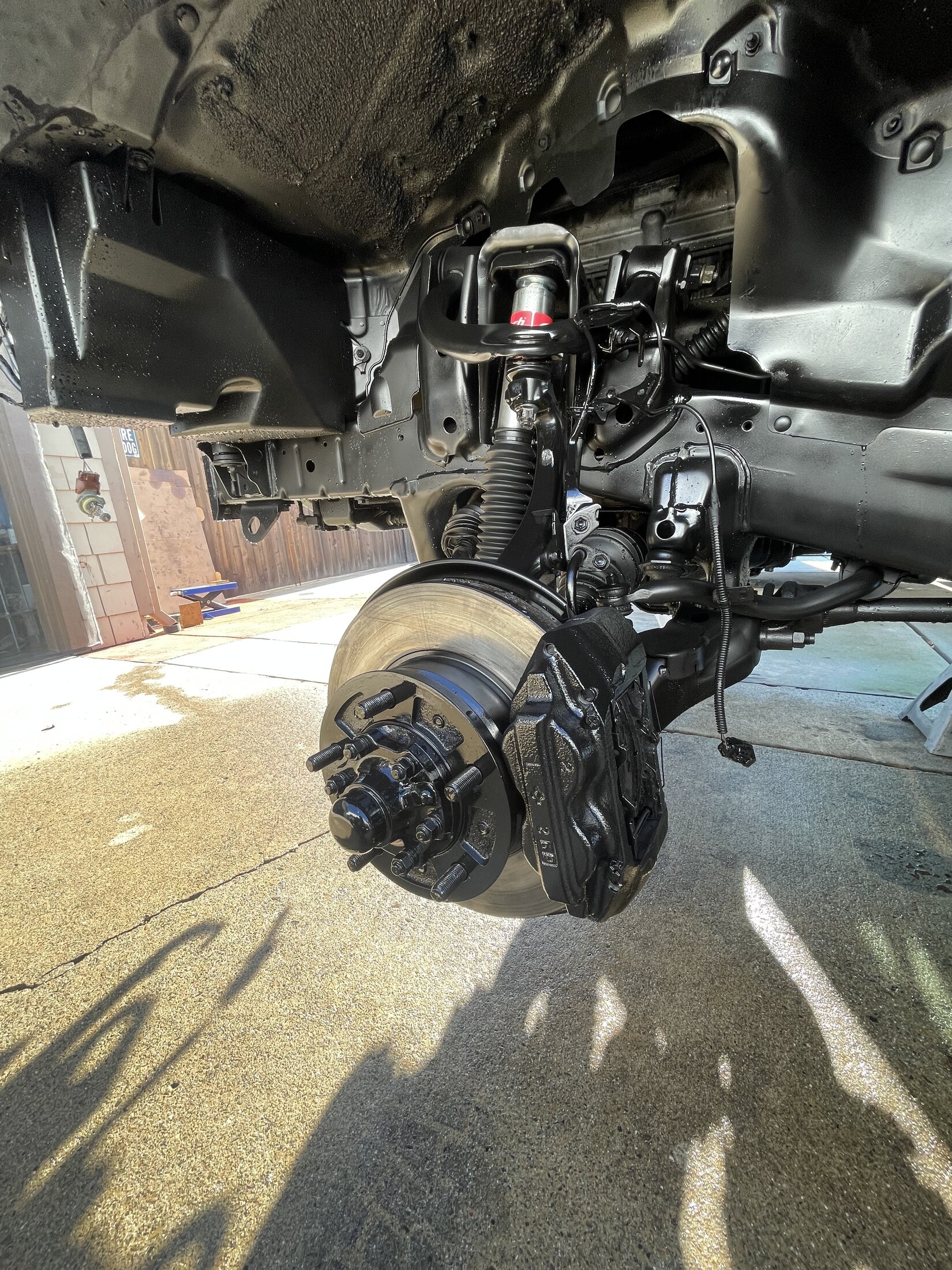

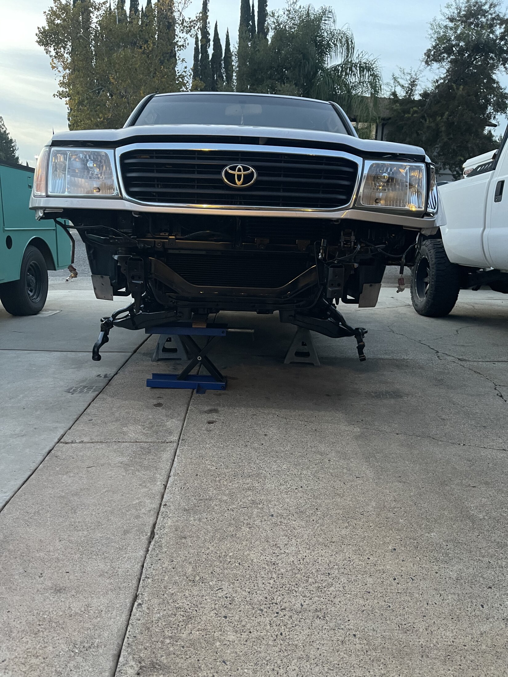

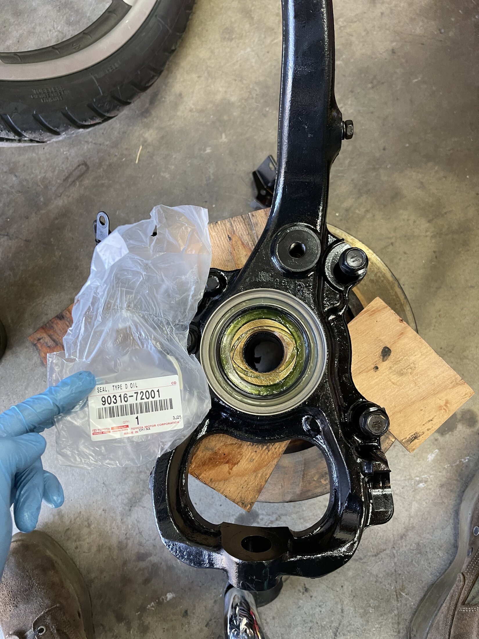

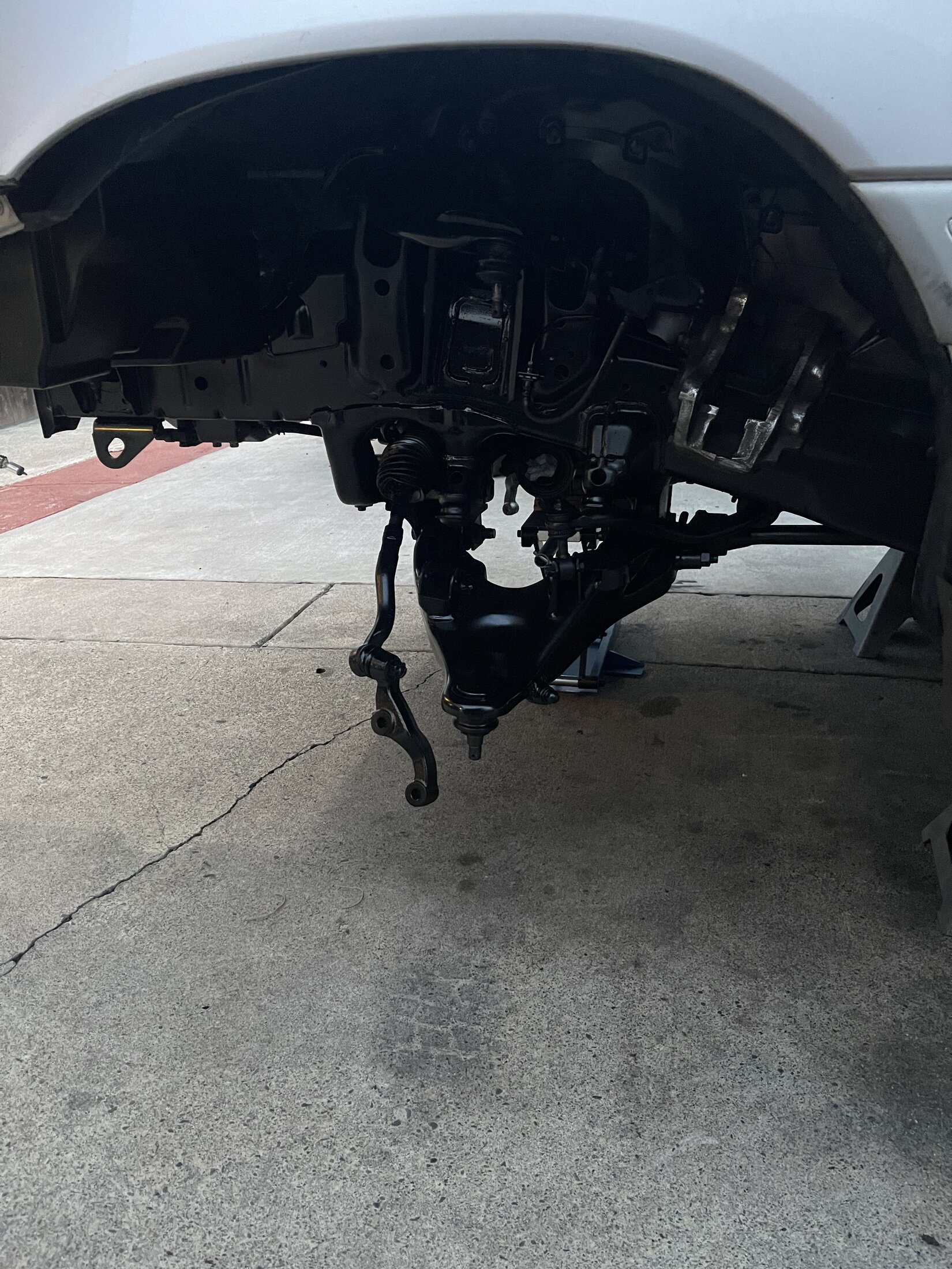

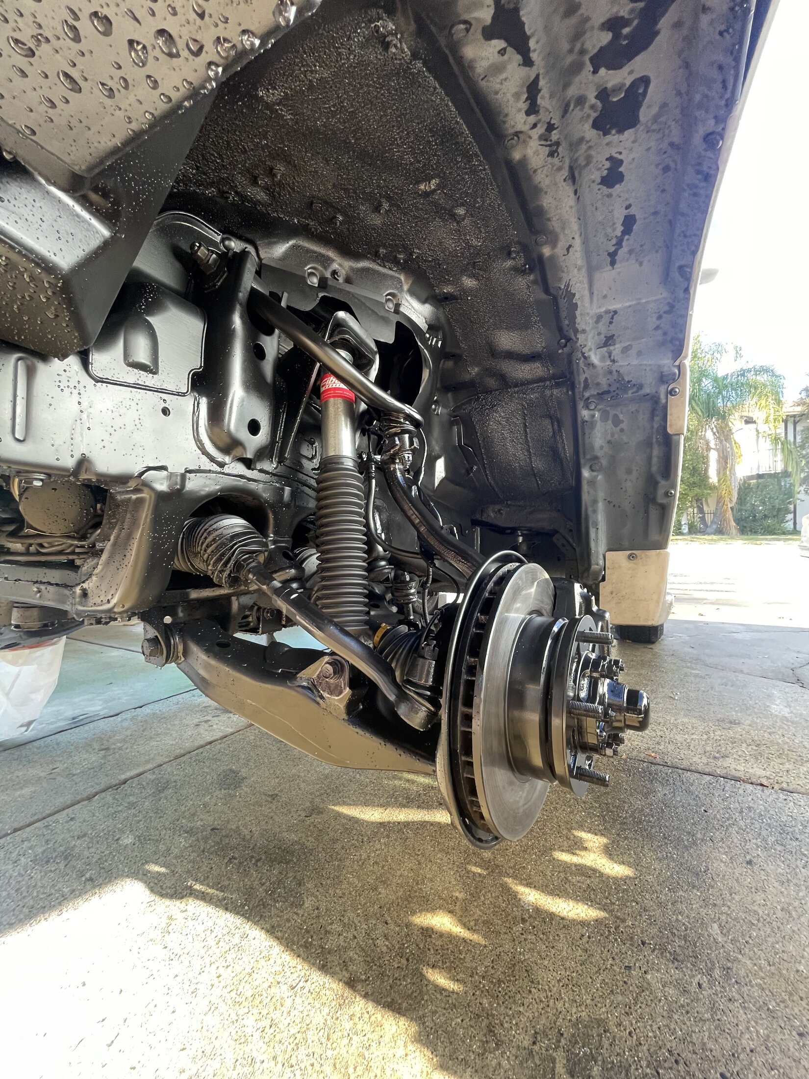

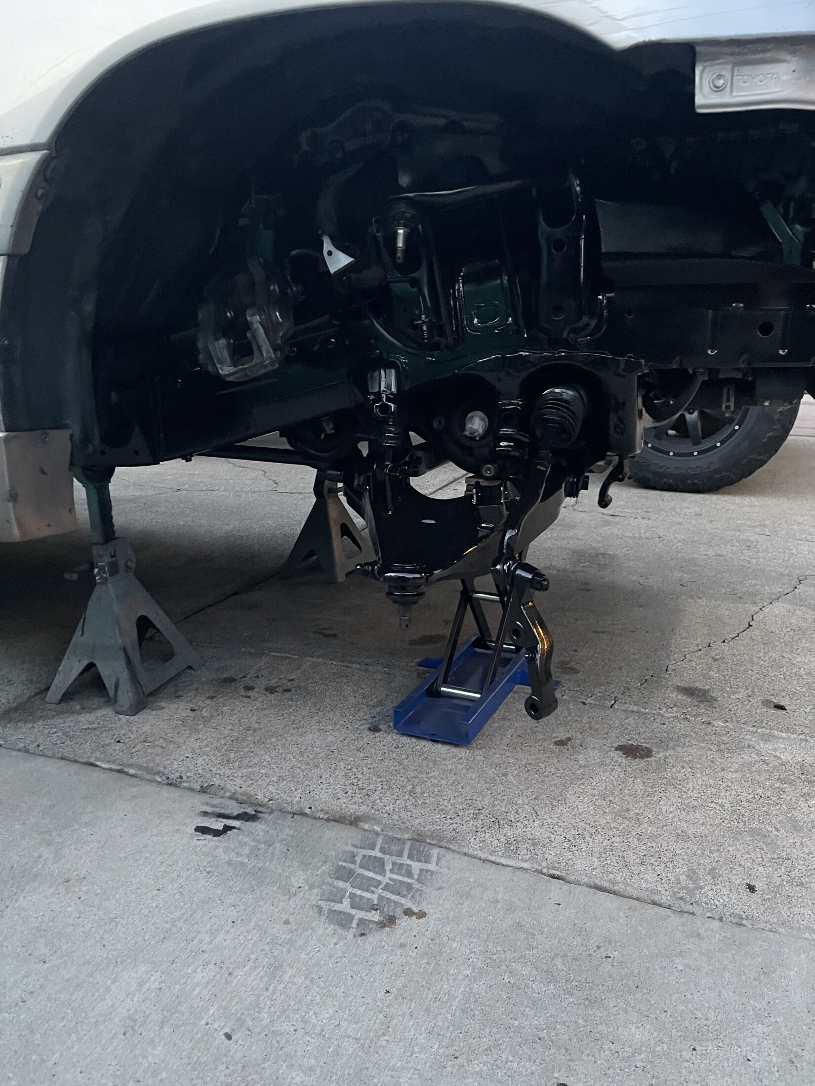

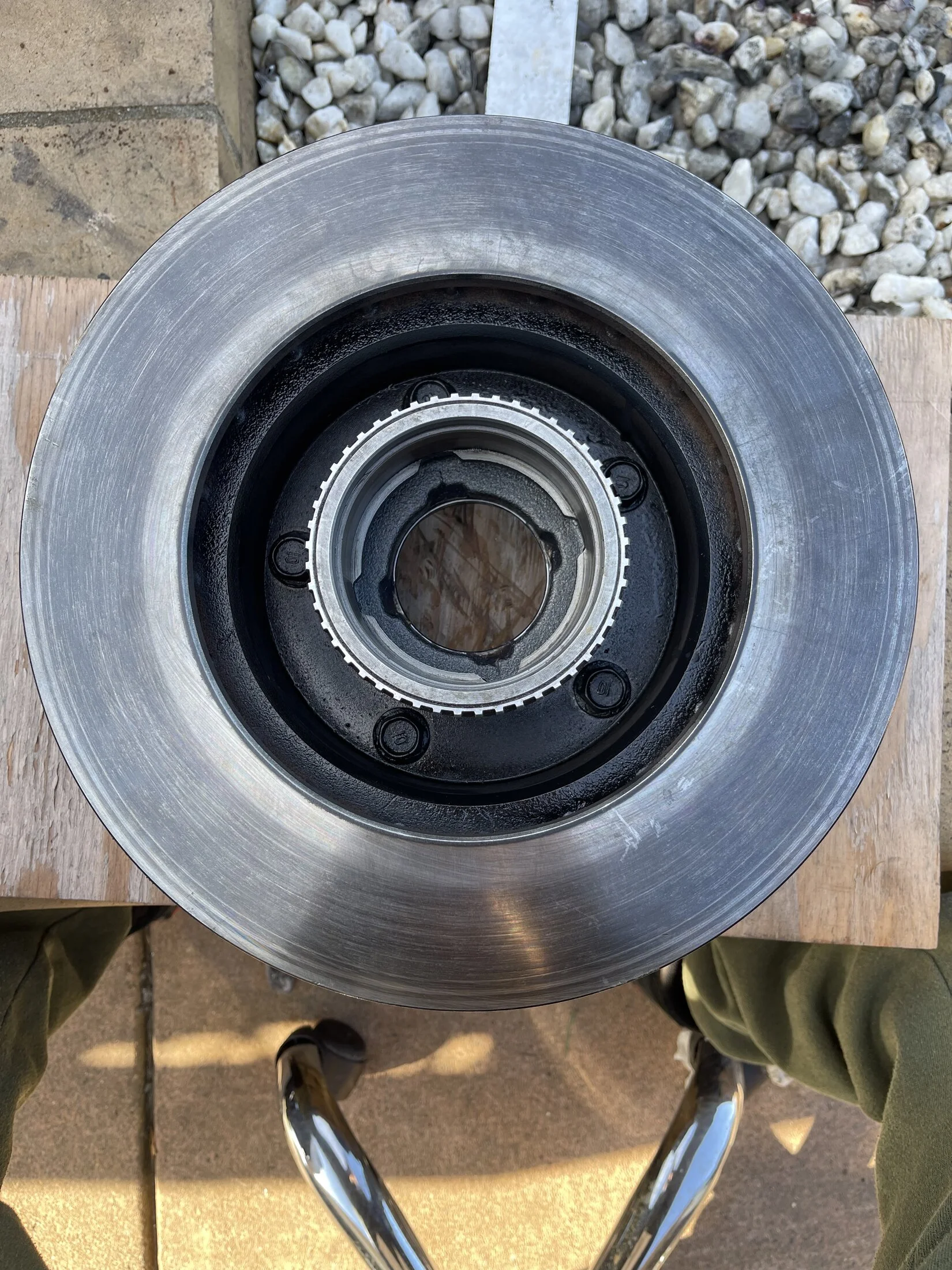

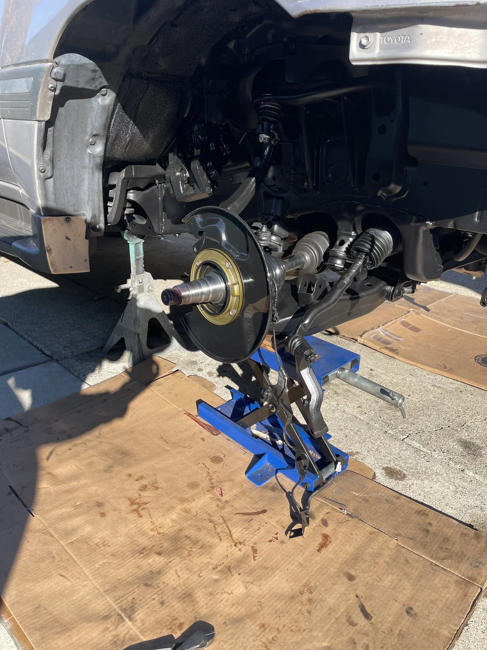

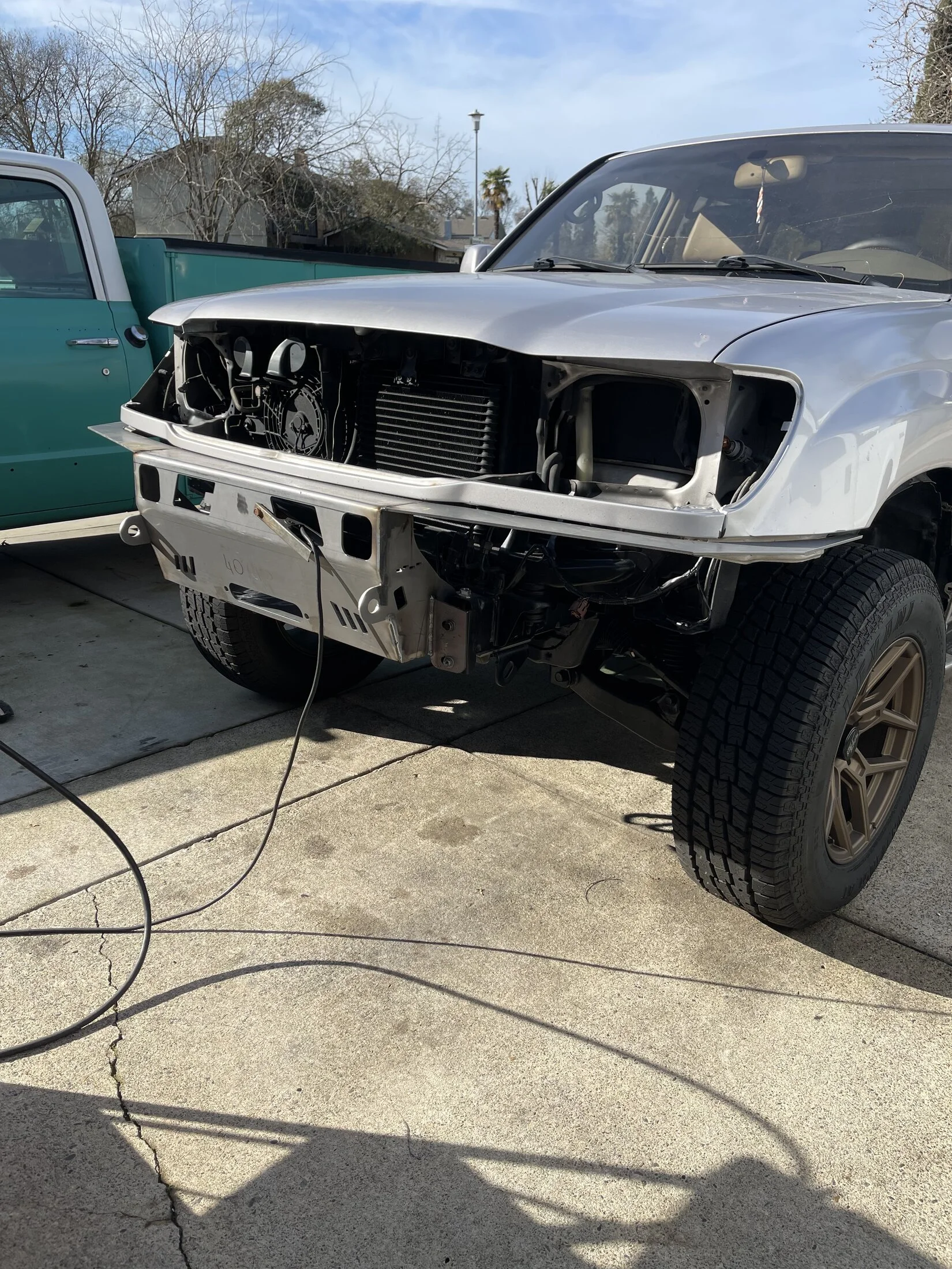

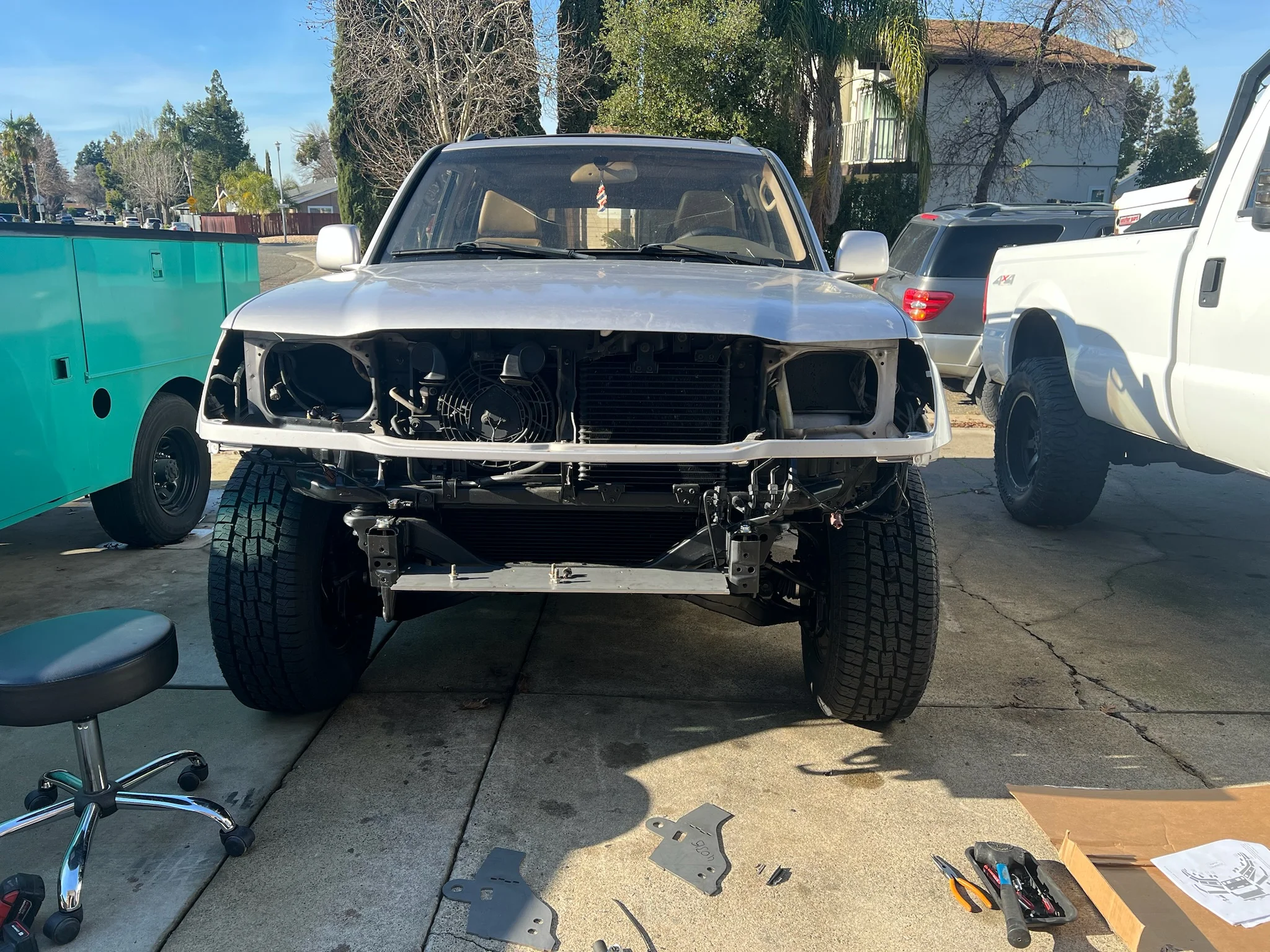

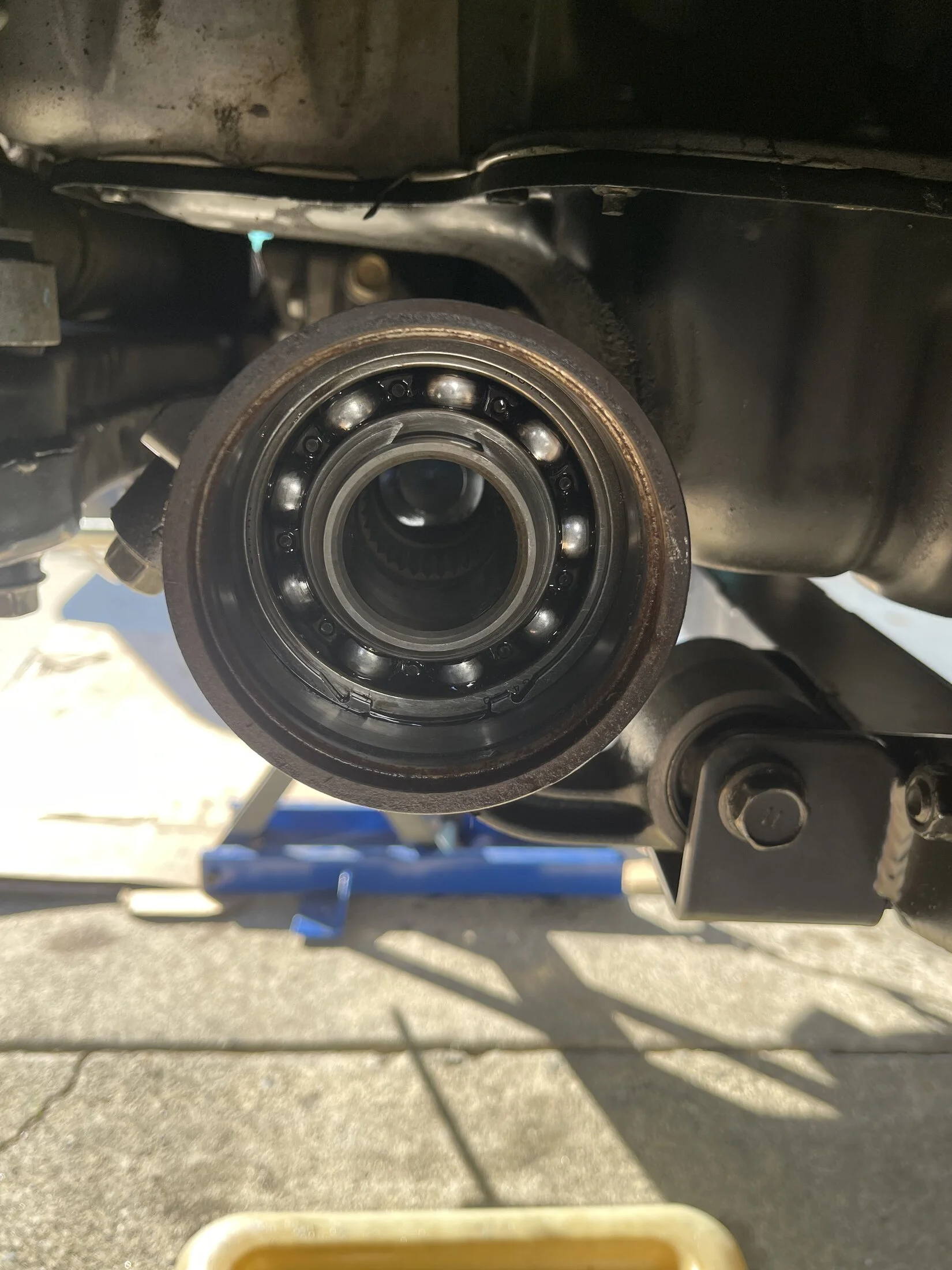

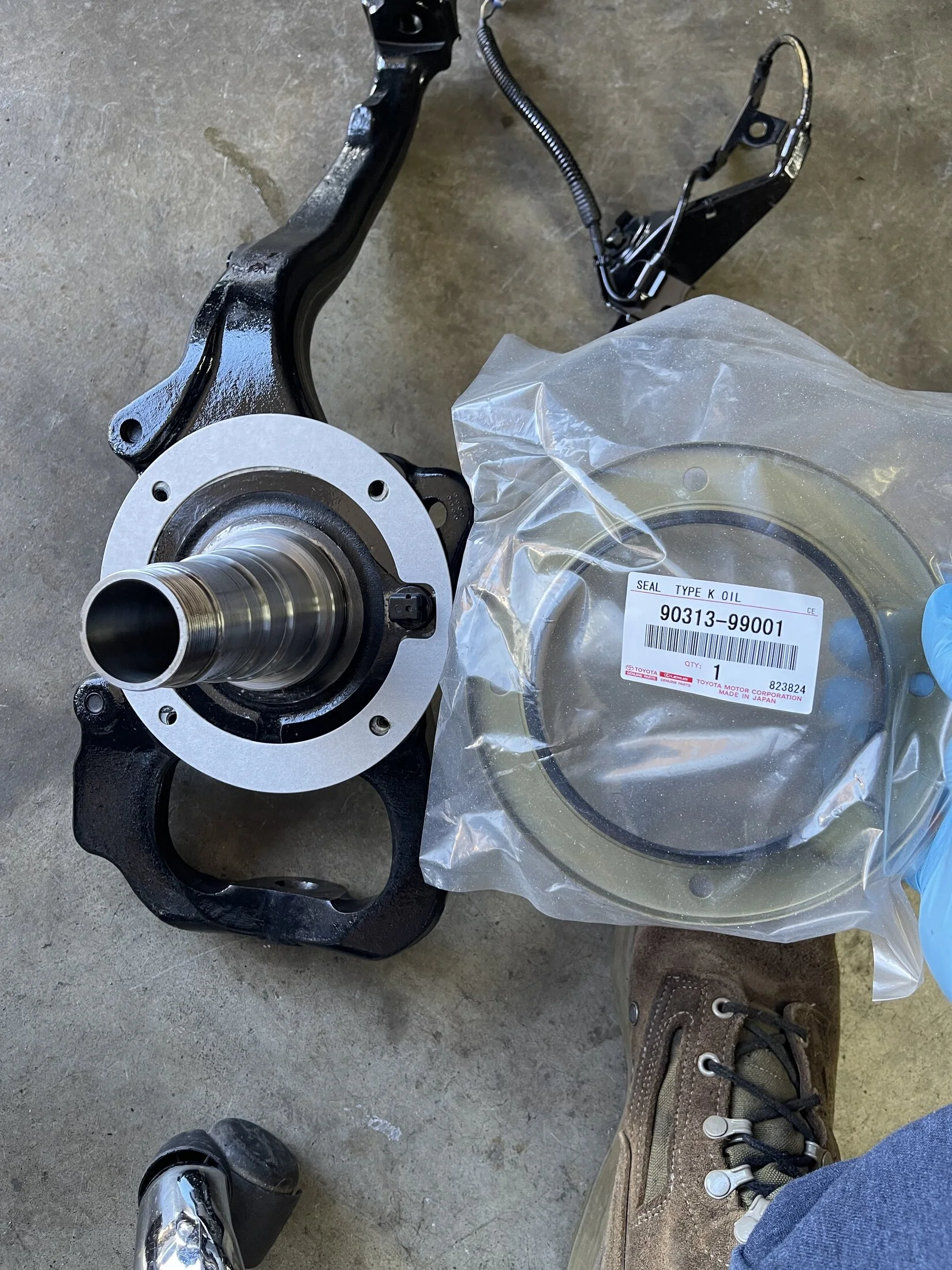

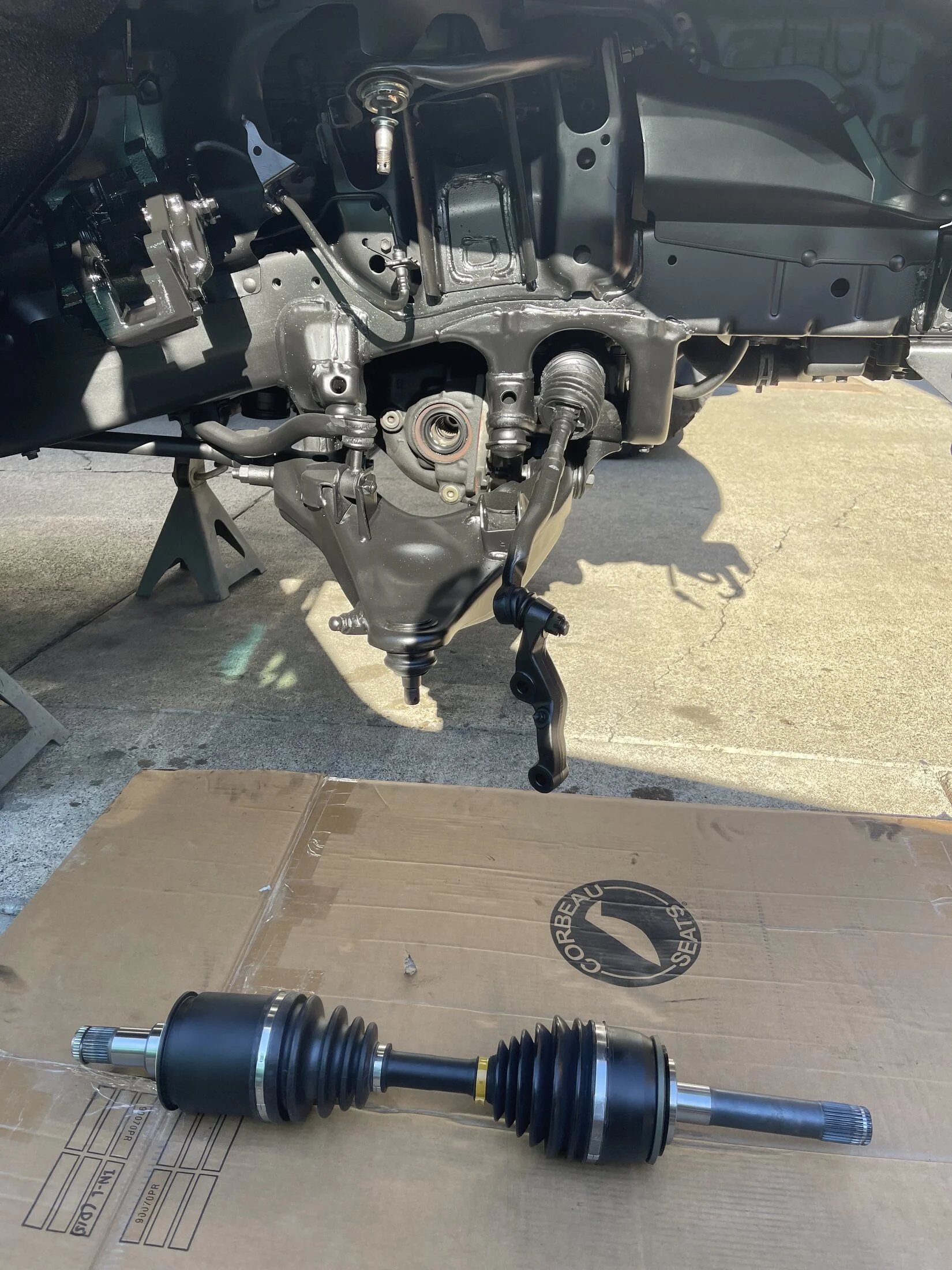

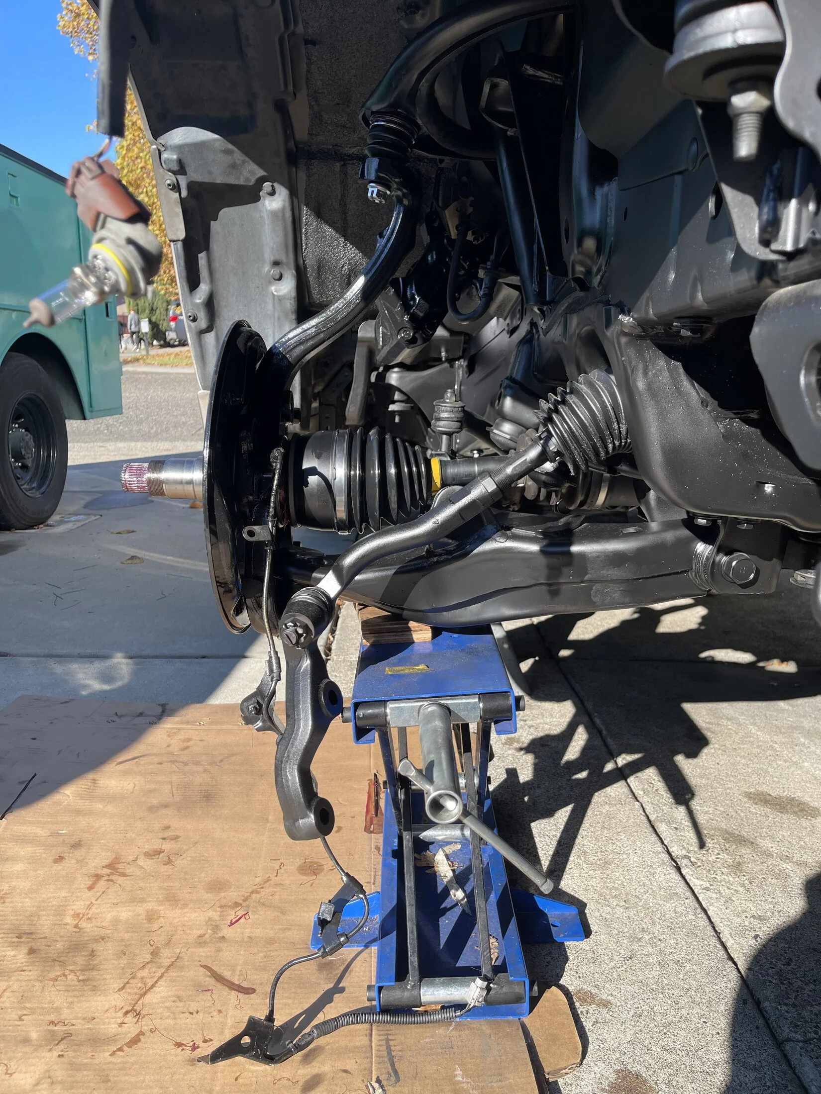

Ok lots of updates! I finished overhauling the front end with all OEM Toyota parts 😉

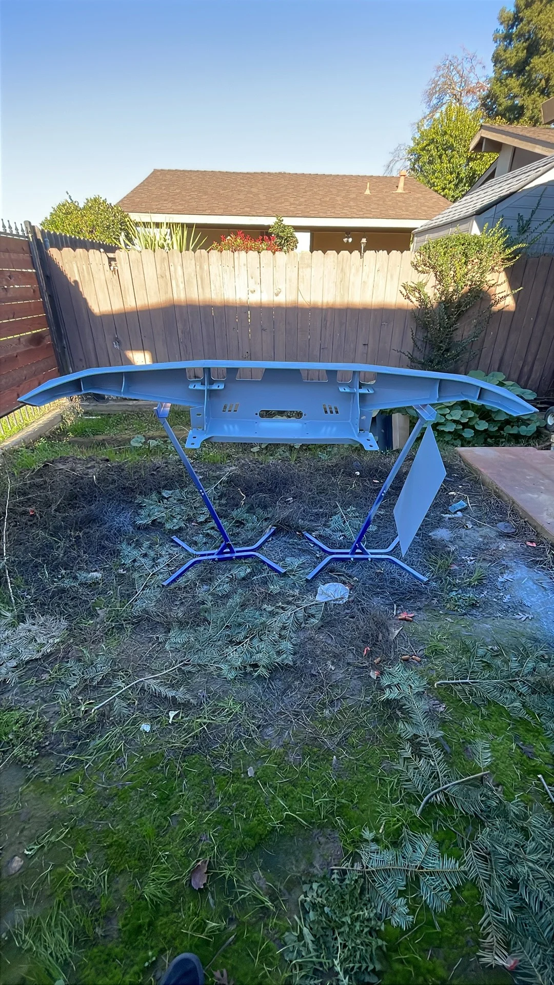

First everything got pressure washed scrubbed pressure washed scrubbed again and a final pressure wash for a good clean work environment. Sanded all the loose paint off wash a right angle die grinder with rol loc sanding discs and filled it up with satin paint. Engine gloss black paint for the brake components
I also replaced the axle/diff mounts and installed a Slee diff drop. With the info from this forum I also spliced the dash harness to remove the factory navigation headunit.

The O2 sensors I was willing to get Bosch from the parts store because it’s a quick job and lifetime warranty. I’ve also used Bosch O2 sensors on many projects without issue so I feel good about it. But yes you will see I stick with OEM for most all replacement parts.

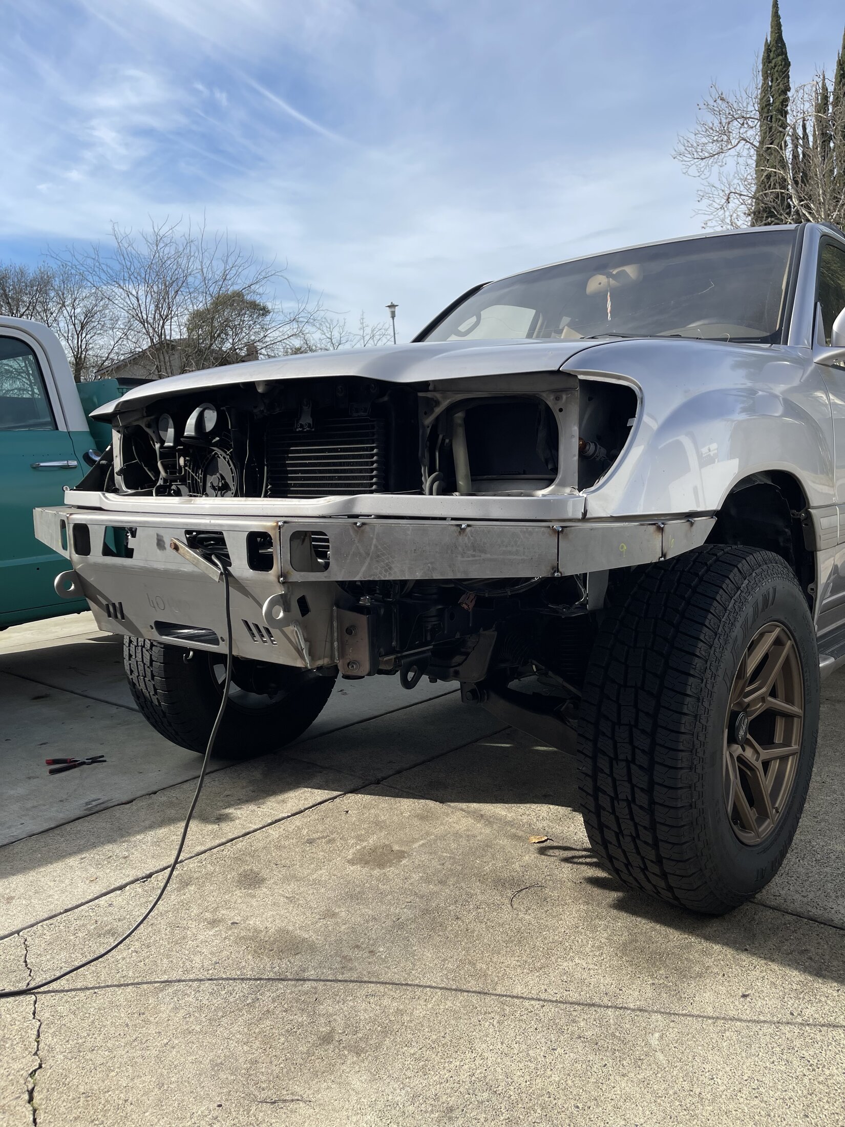

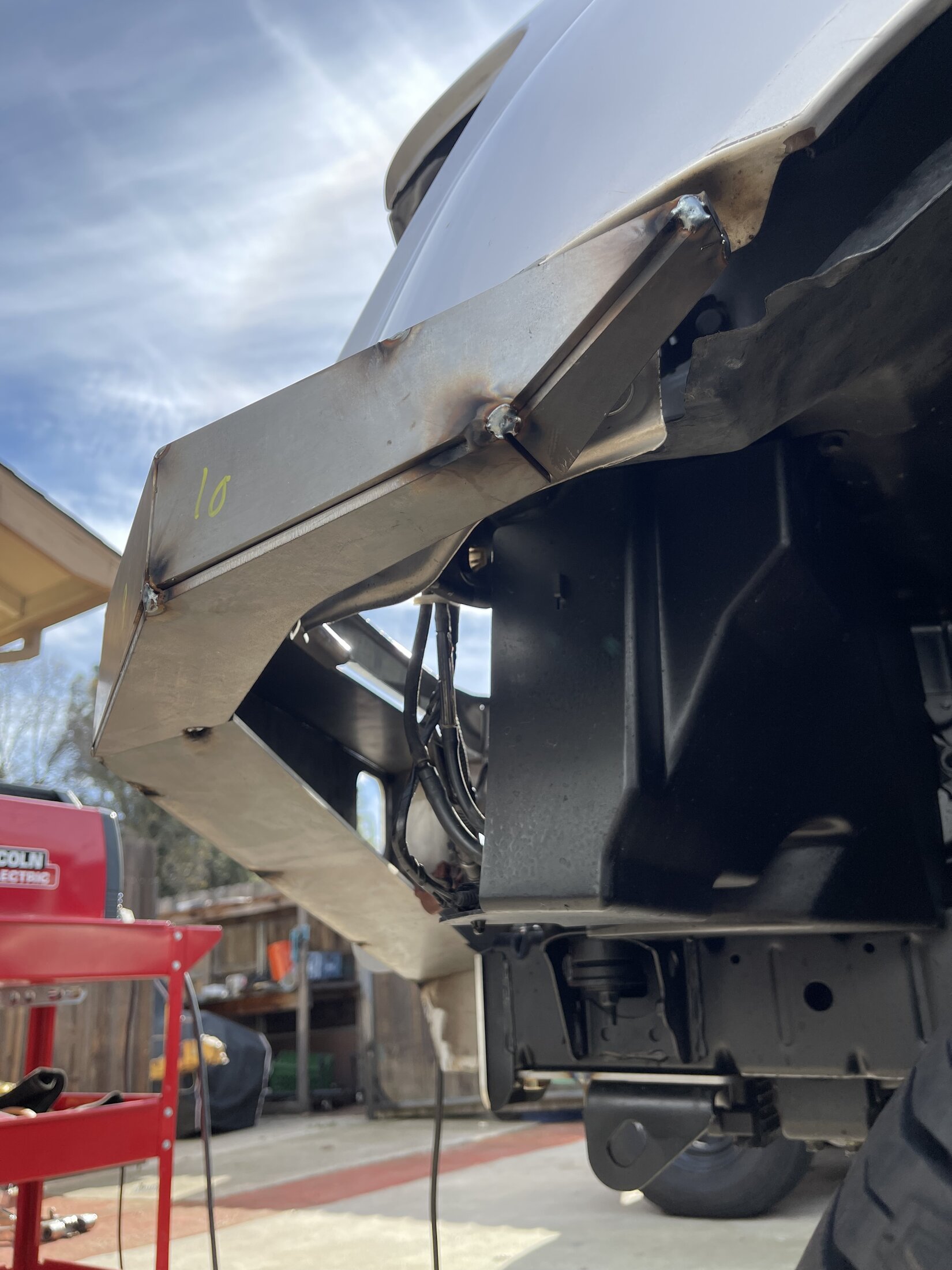

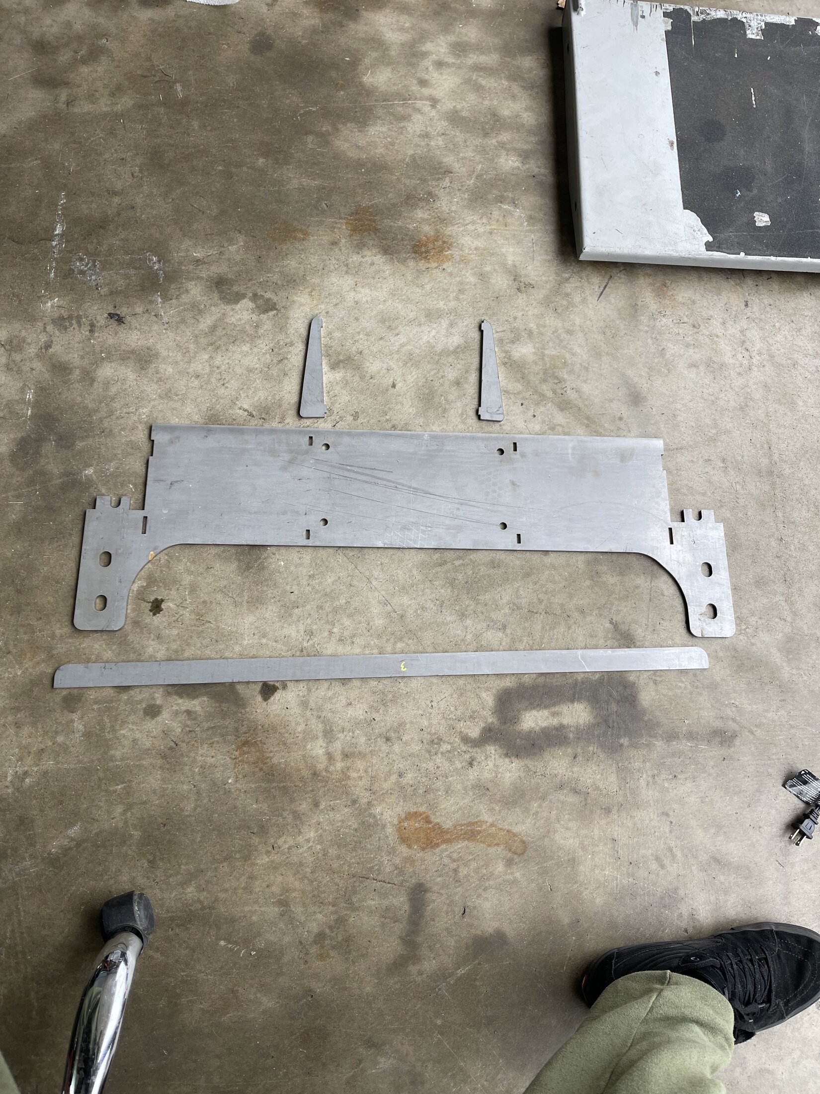

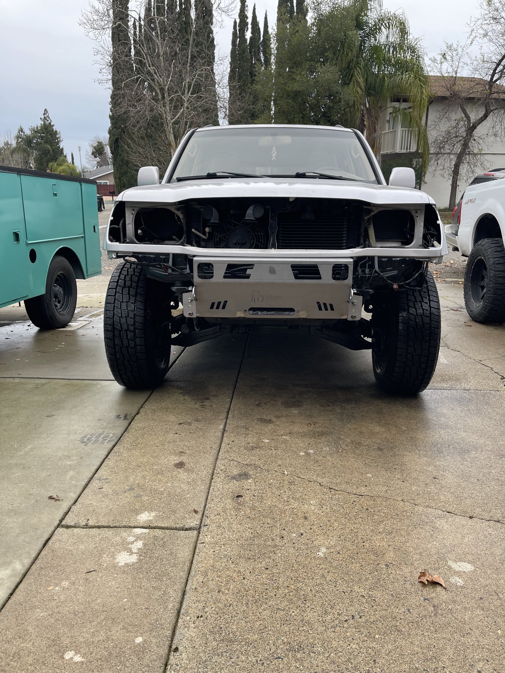

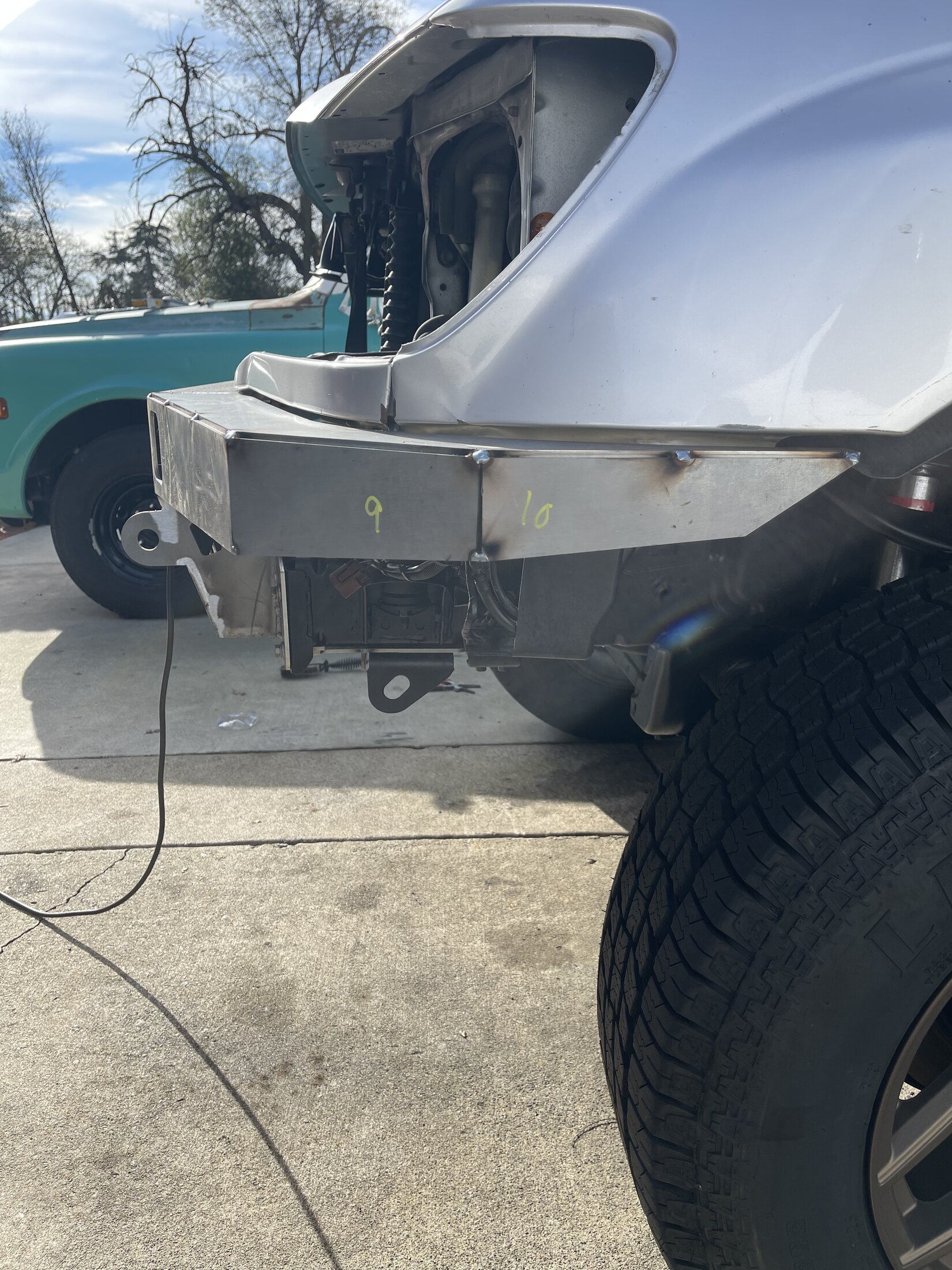

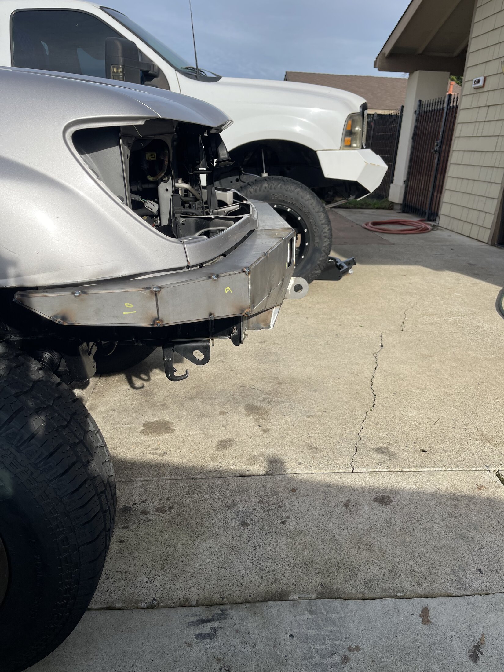

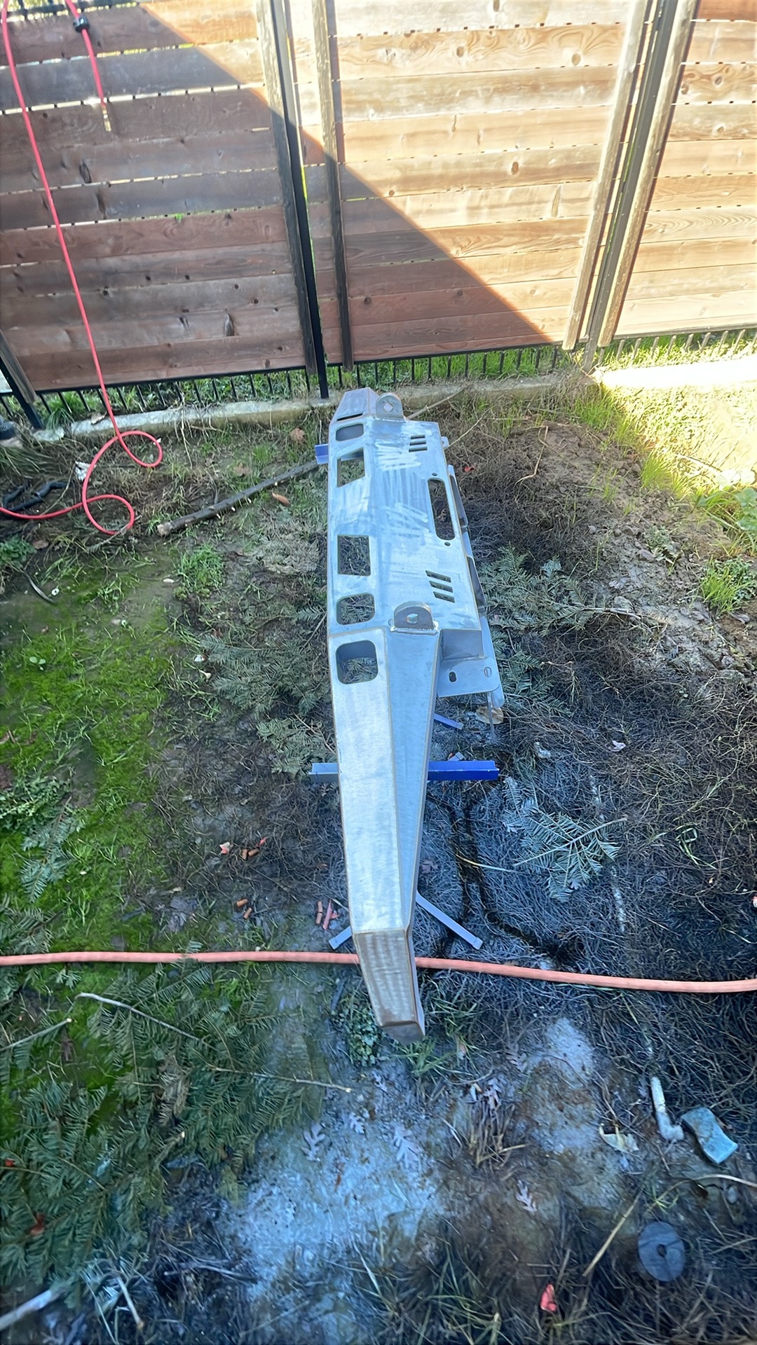

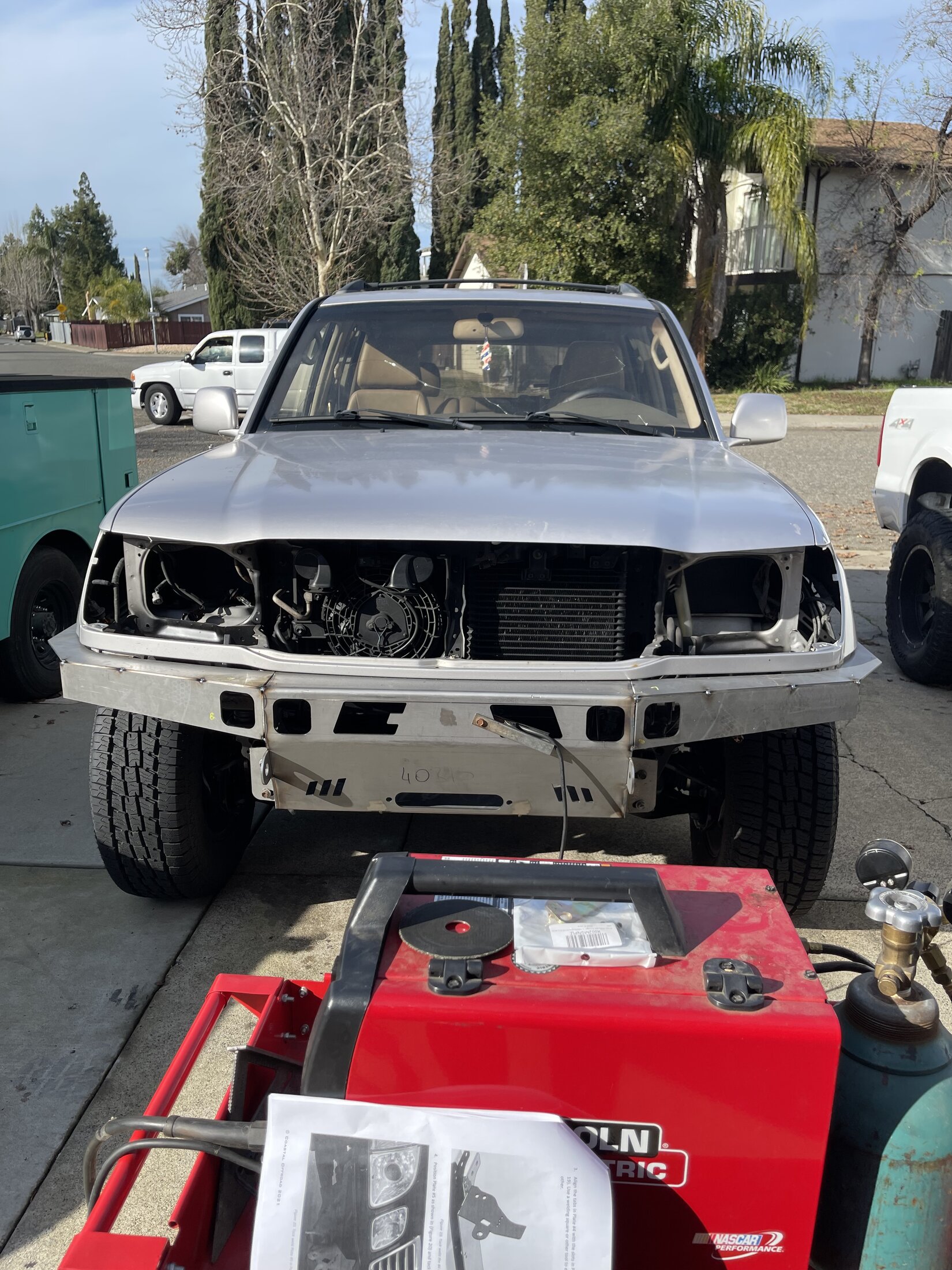

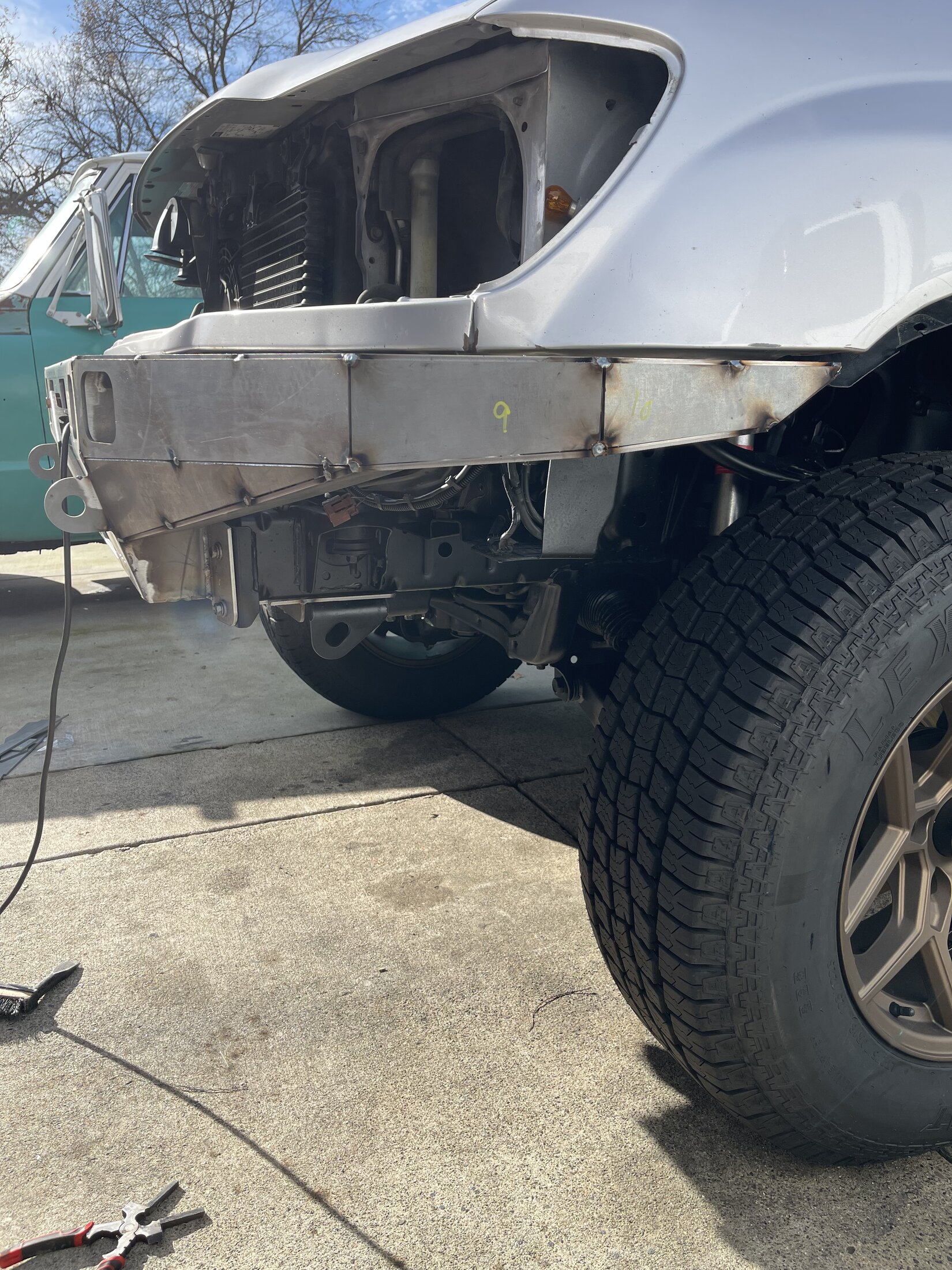

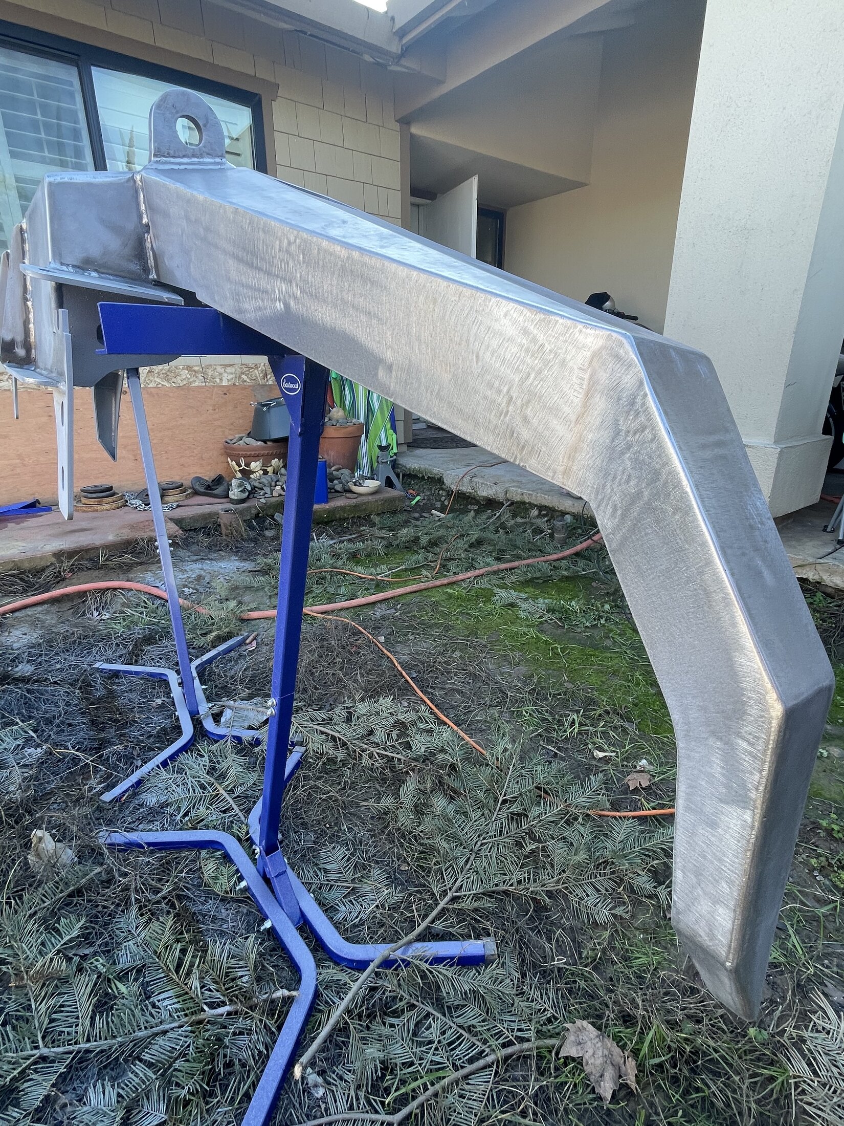

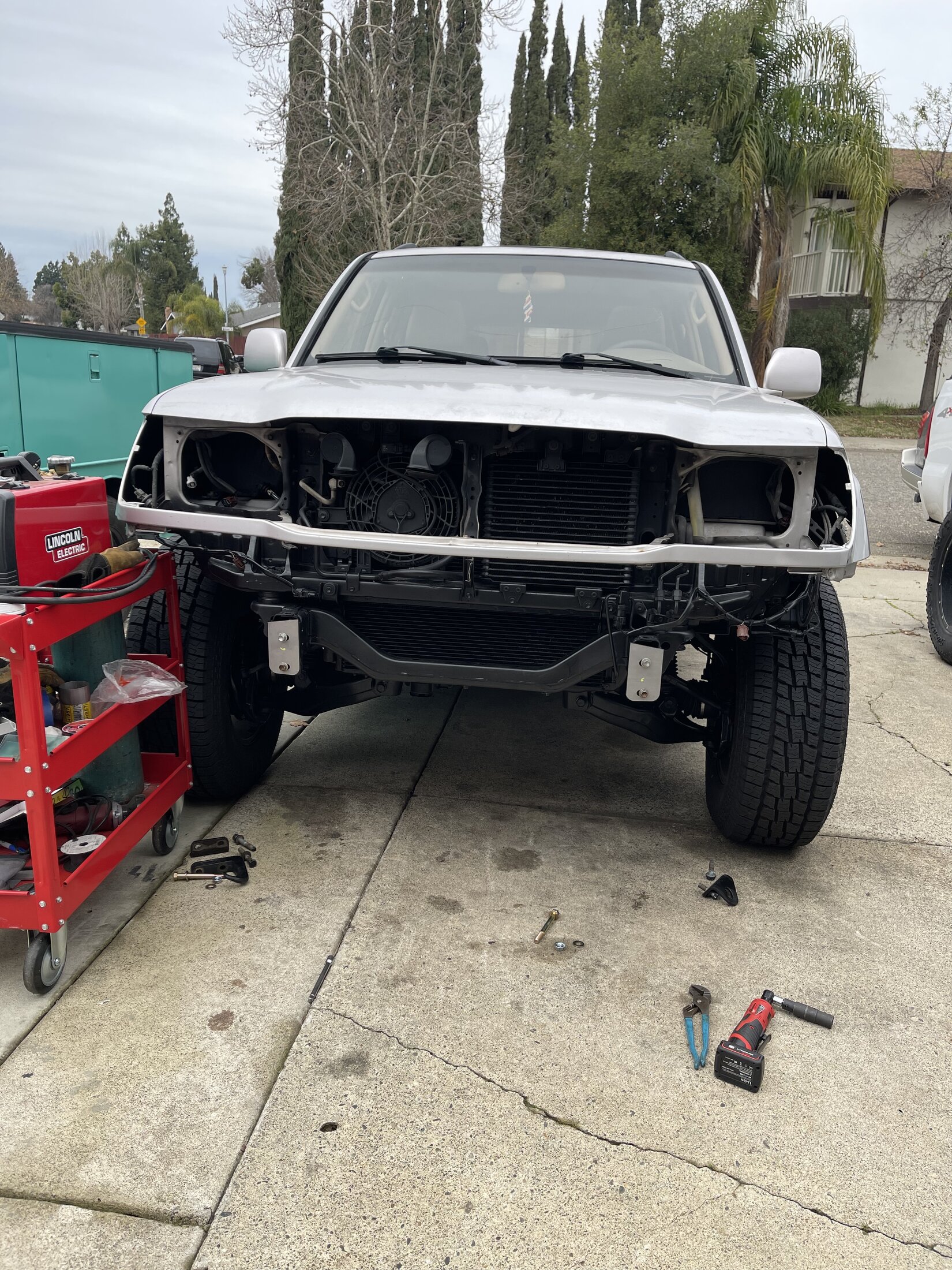

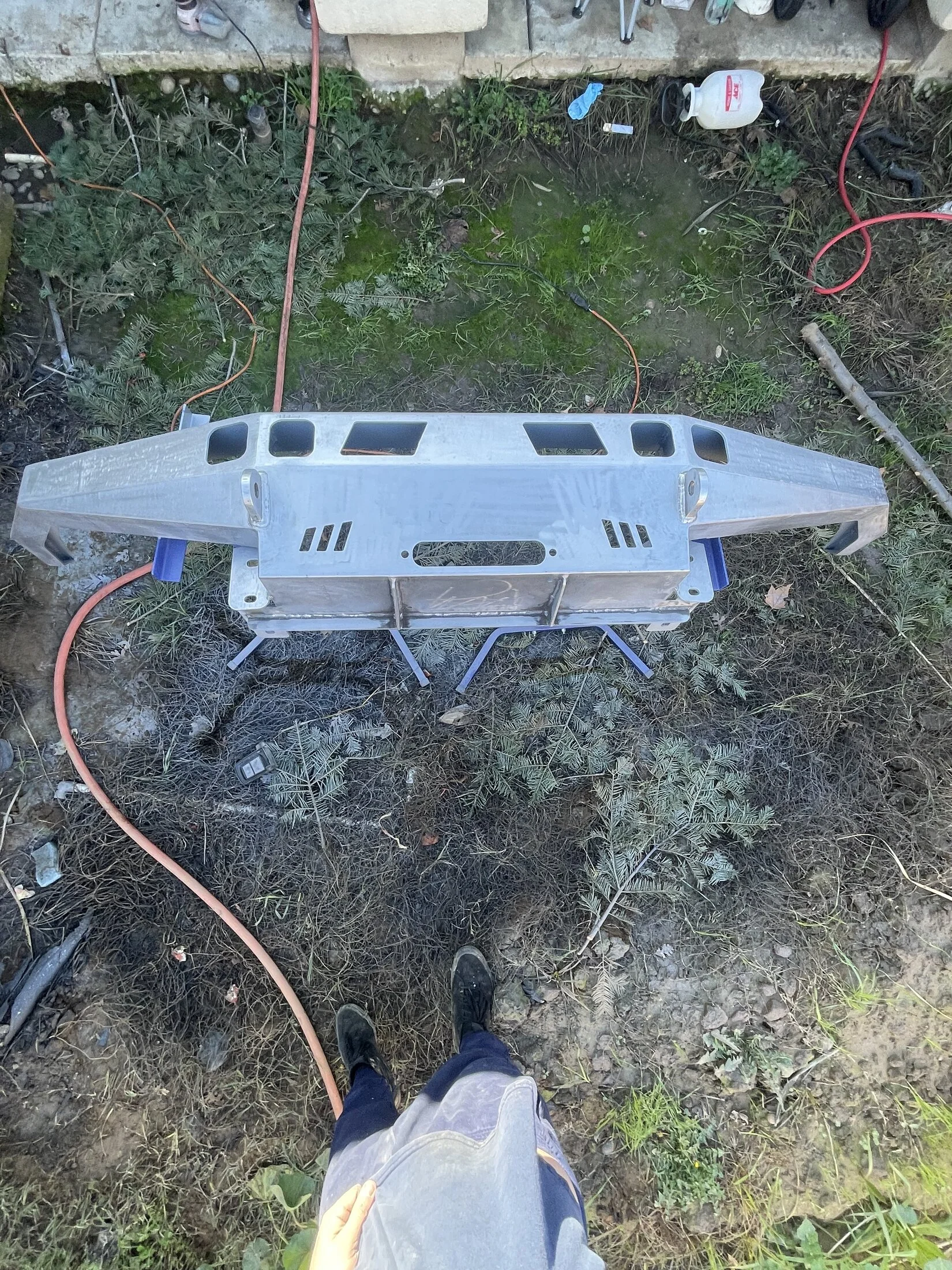

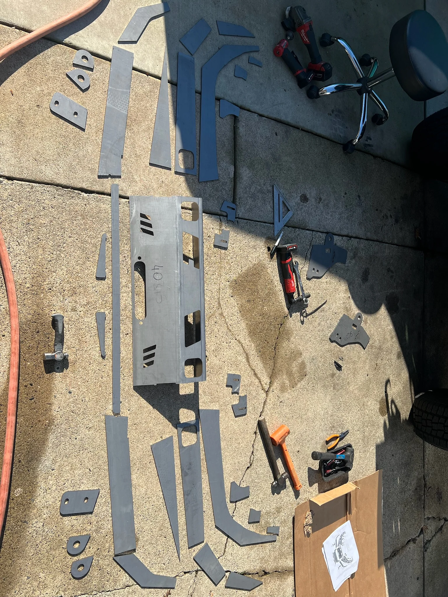

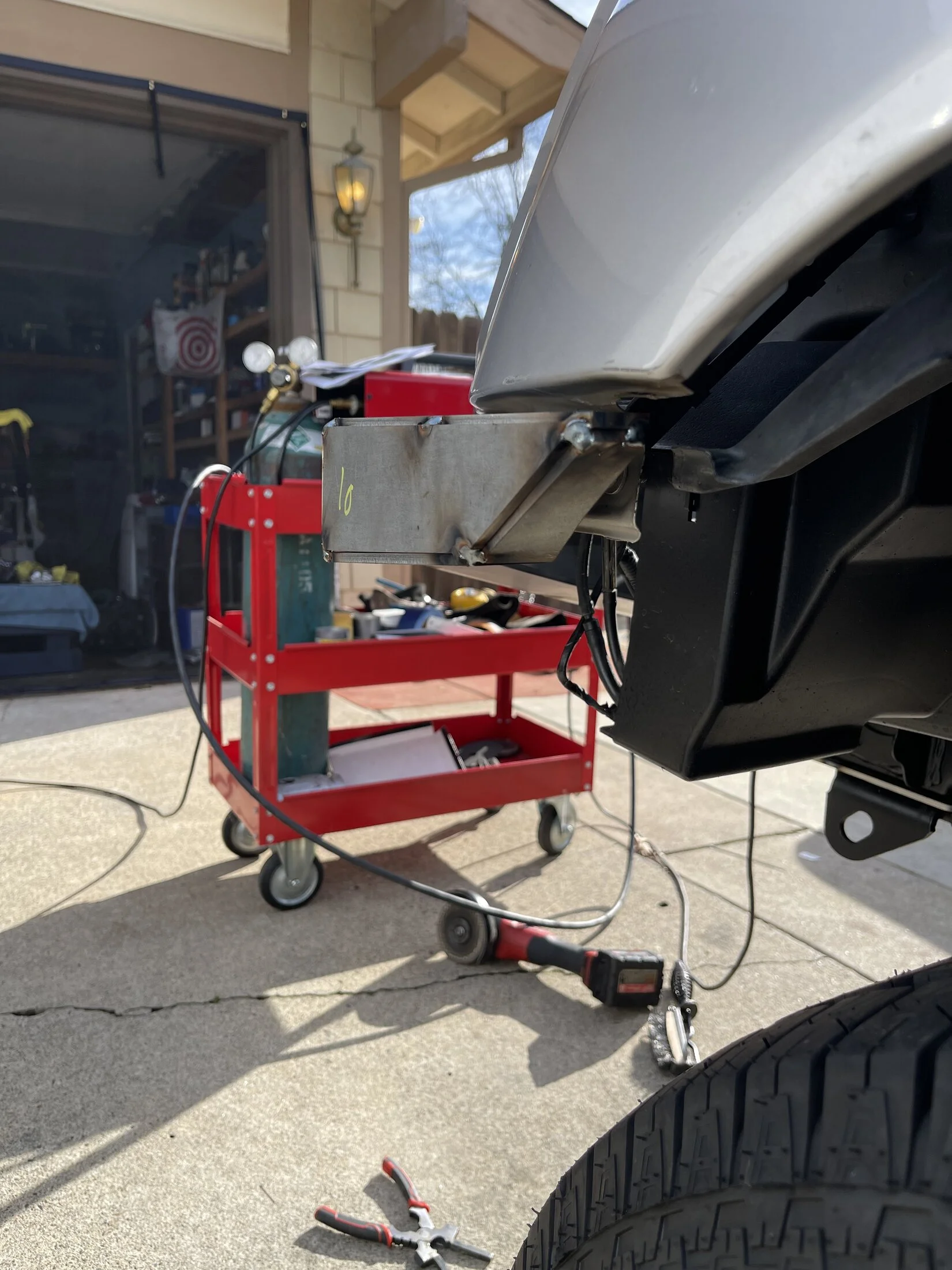

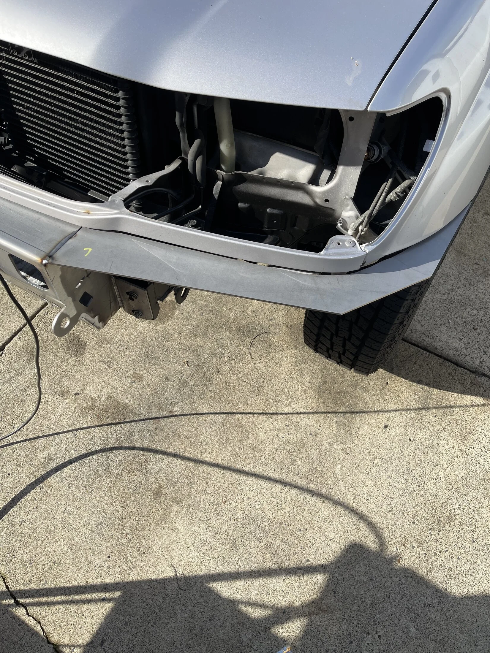

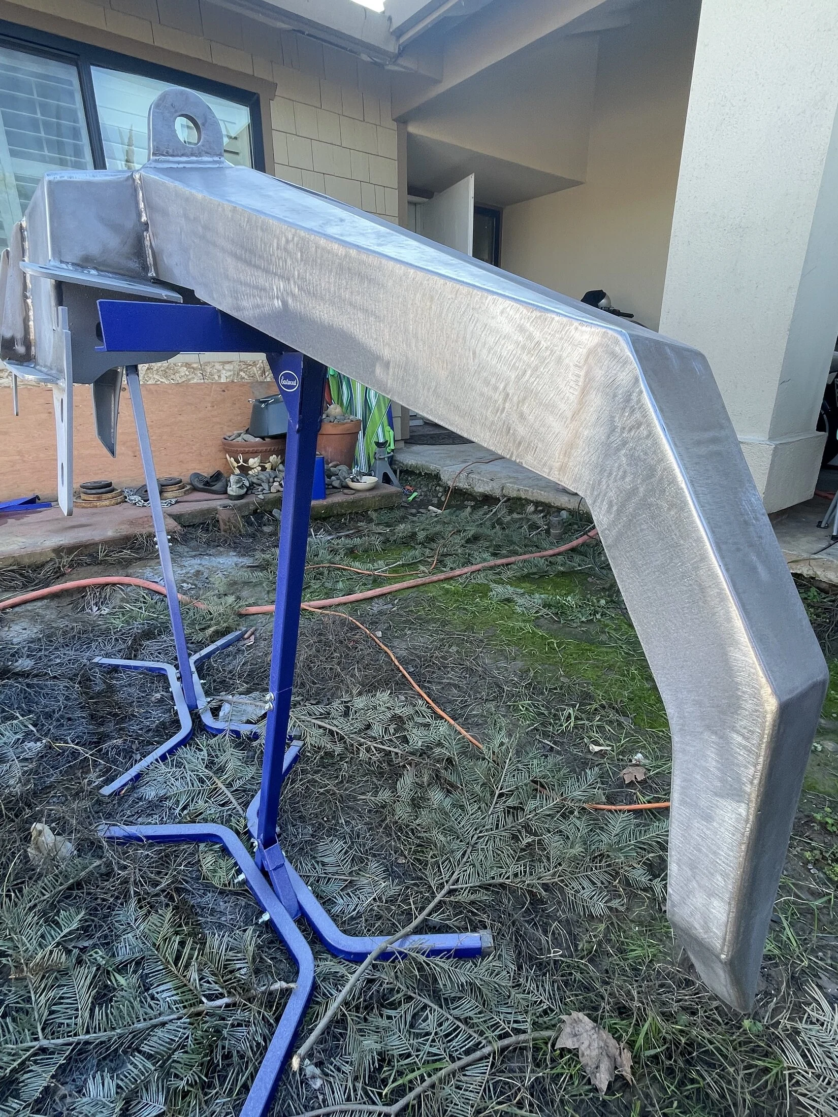

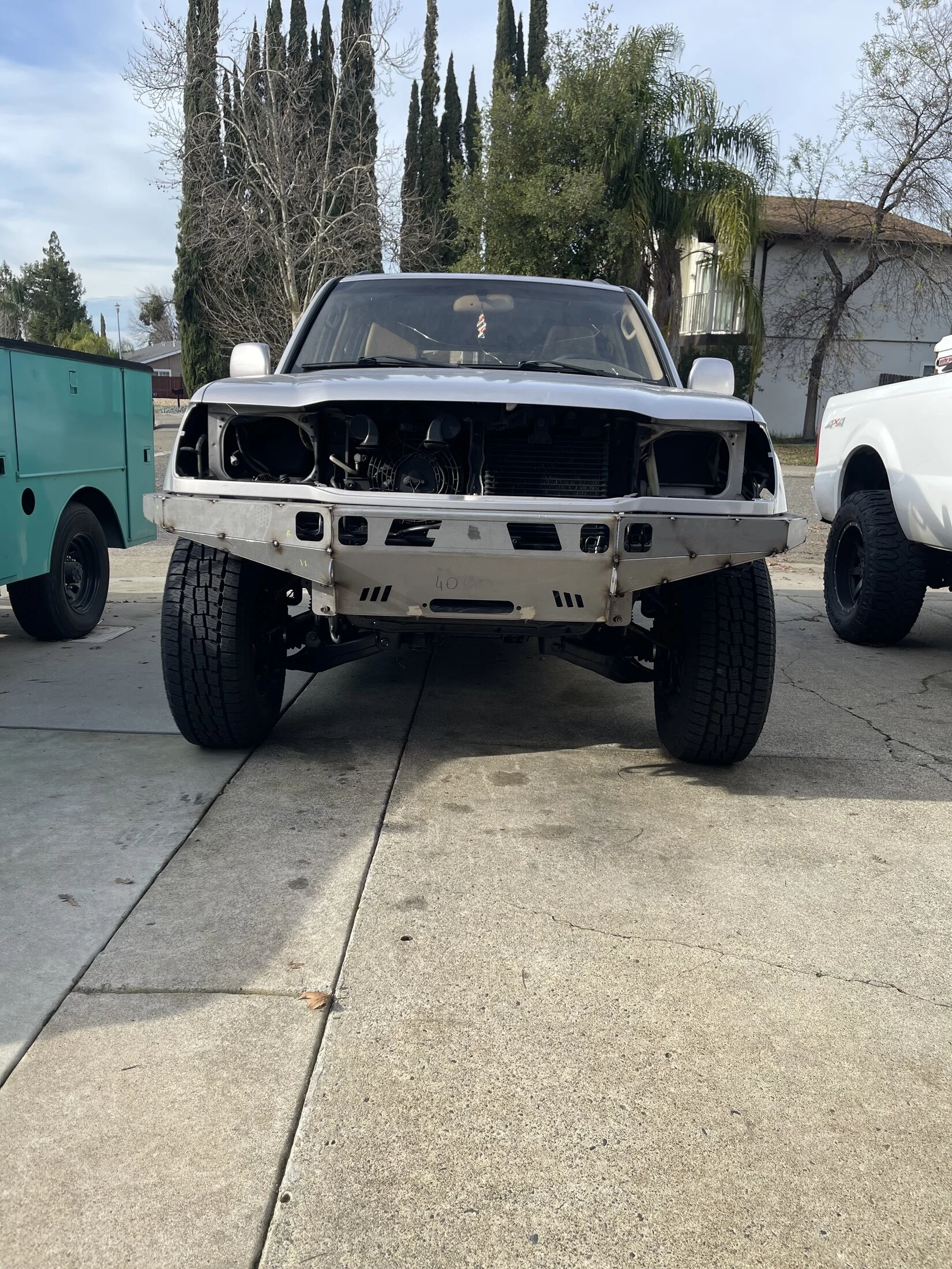

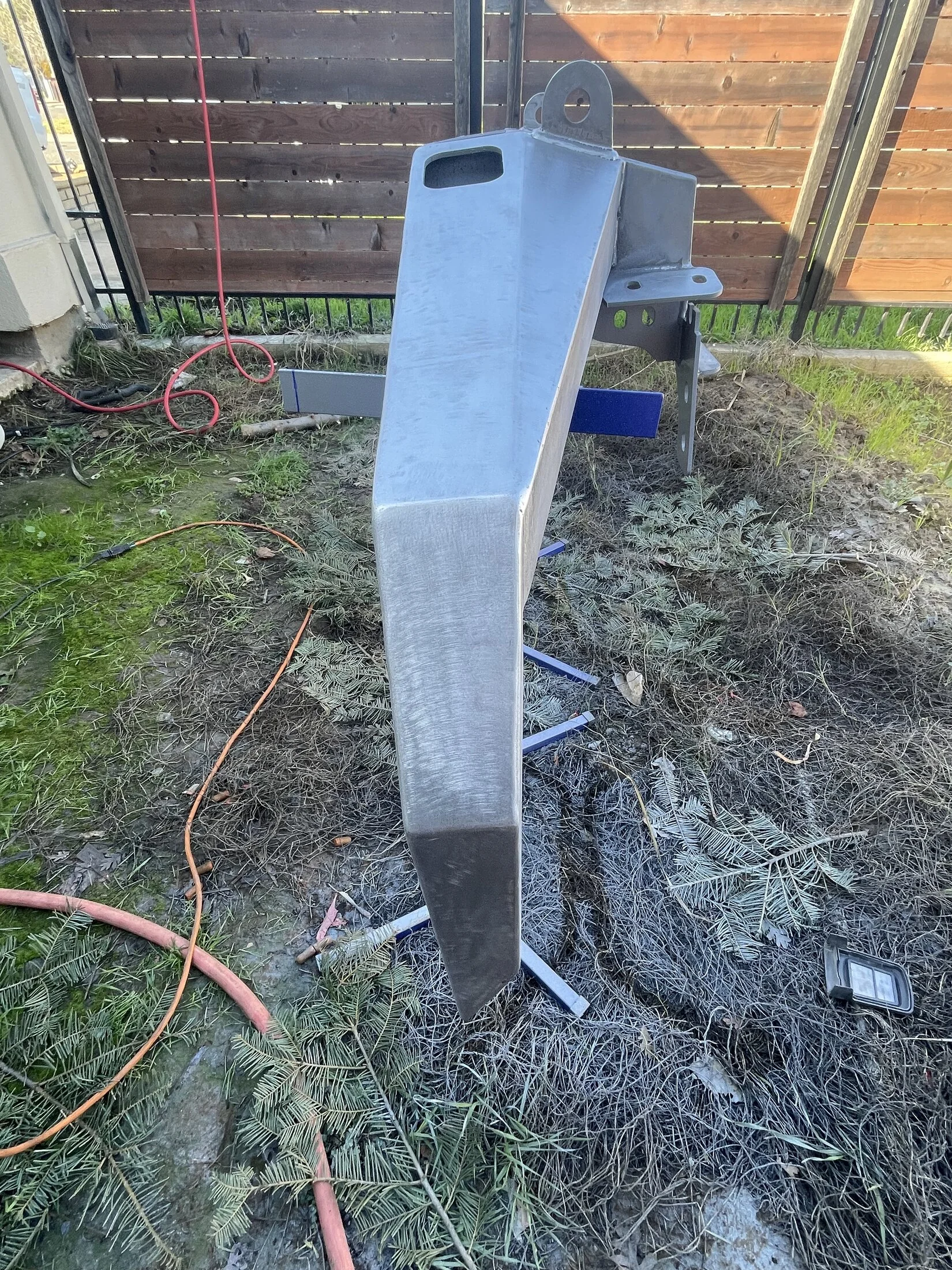

The front bumper was toast on this rig so we decided to put some protection on. The driver fender was tweaked a bit but I was able to tweak it right back to where it needed to be. Also I’ll be shooting the bumper with some silver single stage I have and I’ll shoot clear over it. It won’t be an exact match but should be close.
